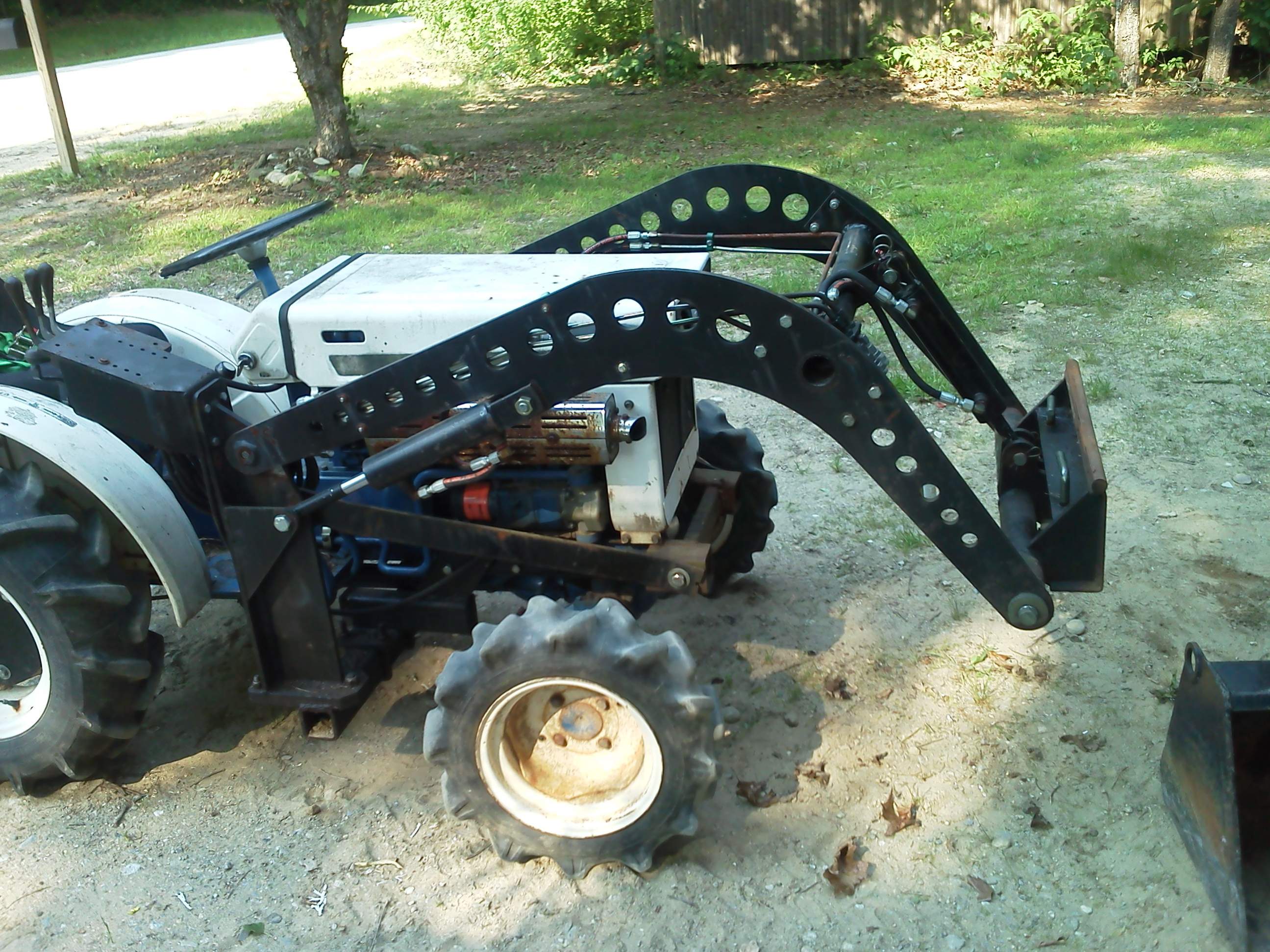

The 3rd spool is in series with the loader valve. It's mounted on the other mast.
The hose disconnects allow me to connect to a hydraulic splitter. It's actually intended to mount on a 3pt. Don't remember why we didn't set it up that way other than I think it may be a bit heavy for the little Beaver. So wheels at one end and I tow it at the other. Most of the time I leave it in the same spot and connect the tractor when I want to use it. Tractor has no problems running it, split many cord of wood over the years.

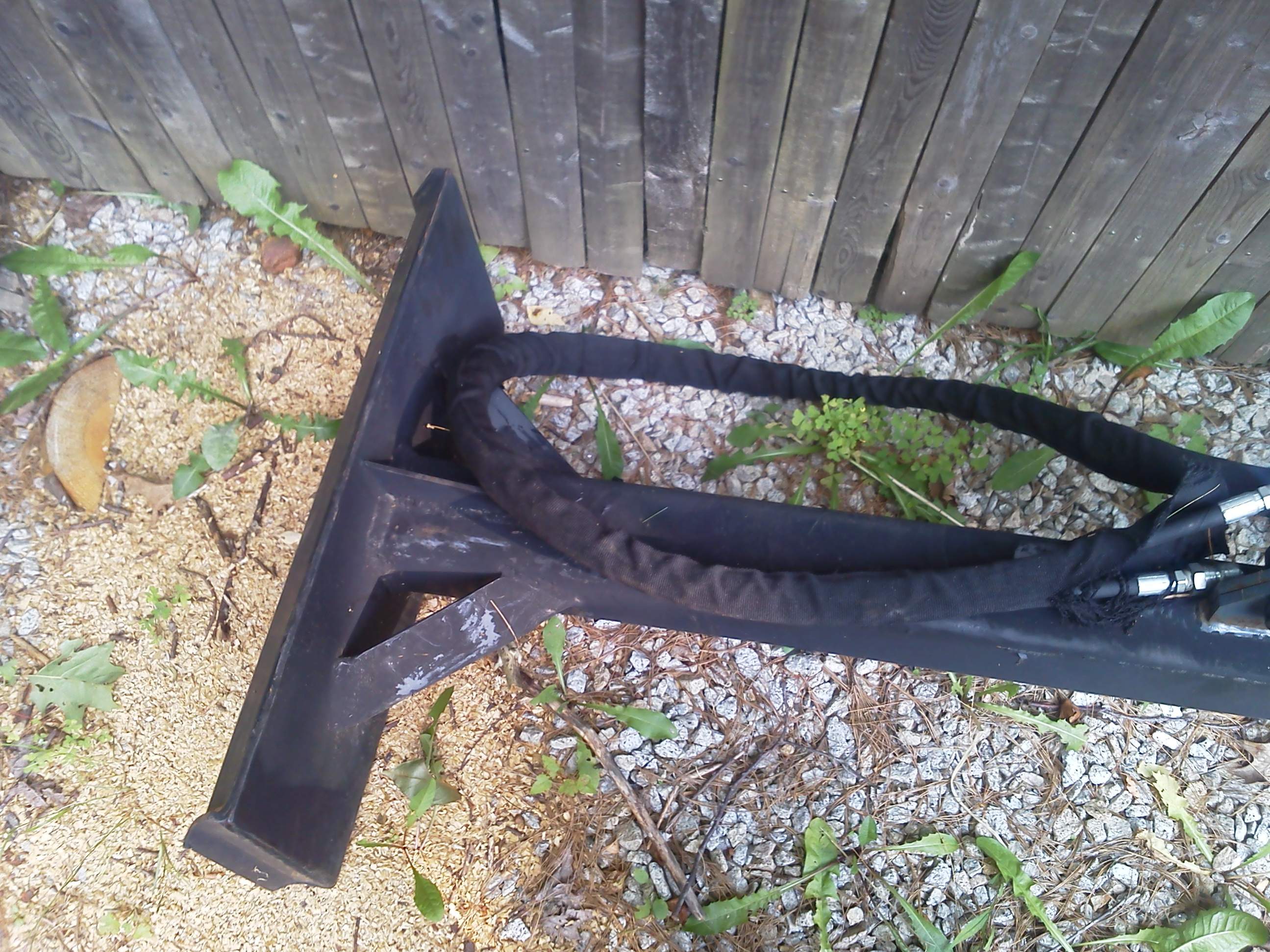

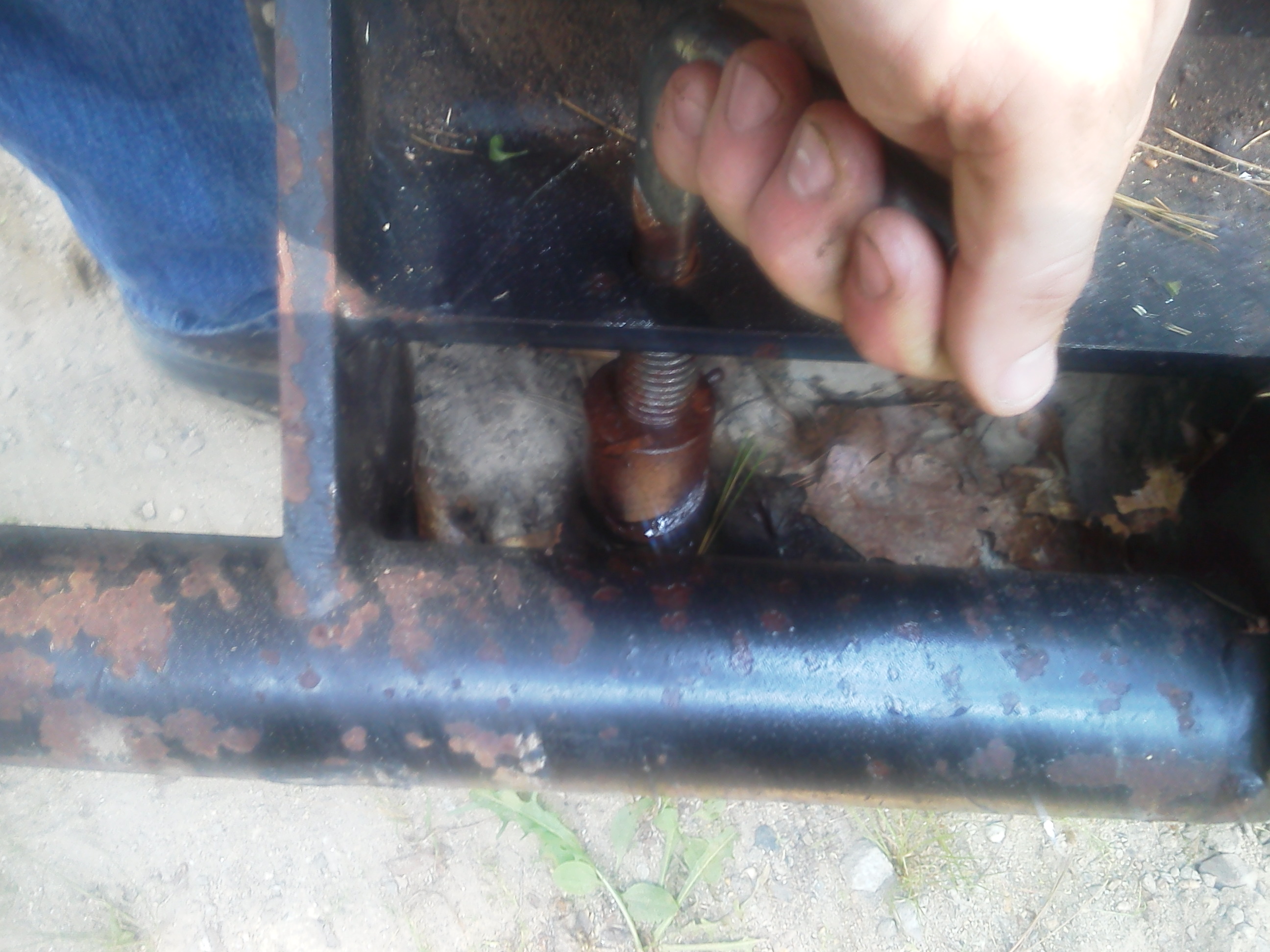

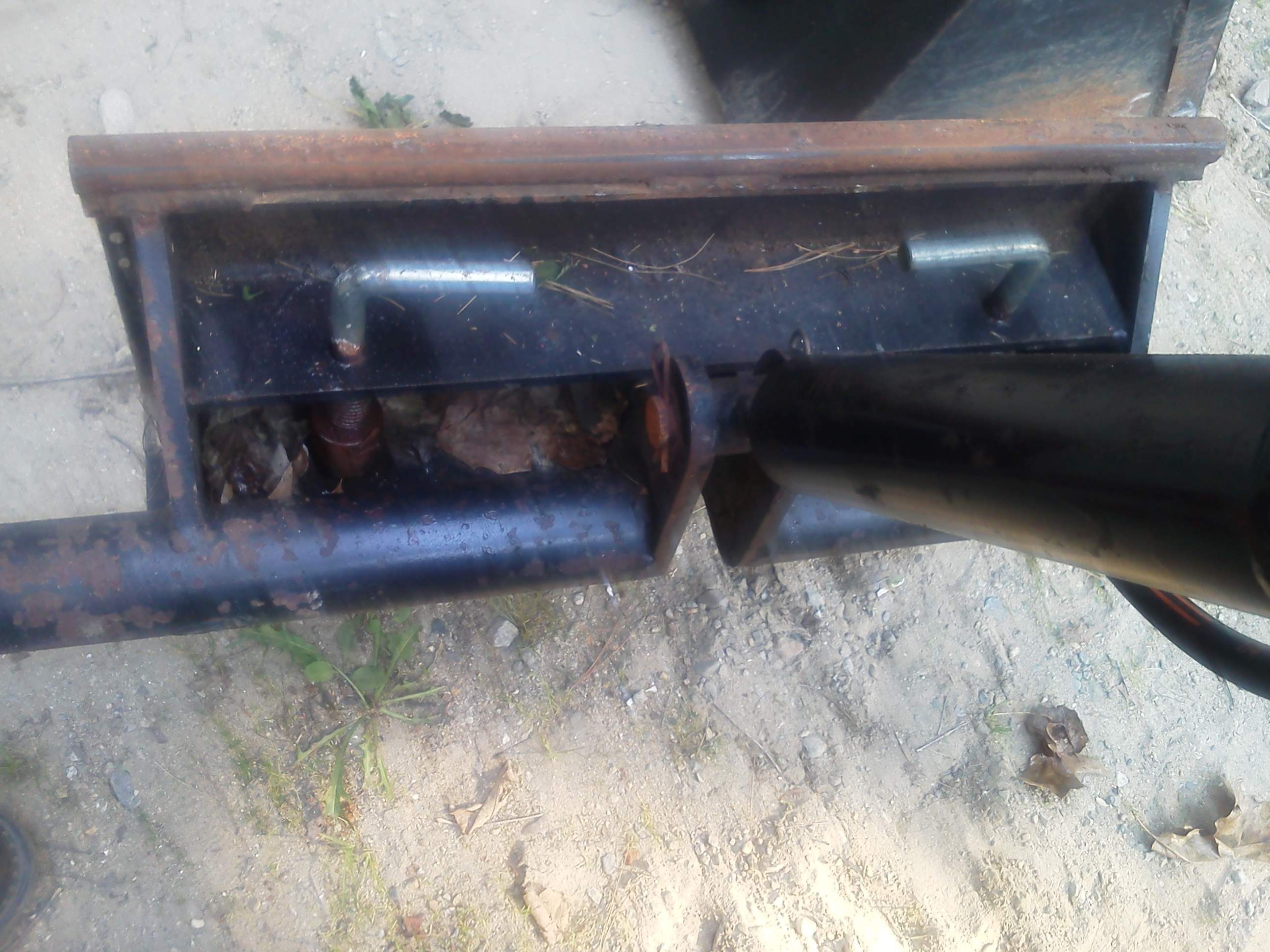

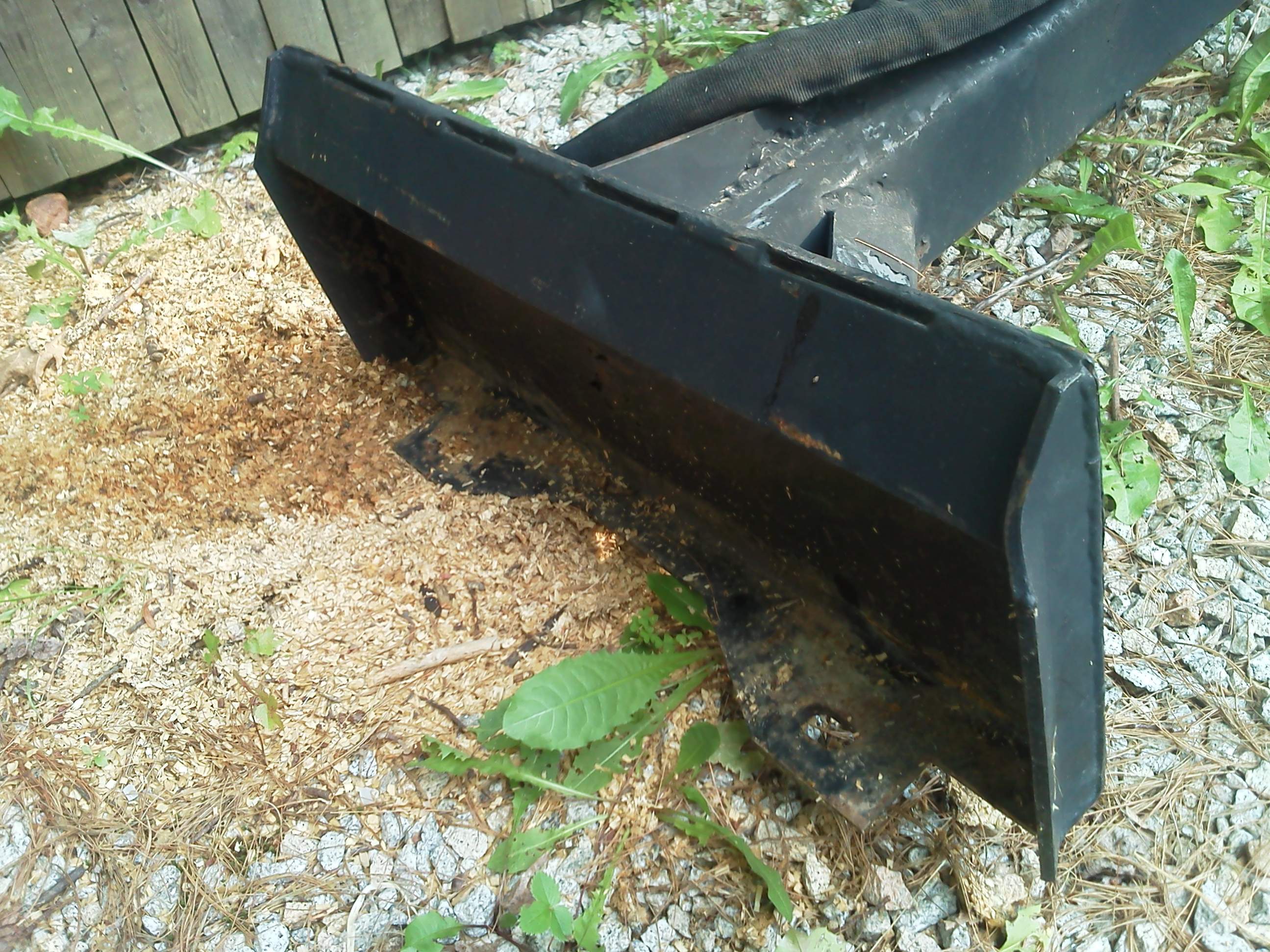

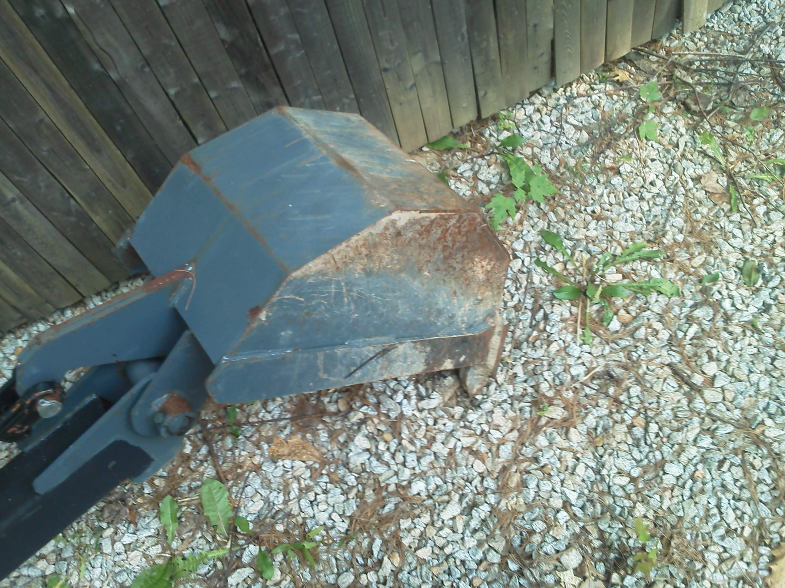

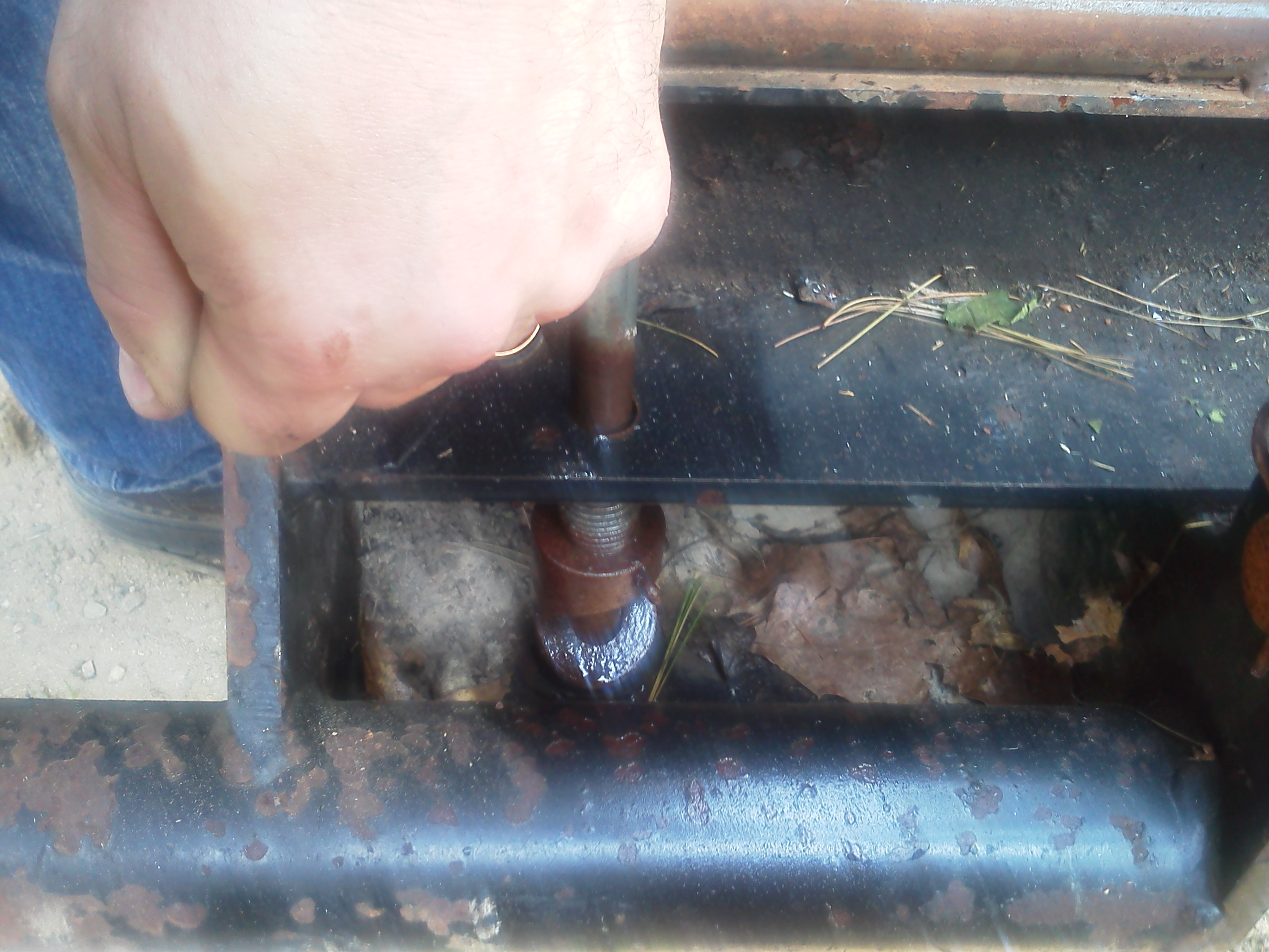

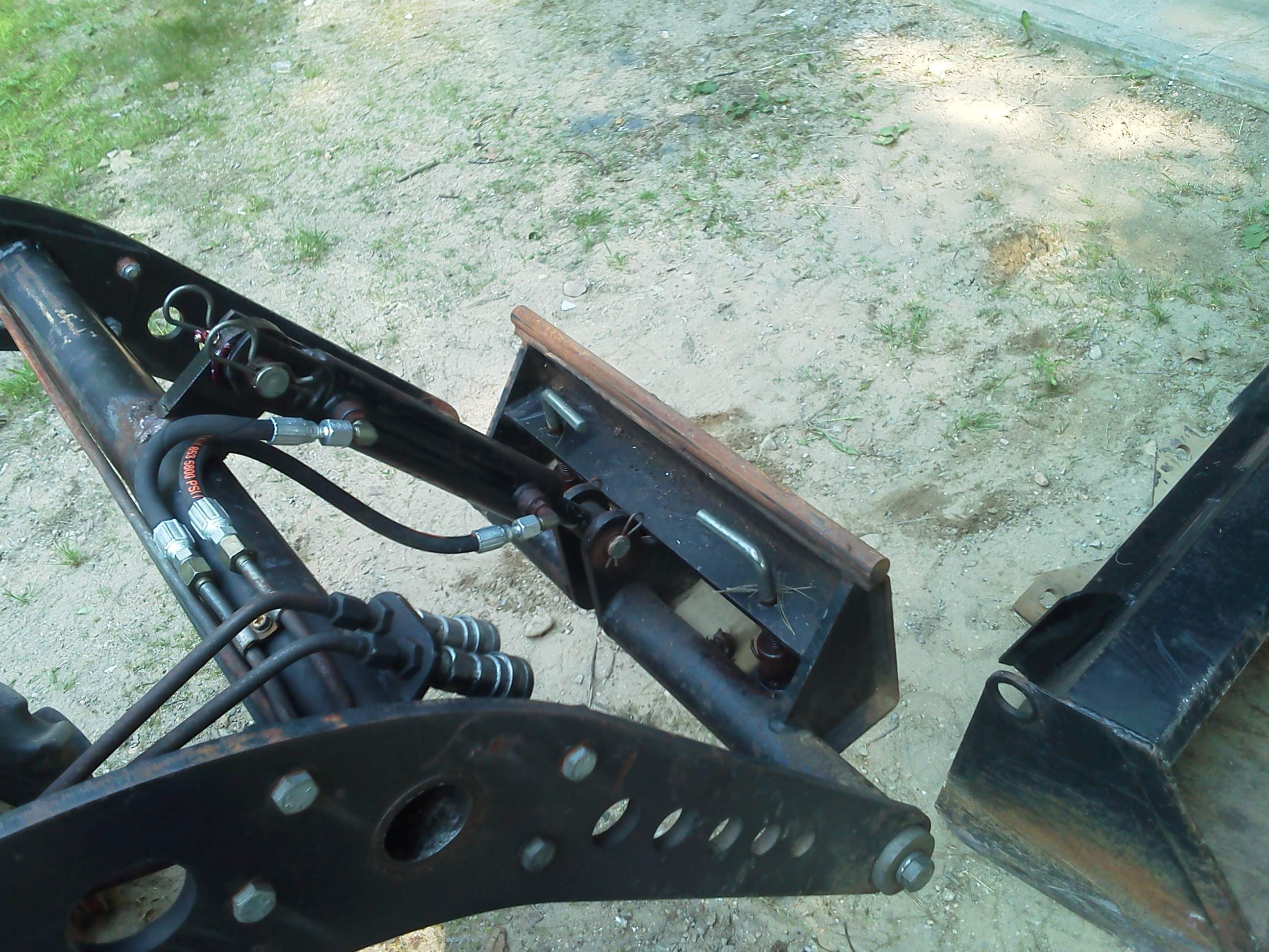

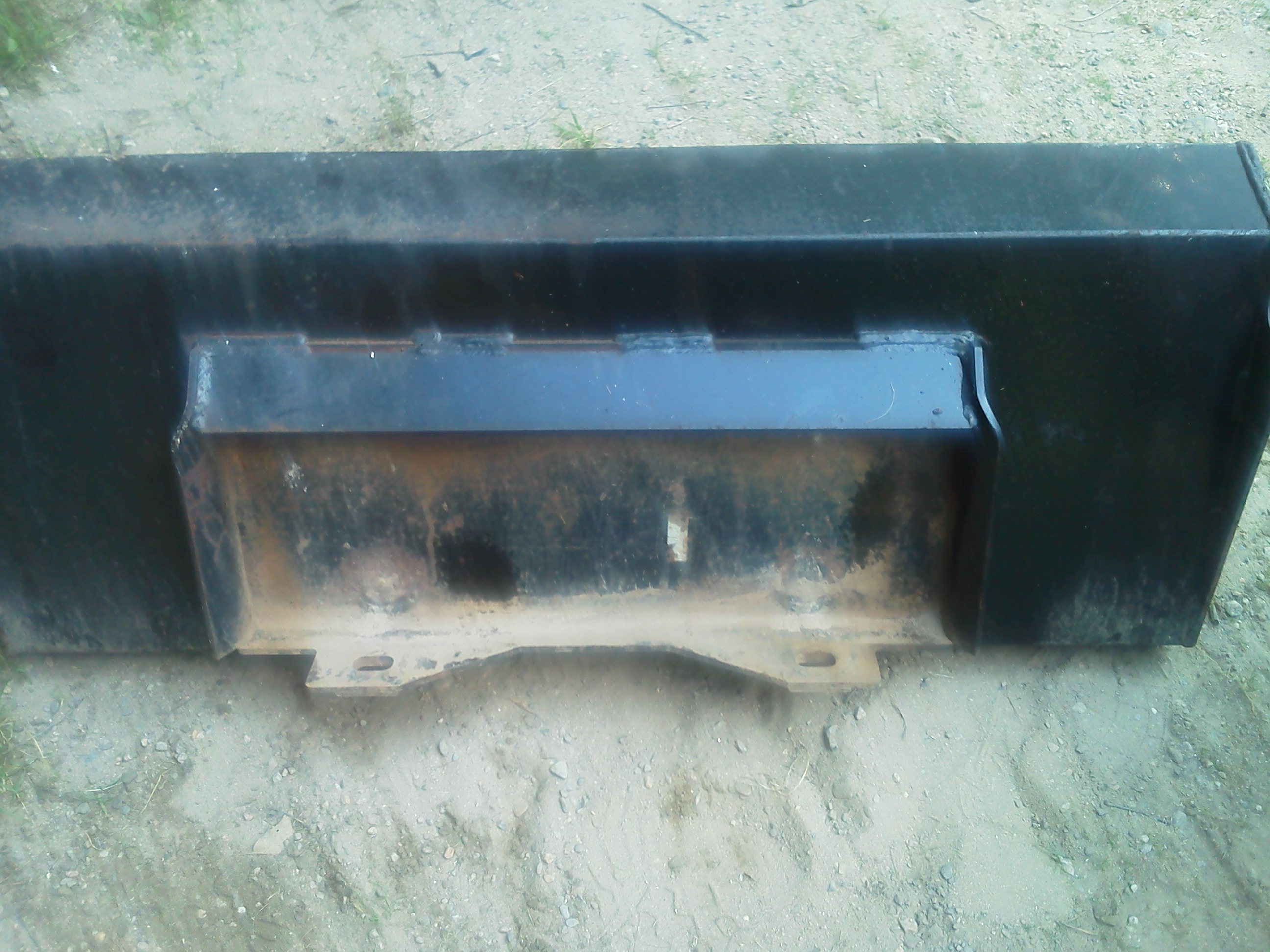

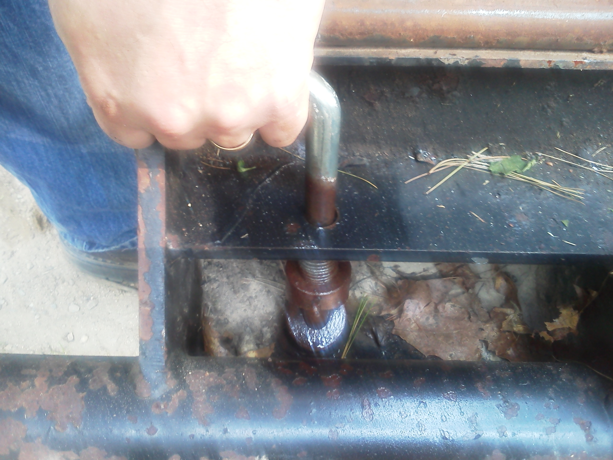

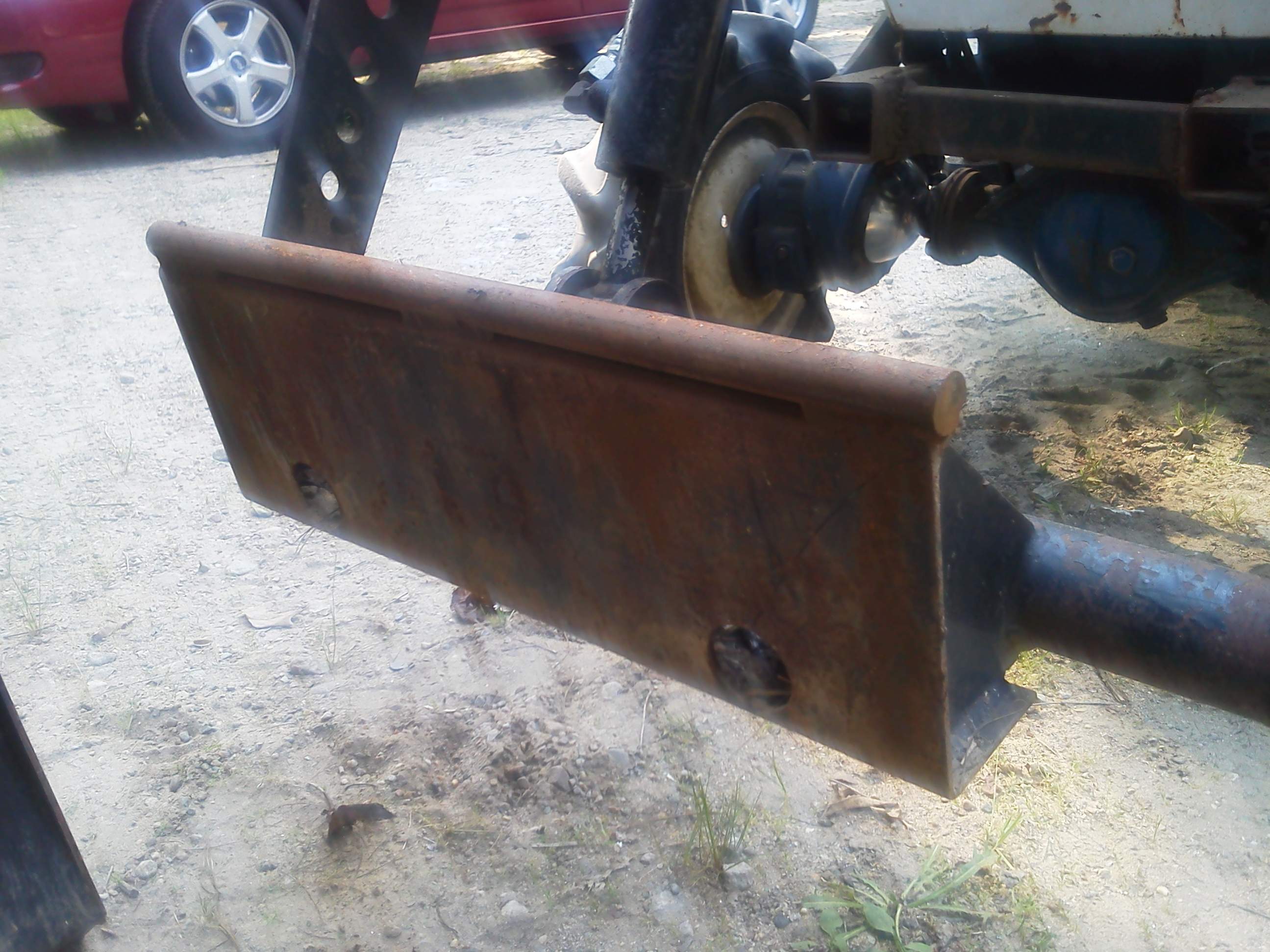

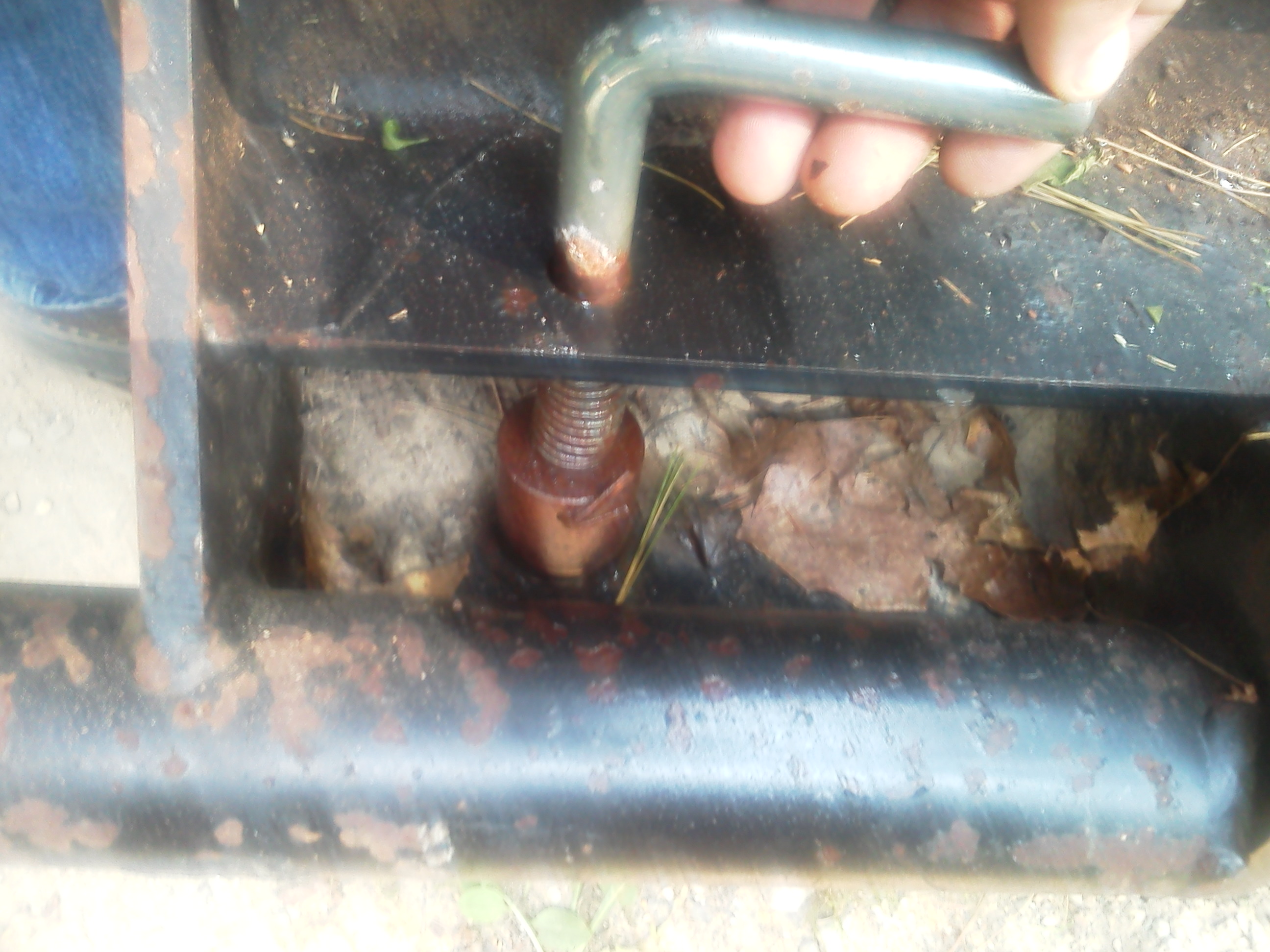

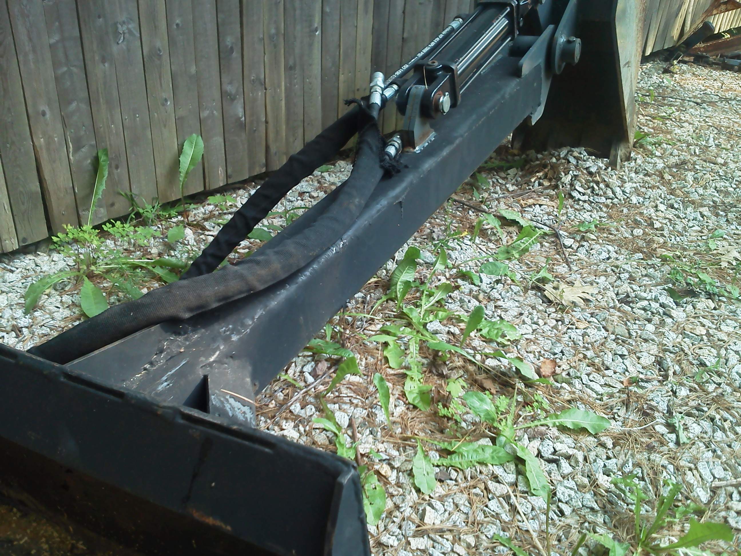

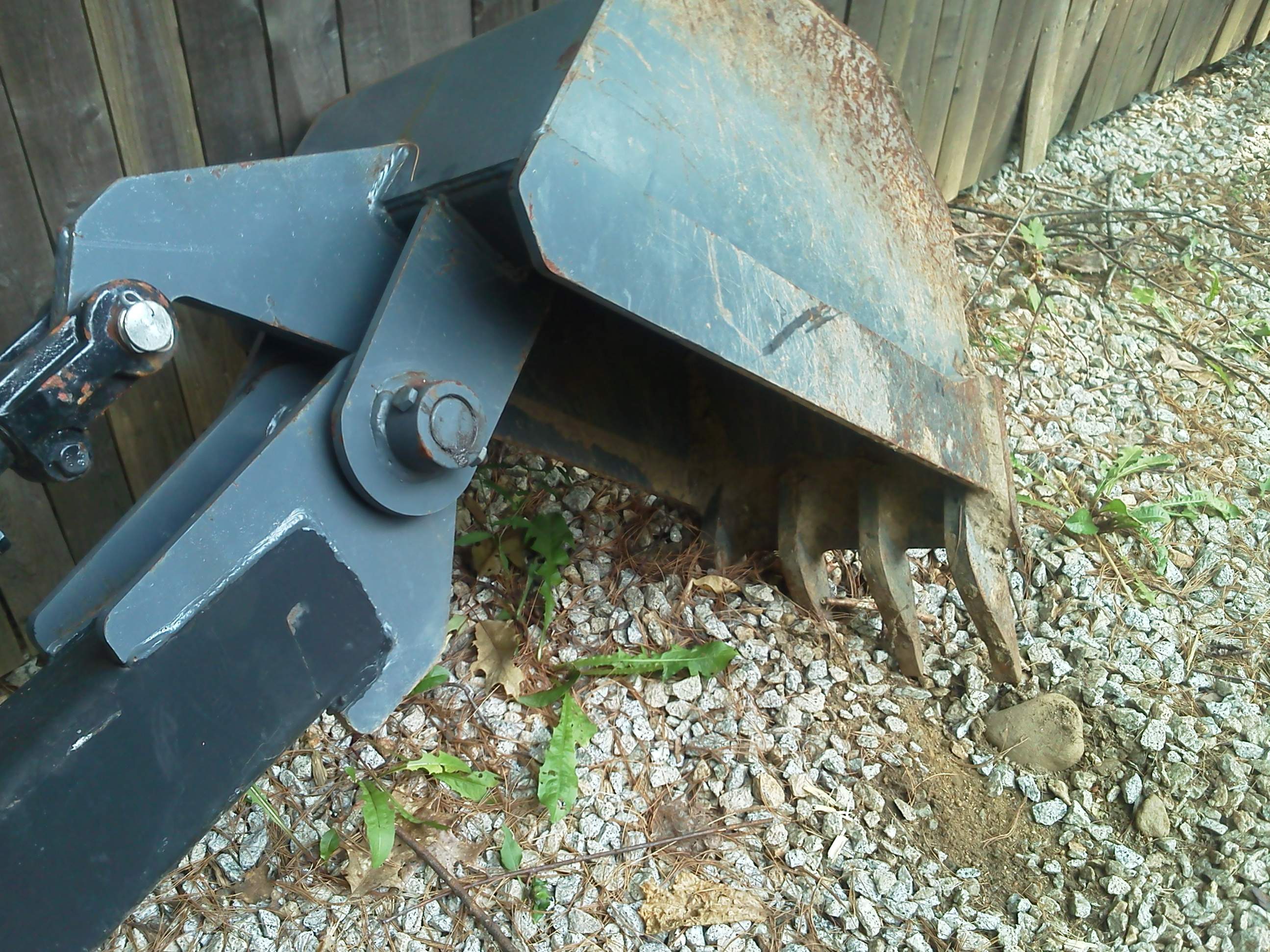

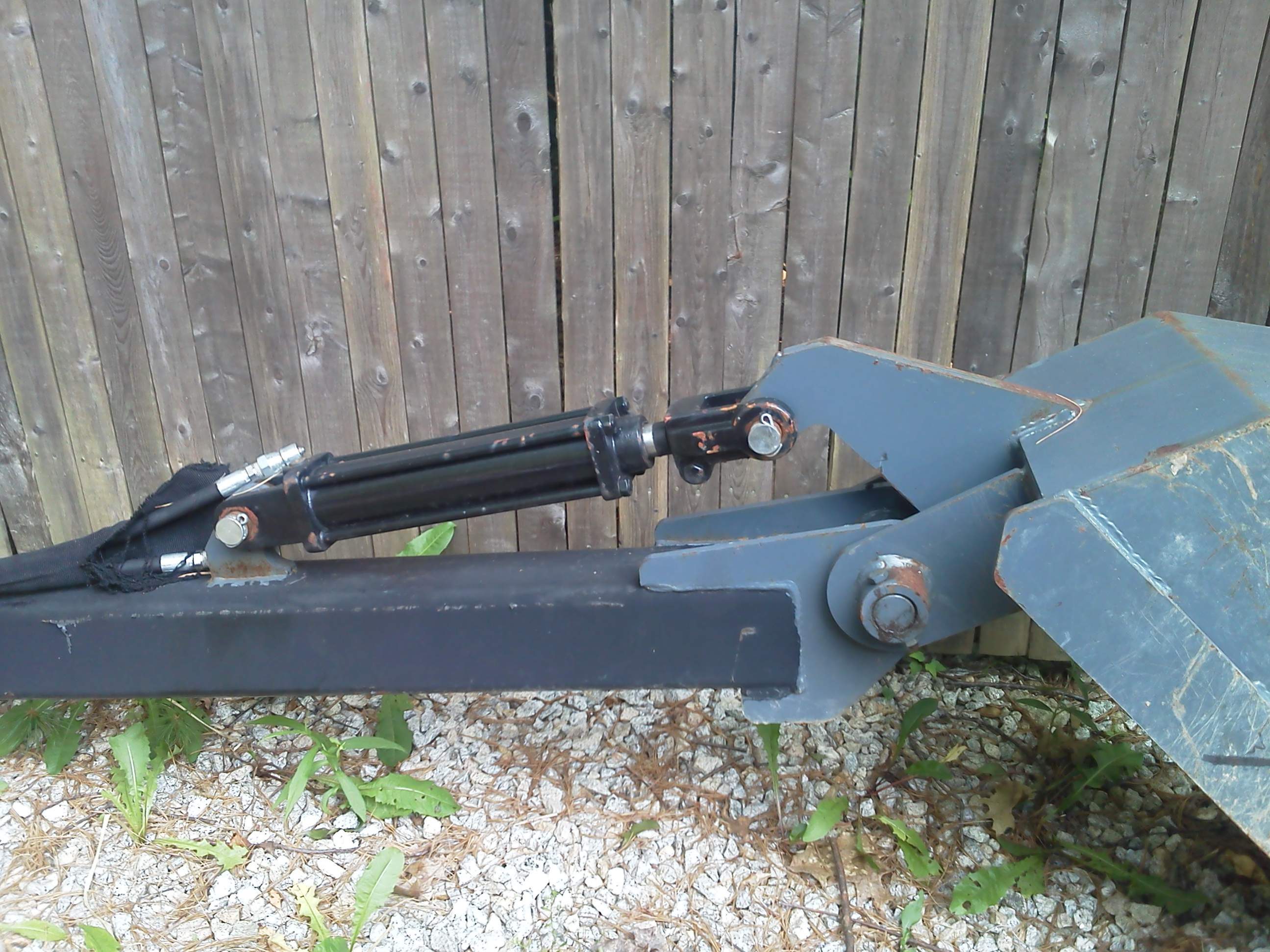

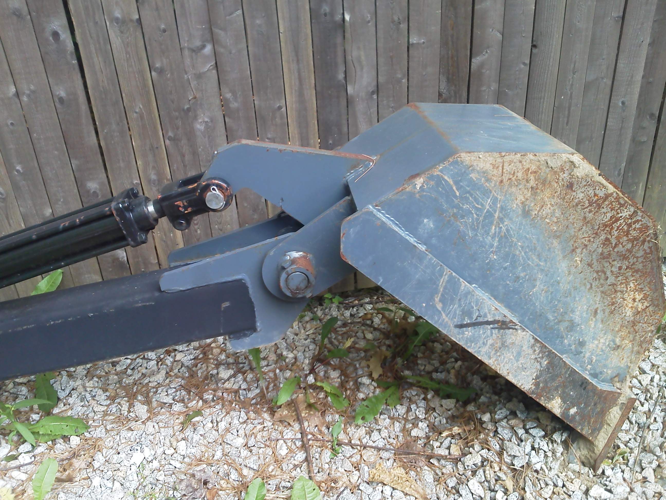

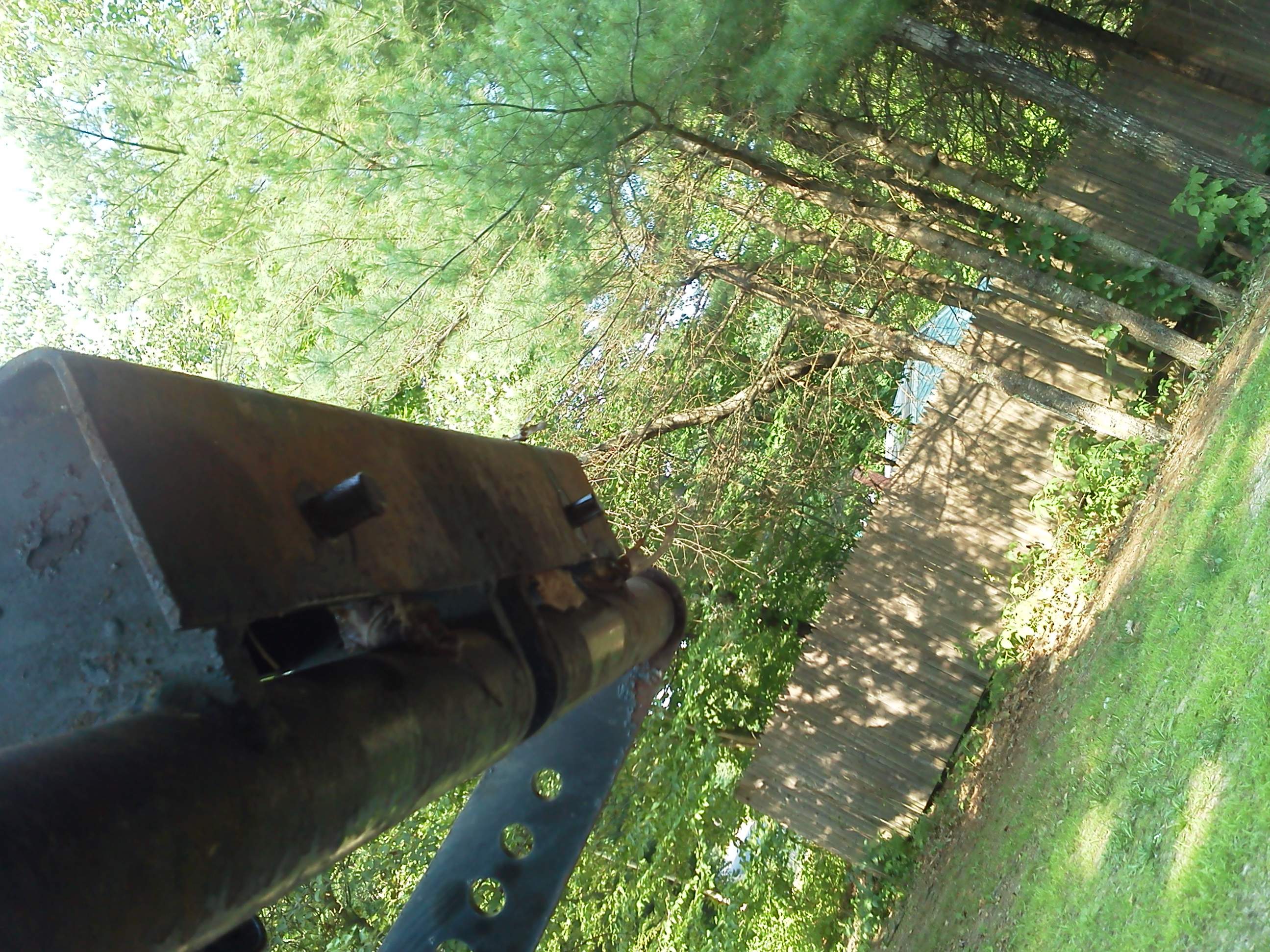

I took 3 pics of me undoing the disconnect so hopefully you could see how it works. They look like a pin sliced at a 45 degree angle except the bottom section of the pin has a hole drilled in it and the upper section has a pin that penetrates the lower pin and goes thru the lower pin and thru the quick attach plate and thru the loader buckets plate. I guess there are a lot of less complicated ways to accomplish the lacking of those pins, but it looks neat and you can rotate both handles out 180 degrees and they will stay there until you get the bucket attached/detached. I would put a flat section at the end of the handles rotation though so the handle would stay in the "UP" position with certainty. I took a ton of pics with my phone of both the trenching bucket and quick attach plates so you guys could look at them. Also the round holes in the bottom of the quick attach plates keep dirt from building up and getting packed around the pins. Freak I was hoping this was the lightweight option you were looking for.IMG_20120713_163329.jpgIMG_20120713_172359.jpgIMG_20120713_172329.jpgIMG_20120713_172321.jpgIMG_20120713_172254.jpgIMG_20120713_172247.jpgIMG_20120713_172237.jpgIMG_20120713_163805.jpgIMG_20120713_163746.jpgIMG_20120713_163737.jpgIMG_20120713_163708.jpgIMG_20120713_163538.jpgIMG_20120713_163532.jpgIMG_20120713_163525.jpgIMG_20120713_163510.jpgIMG_20120713_163441.jpgIMG_20120713_163424.jpgIMG_20120713_163354.jpgIMG_20120713_172429.jpg
