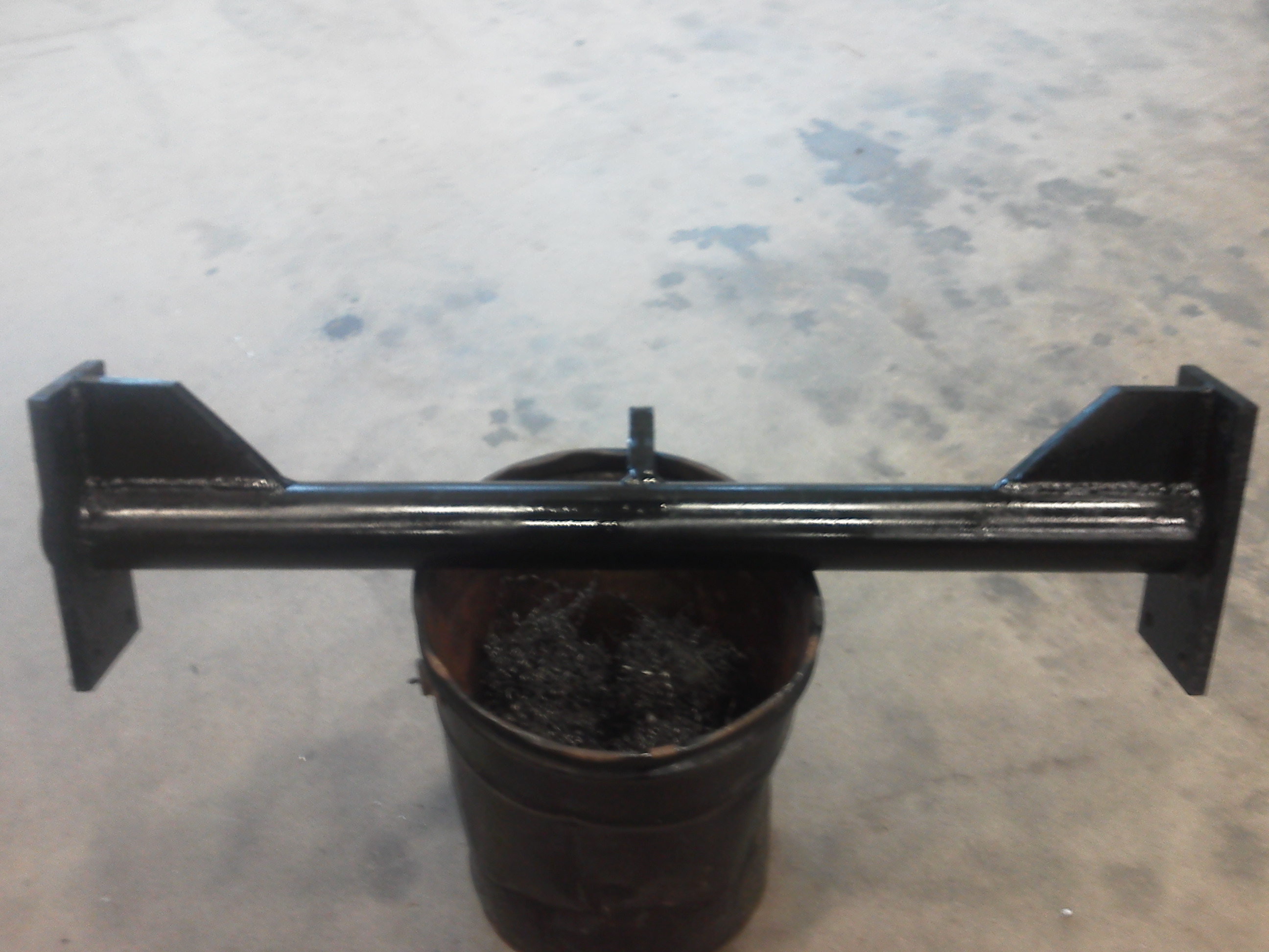

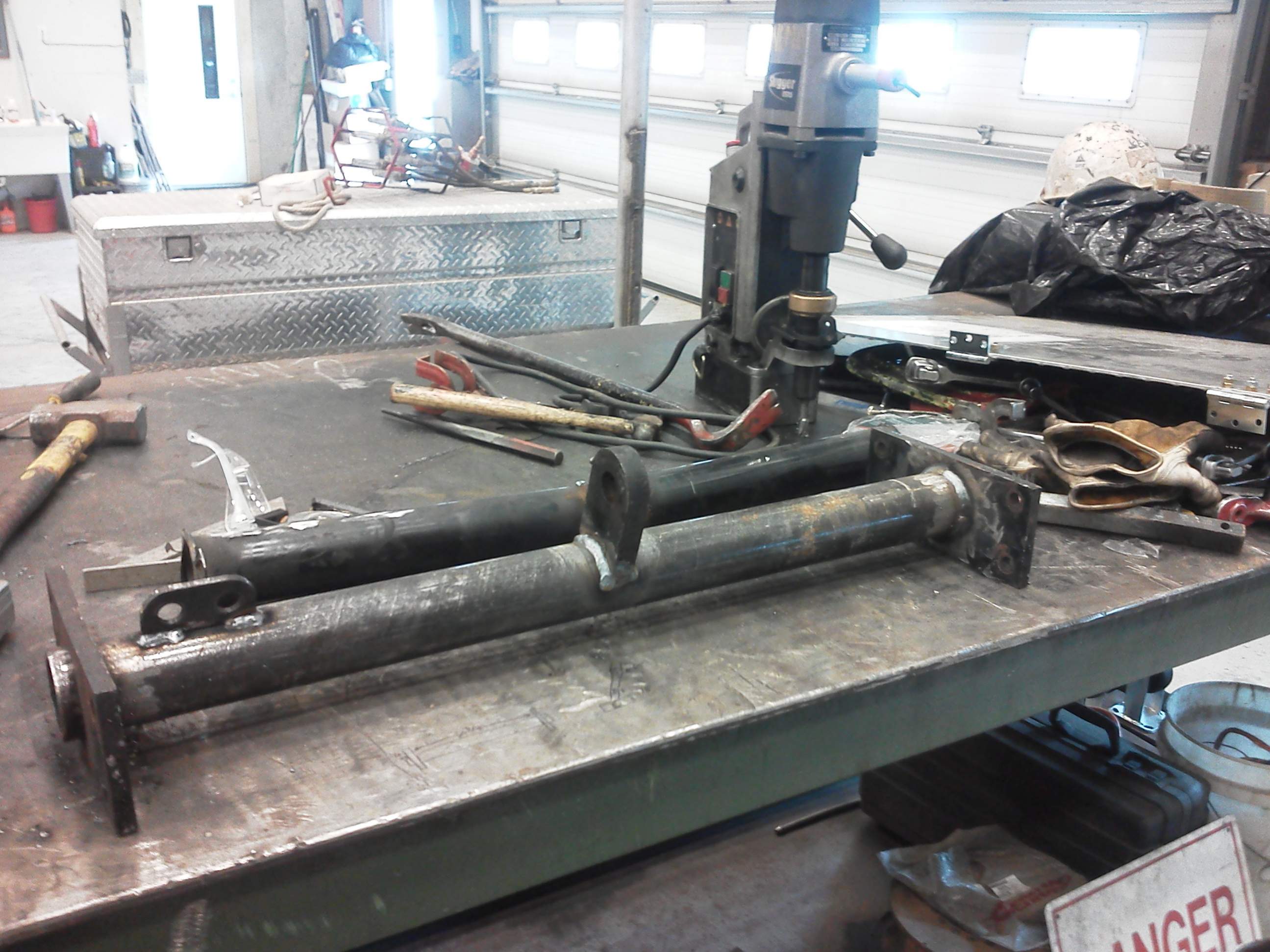

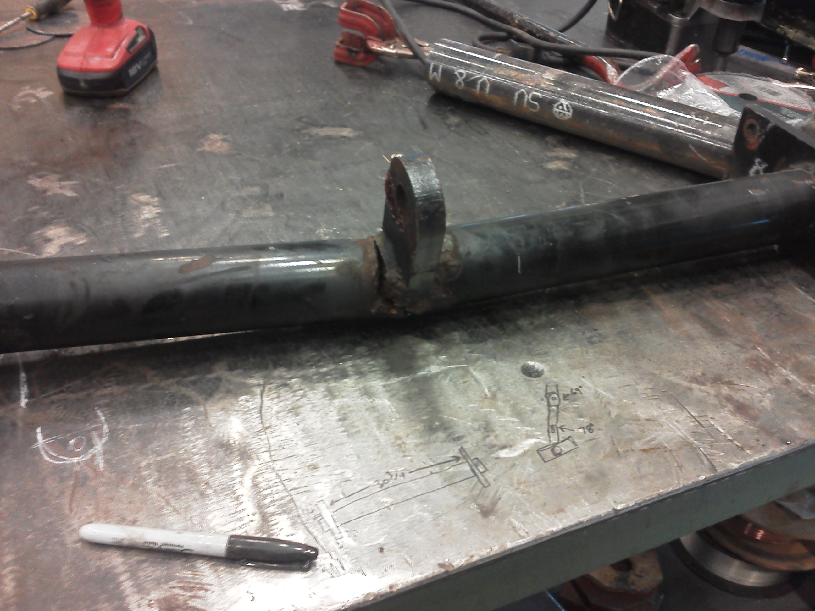

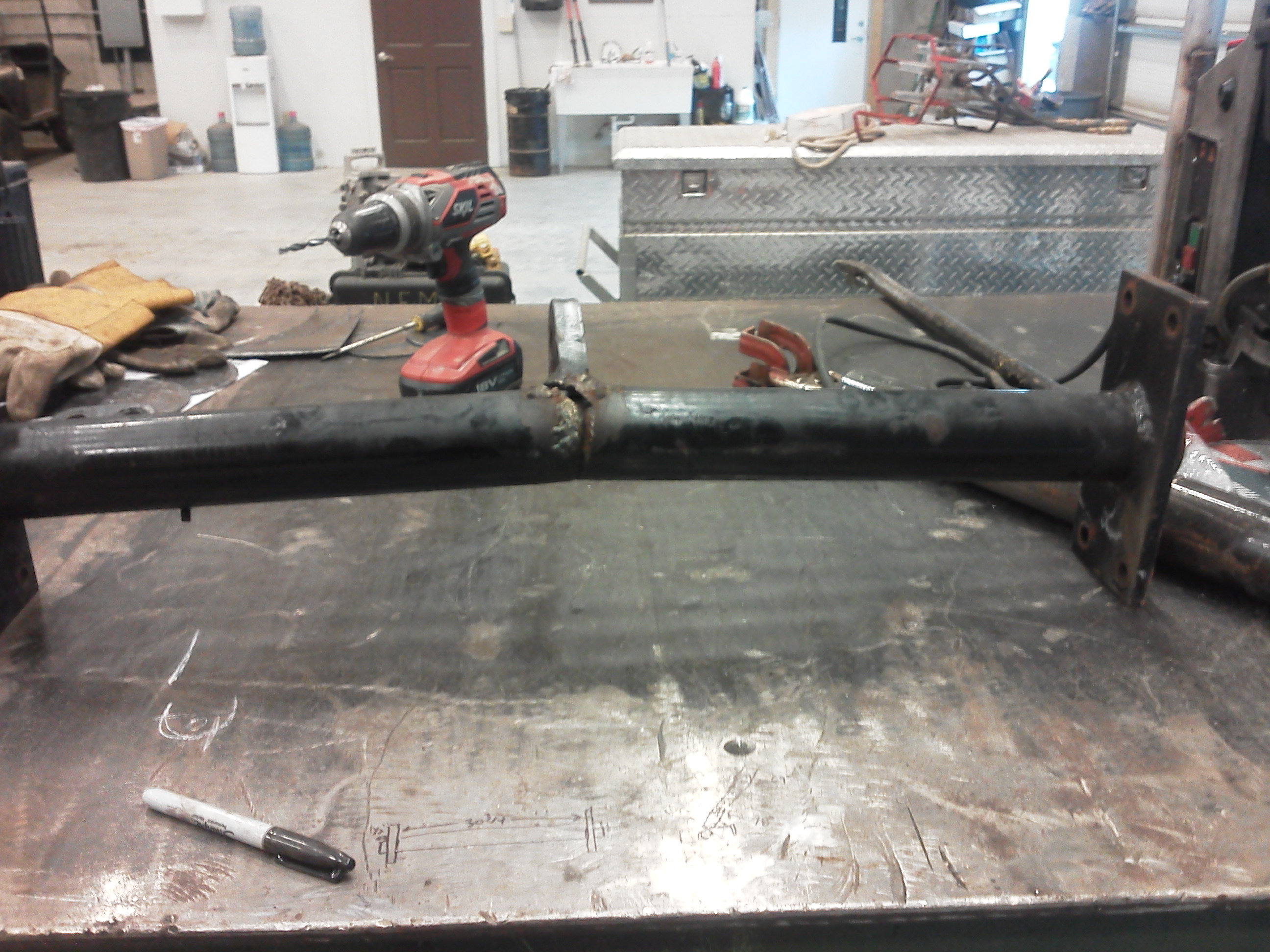

The loader bar for the top of my bucket curl cylinder finally broke the other day. Th previous owner had bent it, re-straightened a couple of times it looked like. He sleeved it with a piece of pipe but the metal was too fatigued. Here are some pics of the break, and the new one I made with 2 gussets of steel that were just lying in a scrap bin so I welded them on. IMG_20120728_135942.jpgIMG_20120728_135931.jpgIMG_20120728_144751.jpgIMG_20120728_152053.jpg

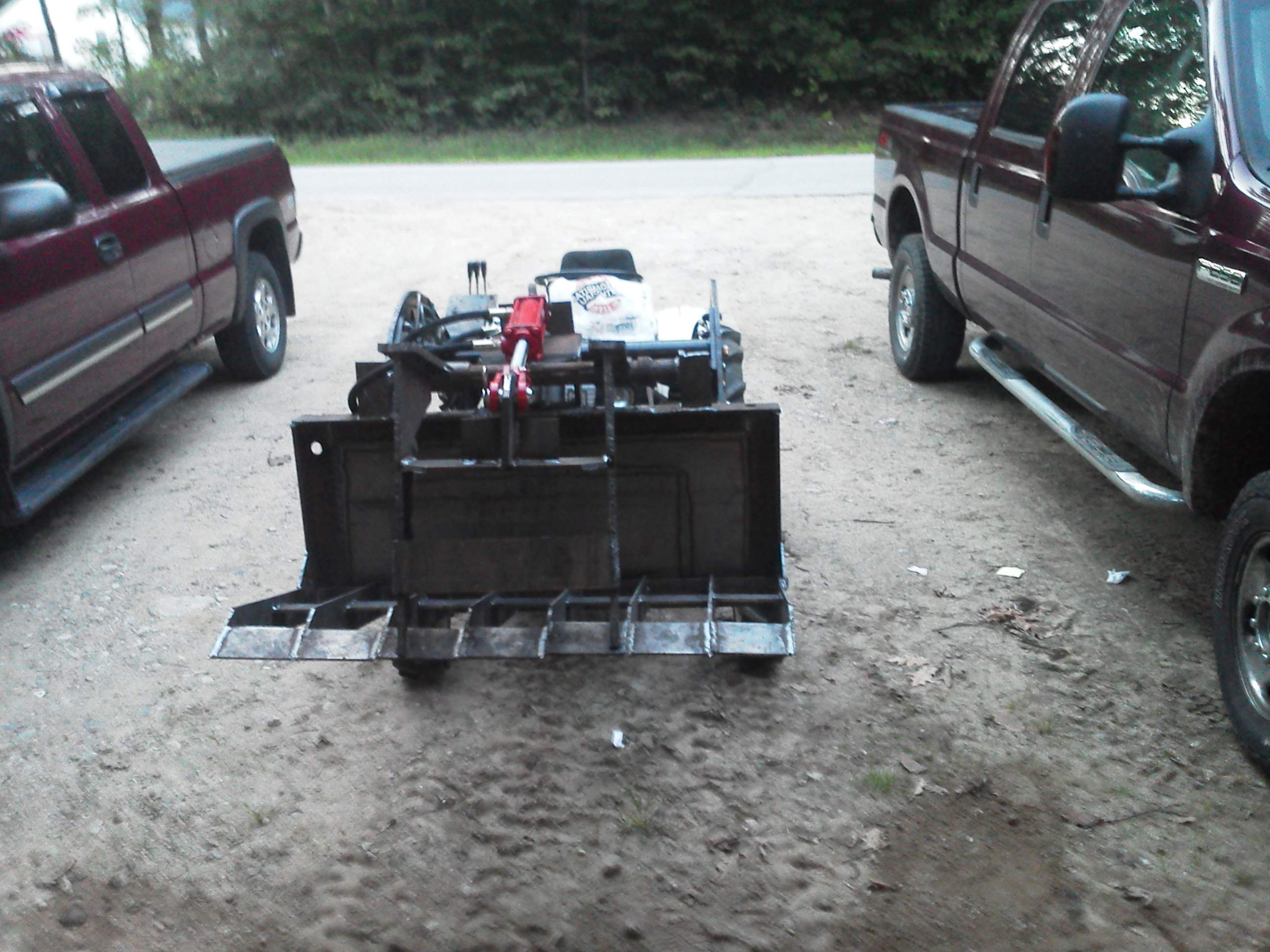

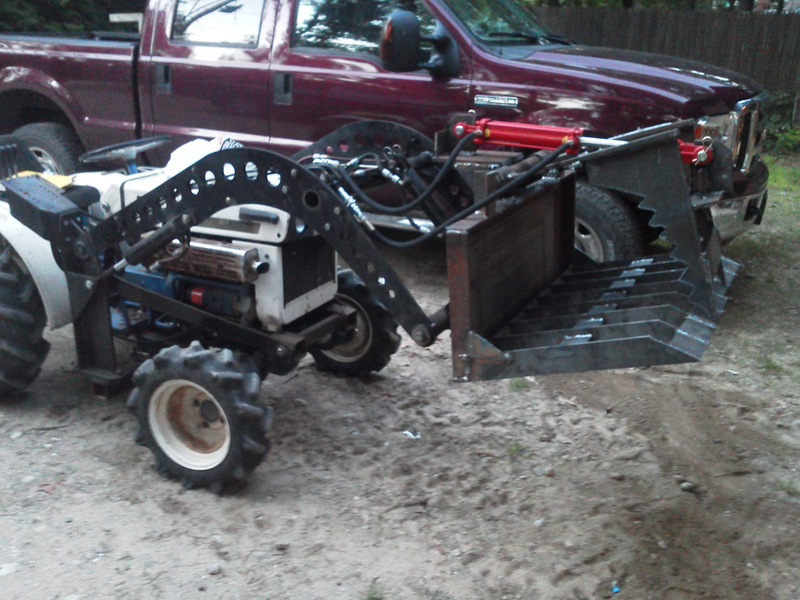

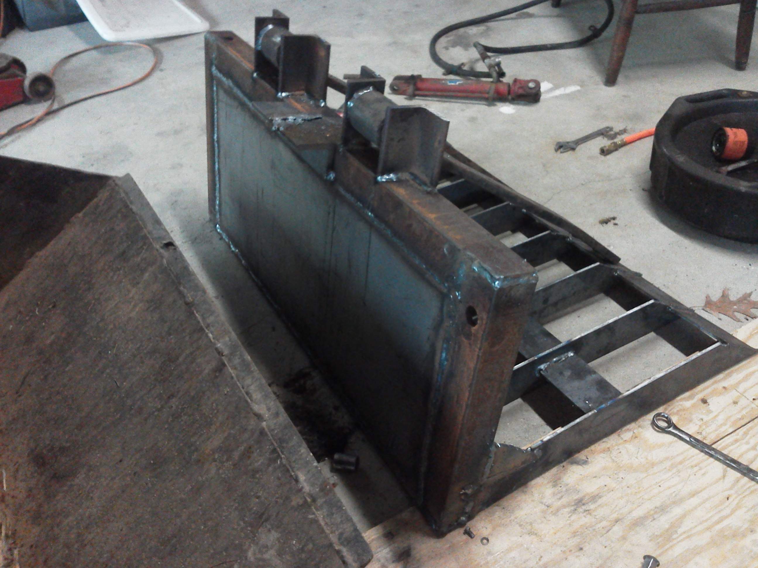

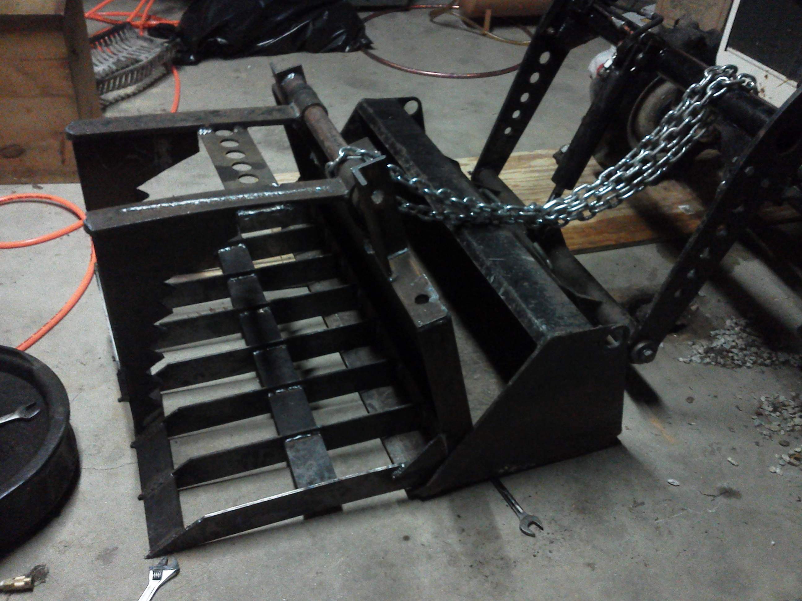

I am also starting to cobble together a grapple bucket. I am using steel scraps that are lying around. My lack of measuring, marking etc. are readily apparent in the pictures, I'm just winging it as I go. It is square though, I just got lazy and held the spacer tabs turned my head and started welding. Needless to say I'm embarrassed at my build quality, design decisions BUT I hope to be grappling brush in a couple of days regardless.IMG_20120728_191301.jpgIMG_20120728_191320.jpgIMG_20120801_133727.jpgIMG_20120801_203845.jpgIMG_20120801_203915.jpg
   / New 370D owner #35
Did you look at the grapple on my tractor? It's very much cobbled together. Angle steel that's a bit bent here/there with flat steel grafted on to extend the teeth. Not a "professional" looking piece at all.
But it works and that is what matters to me.
   / New 370D owner
#36

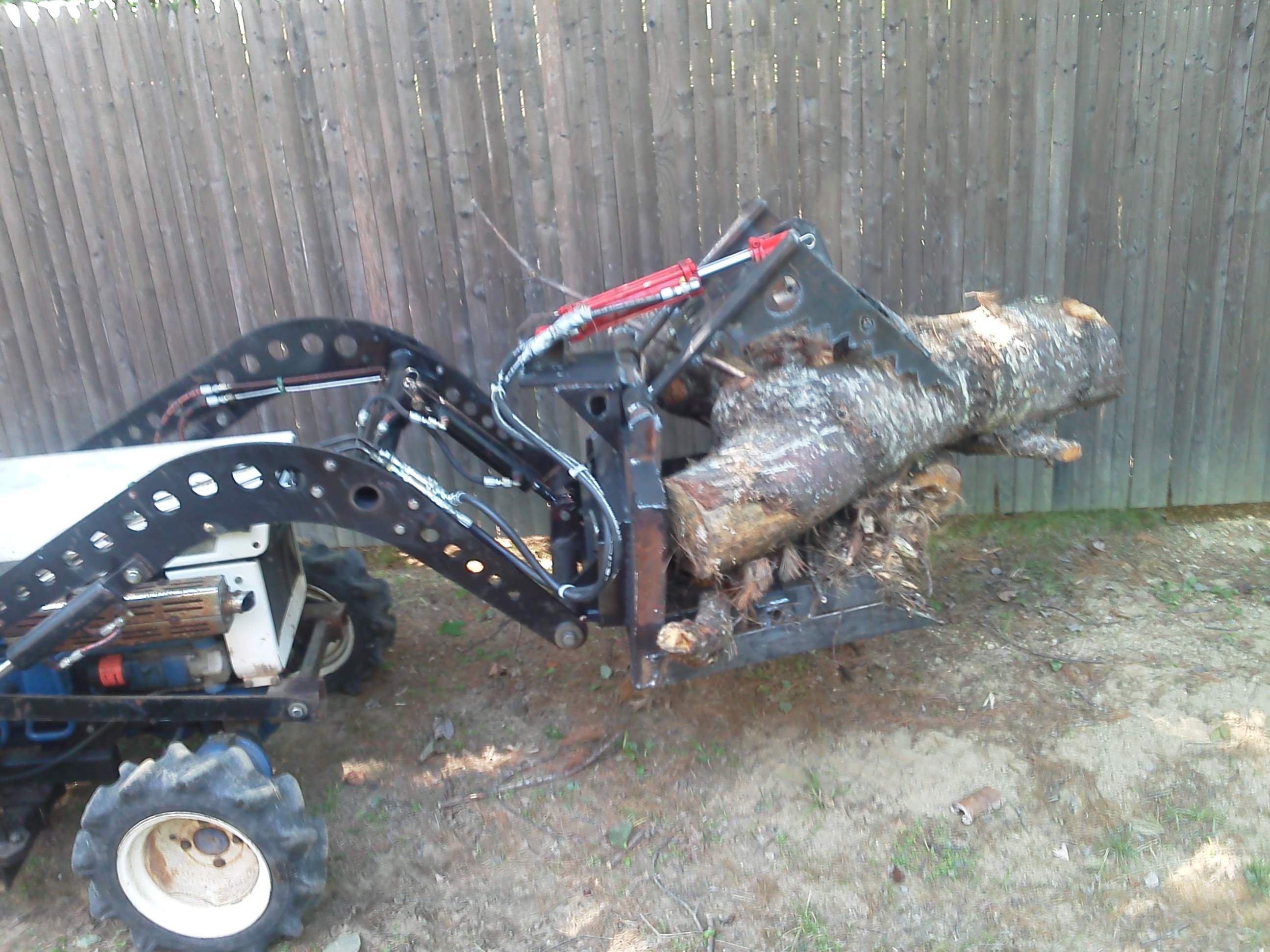

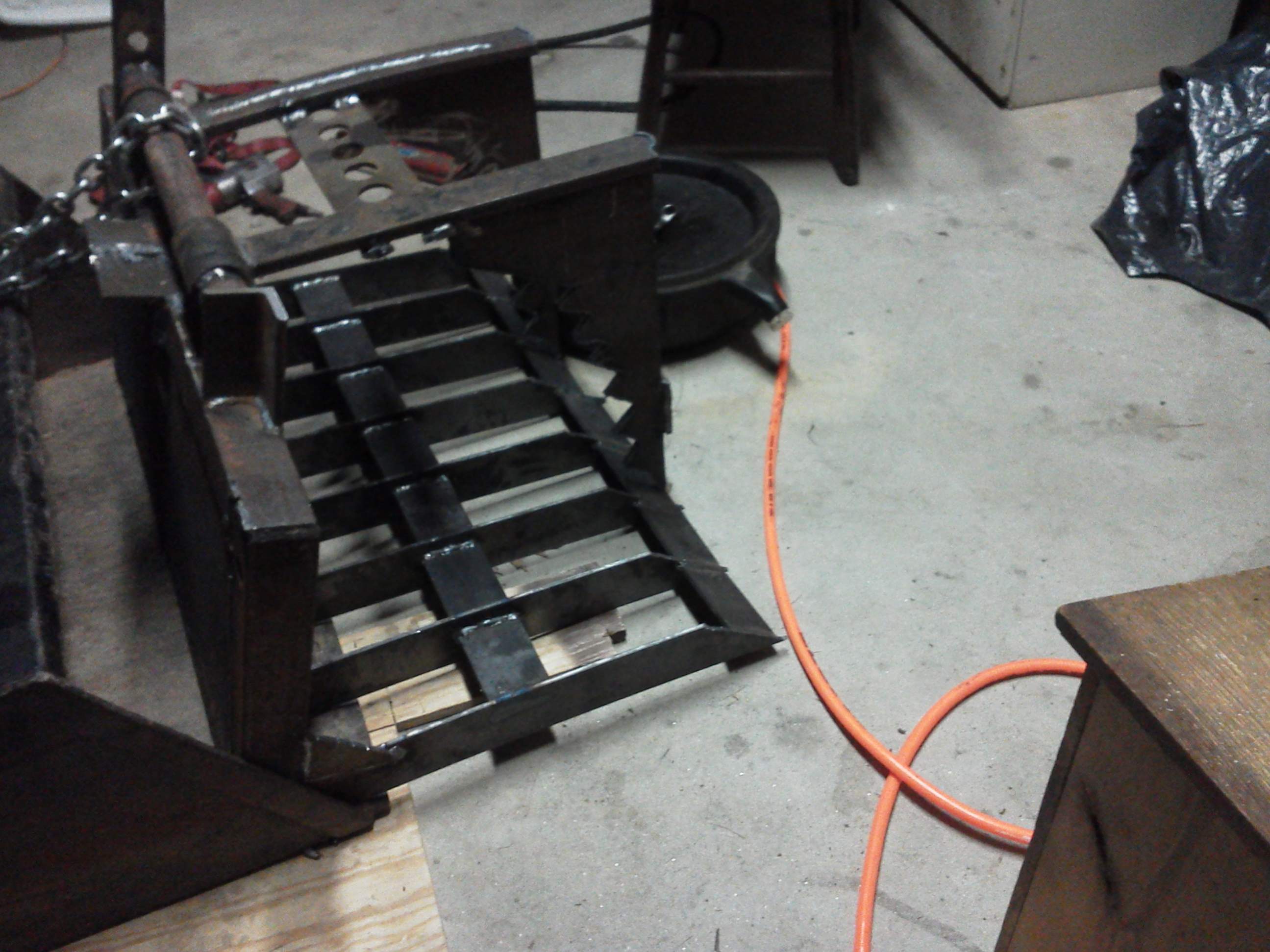

Almost done... When you're in the aisle buying hydraulic hoses 3' sounds like a lot, till you tilt the bucket curl all the way down.:rolleyes: It was getting late and I was getting frustrated so I had to put it up for the night. Stripped a hydraulic fitting etc. I was able to raise the grapple arm, looks like it's going to work great. The wife and 2 children allowed me to work on it til 7pm for 2 nights after work. So I actually only have 6 hours of build time into this thing. You should have seen the sparks flying! I would weld on pieces that were hanging over and torch off the overhanging parts, didn't grind a drop of mill scale or rust. I only knocked the torch slag off with a chipping hammer held the pieces up and tacked them, held a square up, smashed said piece with a hammer into the ballpark and welded them out. (I can't let the guy's at work see this thing:ashamed:) Tech thanks for the lift, you by far have the coolest tractor on here you bought it and have turned the key on it for what 30 years? Fixed what broke, made what needed makin', I love it. Have a good day all.IMG_20120802_200204.jpgIMG_20120802_200220.jpgIMG_20120802_200232.jpg

OK I just ran home at lunch and picked up some fittings for the hydraulics. It works good, need longer hoses, which I just had made and a couple of 90 degree fittings to come off of the hydraulic cylinder. I need to gusset the top piece of angle on the bucket; I clamped the grapple onto a log and could have rolled the top of the bucket right over. it is pretty heavy even though it is narrower than my tractor bucket slightly. But there is still a lot of capacity left. But with brush and things this thing is going to be great. I'm going to take the torch to it and lighten it up here and there. I'll put in on the scales before and after for a comparison.

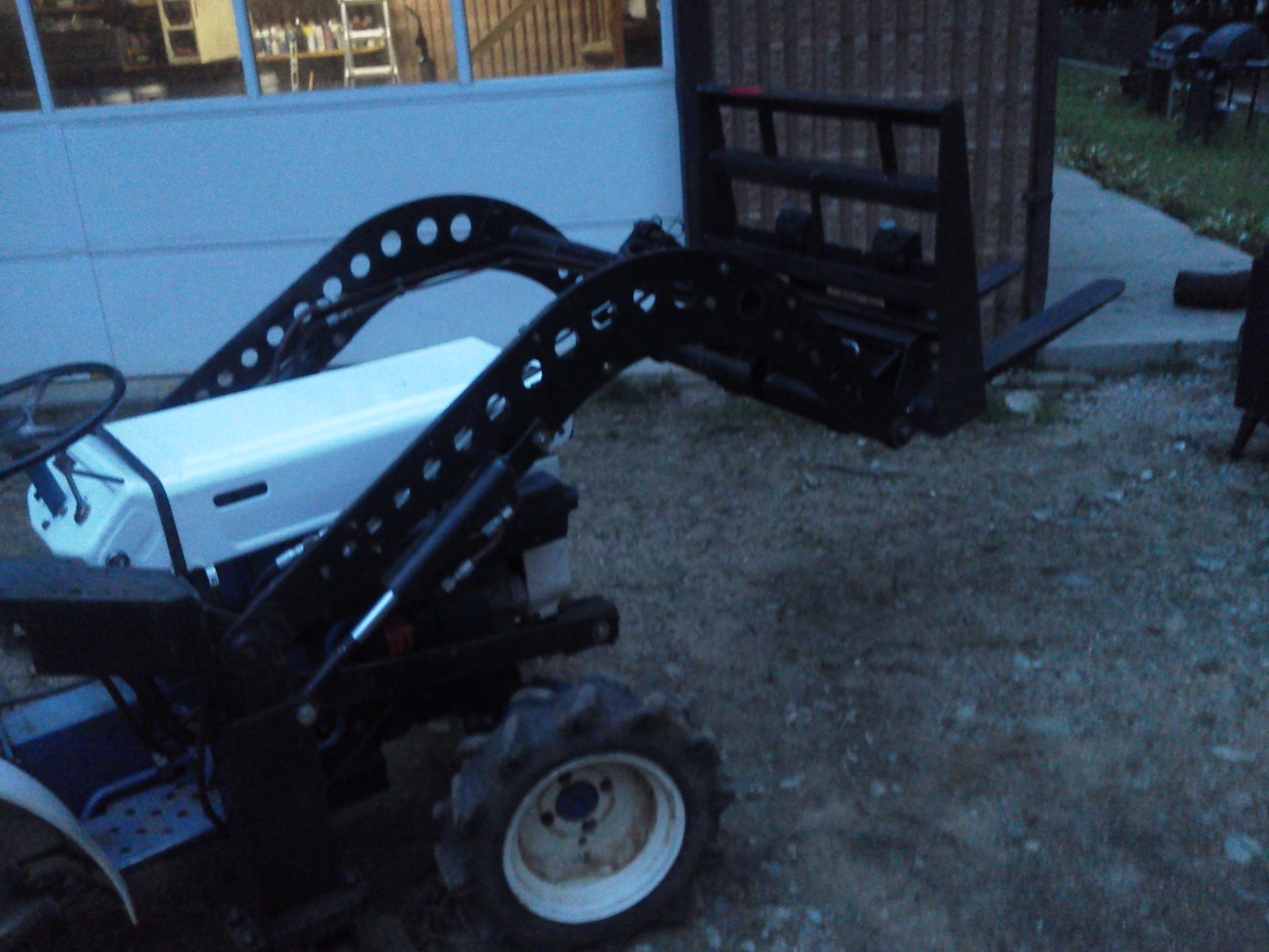

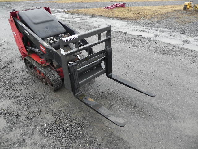

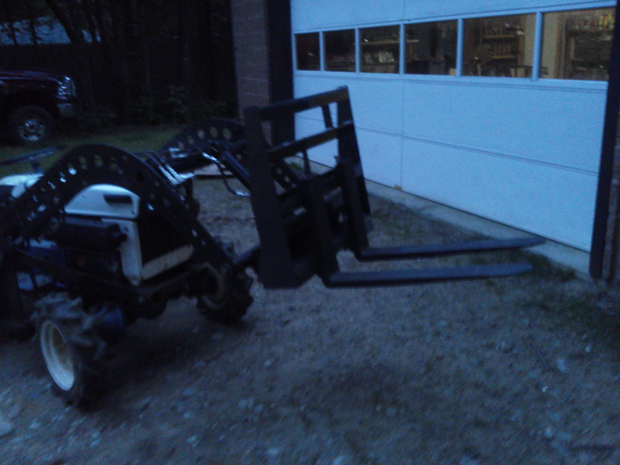

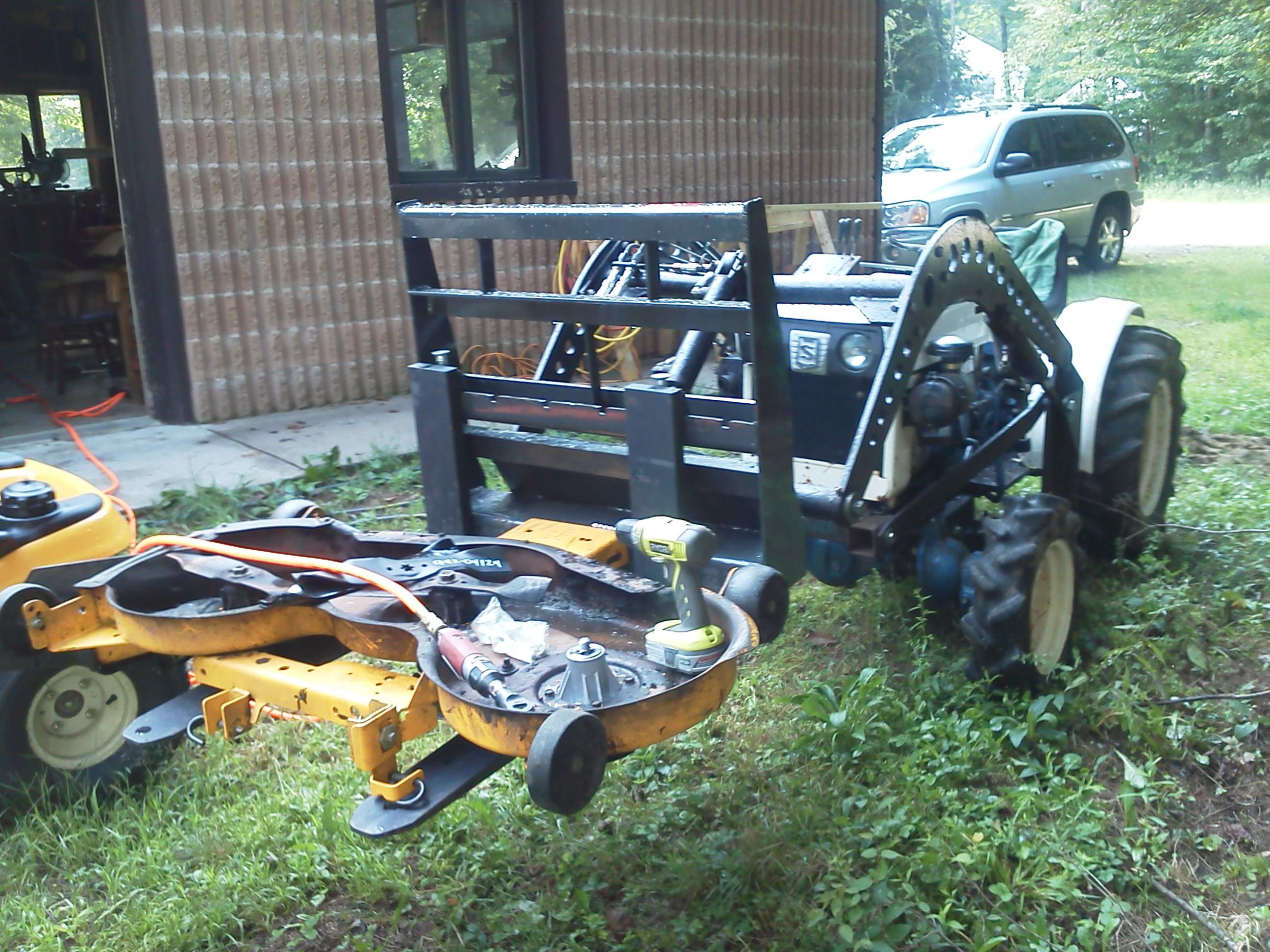

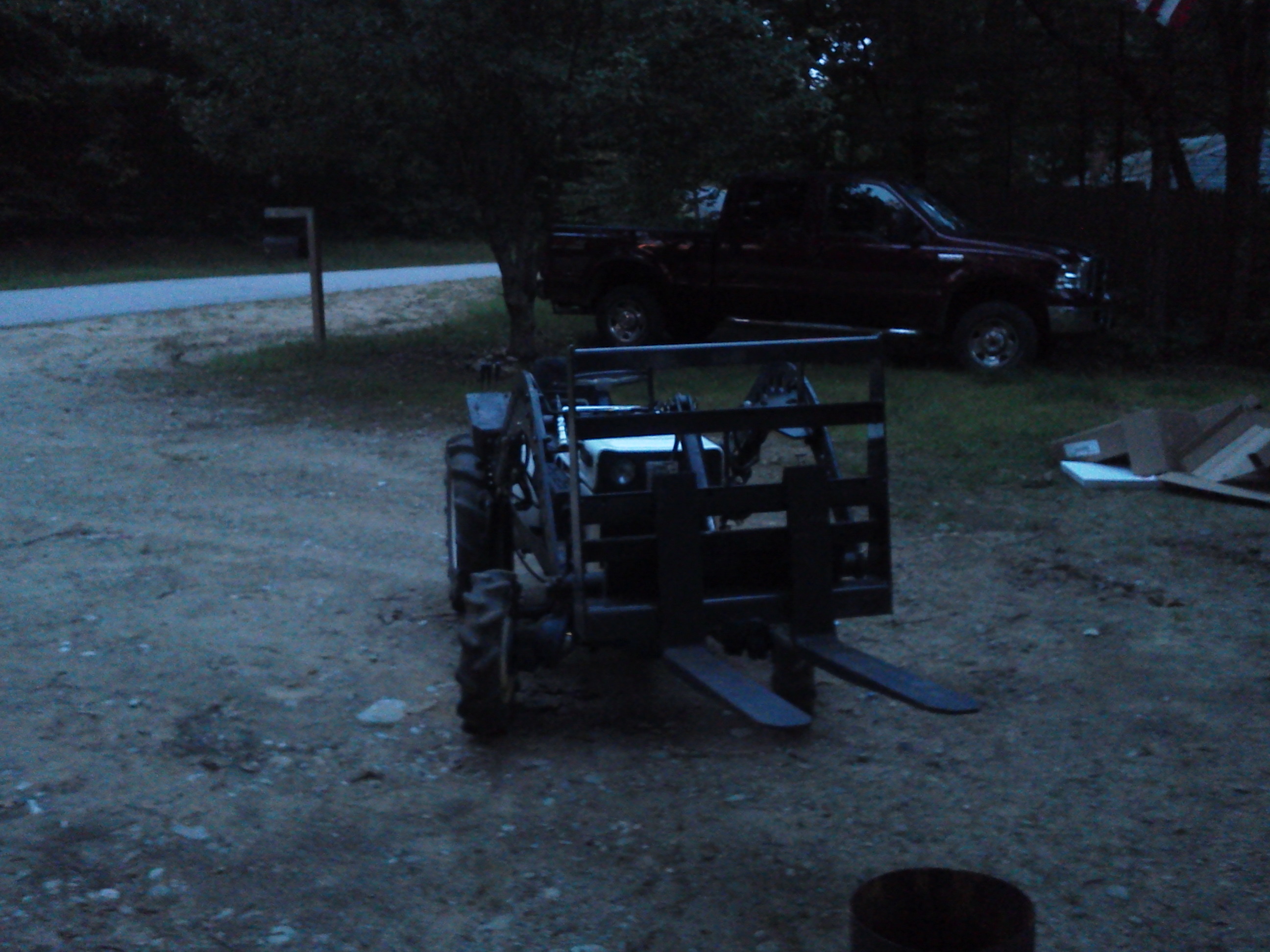

Just ordered these forks, I saw a set on a job site in Mass.which led me to 2 conclusions.
1.The quick attach on my tractor is a Dingo or compact bobcat type.
2. Dingo attachments are perfect size for my tractor. These forks have a lifting capacity of 2500#. The set I saw on my job site were very light weight looking. I found these on e-bay selling for $550. I clicked the make an offer button and offered much less and he accepted.
I'm assuming that the hydraulically powered Dingo attachments would be more than our tractors hydraulic pump could push however. Is this true? I saw a hydraulically powered snow blower, stump grinder, brush hog etc. dingo forks.JPG
