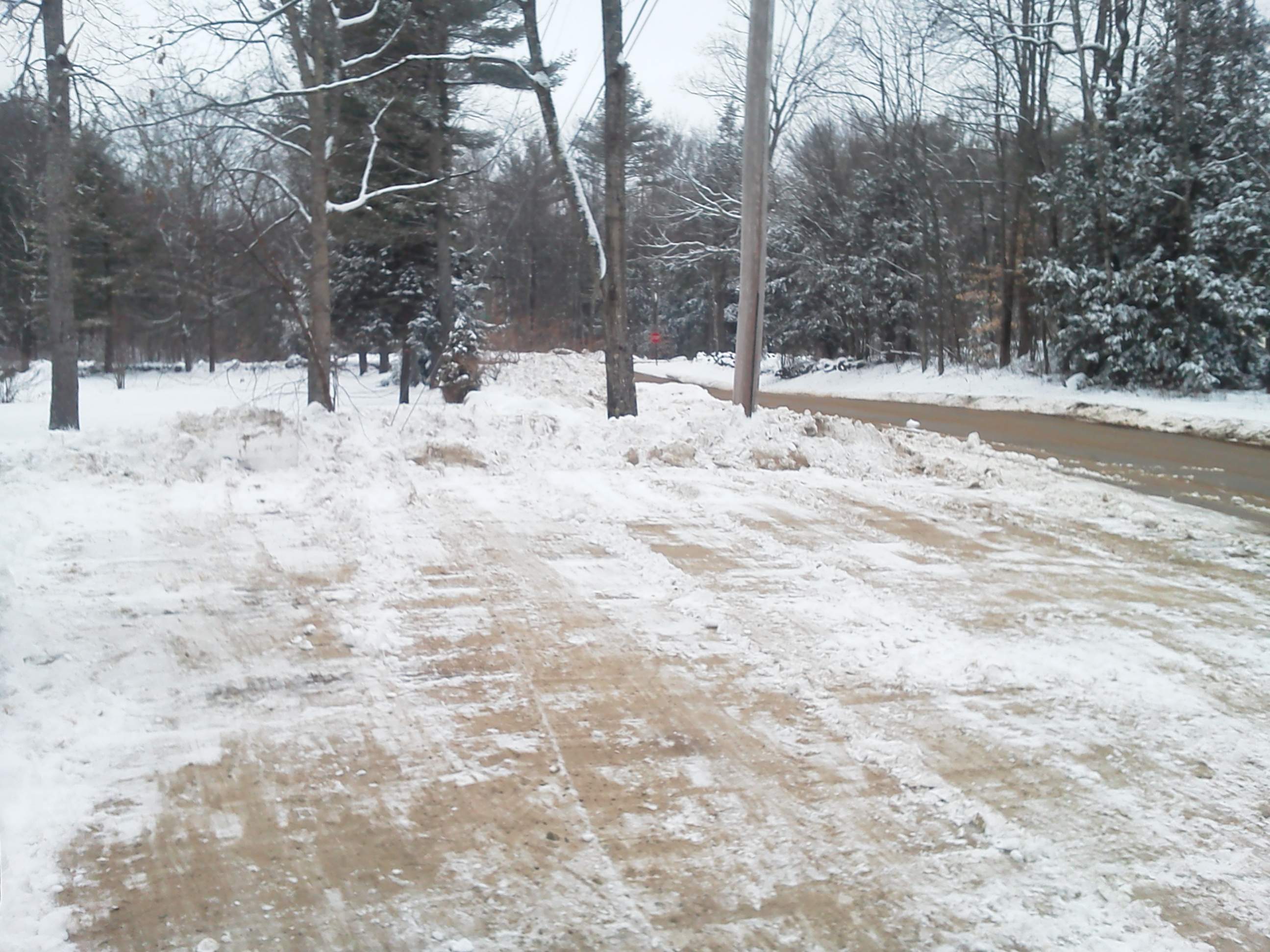

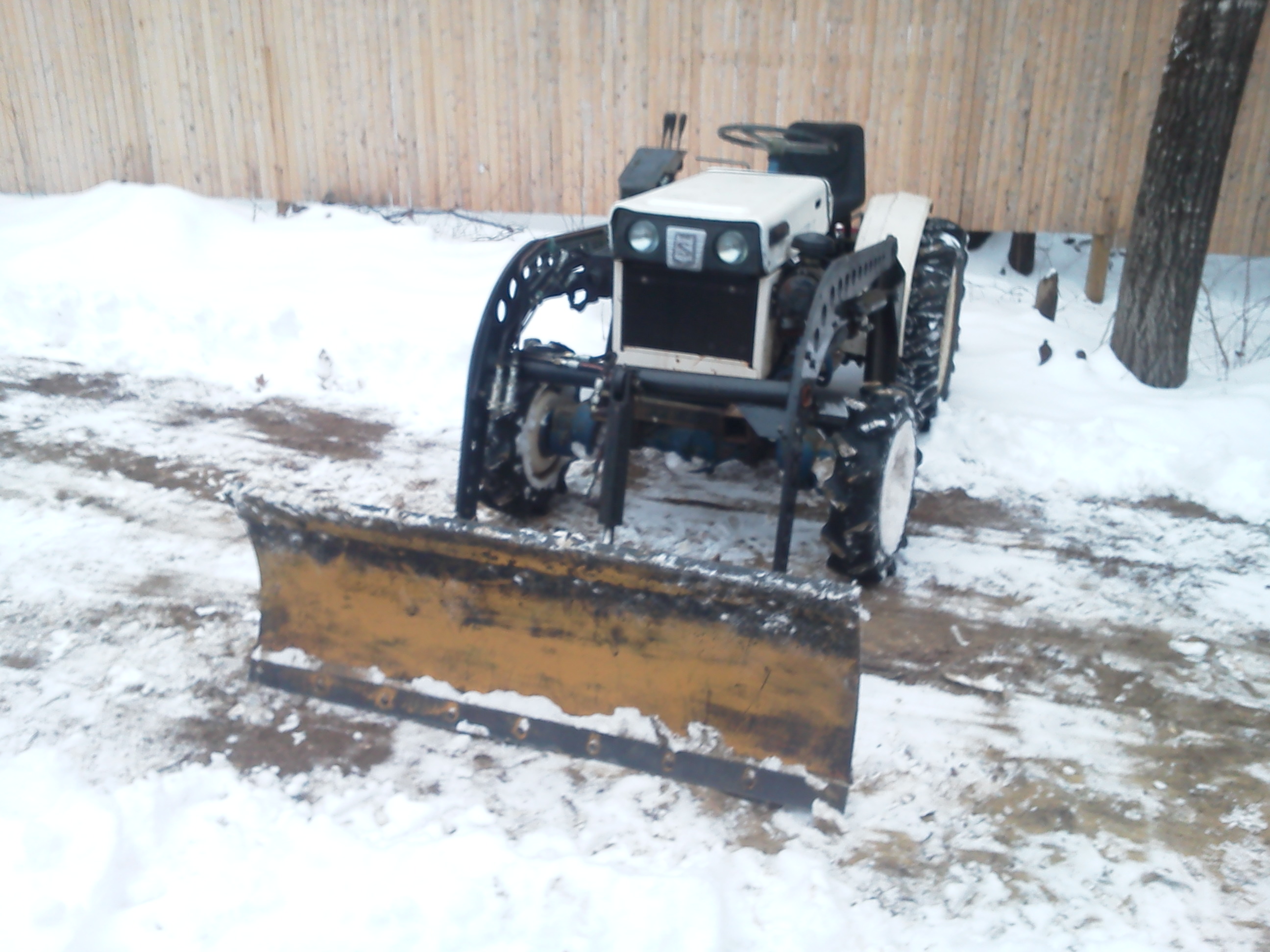

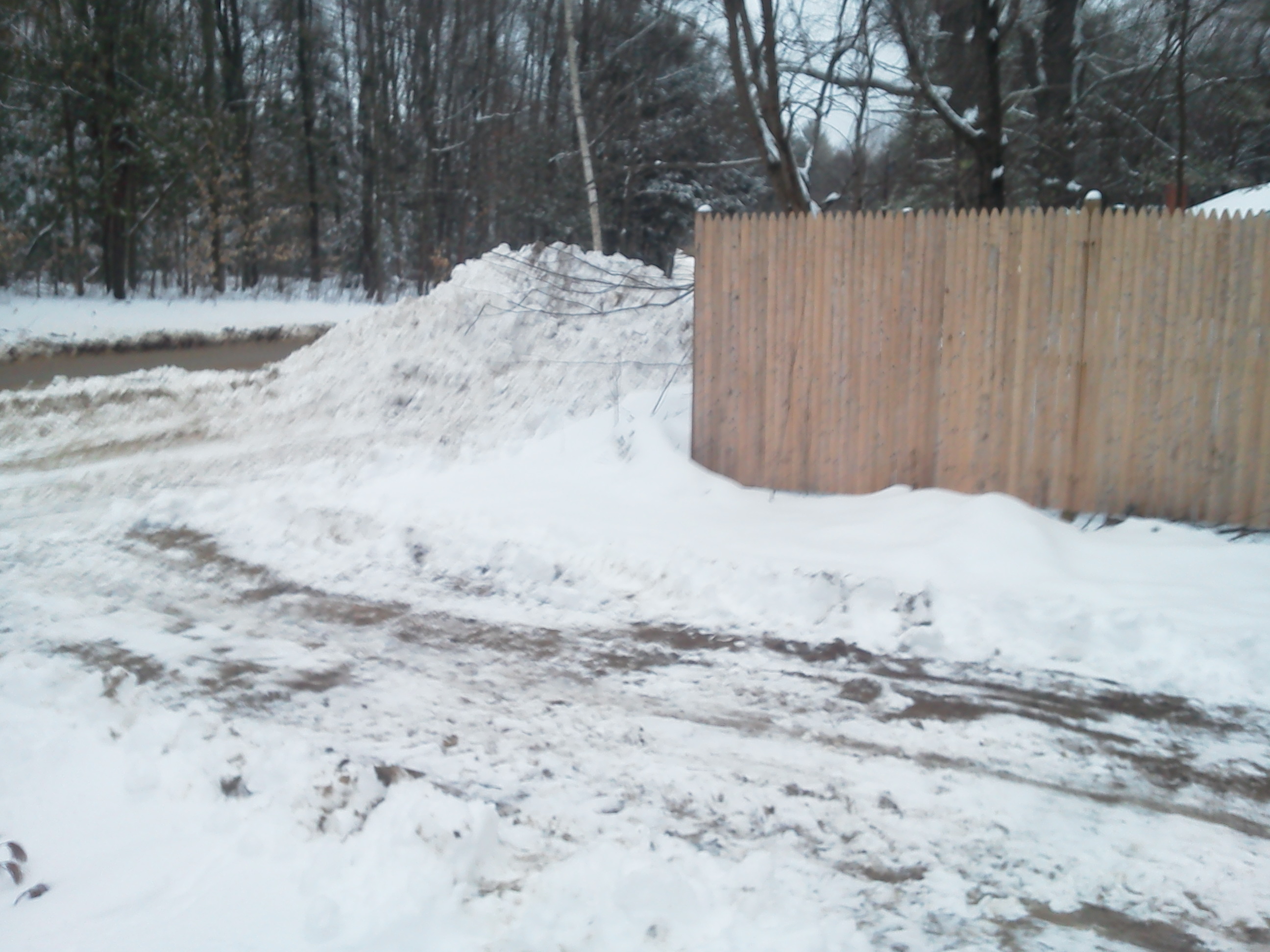

I got to try out the snowplow blade I cobbled together, It works perfect. It think the blade came off an older Lawn tractor it's very heavily built. I can't believe how easily this tractor pushes large amounts of snow. I will definitely do a couple of modifications in the Spring. Hydraulic angle for the blade and widen the blade. I have a question about the differential lock by the foot board of the tractor. I was just reading the owners manual and it says that it is on a spring and you can lock and unlock the diff. The one on my tractor is laying right on the floorboard and I have tried to lift it up out of curiosity before and it wouldn't budge (I had no idea what it was for until a few minutes ago). If the diff is locked all the time is this a problem? I have never noticed any problems with the operation of the tractor.
