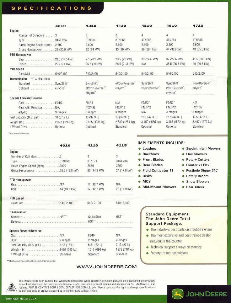

Got to play a bit with a brand new 4110, just briefly after they pulled it out of the shop. I assume it's a lot like the 4010, but they didn't have one of these yet. They gave me the specs from a sheet faxed to them by JD (they didn't have any lit yet..nothing!) the 4010 has a Hydro transmission, 18HP engine, 14 Hp at the PTO. Maybe a bit smaller overall, at least to me, than the 4100. I'm a bit baffled on why they put such a small engine on it on a tractor with a bigger frame than the Kub BX(just 14HP at the PTO, with a lot of the competition coming from the BX with 22 HP and 17 at the PTO. Seems they had a big opportuinity to take the spotlight away from the BX, and they may have blown it. By the time you get equal power (adv HP) you get into a lot more money than the BX.

Ok, I got another close look in warmer, dryer weather. I also got ahold of a spec sheet on the new tractors, so check it out. Still don't have dimentions and some other specs, but it's more than I've seen anywhere else.

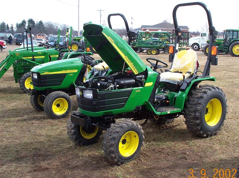

Picture of JD 4110, 4115, & 790...
{see attachment}
