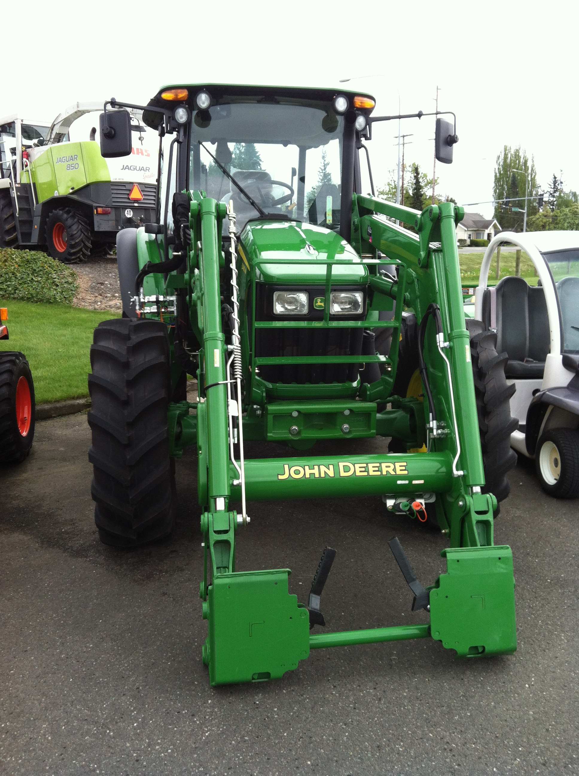

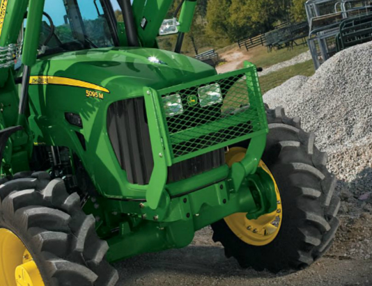

I have a couple of more questions I would like to ask:
First:
Here is a picture of my tractor, and another from a JD brochure. It seems to me that my grill guard is larger and doesn't seem to fit the tractor as well as the one on AKfish's machine. Maybe pclausen knows if John Deere has changed to this style with the H260, or if the one I have is not standard. I kind of like the look of the one with the expanded metal in it. Actually, the best looking one that I have seen is on Caledon Hills tractor. I wonder where he got his?
Thanks,
Island Farmer

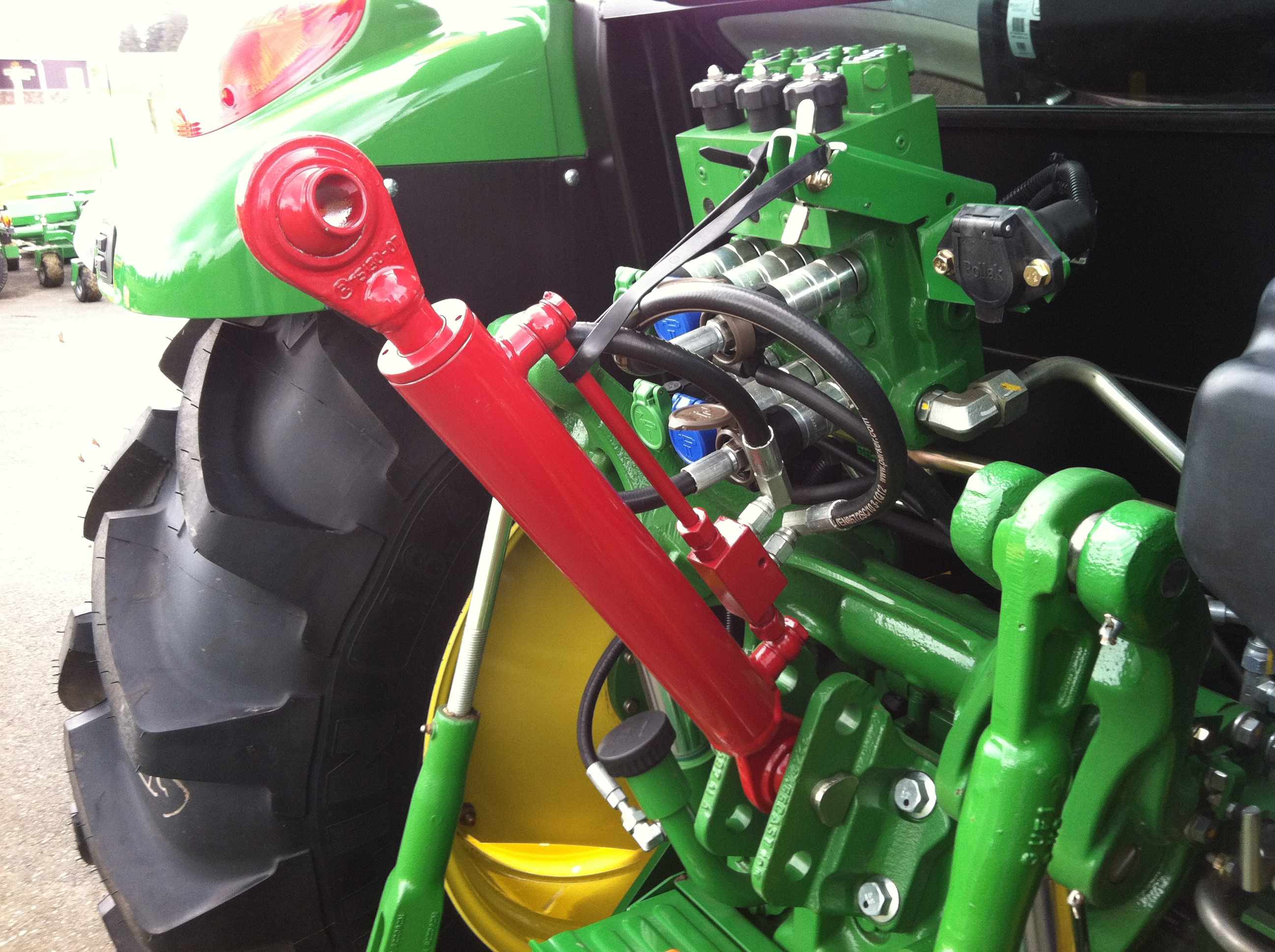

Here are some pictures of my hydraulic top link. I don't have any experience with these. What do you think?
Thanks,
Island Farmer

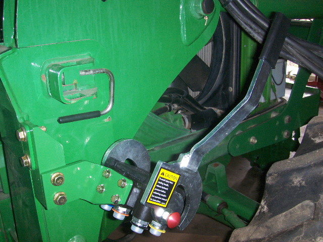

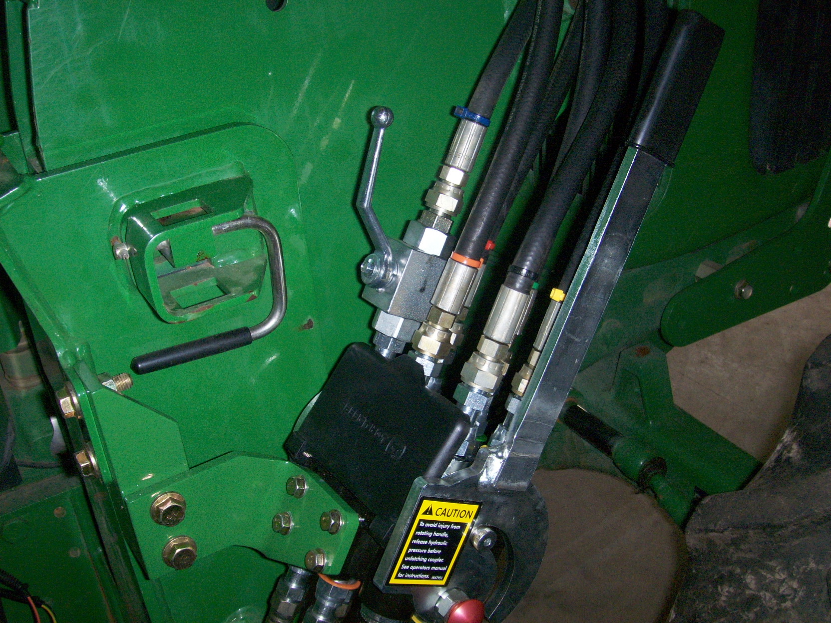

I don't think there is a choice in the Multicoupler mounting (unless you are building your own bracket) I mounted mine with the handle out because that's how Deere did it on the 640 loaders. I like the way shown in post 251 with the handle forward. It sticks out less and being right handed it looks like the swing of the lever would be easier for both couple and uncouple. IIRC I'll gain almost 3 1/2" clearance if I turn mine 90 degrees (lever forward)
I even took the handle off and straightened it to gain clearance. (see the bends in first picture)

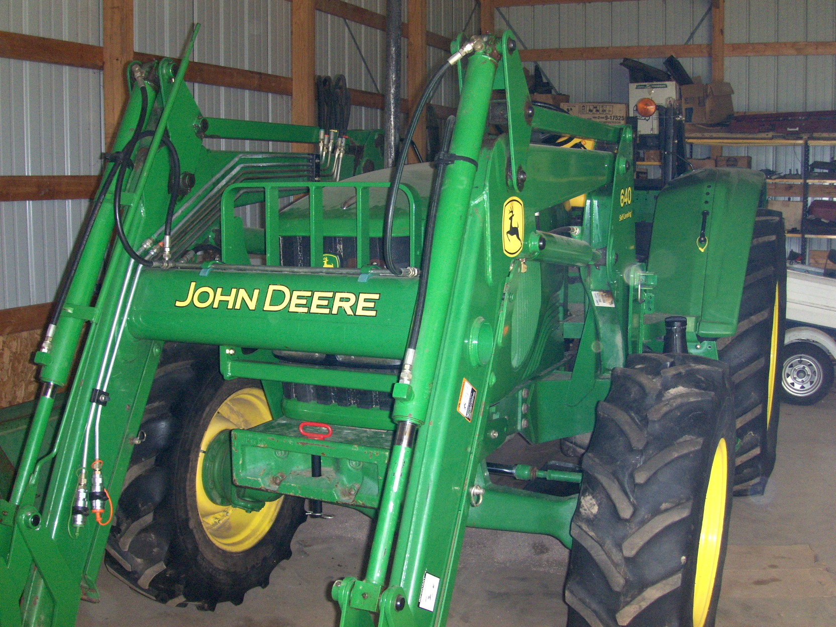

I actually like the guard in the first picture the best, it's taller and will protest the hood better. You should see the second pictured guard without the mesh brush guard installed. Do you have a picture of Caledon Hills guard?
JD offered a HD guard for the 673 loader that I liked better than the one that came on my 6415. They offer the mesh guard for it too (on my wish list). So I bought the guard and swapped. Weighs about 50lbs more than the original one.
It has larger side plates. A 2" x2" crossbar, the folding part is larger (taller), and the latch has been moved from the right side to the left (same side as the hood latch).
