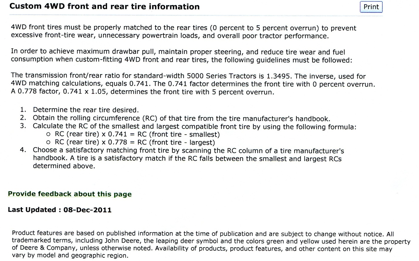

I don't have a great deal of "knowledge" regarding overrun - beyond the difficulty shifting in and out of 4x4 - when you approach the upper 5% boundary.
I switched back and forth with different tire/wheel combos on an older, 4x4 tractor that I used to own. The greater the overrun - the more "crabbing and grabbing" occured with the front wheels when using 4x4 and the harder it was to shift in/out. Especially - out!
Everything is a compromise... floatation versus traction; stability versus ground clearance, etc.
Shoot for something in the middle --- call it good! :thumbsup:

AKfish,
Thank you for your input. That is very interesting regarding the "crabbing and grabbing" when you have too much overrun. I wonder what happens in your case, or possibly mine if I go the way I'm leaning, we would both have about .25% overrun with new tires. The thing is that eventually those fronts will wear and we will have less overrun. I would assume eventually maybe some underrun. I guess the bright side is that with less overrun to start with, there may be less rapid tire wear. When we go below 0% overrun though, it would seem that we would have much less pulling/traction.
I also appreciate your sentiment of do your best and then keep moving.

My 6415's owners manual states Ratio of front to rear tires is precisely determined to produce positive front wheel lead of between 1.5 and 4 percent.
"Otherwise the tires will become deformed or suffer undue wear."
MY thought/opinion is this lead is for steering control. The front tires will never be lagging and will be able to pull the front end in the direction the operator steers. When going straight they will have the 1.5-4% slippage since they are going slightly faster. This just my opinion. I would love to hear the technical reason(s) from an engineer! :)
I am thinking less than 1.5% and steering will be difficult. Over 4% and wear will be faster.

I am still struggling, trying to come to a decision about what to do with my tires.
In your case, I think that you said that you decided to get the standard non-radial tires so that they would be easy to replace in your rather remote location. I think that they are the Goodyear 11.2/24 Dura Torque TL in the front, and the Goodyear 16.9/30 Dura Torque TL in the rear. If this assumption is correct, I calculate that you would actually not have any overrun of your front tires at all, but instead have a slight underrun. Based on what I have assumed is your rear tire, we would have 175" rolling circumference times .741 (for zero overrun) which equals 129.67. Your front tire when new had a rolling circumference of 129", which would produce a slight underrun. I think that it is possible that this is the cause of your steering issues.
What I just cannot understand is why John Deere gives these recommendations, and then sells new tractors and installs tires on them that, in some cases, do not follow their own guidelines. For example, my tractor came from the factory with the 12.4R24 / 18.4R30 combo. If you calculate zero overrun you get 136.34", and the 12.4R24 is 136". Generally our front tires wear faster, so starting with almost no overrun doesn't seem desirable.
Let's consider pclausen's sexy new 2012 5085M freshly delivered to the dealer today. He ordered the 13.6R24 - 420/85R34 combo which produces an overrun of smack dab in the middle of JD's recommendations: 2.5%.
I would like to go with the 18.4R30 in the rear, because although it is shorter than pclausens's rear tires, it is wider and has a larger flat plate, but the only reasonable front tire choice would be the Multibib 440/65R24 which is 17.3" wide. So, do I choose the Michelin Multibib 440/65R24 front and the Agribib 18.4R30 rear, or do I choose the 13.6R24 - 420/85R34 combo that pclausen has and is a factory option on the 5085M, that is the question..................
I must say, I am a little punchy at the moment, been working way too many hours. So, sorry if I am no longer making sense. I have't seen any posts from Caledon Hills lately, but I wonder if he has many slopes to contend with? The 14.9R24 - 18.4R34 combo that he has, and that I got just feels too big and tall for working in tight places, or on even moderate slopes. Well, back to work for me. I wish that everyone has a good rest of the day, it is beautiful here on the island.
