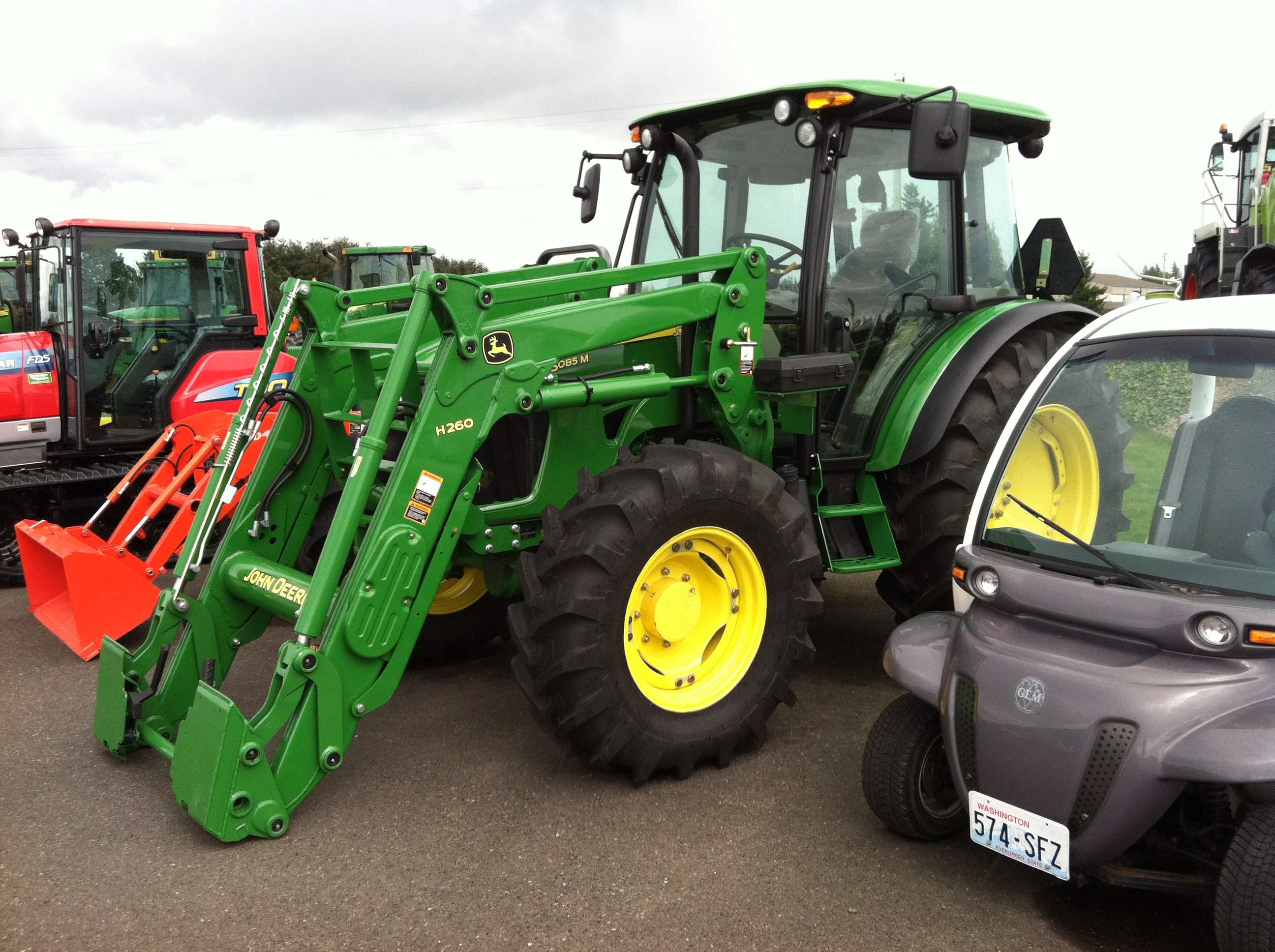

Here are some pictures of my hydraulic top link. I don't have any experience with these. What do you think?
Thanks,
Island Farmer
What's the bore? I am planning on 3" for the 6415. Needs some green paint!:laughing:

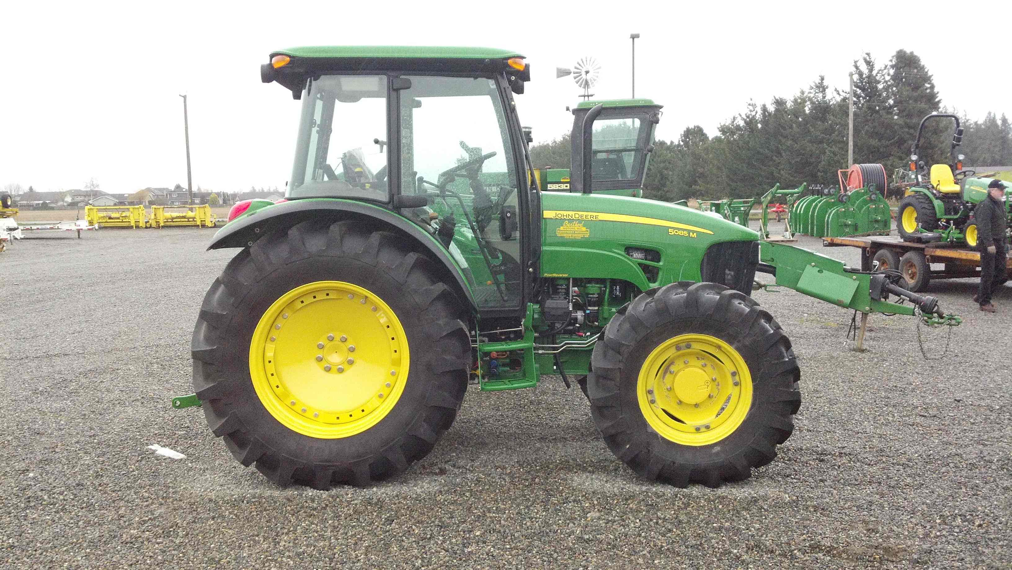

As some of you might remember, like pclausen, I really struggled with my tire selection. On my Bobcat A300 I have larger than normal wheels and tires, and I have never regretted my decision to choose them. Less rutting and compaction.
My machine unlike pclausen's was a 2011 5085M from a dealer's stock. It came with the Goodyear radial combo 12.4R24 / 18.4R30. If I had ordered the tractor from the factory, I think that I would have chosen the combo that pclausen did 13.6R24 / 420/85R34. Instead, I swapped the wheel tire combo that came on the machine and for additional money got 14.9R24 / 18.4R34. This is what Caledon Hills did, but the difference was that he got a wheel tire combo off of a new 6 series machine. This way he ended up with JD wheels which were setup for wheel weights. In my case I got rear wheel centers that don't work with wheel weights. I have already decided that I don't want Rimguard, so my options are to wait quite a bit longer for new wheel centers that will accept wheel weights, or go back to the original combo.
In the following thread I see that there has already been some discussioin of the fact that with the 5 series machine and the 563 / H260 loader it is desirable to at least go up to the 13.6R24 front tire.
http://www.tractorbynet.com/forums/john-deere-buying-pricing/215735-5105-m-my-first-day.html
One additional twist, JD calls for a front tire overrun of between 0% and 5%. My original 12.4R24 has just over 0%, if I stayed with the 18.4R30 in the rear, which is a pretty beefy tire, and went up to the 13.6R24 in the front that would be just shy of a 5% overrun. Final thought, although the 14.9R24 / 18.4R34 combo is very strong and has a very substantial flat plate, it does make the tractor feel even bigger and taller than it already did. I have to say that there is something to be said for trying to keep the tractor as nimble as it can be, otherwise why have a 5 series, might as well move right on up to a 6 series?
Final, final thought: I could go back to the 18.4R30 rears which easily accept wheel weights, but swap to 13.6R24 fronts with the nearly 5% overrun. I don't understand why JD doesn't offer this option. Just for reference, I believe that pcluasen's combo of 13.6R24 / 420/85R34 has an overrun of between 2.5 and 3.
Anyway, any of your thoughts would be greatly appreciated on this decision.
Thank you,
Island Farmer

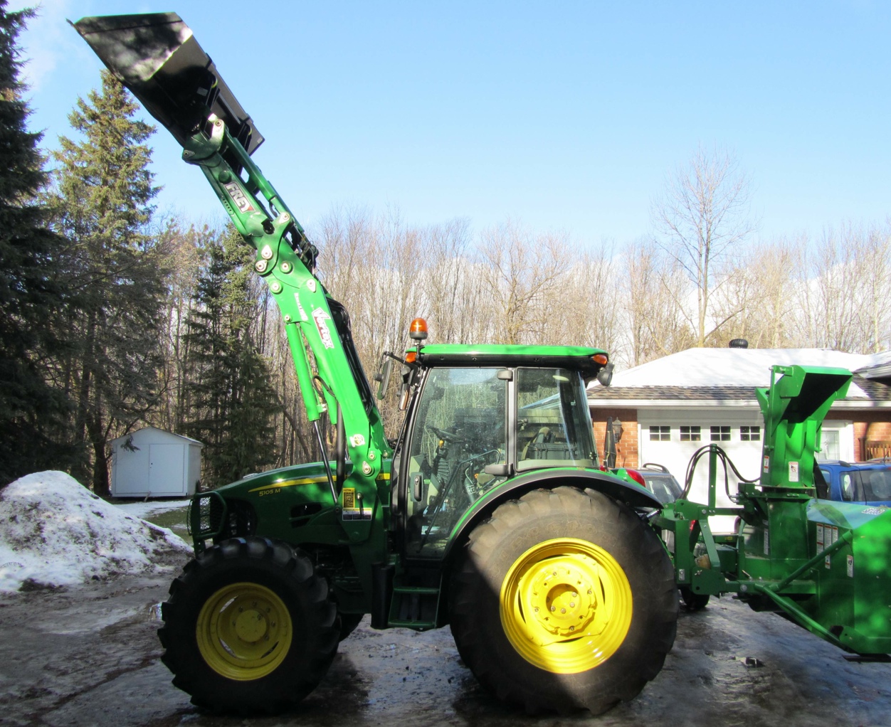

Below are some pictures of my tractor with the 14.9R24 / 18.4R34 combo:
Hi Zebrafive,
I am in kind of a hurry at the moment. I can check later, but I believe that the bore is 3".
Island Farmer

Have you considered getting the wheel centers drilled for wheel weights?
Would this be a solution? Or do you want to get away from 34" wheels?
Would you gain any steering angle switching to 13.6s vs 14.9s? If so I would switch. 14.9s seem overkill on a 5000 series. If you only switched to 13.6s where that leave your overrun percent? still in range?
For the rears I doubt you would notice the difference between 18.4 30s or 34s. I think the 2" lower would make it more stable, but doubt you could tell.
Why no RimGuard? It would be my first choice for rear wheel weight. I know once it's in you can't remove and replace like wheel weights, but who does that? People put wheel weights on and leave them too.
Have you checked the ballast requirements for the loader? Sometimes no wheel ballast is not an option.
My guess on why a tire combo is not offered would be lack of demand. Most people do not do the research you have done, they just buy what is offered.

Zebrafive,
I just checked my notes, and the top link cylinder should be 3".
Island Farmer

HTML:
Zebrafive;2838785]Have you considered getting the wheel centers drilled for wheel weights?
Because these Titan wheel centers are concave, wheel weights cannot be properly mounted on them.
HTML:
Actually, I would not gain any steering angle by switching to 13.6s, but the tractor would be over two inches lower to the ground and more compact feeling. The thing is that the rolling circumferance of the 13.6 does not work with my 18.4R34, I would have to switch to the 420/85R34 that pclausen has to make the 13.6 work.
HTML:
I am not sure about whether you could notice the differenc in top-heaviness either, but the tractor would definitely feel more compact.
HTML:
I have decided that I just don't want to go with Rimguard, I would consider it if I didn't have the radials.
HTML:
With the 400 lbs. of wheel weights and either an implement or my ballast box, I will be fine.
HTML:
I guess you're right, but when spending this amount of money I like to get things as right as possible.

Sounds like you're leaning towards changing tire sizes. This will solve the wheel weight mounting problem, make the tractor more stable, and not really give up much in footprint.
I do think the 13.6s will allow tighter steering unless you set them out wider than pictured, then most likely no difference. Not sure on the M series, but on the 6000 series, 71" is maximum front width recommended for a loader. 13.6s should also have more capacity then needed for the loader. So that's good.
I agree it's cheaper to do it right the first time and with a new tractor you only get one first time.
For the top link 3" is the right choice.

I don't think there is a choice in the Multicoupler mounting (unless you are building your own bracket) I mounted mine with the handle out because that's how Deere did it on the 640 loaders. I like the way shown in post 251 with the handle forward. It sticks out less and being right handed it looks like the swing of the lever would be easier for both couple and uncouple. IIRC I'll gain almost 3 1/2" clearance if I turn mine 90 degrees (lever forward)
I even took the handle off and straightened it to gain clearance. (see the bends in first picture)
I like this. Having the unit be as streamlined as possible should be a good thing.

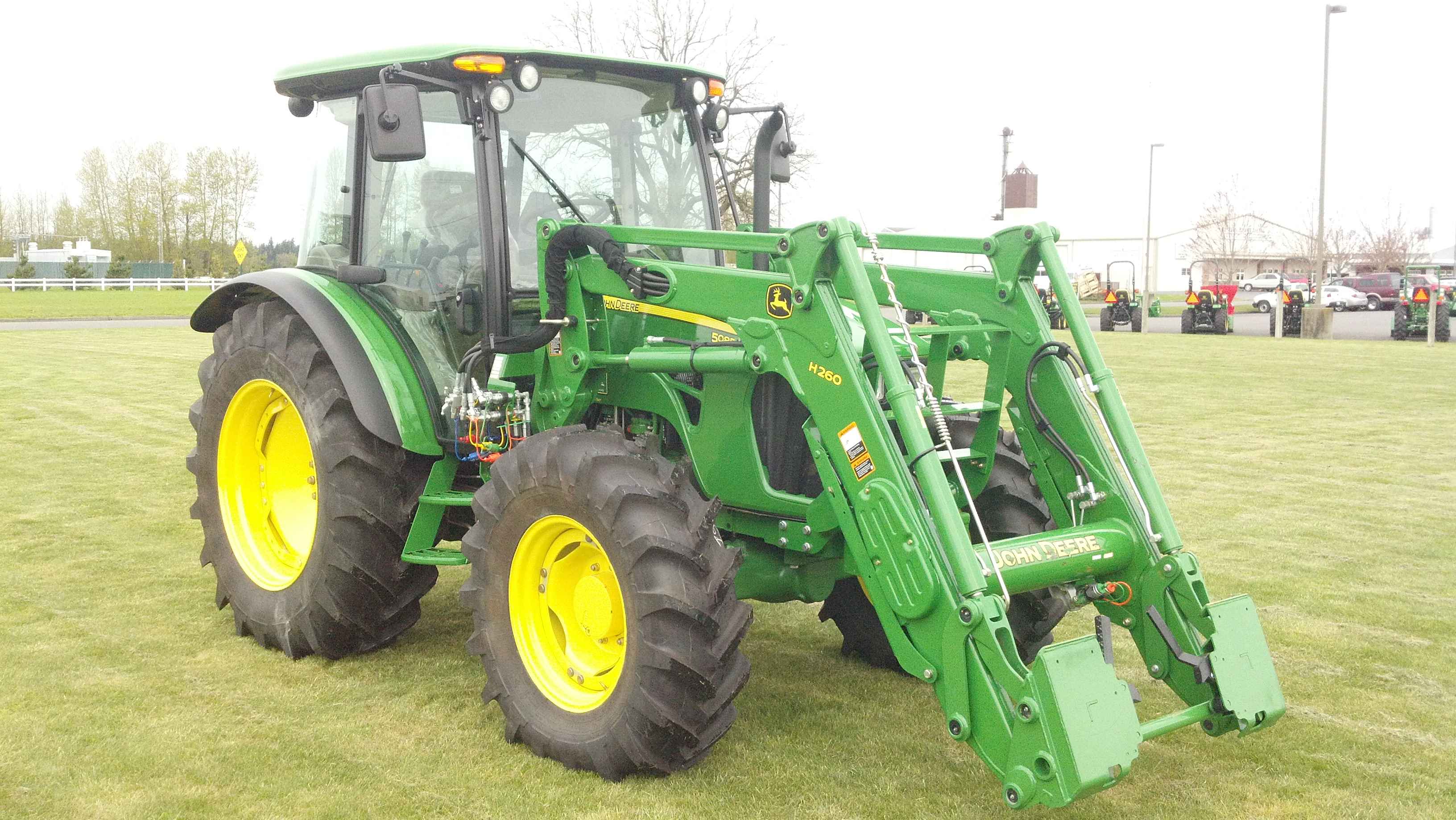

I actually like the guard in the first picture the best, it's taller and will protest the hood better. You should see the second pictured guard without the mesh brush guard installed. Do you have a picture of Caledon Hills guard?
JD offered a HD guard for the 673 loader that I liked better than the one that came on my 6415. They offer the mesh guard for it too (on my wish list). So I bought the guard and swapped. Weighs about 50lbs more than the original one.
It has larger side plates. A 2" x2" crossbar, the folding part is larger (taller), and the latch has been moved from the right side to the left (same side as the hood latch).
Zebrafive,
Your hood guard looks pretty beefy. Here is the best picture I have of Caledon's hood guard.
