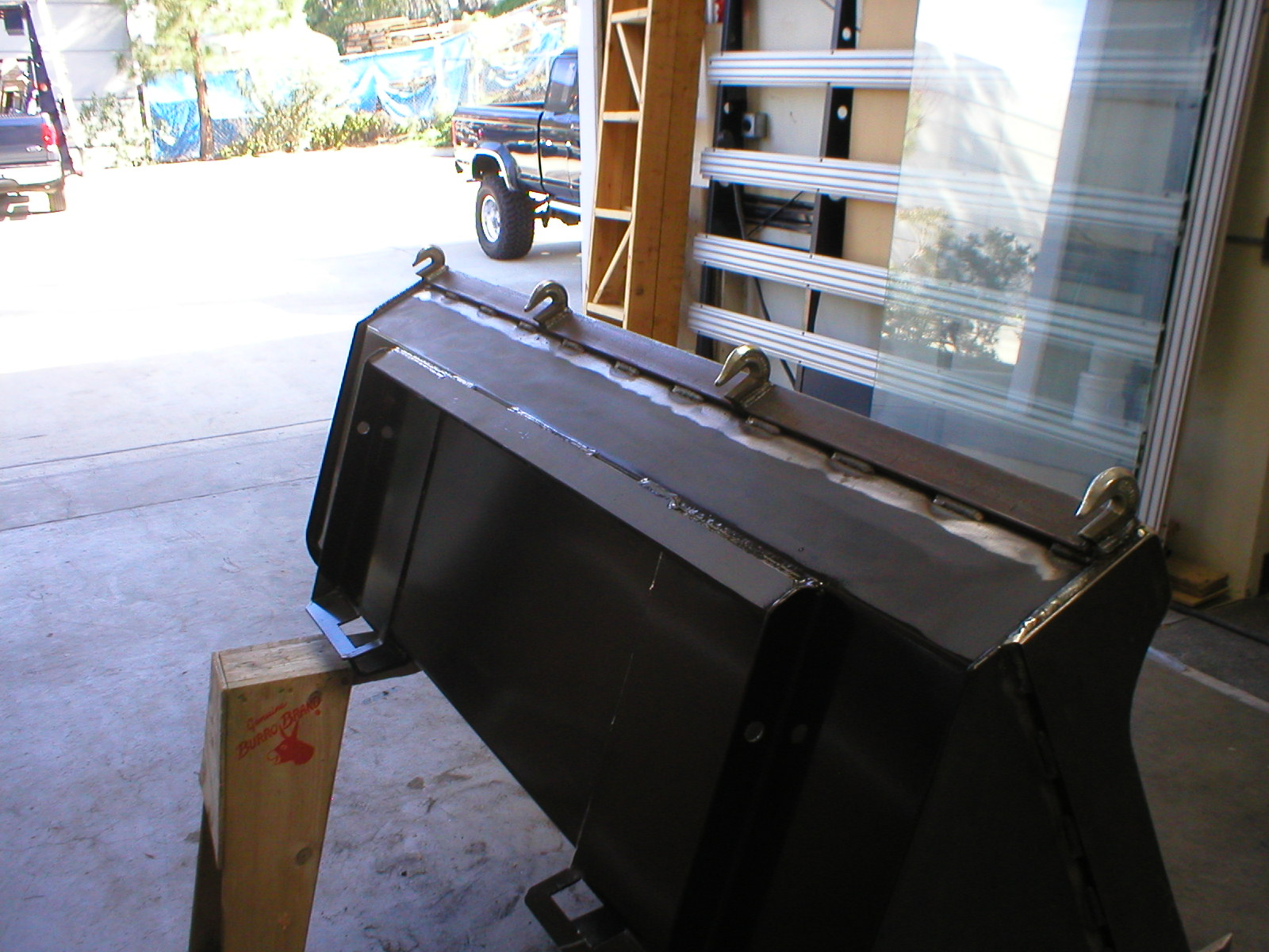

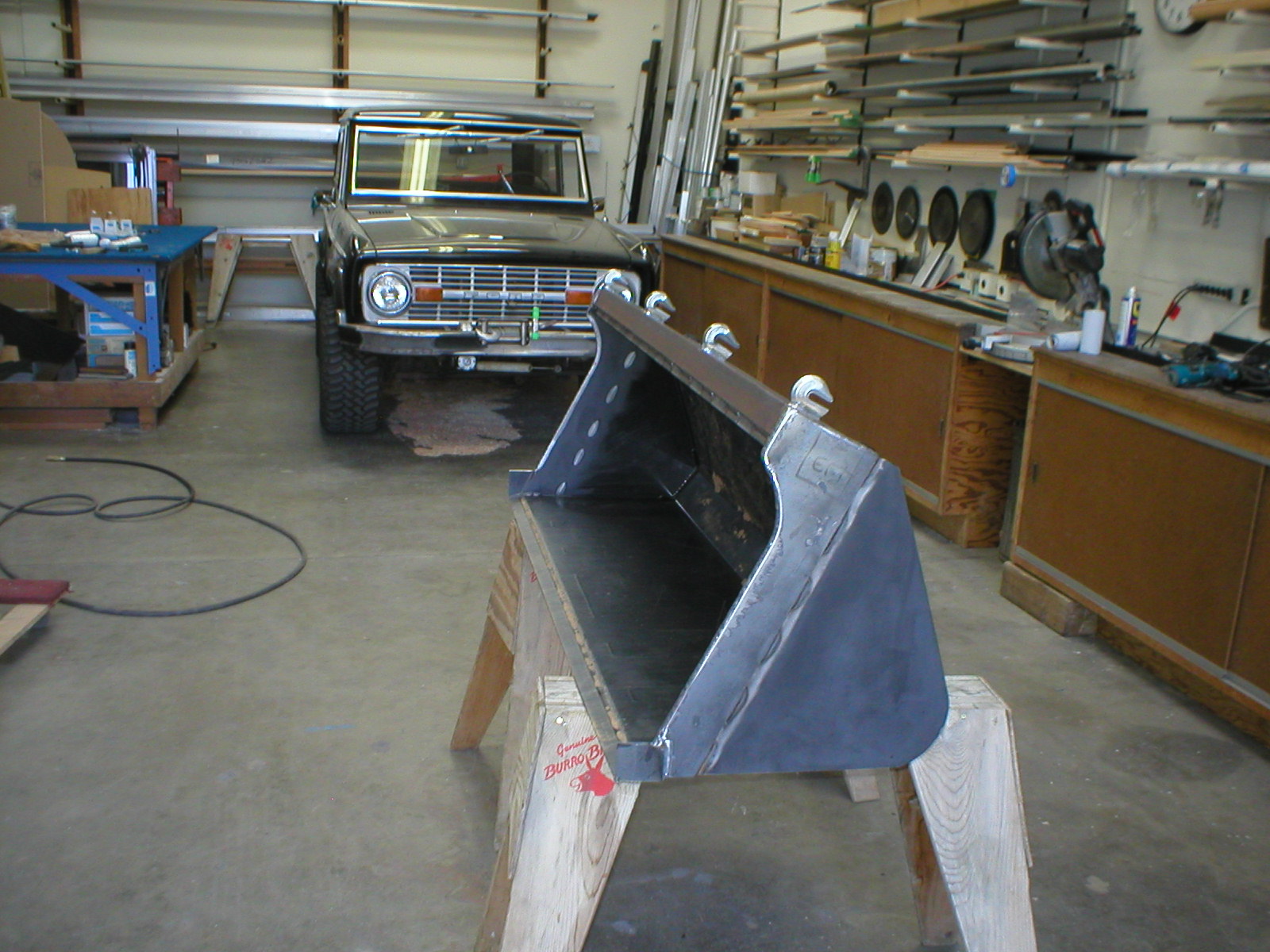

I have a DK-40 and stock loader and bucket, BUT I added the Kioti made bucket bottom edge to give even more strength and to keep the bucket's edges/corners from wearing excessively over extended use, on recommendation of my selling dealer's tech guy. I recently removed it to cut two more holes 4" from center of each corner's closest bolt hole. I had bent the reversible edge bar at both corners due to, ( IMHO, Kioti's not putting holes out close enough to the edge/corner of the bucket), making it vulnerable to being bent when/if it snags on a rock or such.

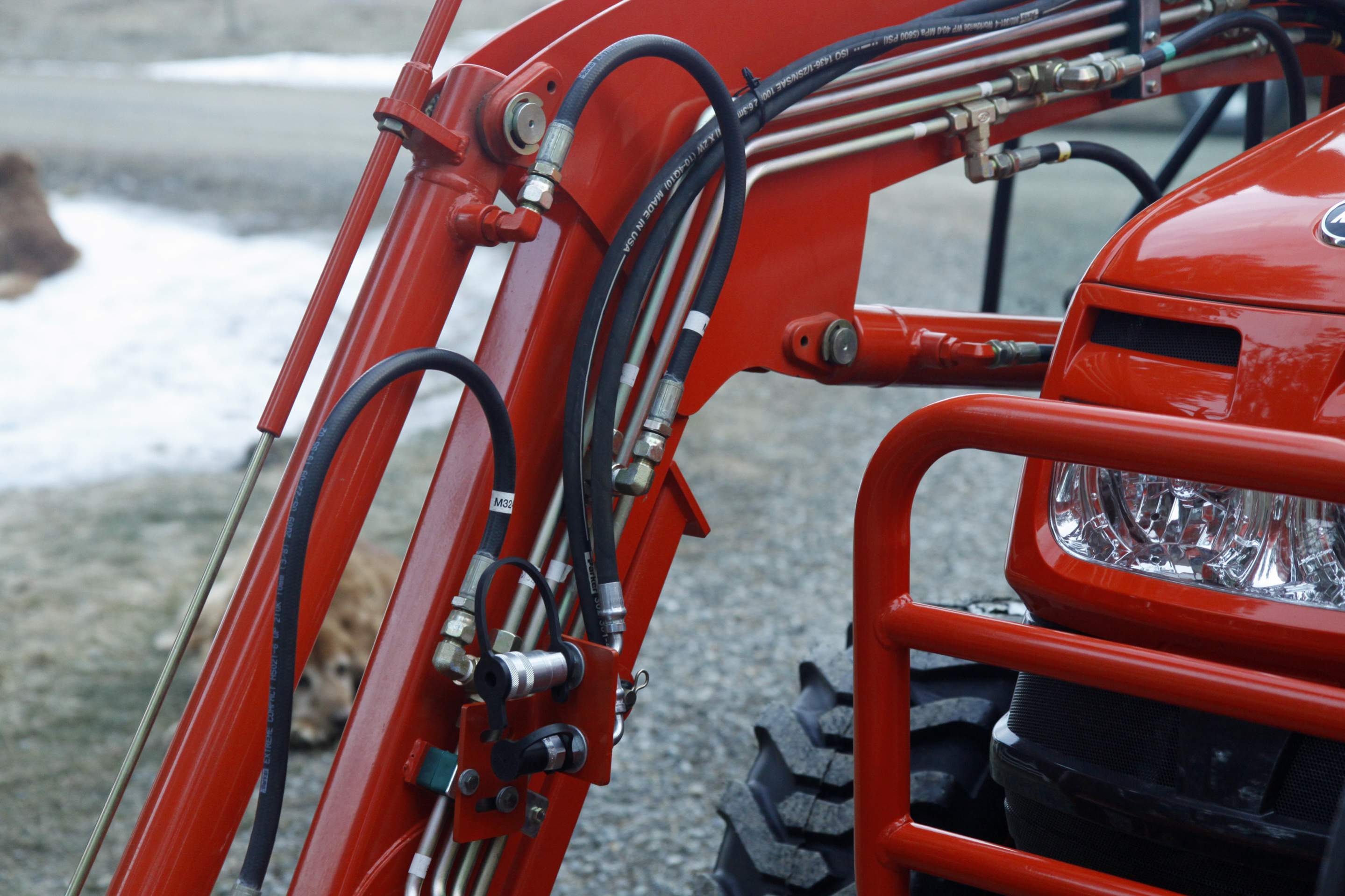

MIE can also sell you a hydraulic kit for running remotes for grapple, etc to front of your loader. I would definitely talk to them about what is available in a kit from Kioti.

Thanks for the info everybody, i think what I will do is increase the capacity on the stock bucket like Mountainview did. The teeth on the bucket would be nice but the I can't use the edge to smooth stuff out with, until I get a box I'll leave the edge smooth. I may build my fork rack with a grapple arm, we will see. CJ
The capacity of my bucket did not change at all as far as volume. Just that it is now a lot stronger and has some hooks for chains to hook onto for moving those odd shaped over sized items. ;)
