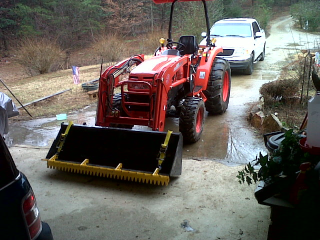

I have a DK-40 and stock loader and bucket, BUT I added the Kioti made bucket bottom edge to give even more strength and to keep the bucket's edges/corners from wearing excessively over extended use, on recommendation of my selling dealer's tech guy. I recently removed it to cut two more holes 4" from center of each corner's closest bolt hole. I had bent the reversible edge bar at both corners due to, ( IMHO, Kioti's not putting holes out close enough to the edge/corner of the bucket), making it vulnerable to being bent when/if it snags on a rock or such.

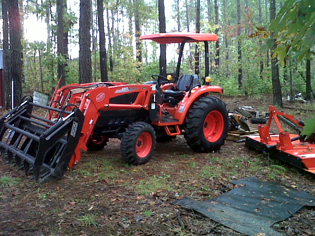

As noted below in my signature I have an Igland brand winch and Log grapple. Both units are fantastic, (made in Finlandia/ Norway) and the log grapple is amazing, and because it is only 36" wide and weighs around 400+ lbs. it does NOT take up much lift capacity. I've picked up and rolled back and carried 30' complete trees over some distance! Right now both items got a full 8 hours use today; along with my local pro tree surgeon we downed over 4 cords of ash, hickory, maple etc. alongside my road and cut it up and carted it between my and my pro's tractor we did an amazing amount of wood clearing for view and harvesting of the wood for his outdoor furnace. he burns on avg. 100 cords/winter!!

I just picked up at TSC the on sale until supplies are gone, Ratchet Rake, for $199 vs. $349. It is heavy duty and will fit right on your OEM bucket. Yours would take the 72" rake.
It's worth it, IMHO, for those $, just the metal and hardware alone would be worth it, regardless of its functions; grading, picking up brush directly out of the ground, etc. Check it out on their www.Rachetrake.com web site. It is available through TSC, (but is not on their web site), but can be found by having your store do a search for it. The price on Ratchetrakes web site shows $349, but it is $199 at TSC- just ask them. ( No affiliation with either company).

I love my DK50. I'm running a 72" WR Long RGB grapple and I use the WR Long electric 3rd function. I use BOTH rear remotes on the TSG-50 stump grinder.
Ballast is my new issue. The FEL has gobs of lift, but I need more ballast to keep the loaded rears on the ground.
I've found a home brew carry-all I am planning to convert into an 1100 lb ballast & tool box (but I have not started yet). In the short term I'm looking for an 1100 lb 84" HD boxblade...
