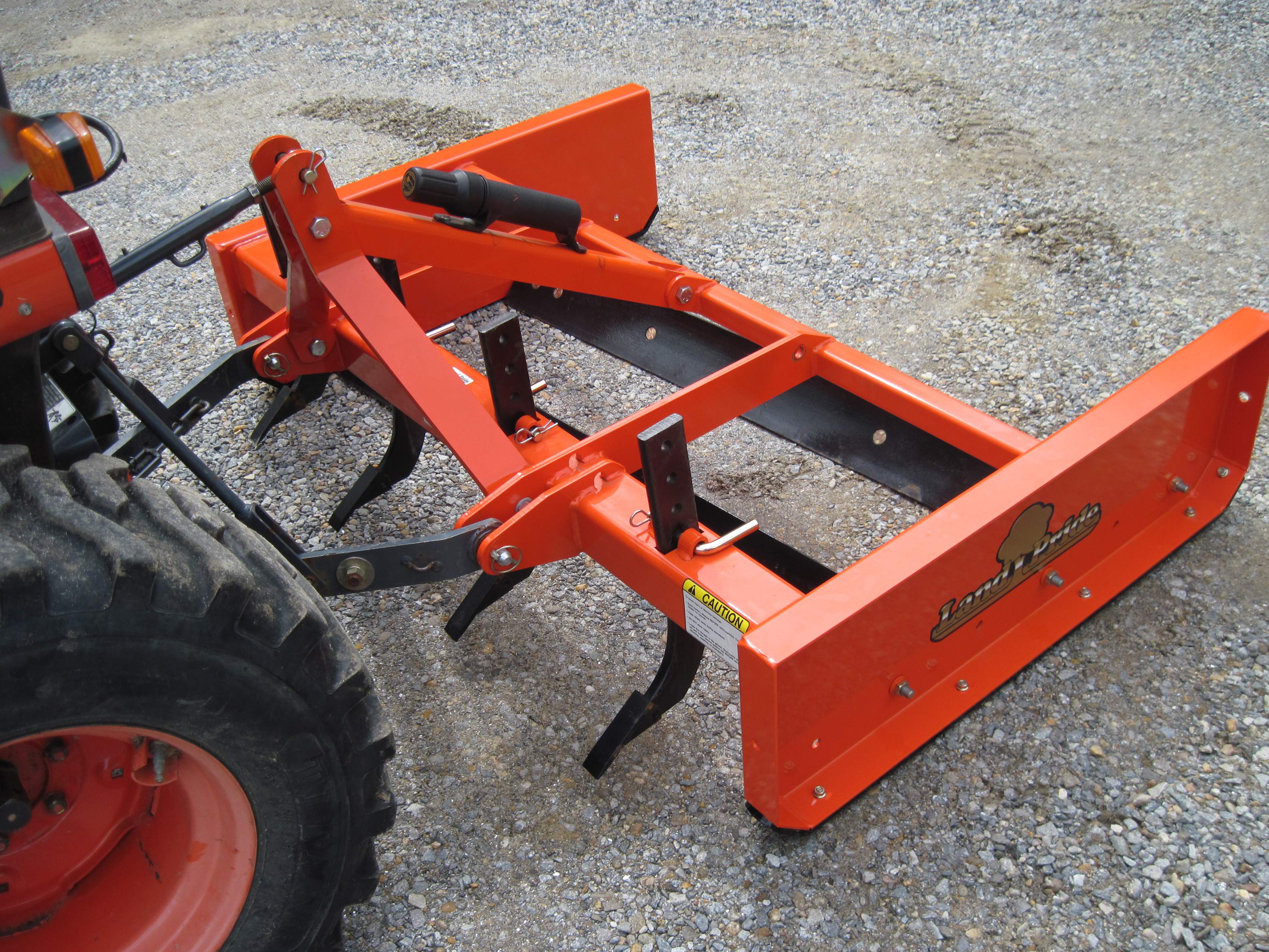

Picked up a Land Plane ( Grading Scraper ) last weekend to help maintain the driveway.
I will also use it to to level the lawn as I am starting

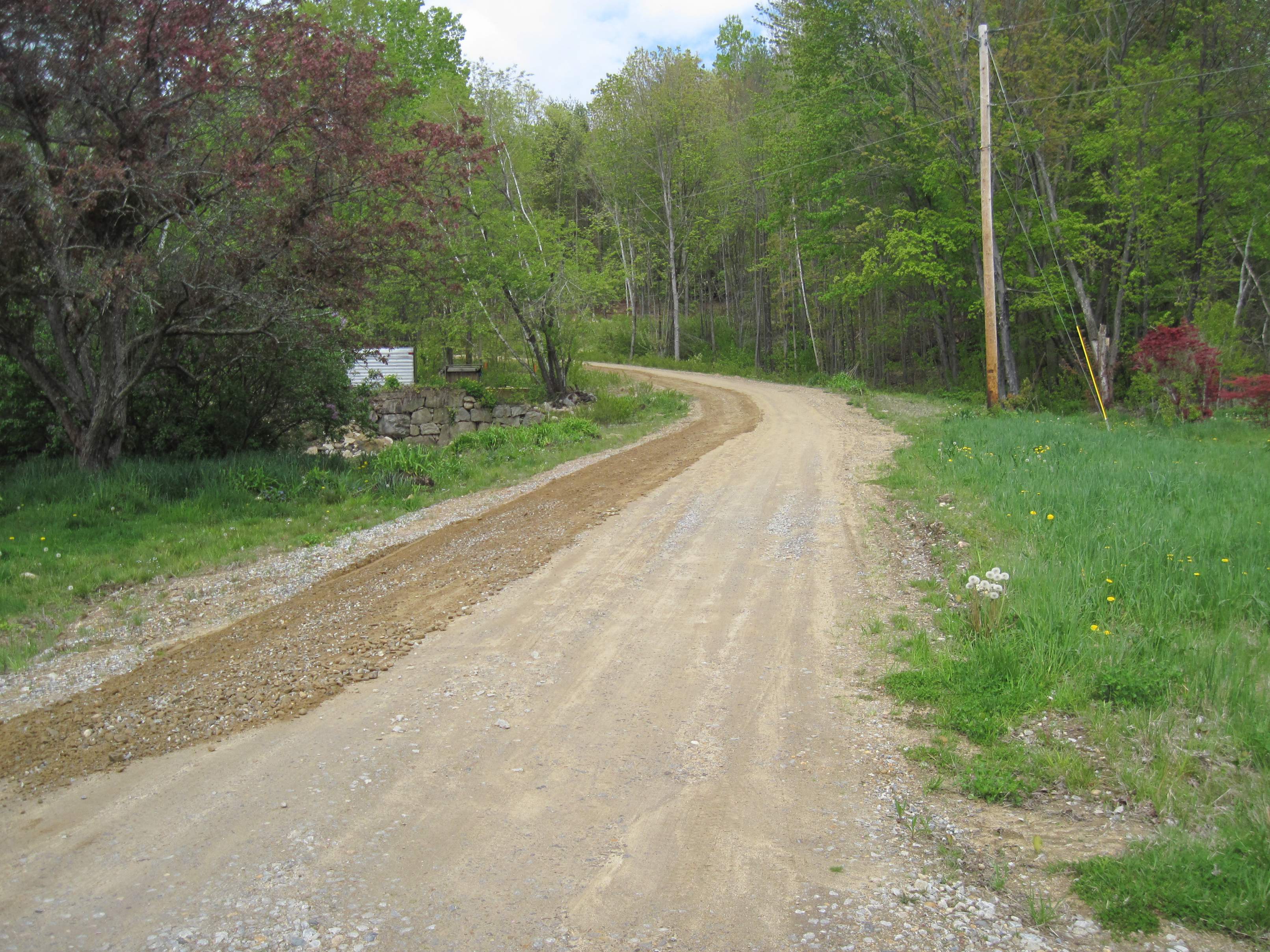

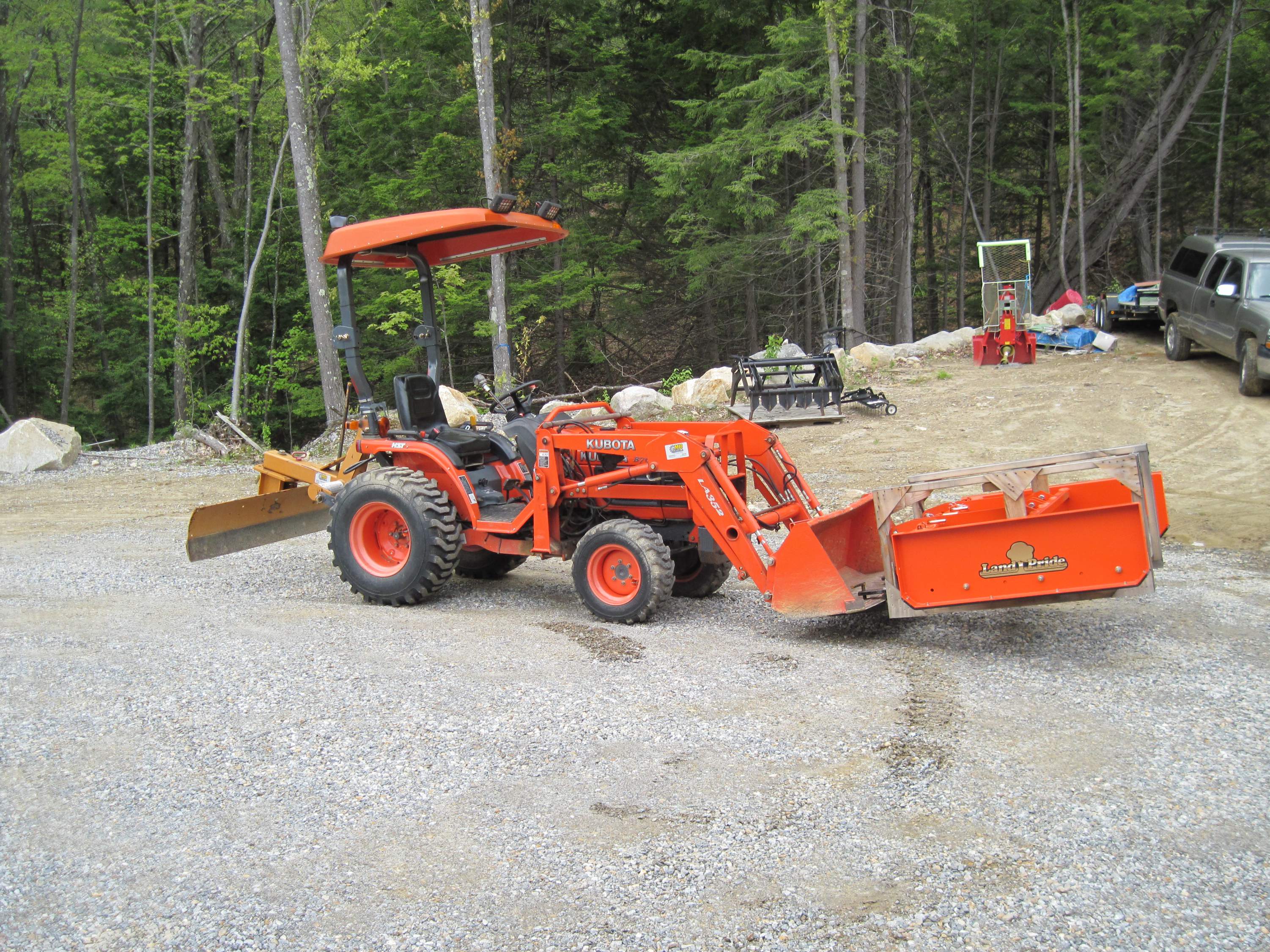

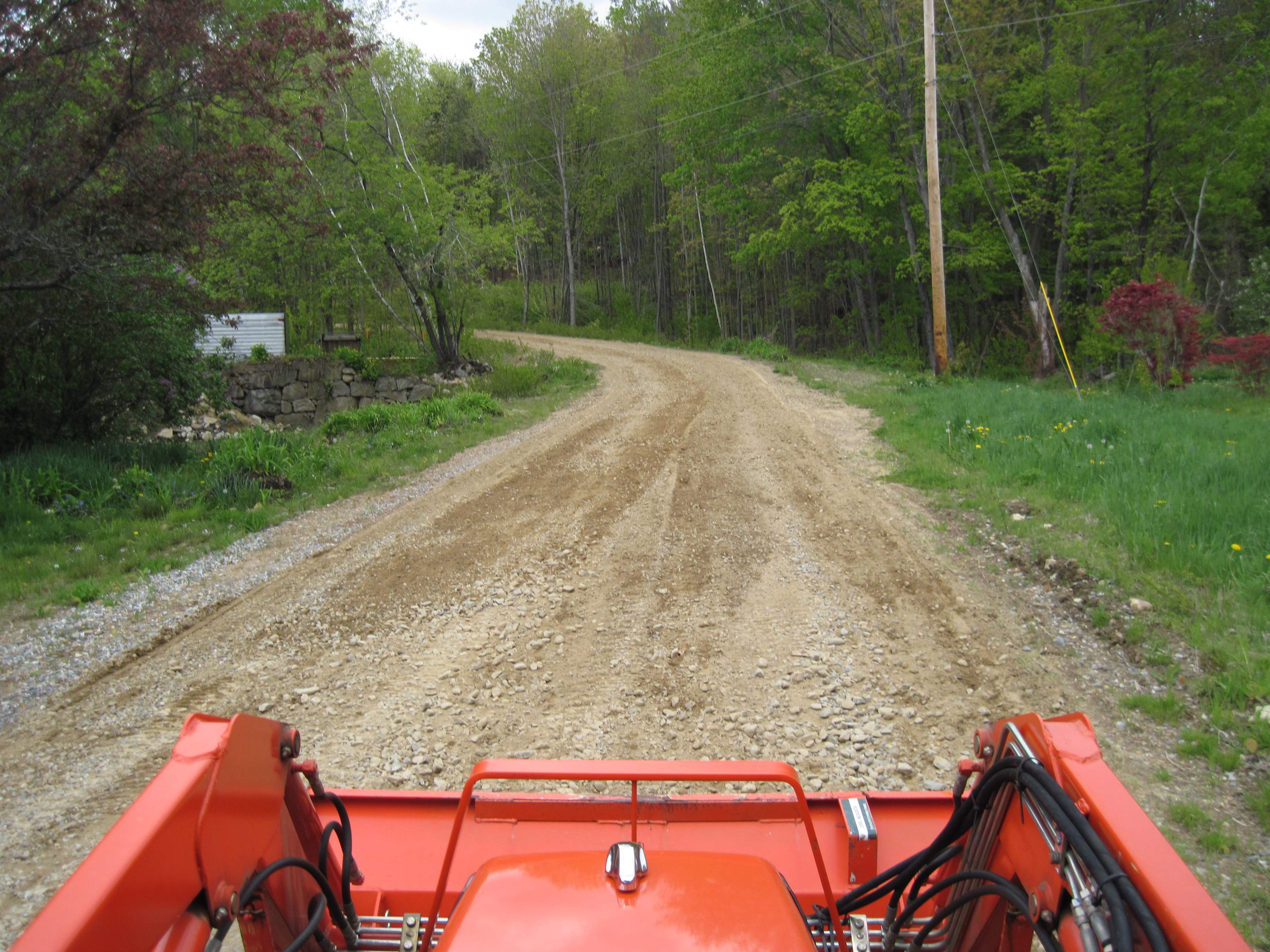

Sorry I didn't get pics up sooner. Been out of town.
It was nice to finally have a smooth driveway again. Looking forward to getting the lawn all smoothed out once all the planning is down for the irrigation system.

What I've found is, like Ted's video, you can run 'em without the teeth down first to see what it will pull up... I've used mine on some sorry looking drives and you'd be amazed how much gravel it will float to the top of the surface! Won't end up looking "just like new", but it will sure be a sight better than what you started with. If you've got bad ruts, then you can run the teeth down after a pass or two if the blades are enough to get it the way you want.

I am wondering how much you will use the rippers? It seems like most of land planes do not come with rippers...
/ New Attachment
I do not think I will use the rippers very much, if at all. But it is nice to have them if needed.
I was very surprised at how much material it brought up to the surface after just 3-4 adjustments to the top link.

looks like you could have afforded to go wider. On something like that i think you could go 7+ feet wide to grade more of the drive at one time. You should have plenty of tractor to pull even that wide.
