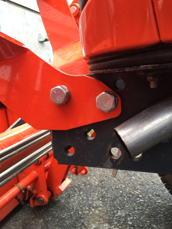

I took delivery of a new B2601 with a Canopy, 54 inch MMM, Quick Attatch LA434 loader with 54 in bucket, and a set of Woods QA pallet forks. It was kinda sad to see my BX1860 leave, but the power of this B2601 while chopping up 10 to 12 inches of wet leaves was wonderful.
My only problem is the grill guard that was put on the tractor does not allow the hood to open! I am going to get into the opening to see if there are other holes to mount the grill guard further forward, because the hood raises up about 2 inches, then stops against the guard! Is there anyone who has run into this before? I am going to call my salesman and tell him about it Monday, but if there is a special guard for the new B2301/2601 tractors I would like to know about it. Thank you in advance.

Mine is solid bolted, but I see 2 more holes in the frame hat will allow the grill guard to go forward and up about 2 inches. This will also get the cross bar out from in front of the headlights. I have family coming tomorrow, so I have no time to test out my theory yet.

Here's a pic of mine. No issues with hood.

Thank you. Mine is bolted in lower holes right up against the exhaust! I will move my bolts and guard tomorrow.

This is the same guard as the picture by grandall4, mine is in holes closer in and lower on the frame. I will be moving mine tomorrow as soon as I get two additional bolts. They shared bolts with the mower frame on 2 holes!

I moved the guard to the holes pictured by grandall4 and the hood now opens, and the guard clears the loader arc by about 3 inches. Thank you for the information.
