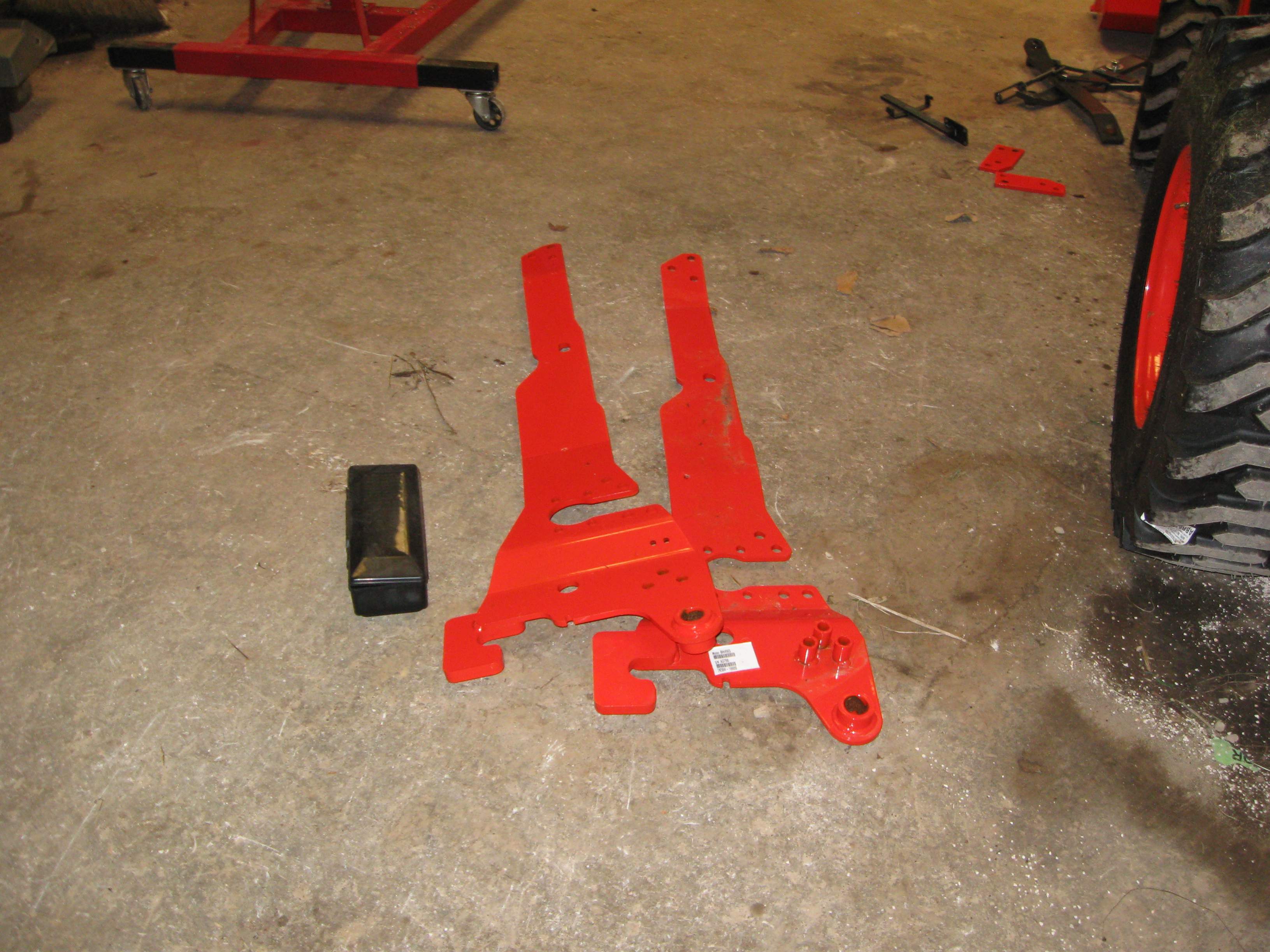

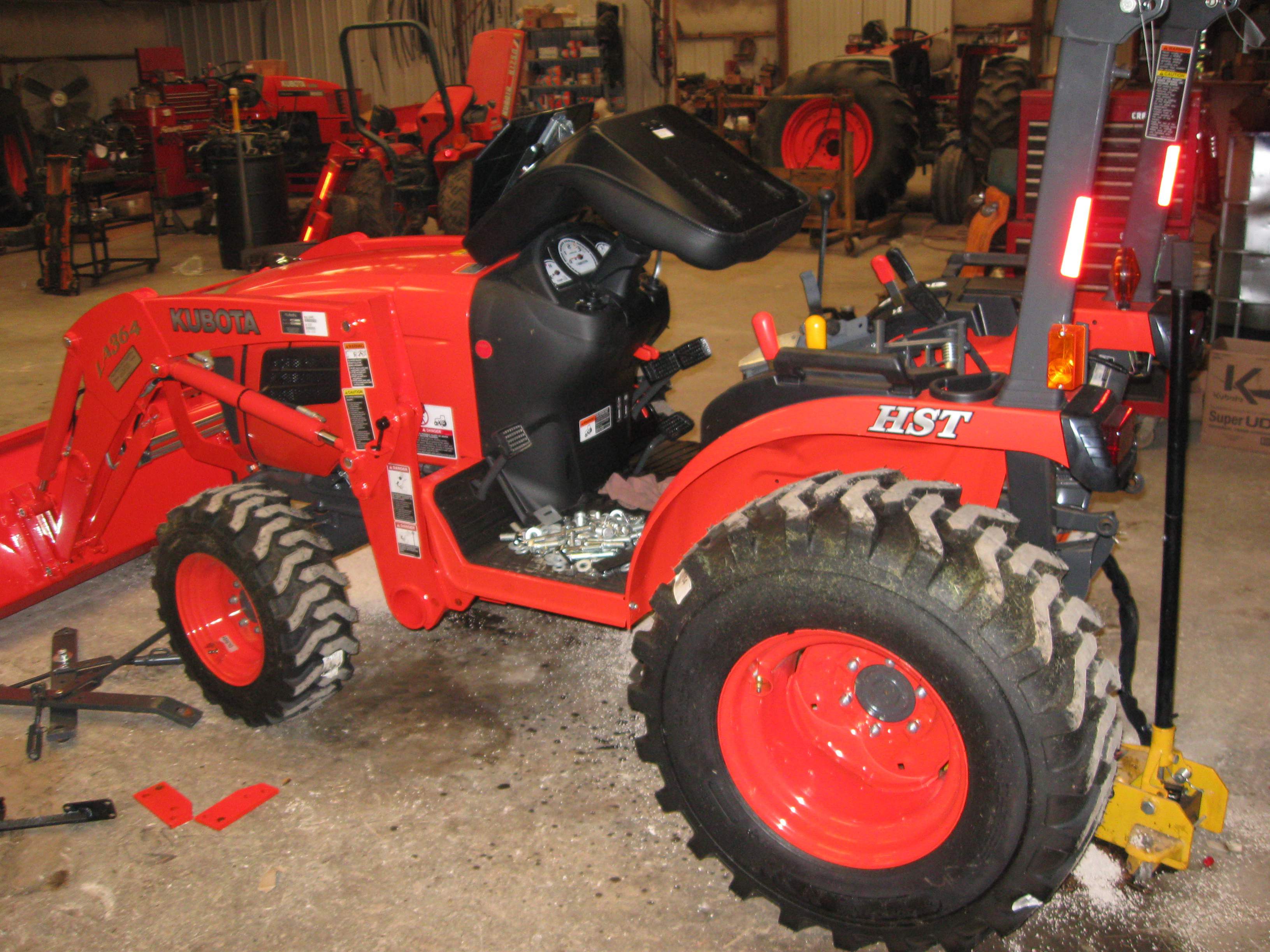

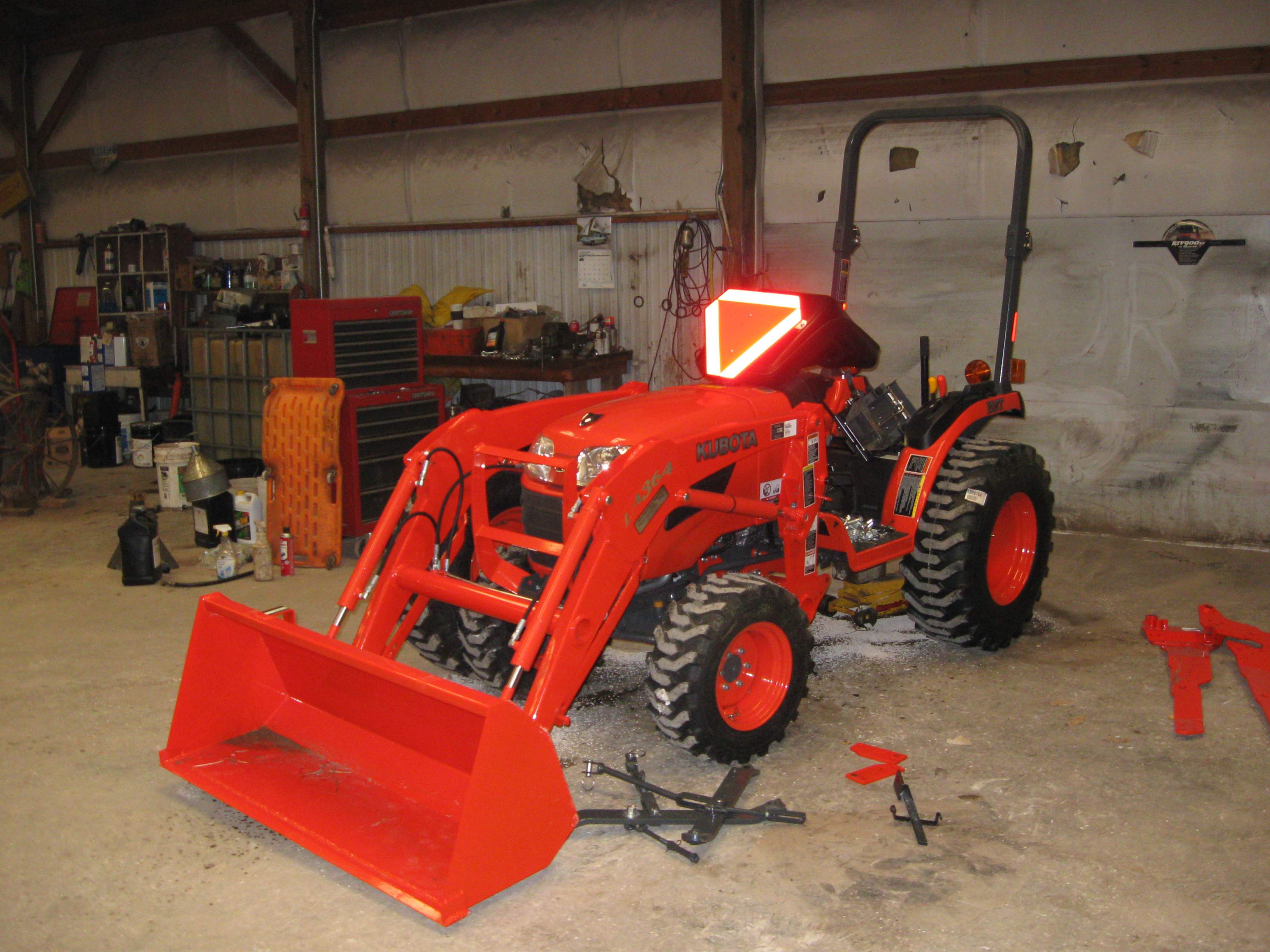

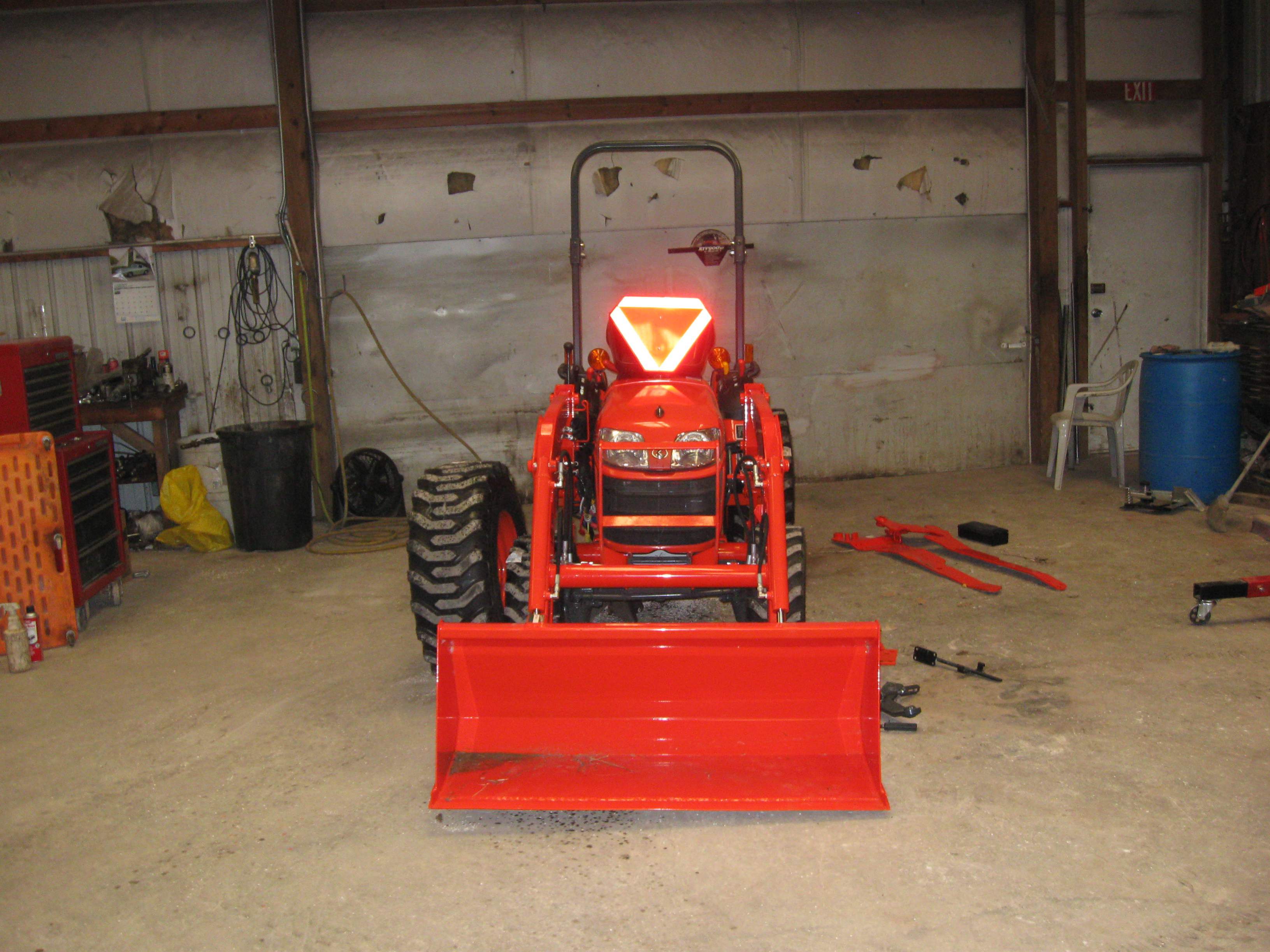

Traded the B2320 "geared" with 20 hours and the BX25 with 150 hours to Barlows for the new B2620 HST FEL BH. Your a bit behind, I'd posted pics of the B2620 in the garage at Barlows getting the BH installed. It was probably over in Kubta Buying/Pricing forum. I'll see if I can find the pics.:)

I am a bit behind sir.. well shes a beauty! I think you made a good choice.
