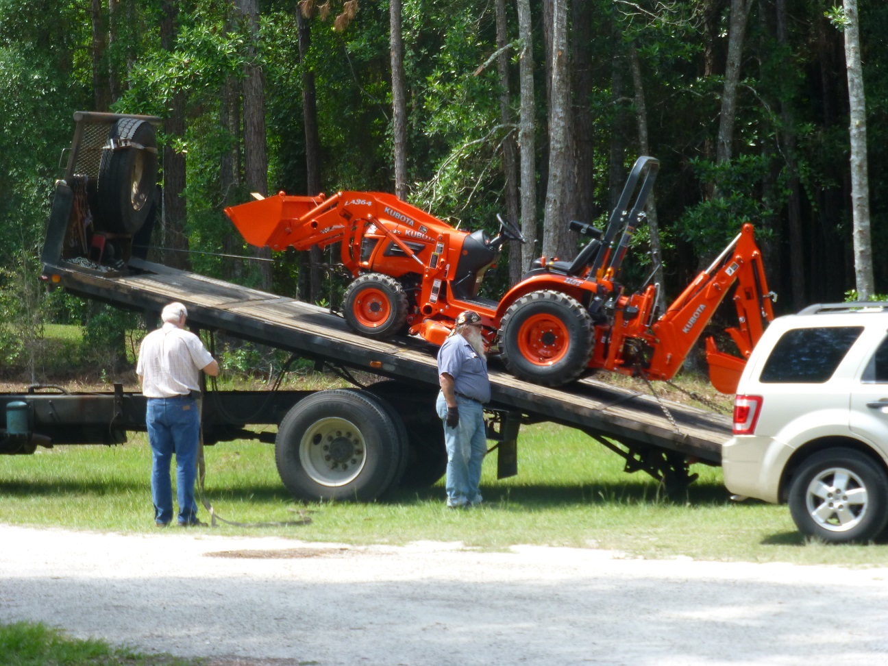

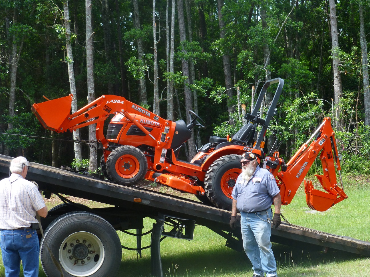

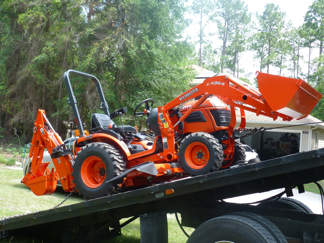

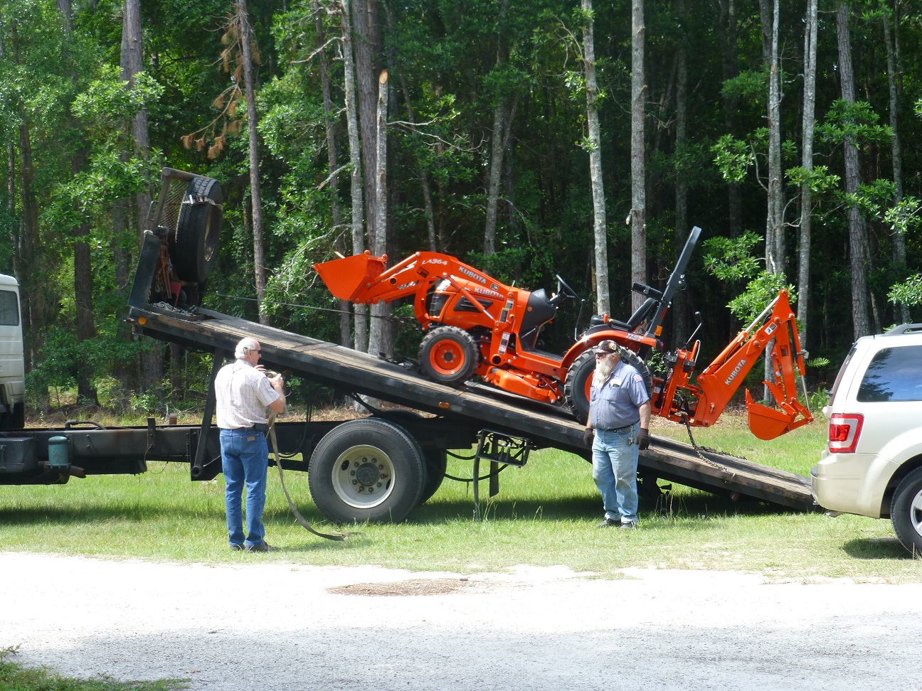

Lo and behold the tractor finally arrived today. I will try to get some more pics later but these are what I took when she was being offloaded. I spent all afternoon in the seat using both the loader and backhoe. The dealer threw in a set of rubber feet for the backhoe which seem to be a little more stout than the standard feet which they gave to me in a box. The backhoe was a beast having no problem with these Florida roots. The loader will take some learning to get the bucket full each time. The only problem I had today was I didn't put on sunscreen so my neck is red.....no pun intended:laughing: Probably won't use the mower till this weekend so will have to wait for that experience.
P1010356 - Copy.JPGP1010357 - Copy.JPGP1010358 - Copy.JPGP1010359 - Copy.JPG
A couple of first impressions. I like the roominess of the seating area. I also really like the placement of the joystick for the loader. The HST is the bomb as I had driven a gear shift of my friends and it was no fun when using the loader. The placement of the reverse peddle caused me to hit something else which I am really not sure what it was yet (loader joystick lock?). I was also looking for a 4th gear as high just seemed slower than expected.
The sales rep showed me how to take off the backhoe. He also said i needed to mount at least 1 of the 3pt arms to raise and lower the MMM which i wasn't quite sure why. Anyone know if this must be done? Also, getting on the 3pt arm was a bit of a challenge as we had to remove a locking bolt. Then we used a crowbar to get the rod that the 3 pt arm mounts to, to move to one side. Is this typical and is there anything I can do to loosen this rod up? I will post more experiences along with pics later.

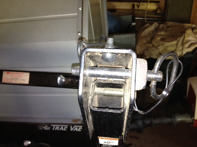

On the ROPS and pin vibration - my Ferris ZTR ROPS has a washer and foam insert - never vibrates. Should be easy to make this with a washer and a piece of soft rubber or foam pipe insulation.
