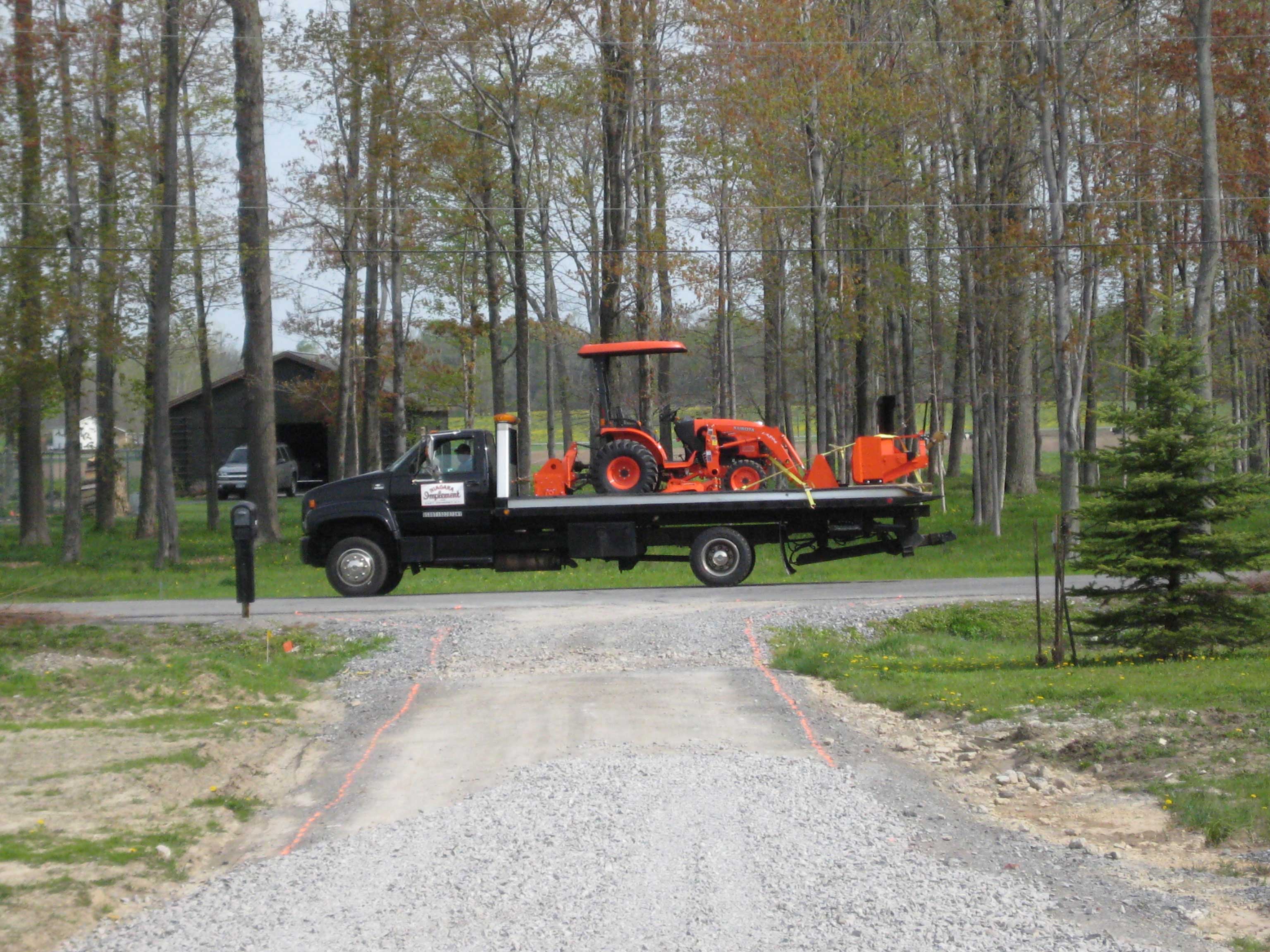

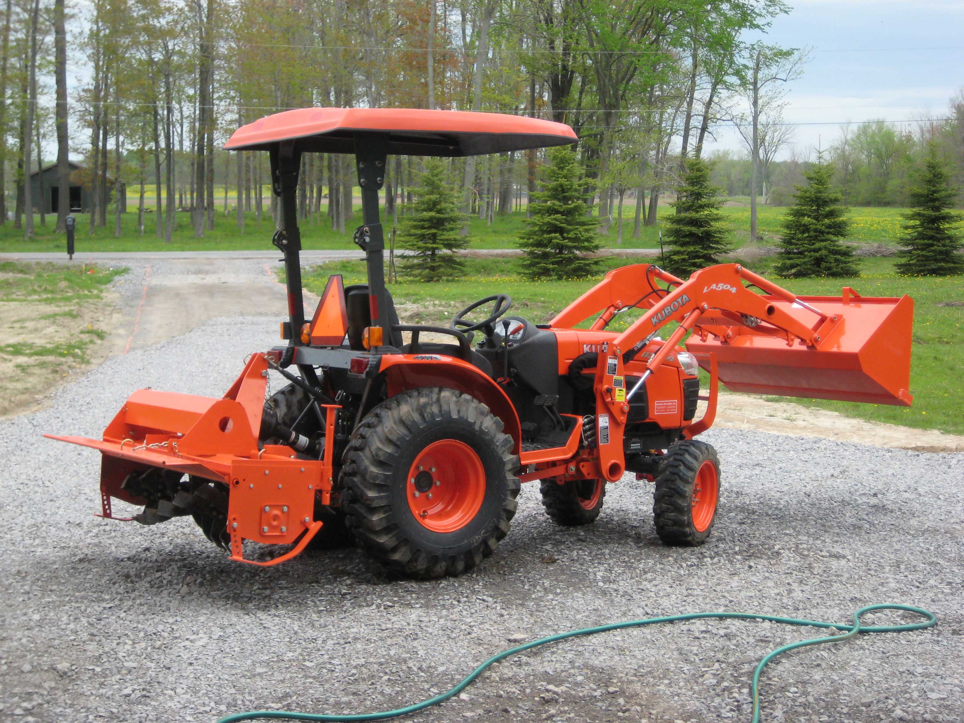

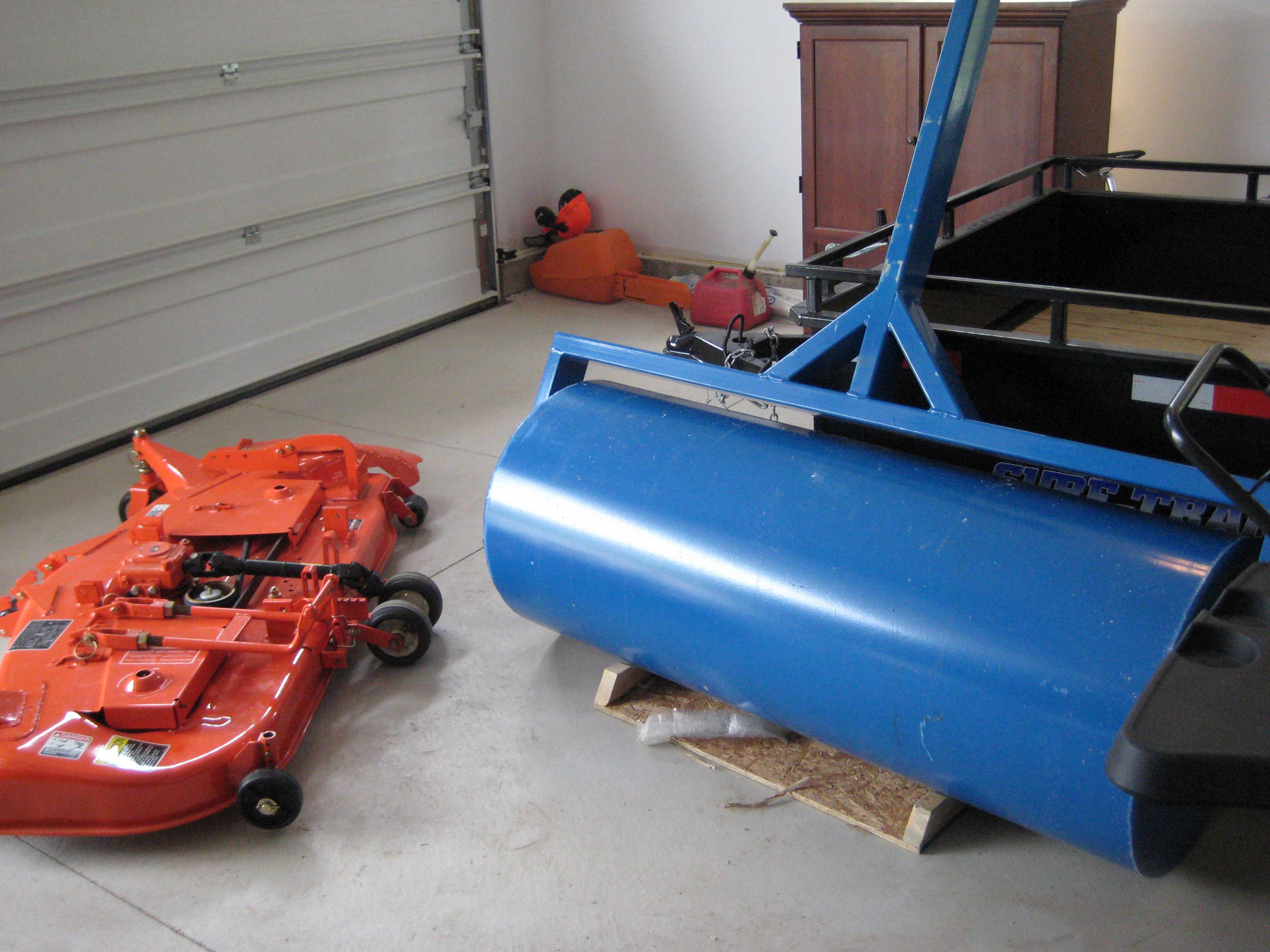

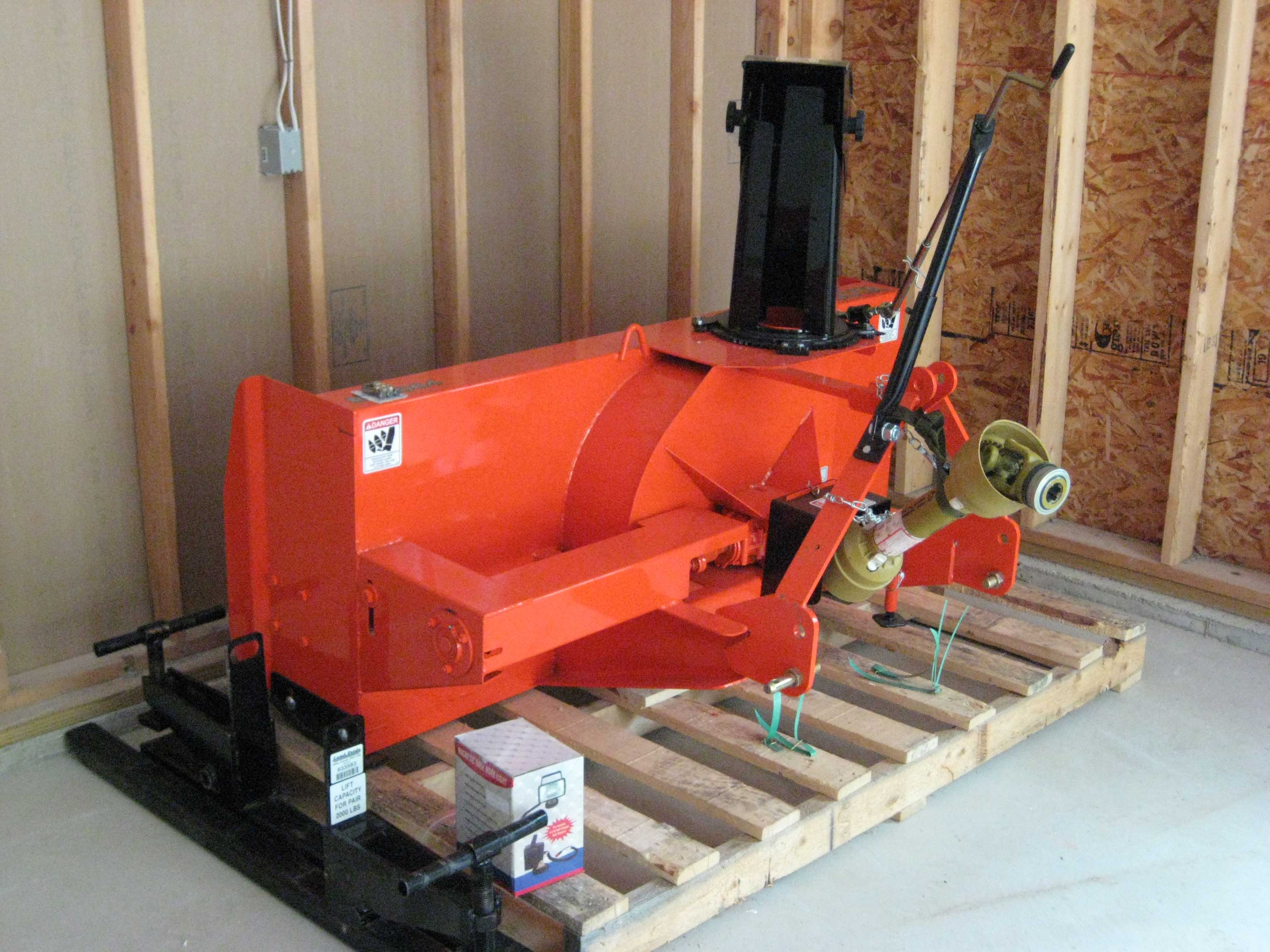

Well, after many months of research, it has finally arrived. We have a new house and I have lots of outdoor work to do. I'll use the tiller to reclaim the adjoining field and then roll the seed. The blower will be great for these buffalo winters. We have stone, but in a week or two they will be completing the asphalt. I used it yesterday to build up the earth so I could drive into my rear garage door as the ground settled over the winter and there's quite a drop. They have to come back and finish grading around the house. I bought a quick hitch from Harbor Freight which worked great for my box blade, but it made the PTO shaft too short on the rear tiller. Not sure what to do? Maybe ask to get a longer shaft or go back to hooking it up without the quick hitch.

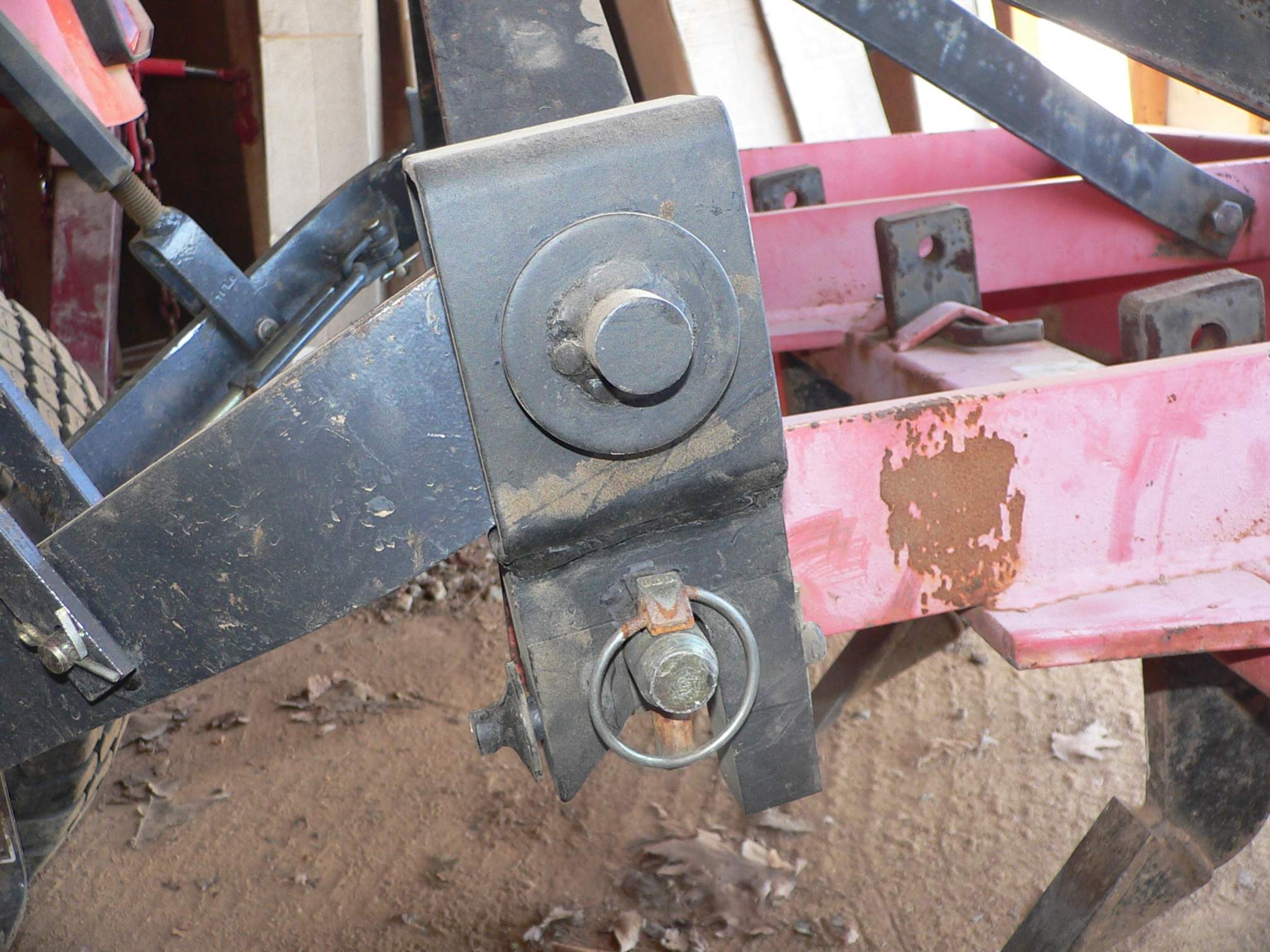

Congratulations. The B3200 is nice and you decide if it vibrates, don't let anyone talk you into it. Mine was not unusual vibration. If you bought new tiller, they may swap you a longer shaft. I've bought the cheaper QH's off Ebay that let the implement sit on top of the QH or under the QH to solve my "short" problem.

Just another thought - looks like you have the same snow blower I have and part of the setup was to cut the PTO shaft to length since it was too long. Maybe if you have not done that yet, it might be long enough to use on the tiller?

That's interesting....I'll have to swap them and see how that works. I just figured that they were both the same length. I already ordered the extender from Agri Supply, but if I can just swap the two PTO shafts, that would be great.
