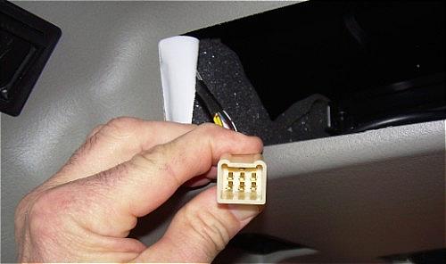

Understood. Have you thought of loading the tires with RimGuard? It worked well with my B2620.
Also, was the Radio plug you cut out just the standard Kubota radio plug? img0830.jpg
Thanks!
   / New B3350 #160
Yes that is the plug I removed. Not a fan of loading the tires, I like to be able to remove weight when required. I am taking off the grass catcher today, putting the spacers and will hook up the ballast box to see how it feels.
