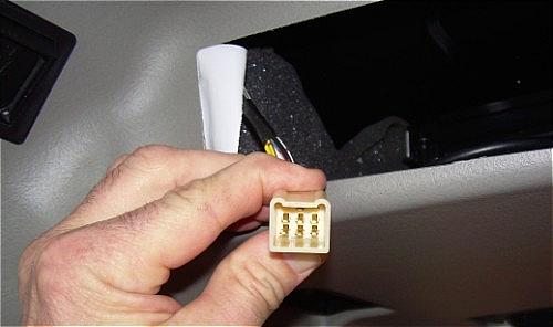

10) radio setup was easy, bought a Sony with bluetooth, cut the Kubota plug and rewired myself. Do not use the diagram that circulates on the web about using a Generic radio in a Kubota RTV, not a single wire was coded according to the diagram found in various forums. Had to remove the speakers to figure out the polarity, nuts are a pain since they fall in the cab ceiling liner when your unscrew the speakers. Have fun!

Also, was the Radio plug you cut out just the standard Kubota radio plug? img0830.jpg
Thanks!
/ New B3350 #160
Yes that is the plug I removed. Not a fan of loading the tires, I like to be able to remove weight when required. I am taking off the grass catcher today, putting the spacers and will hook up the ballast box to see how it feels.
