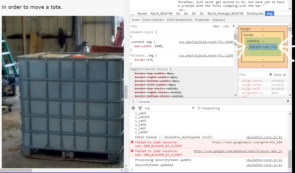

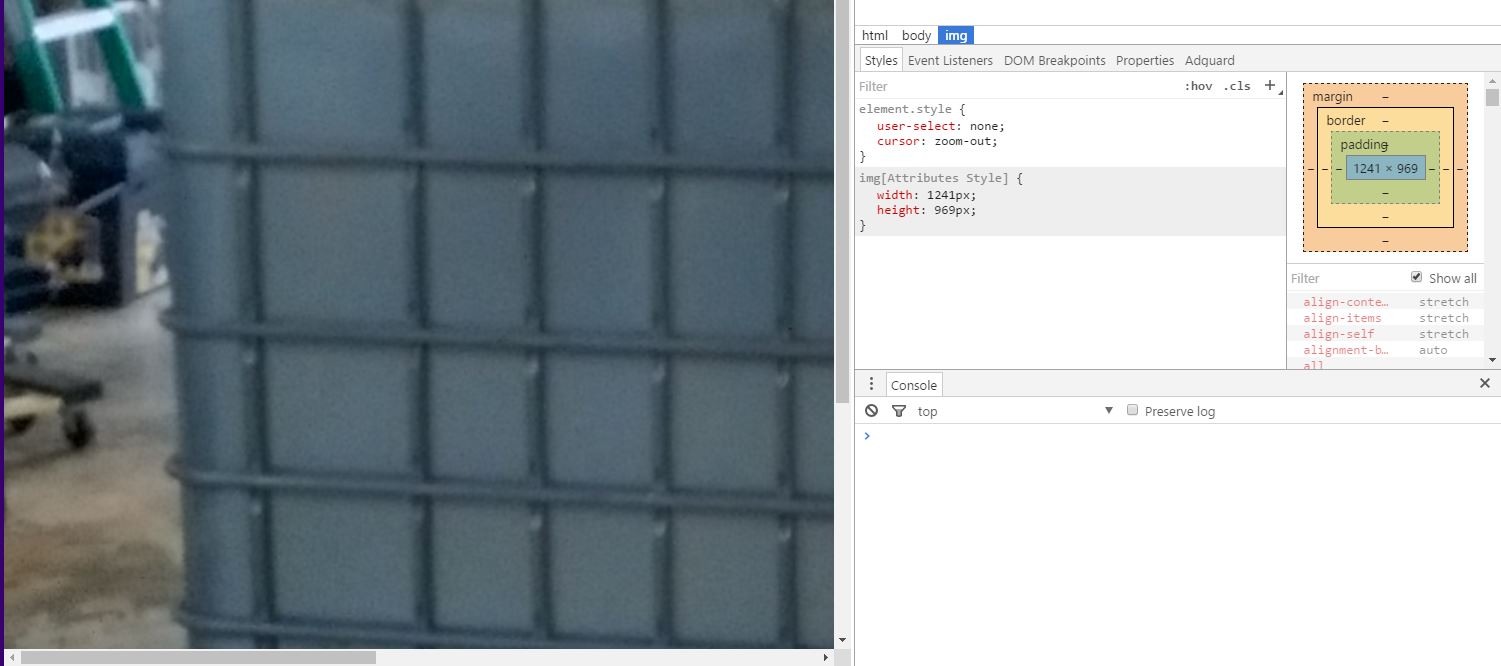

Don't apologize for in post full size pictures, that is the best way to do it. They are smaller than having to click them to see them.
In post size is 539 x 421 pixels:
After click size is 1241 x 969 pixels:
To see the size, right click the picture and click "Inspect". :thumbsup:

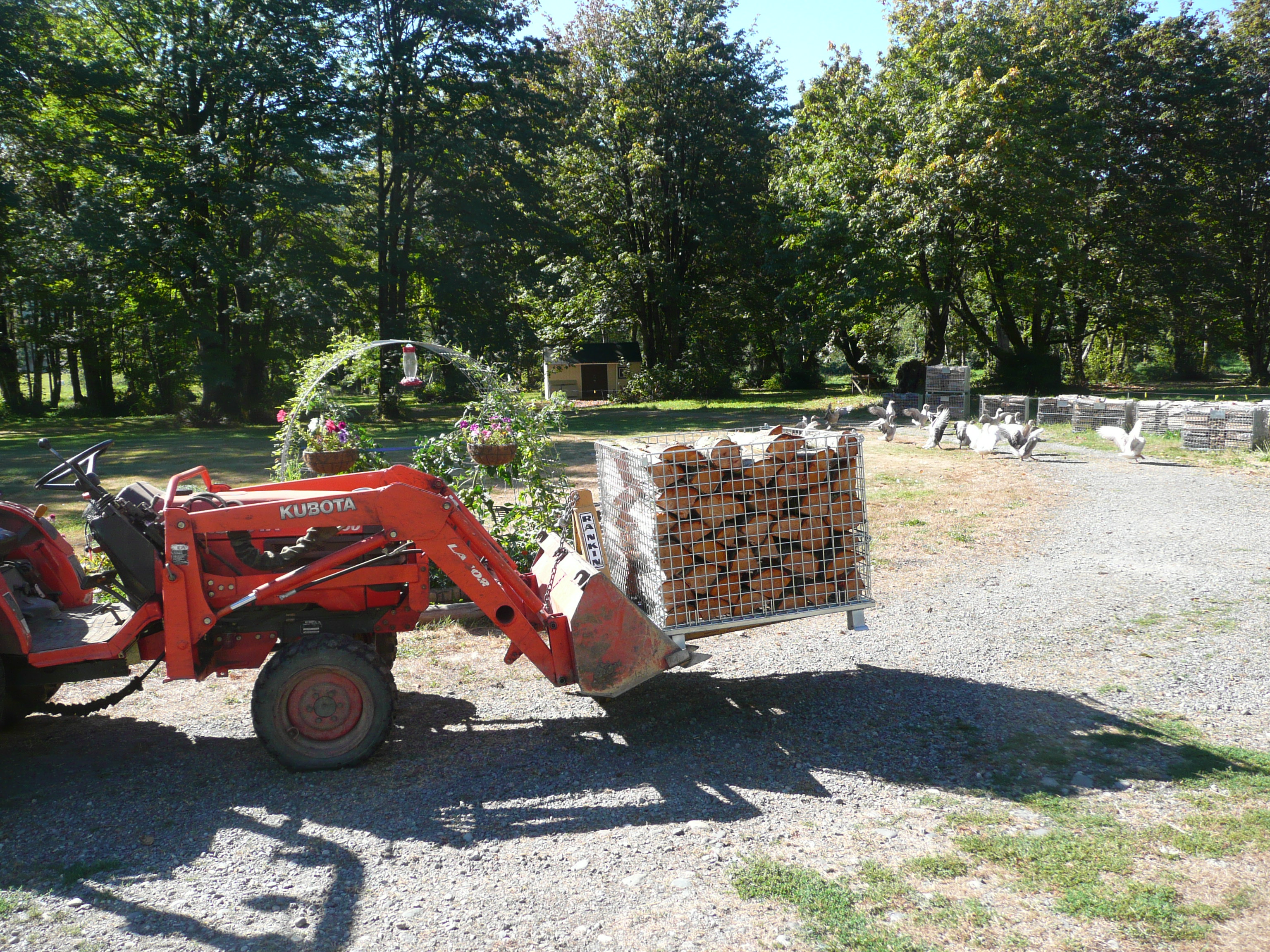

I have a regular tooth bar on my B7800's bucket. I've spun huge tree trunks around with it (once bent and popped off the bar- ouch!) and have back dragged a LOT with it (doing my site prep for my garage I broke one of the stays for my 3pt arms and could no longer use my box blade- I ended up back dragging with the tooth bar to gouge and break up the soil (two-wheel driving: front wheels off the ground!); wasn't pretty, but it got the job done).
Never have removed the tooth bar. I have 3pt pallet forks that I sit just inside the edge of the bucket (chain them to a hook on the bucket- not the steadiest, but it gets the job done), which helps bring the weight in closer so I can actually lift stuff (wouldn't have been able to lift a load like this with clamp-ons):
Of course, the B7800 doesn't have SSQA, so popping buckets on and off really isn't an option. The Kioti, on the other hand... but, I have a fair amount of attachments scattered about, and having another bucket is just one more thing I have to find a place for. Don't know if I'd need a tooth bar-like function for the Kioti though. (I do have actual SSQA pallet forks; SSQA is really nice to have!)
