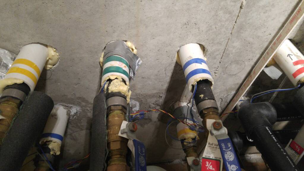

I put my header inside with shutoff for each loop. Also useful to purge with the loop pump instead of renting a purge pump. 0207181231.jpg
I also put temp sensors on each loop.
