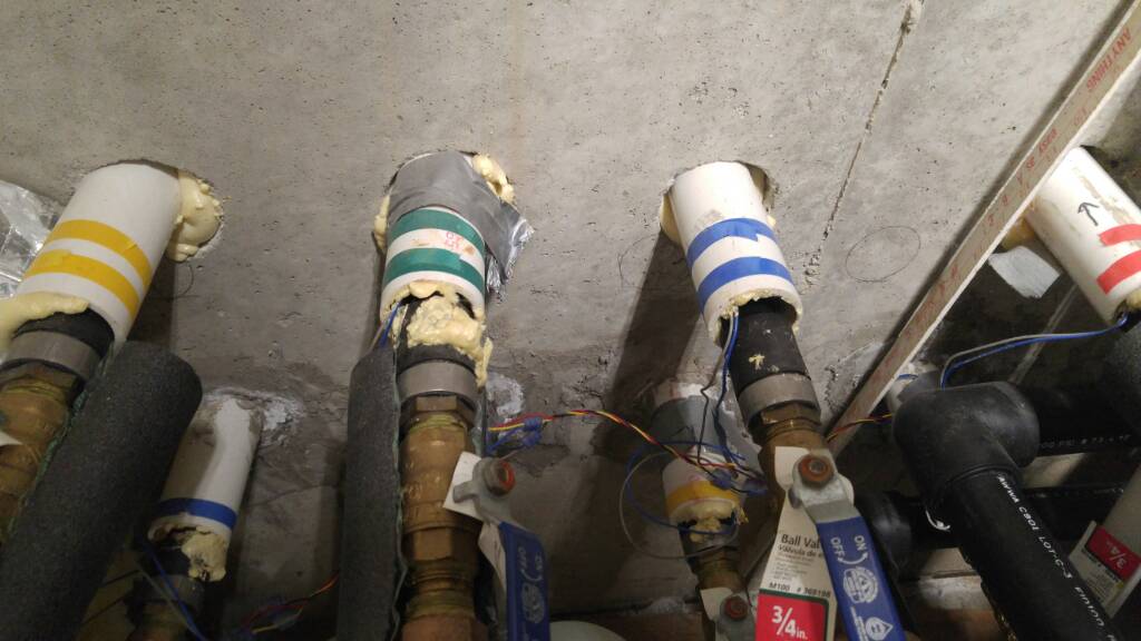

I put my header inside with shutoff for each loop. Also useful to purge with the loop pump instead of renting a purge pump.View attachment 539532
I also put temp sensors on each loop.
