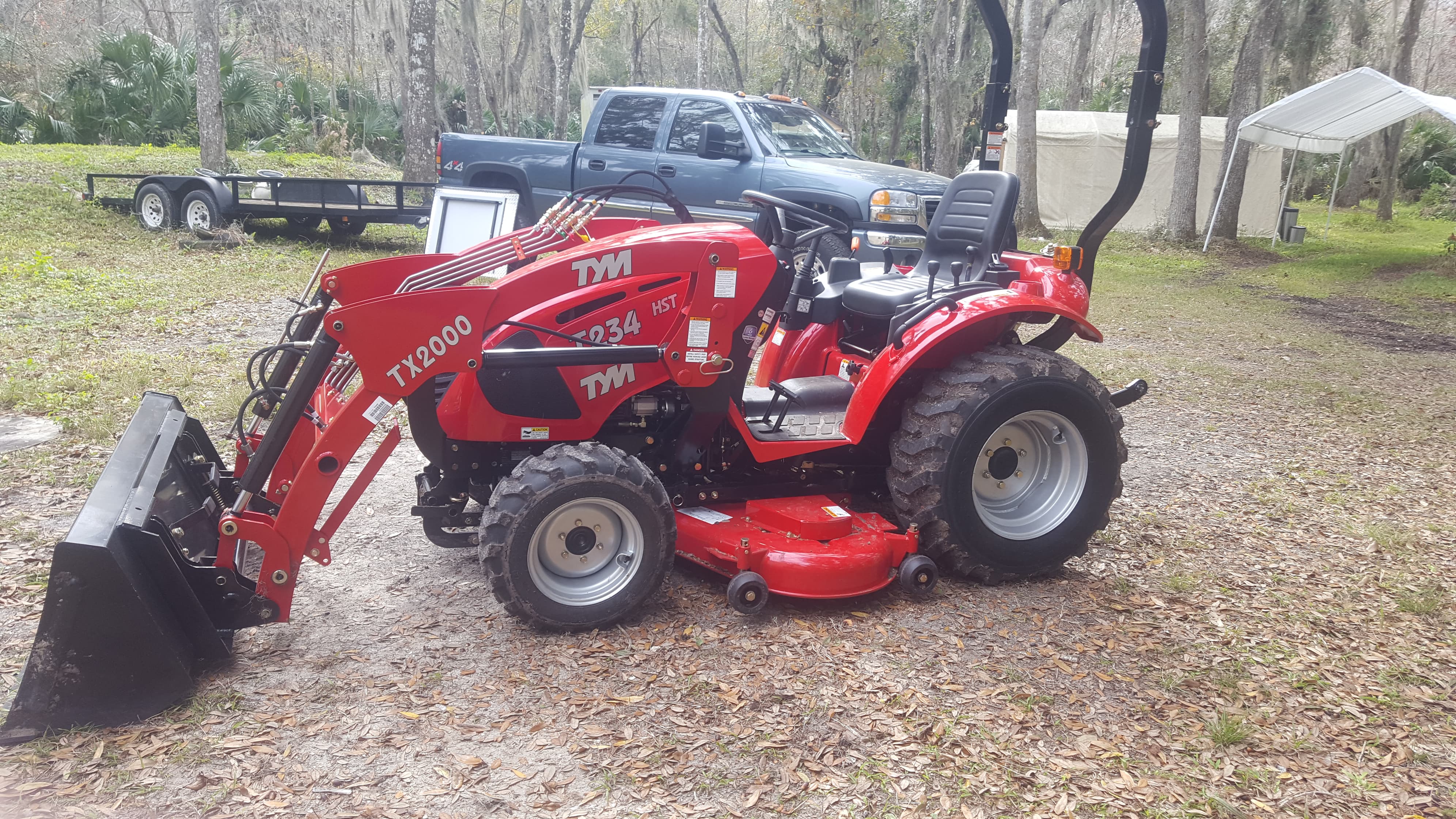

I just went from a B6100 to a new TYM T234 and so far very pleased. The price i got on the Tractor, FEL and MMM was $13,900 which was way under the prices on all the other brands. A little larger than others, more lift, larger tires, 5ft bucket and a 6yr warranty. Much more bang for the buck IMO. 50784603_2007515796214262_475077194582851584_n.jpg
