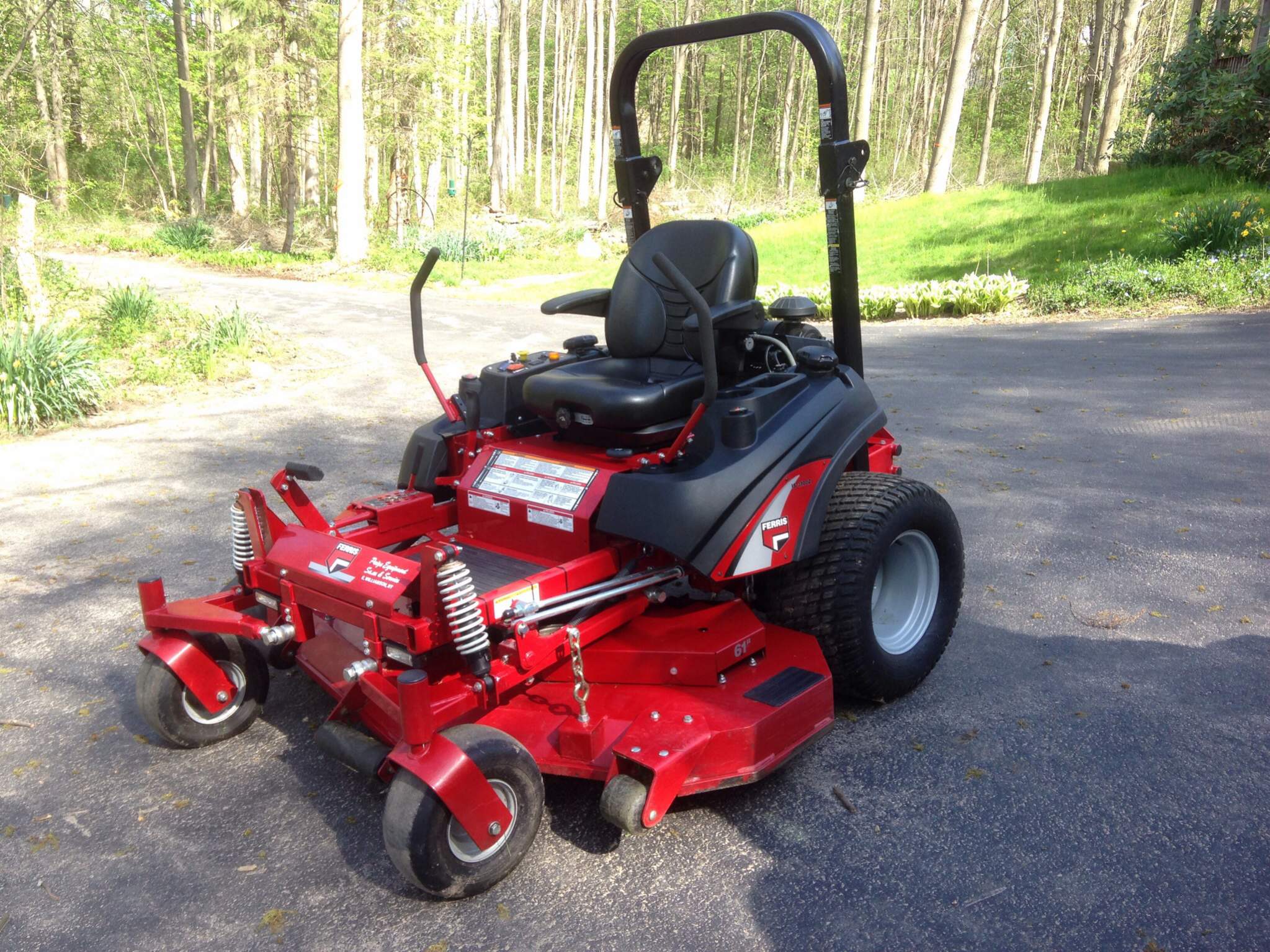

Btw, nice Ferris!
   / New BX2370-1: Great, but jarring ride #30
I know Michigan seats are used in other brands (Ferris is one) but I don't ever recall seeing Kubota selling this seat.
But as you say, you'd probably pay a premium and the bracket wasn't very hard to make.
Btw, nice Ferris!
Thanks! I think it was Gary Fowler who said it was the same seat on his Kubota when I posted a picture previously. Maybe he can chime in.
