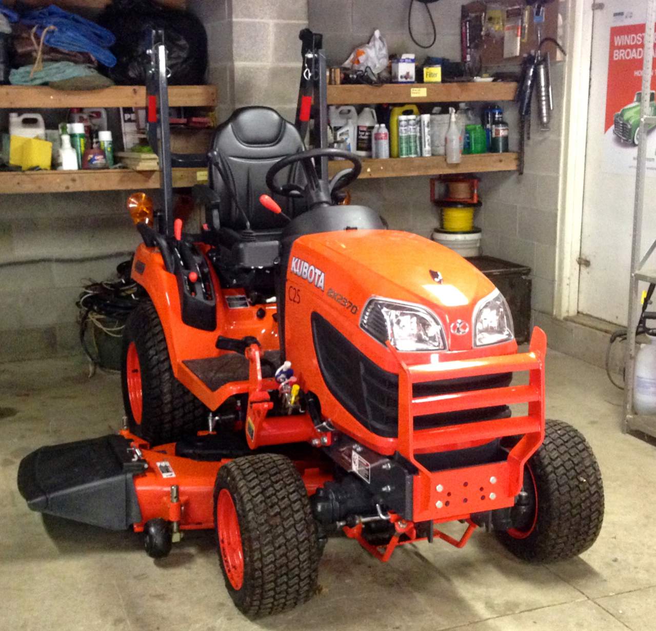

Most of your BX's suspension/shock absorption is the air in your tires. Decrease the fluid. For the smoothest ride eliminate the fluid in your tires. A longer wheelbase, wider stance, heavier, tractor with larger tires will certainly ride more comfortably. Why filled Turf Tires on a BX?
Our Ford 3000 fits your criteria for a machine with a smooth ride, which it has. The BX was purchased to do things that the Ford is too big for (the BX also replaced a JD 425 and Cub Lo Boy). I chose the turfs as my research on TBN led me to believe they would have the smoother ride and would be best in snow. The Rim Guard was intended to aid in traction when plowing snow, general stability and additional ballast for the loader. I guess I figured that the liquid in the tires would not hurt the ride. I'm not sure having no liquid at all would improve the ride enough to make it worth not having the extra ballast.

With a properly filled (70% fill) tire, I cant see any difference in the ride if both are inflated to the same pressure. With the small BX tires AND the short wheel base, it is going to ride rough. Just reduce the pressure to the minimum needed to keep the tire beads seated and it should help smooth things out. However, nothing less than a good suspension seat is going to make it tolerably smooth during high speed operation. Tractors have no give in them other than the tires and the smaller the tractor, the smaller the tires and the rougher the ride. Given the narrow spacing of the tires, short wheelbase and little bitty tires, you cant get a much rougher ride than that of a BX.

Thank you for the positive words, big bubba. We really do love the machine, or at least its versatility. It was just disappointing after my wife and I both had headaches from all the bouncing around. This is the first tractor we've owned with a FEL, albeit small. Certainly will be a nice side kick to our Ford 3000 and RTV1140. I think once we figure out the best route to take (add suspension seat, remove rim guard ballast, both, neither, etc.) it will be fine. We'll see what the dealer has to say tomorrow. Here it is tucked away for the week, minus the loader:
