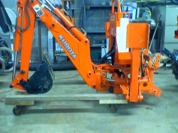

Altho it looks like a safety hazard, it's held it's own for nearly 3 yrs now and I've rolled the BH around all over the shop. Some have used a couple std moving dollies with great success also.
If you have a concrete floor, you should make that gangly space eating BH mobile, you'll be glad you did :D
I'm thinking of building this contraption.
One question: when removing the BH from the tractor, the user manual says to push the boom downwards into the floor to lift the back wheels off the ground a bit, in order to raise the tractor pins out of the BH hook thingy. Does this appy pressure to the dolly or is the boom beyond the dolly at that point (and curled up onto the dolly later on I guess)?
/ New BX24 #28
In my configuration, keep in mind I have a BX23, I use the stabilizers to raise the wheels up ever so slightly to unhook the the locks and use the boom to pivot the BH's lower mounting bracket out of the frames hooks.
I understand the BX24's BH mounts differently then the BX22/BX23 does and I'm not sure how it's done.
I do position the BH's bucket onto the dollie and apply up/down preesure onto the dollie just like it's done if the BH was being placed on the ground and I haven't had any problems.
The key is to get the lowest profile casters as possible.
The lower the better and the easier to mount/dismount.
There have been a few folks that use 2 std furniture dollies, one under the BH's main section and the other for the bucket and they've had great success with this setup also. The bucket/boom slides the dollie back & forth as needed and once the BH is fully dismounted the bucket dollie is drawn up to the main section dollie and together they make one large dollie and it's as easy to move around as a single dollie.
I've never dismounted my BH directly to the floor, with space at a premium in my shop, I knew I'd need all my implements to be mobile :D
