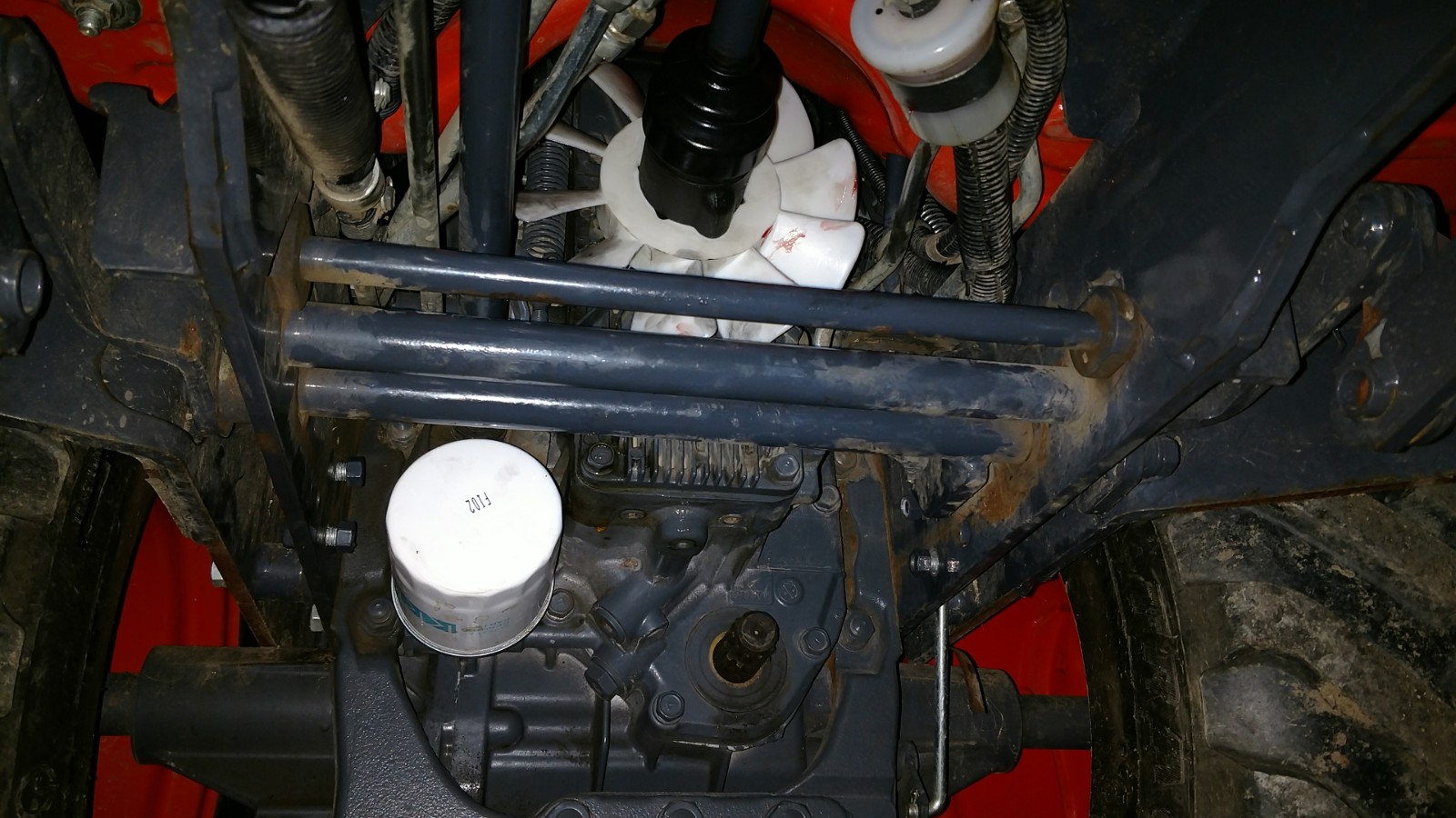

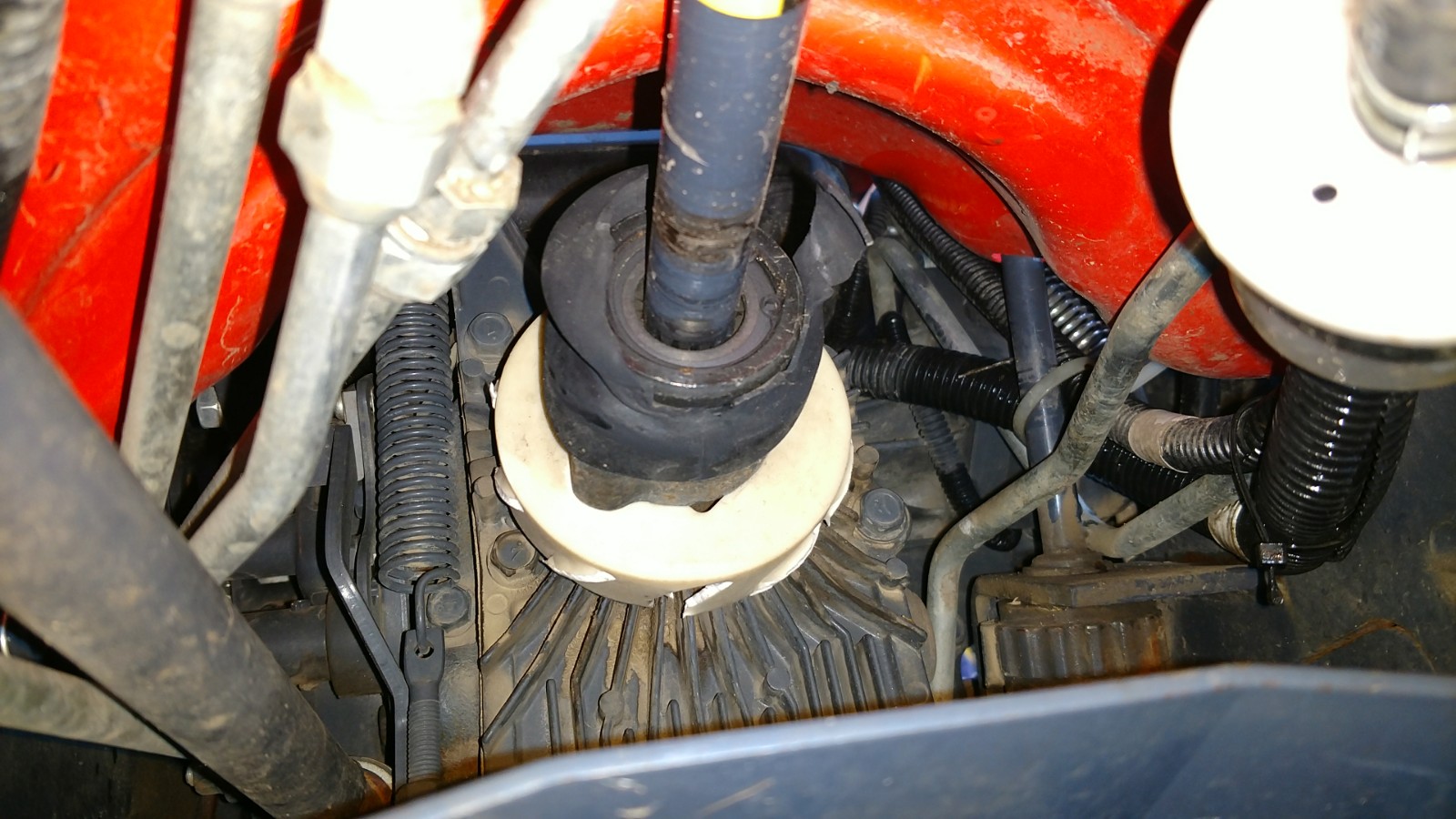

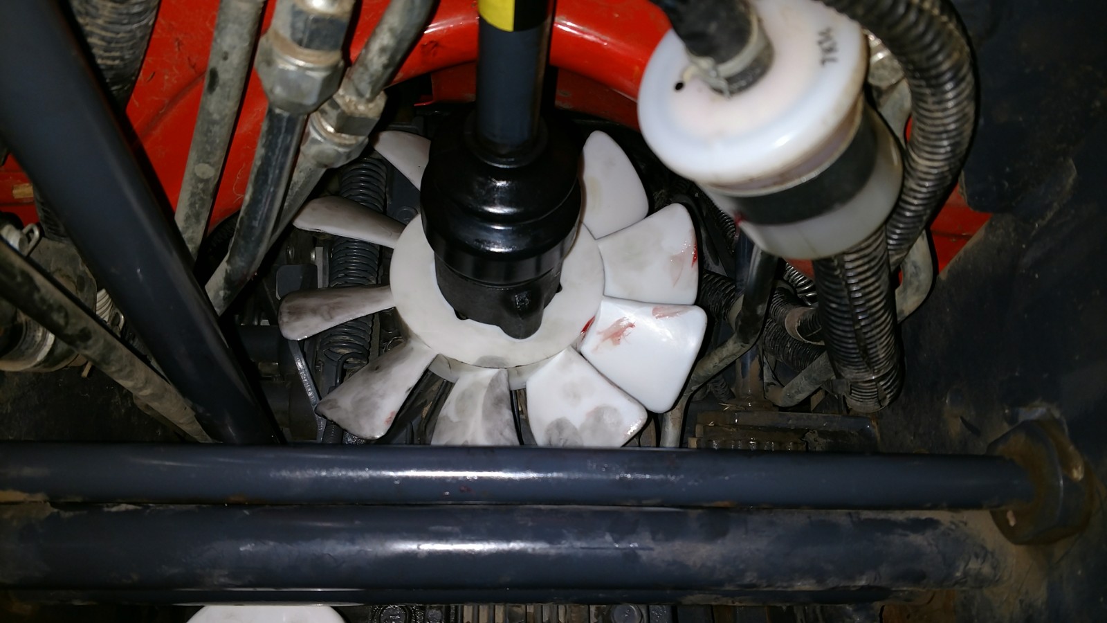

Got the stupid fan and CV boot yesterday (My father who is retired actually ran to get the parts while I was working), I was amazed! Only $6 for the fan and $4 for the CV boot!
It did take longer to get back together because I cleaned out the CV joint castings, cleaned the CV balls, re packed with Lucas "Red and Tacky" grease, had to get the rear axle casting back on with the fan in place and not destroyed... so it was 1:15 to get apart and 1:45 to get back together.

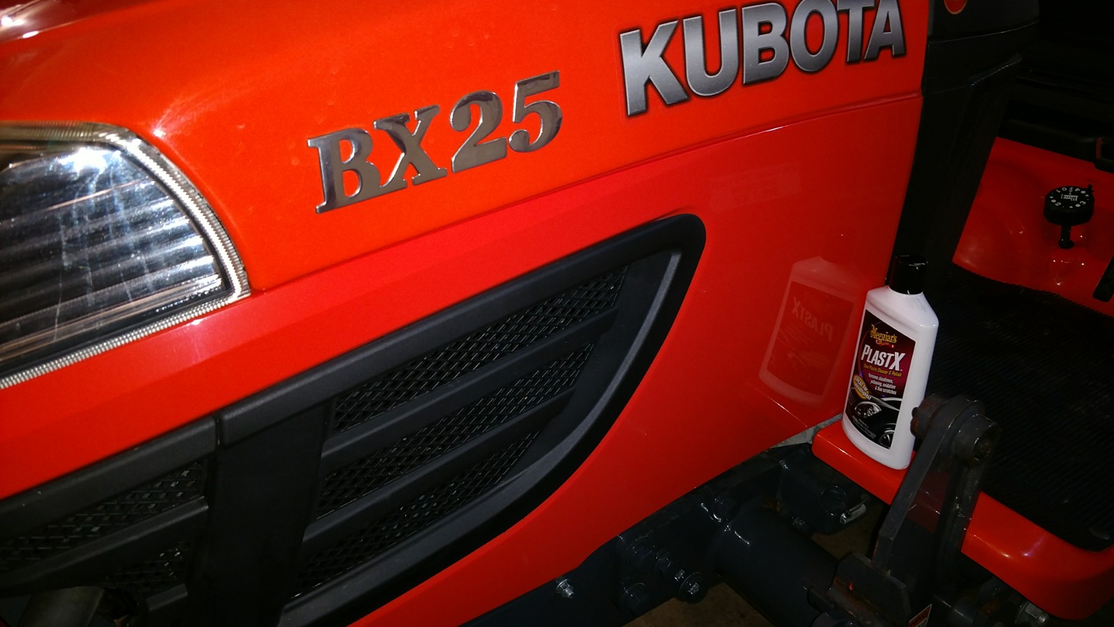

After, it was raining and I didn't want to get my Rhino wet pulling it out, nor did I want to get the tractor wet after it was just washed and waxed.... so I pulled the buffer back out and the Meguiars Plast-X plastic polish and I buffed the lower engine surround. It has a dull haze on it and was not glossy like the orange painted hood, now it looks like fresh paint! Then I took Aerospace 303 protectant and coated all black plastic and rubber to give it a dark black look and to place a very robust UV barrier on the parts.
The thing looks good enough to take to a car cruise... all I need to do is hand polish the wheels and spray some tire dressing on it and its car show time for the Kubota!
You might be able to tell... I am a hobby car detailer and I have STRONG OCD issues with cleaning machines. My garage can look like a garbage truck that shaken and stirred, but my machines tend to all get detailed every use. Cars, trucks, tractors.... all clean.

Glad to see you are liking the new toy! I know you were a bit disappointed at first. You are right in that the hydraulics are shared, so unless you really have the RPM's up, you will really notice it when you try to do too much at the same time. Also, sorry about the fan. I read all the horror stories about that before I bought my BX23S, so I ordered my BXpanded under armor before it was even out in the yard. Since then, I have heard that plate get hit a lot when in the woods. When I look under, I see all kinds of scratches on it, but nothing got through. :) I had my 7 year old on my backhoe when digging a huge fire pit. I swear in 5 minutes he had the controls down better than me. His comment was, "This is just like the digger at the park!" haha :laughing:

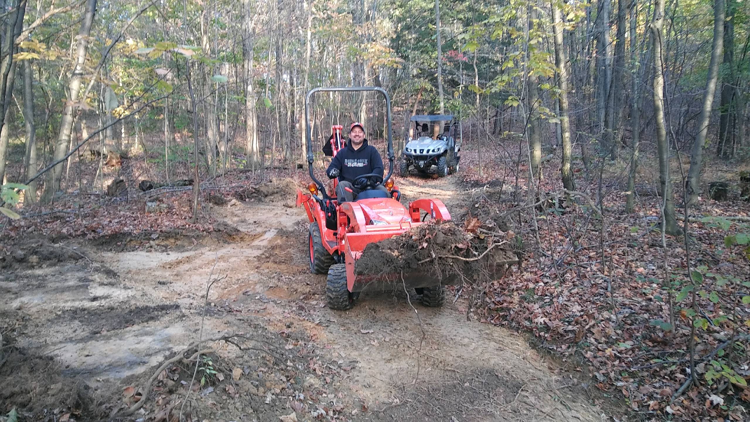

Well, I've put 25 hours on it in the week I've had it. The original owner put 93 hours on it in 4 years. I'll have the original owner beat by Christmas I bet. I'm planning to spend all day tomorrow on it fixing logging roads in my property. I'll be using the BX primarily for digging virgin dirt and moving it to fix 30 years of rain erosion on the logging roads and ATV trails as well as finish leveling out our camp fire area and build a berm for shooting. I'm totally amazed at a few things.
I'm shocked at the traction it gets on steep hills that I'm filling in and using the tractor to pack. It's far better traction with the R4 tires than I ever expected.
I'm blown away at how well I can dig virgin clay and I don't even have a tooth bar on it yet. Wow. For such a miniscule machine, it way over delivers.
The fuel consumption rate per hour compared to my Craftsman garden tractor... My garden tractor rips through gasoline. I can go out and spend 6 hours on this and maybe use 3 gallons of diesel fuel. In 3 to 4 hours on the Craftsman I can nearly kill the 6 gallon tank.
The only thing that I have as a negative is the pressure required to reverse up a steep hill, my leg was giving out on me after a couple hours. I would back up the hill to level-ish ground, dig in and load the bucket, drive down into the steep downhill and use the brake to hold it while I dump, and then reverse back up to do it again. After 2 hours, my leg muscles were crying. The steep hill requires you to nearly stand on the little reverse lever with my heel to get it to move up the hill. Amazingly, no lack of traction. But the lever doesn't want to move down with that much resistance fighting it.
I doubt the reverse issue would be any better on a larger tractor, but a 2 pedal unit would alleviate that dreaded heel pressure and leg fatigue.
Over all, I'm far more impressed with this thing than I ever could have expected. I just hope that the HST can take the steep hills and loads I'm going to give it. I live on a step hillside with even steeper ravines that I'm reworking. Let's hope these things are as tough as many of you had claimed.
