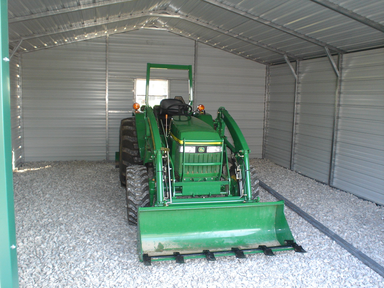

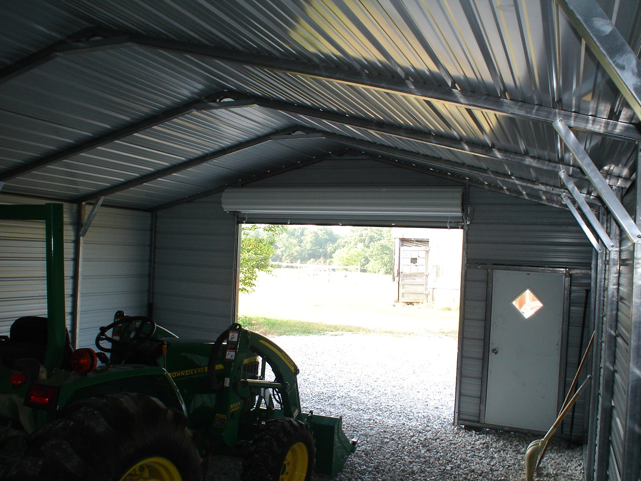

Mine is fully enclosed with rollup door; window; and walk in door. Base size is 20x26(?) with an 8'x10' door opening to get my JD990 inside. In addition to the rebar I also added the big screw in mobile home anchors along each side. This Fall I reinforced the roofline where it meets the side wall because of high winds hitting the building sideways caused the roof to constantly chatter.

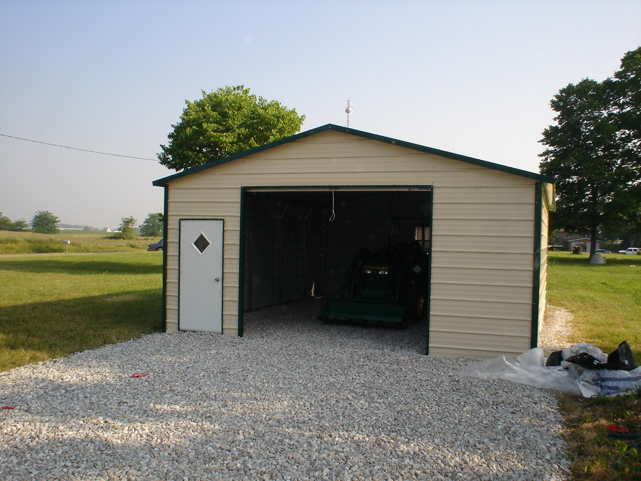

PSDStu - Here is an excerpt from my prior thread......
http://www.tractorbynet.com/forums/projects/101201-new-home-my-990-a.html
Started with a basic setup from All-Steel Carports, then enclosed all the sides and cut in and mounted the doors and windows using low-rent mobile home type hardware. The normal wall height is 5' so I had to upgrade to get the 8' clearance for the 8'x10' rollup door (which goes up nicely and tucks out of the way leaving a lot of room inside) with a rough price of ~$3800. I had some quotes for a pole-barn that started at $10k-12k for the same size building so decided to go this way. Added mobile home anchors that are bolted on the inside steel frame and drilled into the ground about 3' deep. By the way, putting up one of those rollup doors is a real back-breaker since you lift the whole assembly (rolled up) to the header to mount it on brackets.........sweated that one.
One added benefit of this approach is that the county building inspectors don't require you to get a building permit, and this type of construction is considered a "temporary" building (no fixed foundation/footers) = no property taxes applied. Also it will allow me to actually move the building if we ever wanted to at a later date.........which also eliminated a lot of hassles with the Mrs. regarding deciding exactly where to put the building.

I bought mine from gaport.com They don't list Vermont but you can look at another state to figure options. I got the vertical roof and boxed eave style. I does not cost much more to go taller. I even went 5' longer. JC
