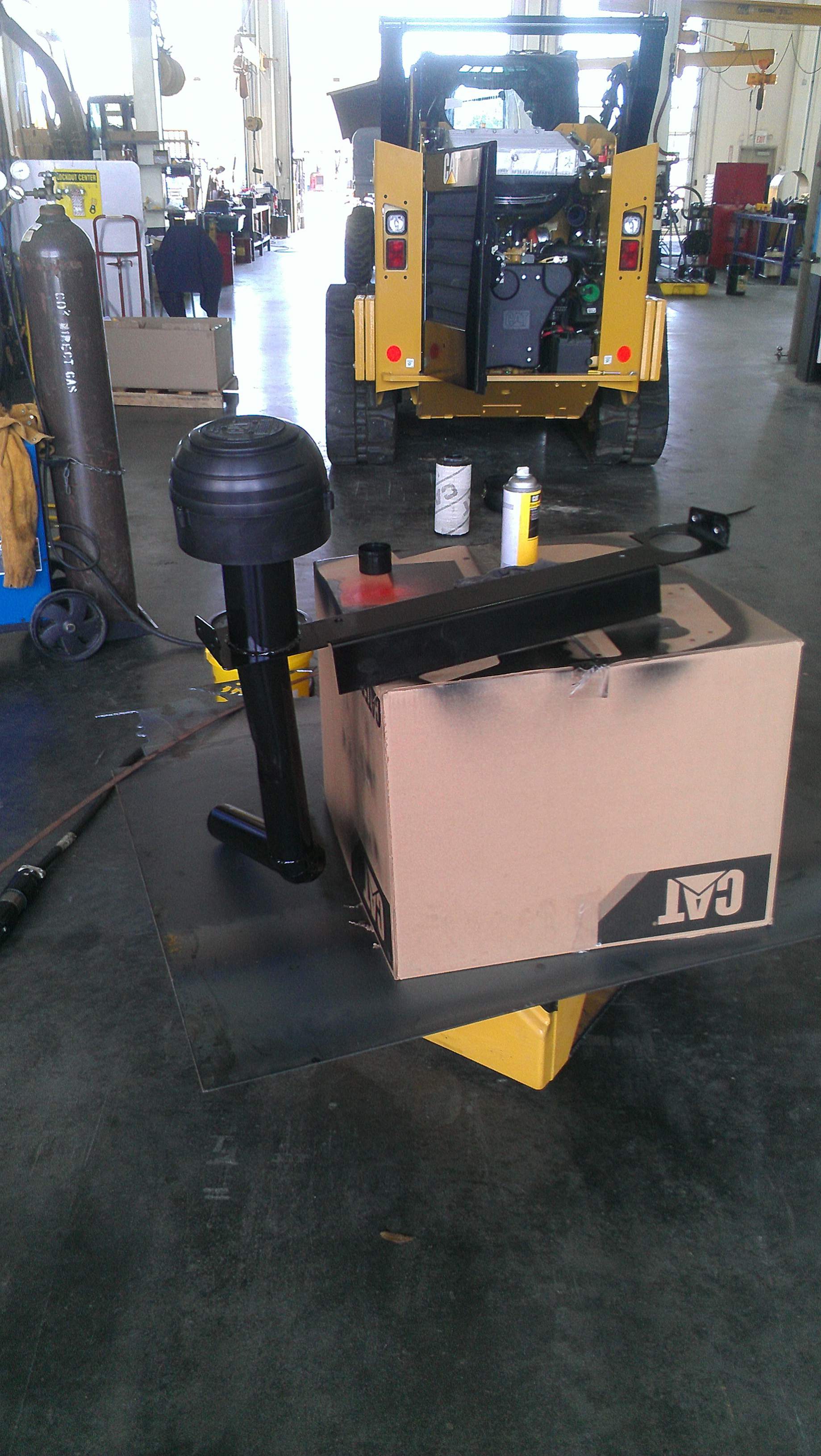

Working on a new 299D that a customer ordered.... like everyone knows the debris barrier kit is unavailable and no one knows when it will be available............ so i built one of my own design. it is still a work in progress but i got the side guards done today (that Cat has no interest in offering
for some reason) along with some of the door seals.... gona be doing a exhaust guard and also doing the intake with dust bowl but its gona be up behind the cab instead of over the radiator cores so you dont have to remove the bowl to lift the cover like the Cat kit does.

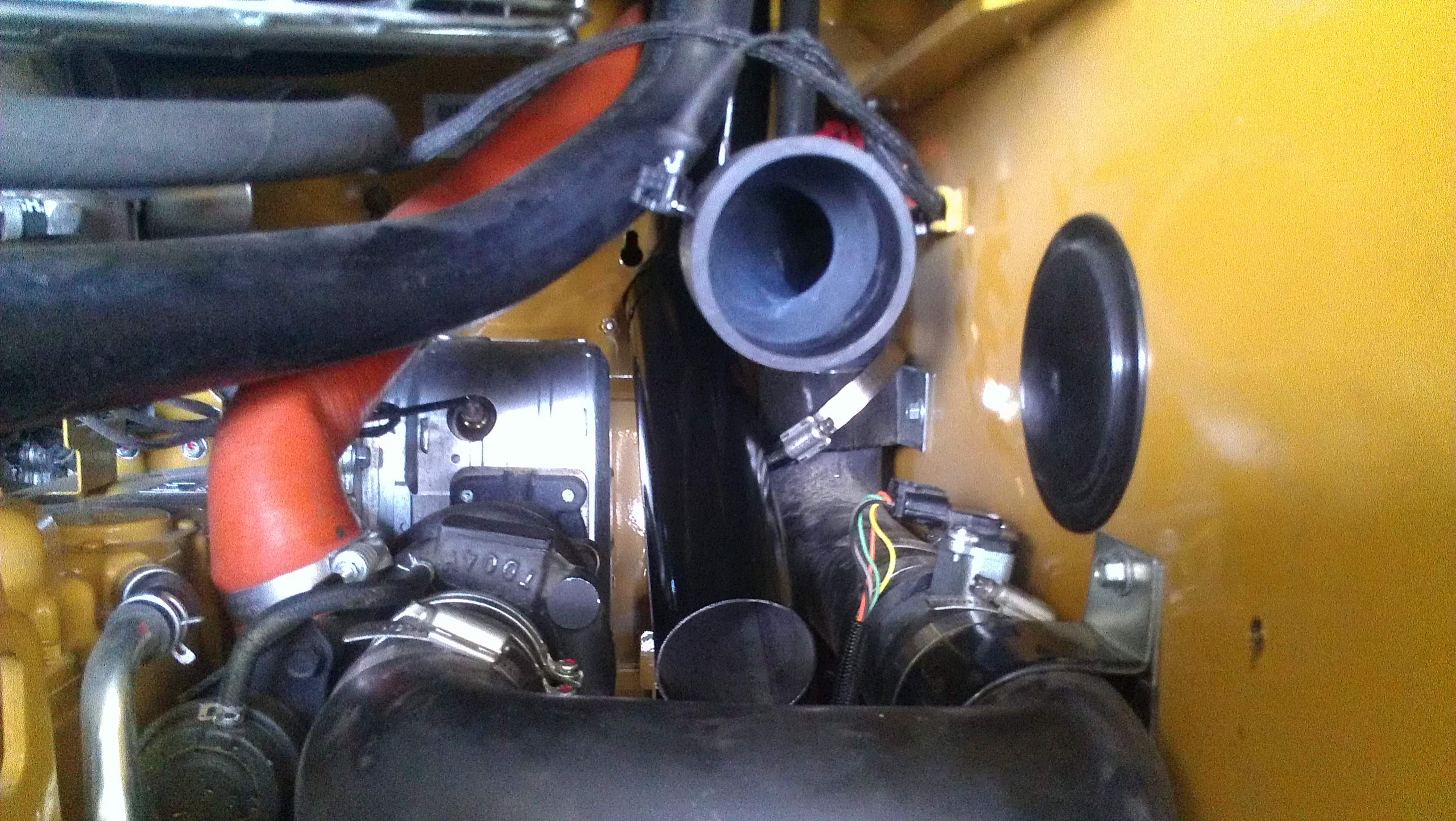

finished the intake system today, $15 worth of pipe and about a hour time and alot cheaper and alot better than the Cat setup........ dont have to take the bowl off the lift the rad screen and plus it up high away from the hot fan air and dust but tucked behind the cab so it wont get knocked off....... have to finish the seals up ontop of the engine cover and do the breakin on the machine and its off to be abused by its new owner!!!!
   / New Cat 299D XHP #45
forgot to take a picture if the turbo blanket.......******........ made a cover out of stainless and covered it in lizard skin and dynamat to protect the intake pipe and filter from heat and also protect the turbo from debris.....can run the machine full speed for 20 min and hold your hand on the sheild the hole time.

Does the pre-cleaner interfere when the cab is tilted back?
