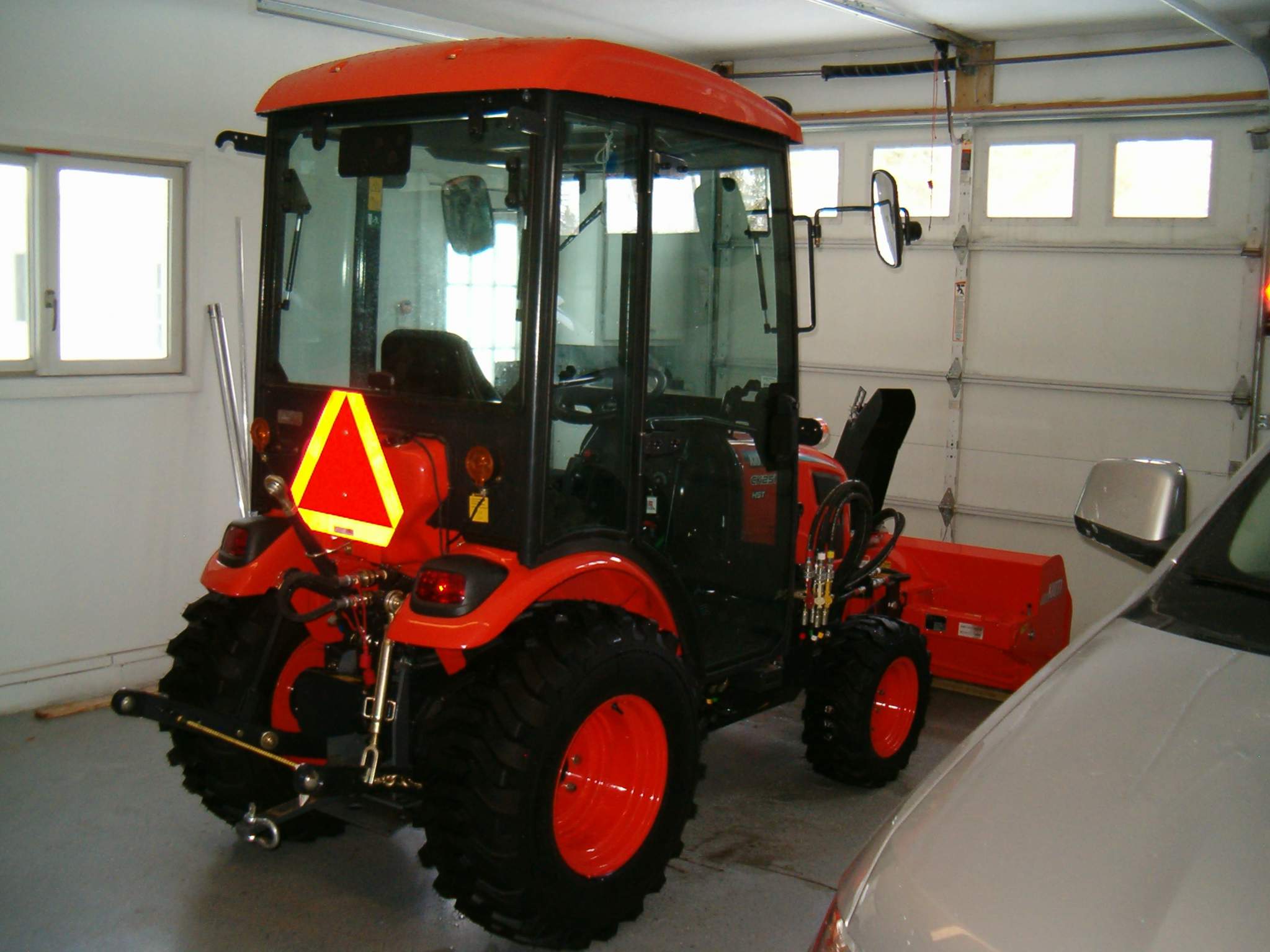

After putting over 1600 hours on my hard working ck20 I purchased the new 2510. This one has a front snow blower, FEL. backhoe, cab and box blade along with a set of forks. I have about 180 hours on the ck 2510. It's my pride and joy.

HPIM6839.jpg here we go again
this one the old ck20 got a boost from phiotoshop

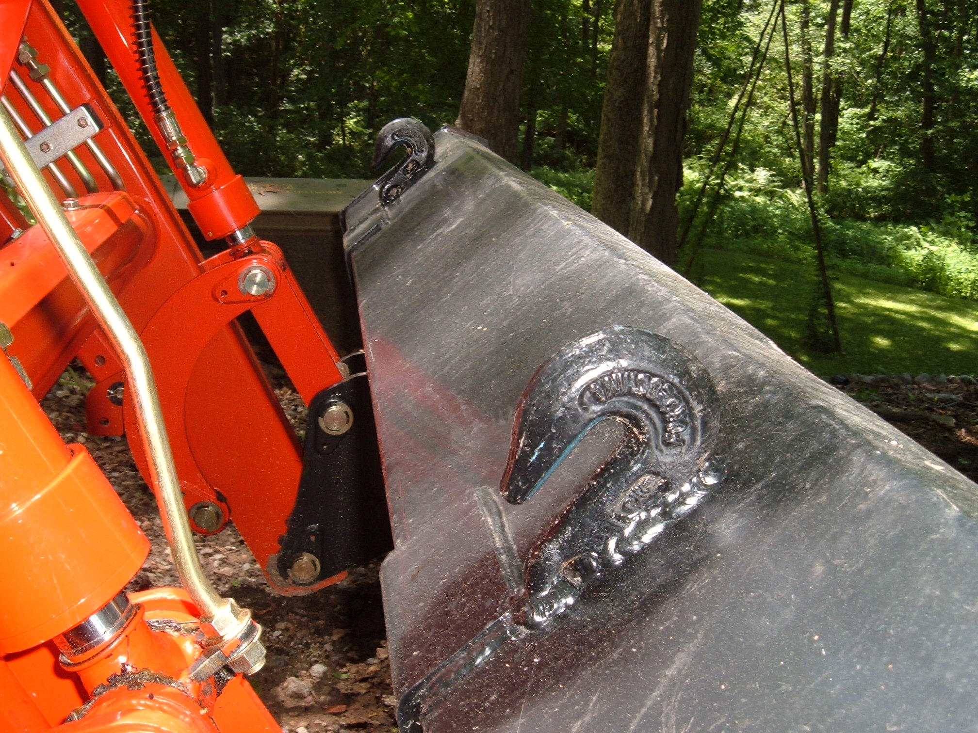

I had two grab hooks welded on the bucket. DSCF1080.JPG Good for lifting all sorts of things.

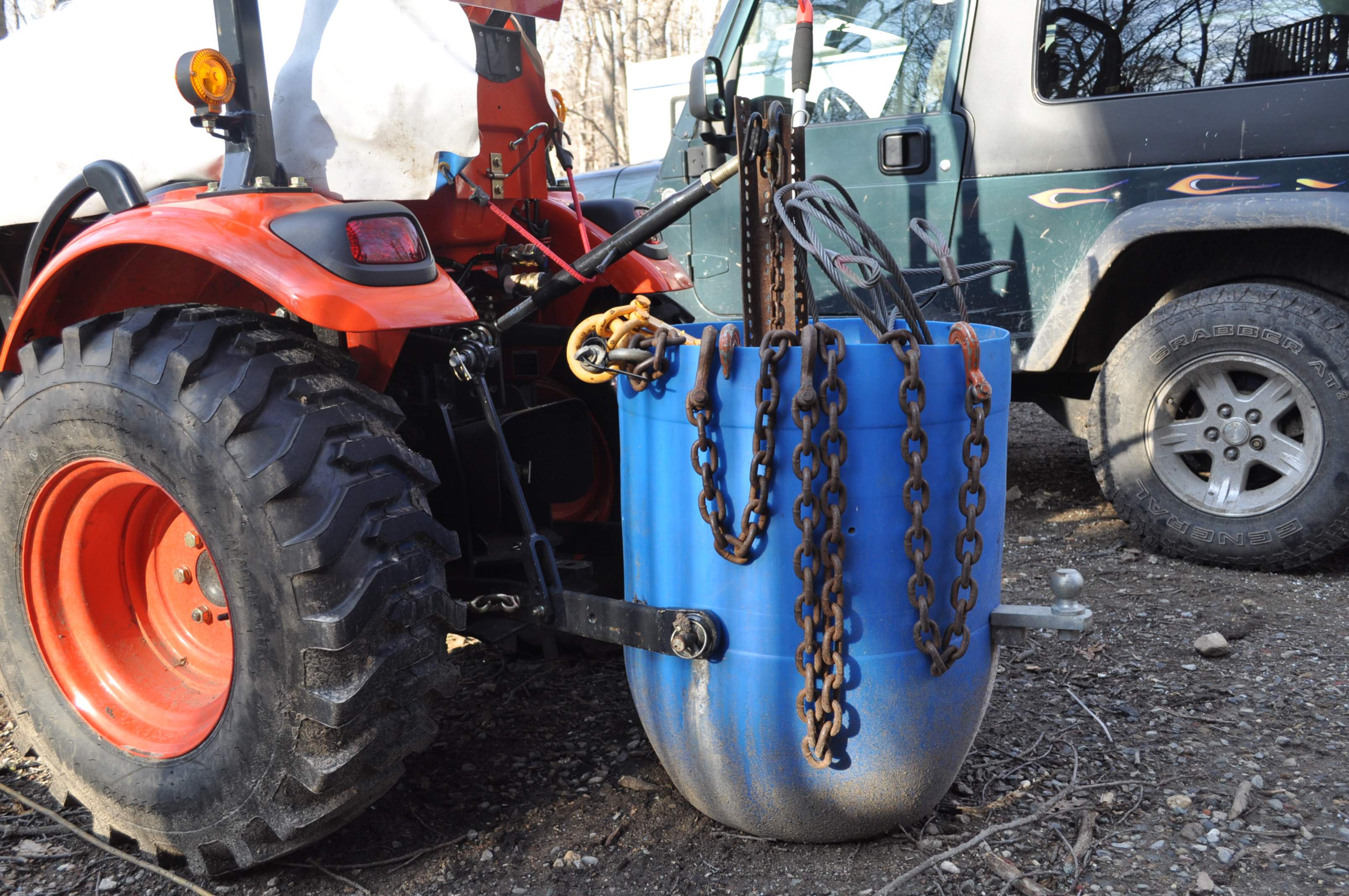

I also made a ballast bucket for a counterweight. DSC_4180.jpg It's a necessity. It also holds my chains etc.

I first welded a piece of heavy c-channel to top of bucket then welded grab hook to c-channel this way no risk of bending top of bucket with heavy load
/ New CK2510 owner #18
The CK2510 doesn't have the lift capacity to bend the bucket. It can only lift 1,092 at the pivot point. If you figure the bucket weighs 100ish that's about 1,000 at the pins, maybe 800 at the leading edge, so 400 per hook. I worry more about the pallet forks bending the bottom. But I don't lift big loads.

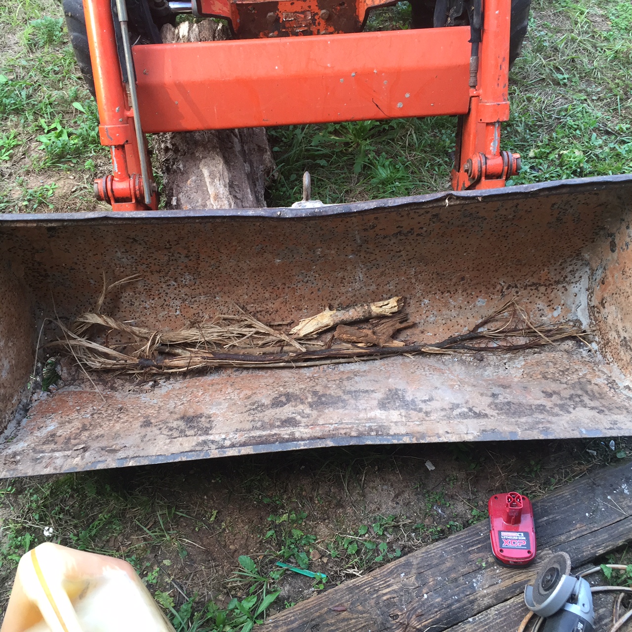

Hey Buggs...
Here is a picture of the loader on my CK20..
As you can see the top and bottom are bent. The previous owner put a single hook in the middle and it has been used to lift things to the capacity of the loader and hence the top edge is now bent...
Rancho
