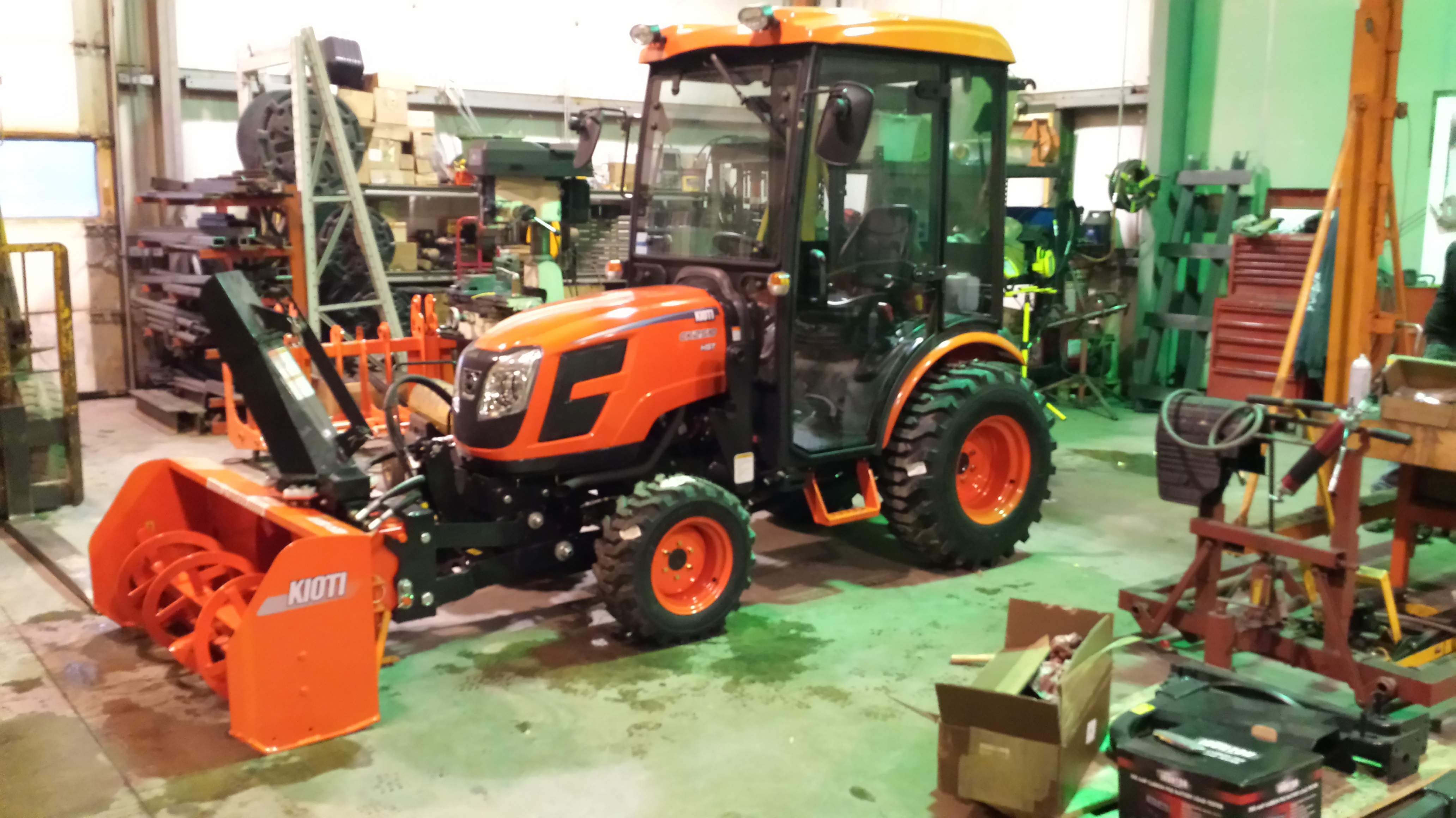

   / New CK2510 owner #11
having troubles but will get it straightened out later....hopefully

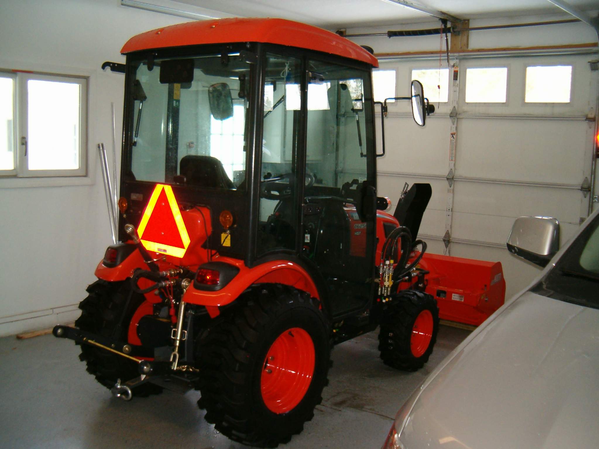

oh and TJP89, the arrows for the hazards light up fine on the dash, just the Hazard triangle doesn't light up.
Not sure what you mean by the triangle. The only thing that supposed to light up are the dash arrows and the lights themselves. The symbol on the switch doesn't light up, nor does the reflector on the back. As far as I know, there isn't a "hazards on" indicator light on the dash, besides the arrows. At least on my tractor.

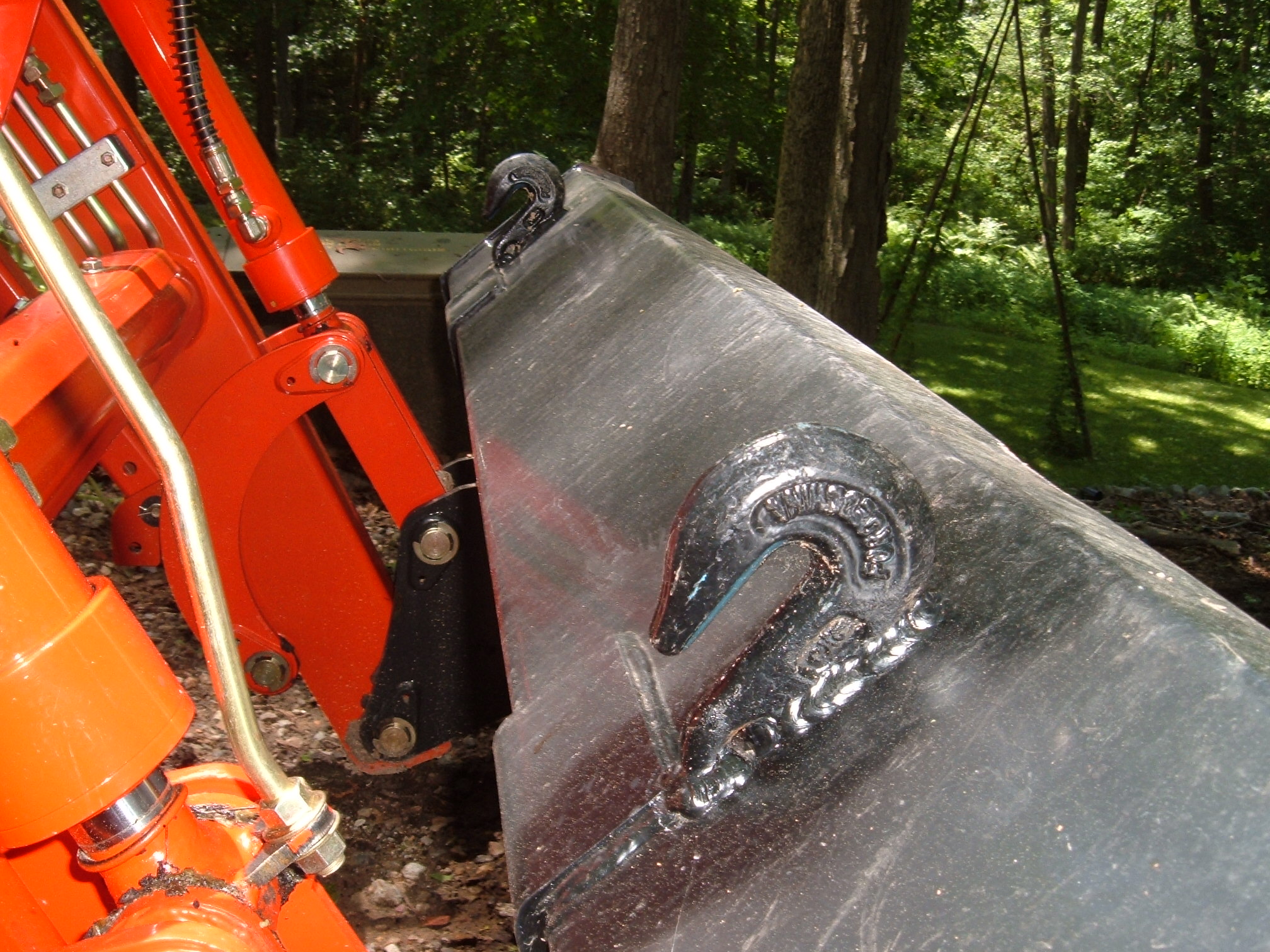

I had two grab hooks welded on the bucket. DSCF1080.JPG Good for lifting all sorts of things.

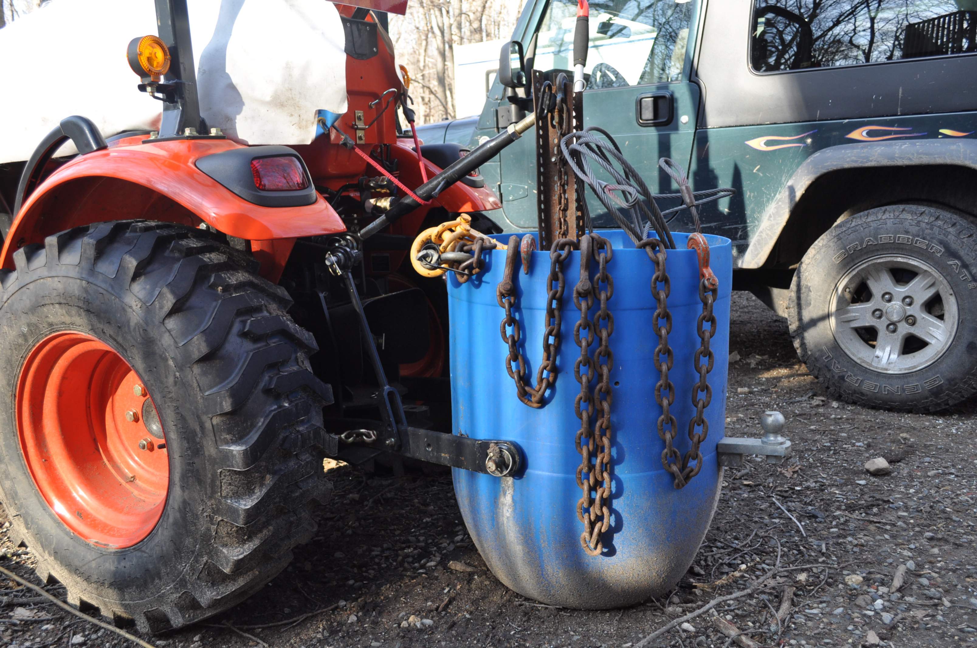

I also made a ballast bucket for a counterweight. DSC_4180.jpg It's a necessity. It also holds my chains etc.

I had two grab hooks welded on the bucket. View attachment 449354 Good for lifting all sorts of things.
I also made a ballast bucket for a counterweight. View attachment 449355 It's a necessity. It also holds my chains etc.

Bugs, you may want to consider mounting the rear light(s) on the ROPs, not next to the SMV. I've found that with some implements, like the carry-all, with the 3PTH up, completely block the light on the rear. I think I will mount two more lights behind the forward facing ones on the ROPs, facing backwards. That way I have full illumination in back, and the one by the SMV provides great light for hooking up implements in the dark.
   / New CK2510 owner #16
My plan was to mount all three lights to the underside of the ROPS; the front ones more to see the way and the rear one to illuminate the rear implement. All three are 27w led flood lights.

I first welded a piece of heavy c-channel to top of bucket then welded grab hook to c-channel this way no risk of bending top of bucket with heavy load
   / New CK2510 owner #18
The CK2510 doesn't have the lift capacity to bend the bucket. It can only lift 1,092 at the pivot point. If you figure the bucket weighs 100ish that's about 1,000 at the pins, maybe 800 at the leading edge, so 400 per hook. I worry more about the pallet forks bending the bottom. But I don't lift big loads.

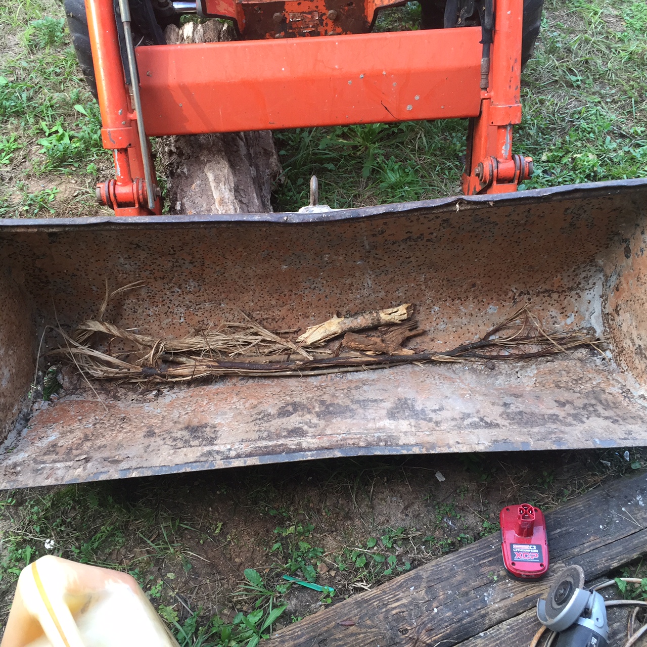

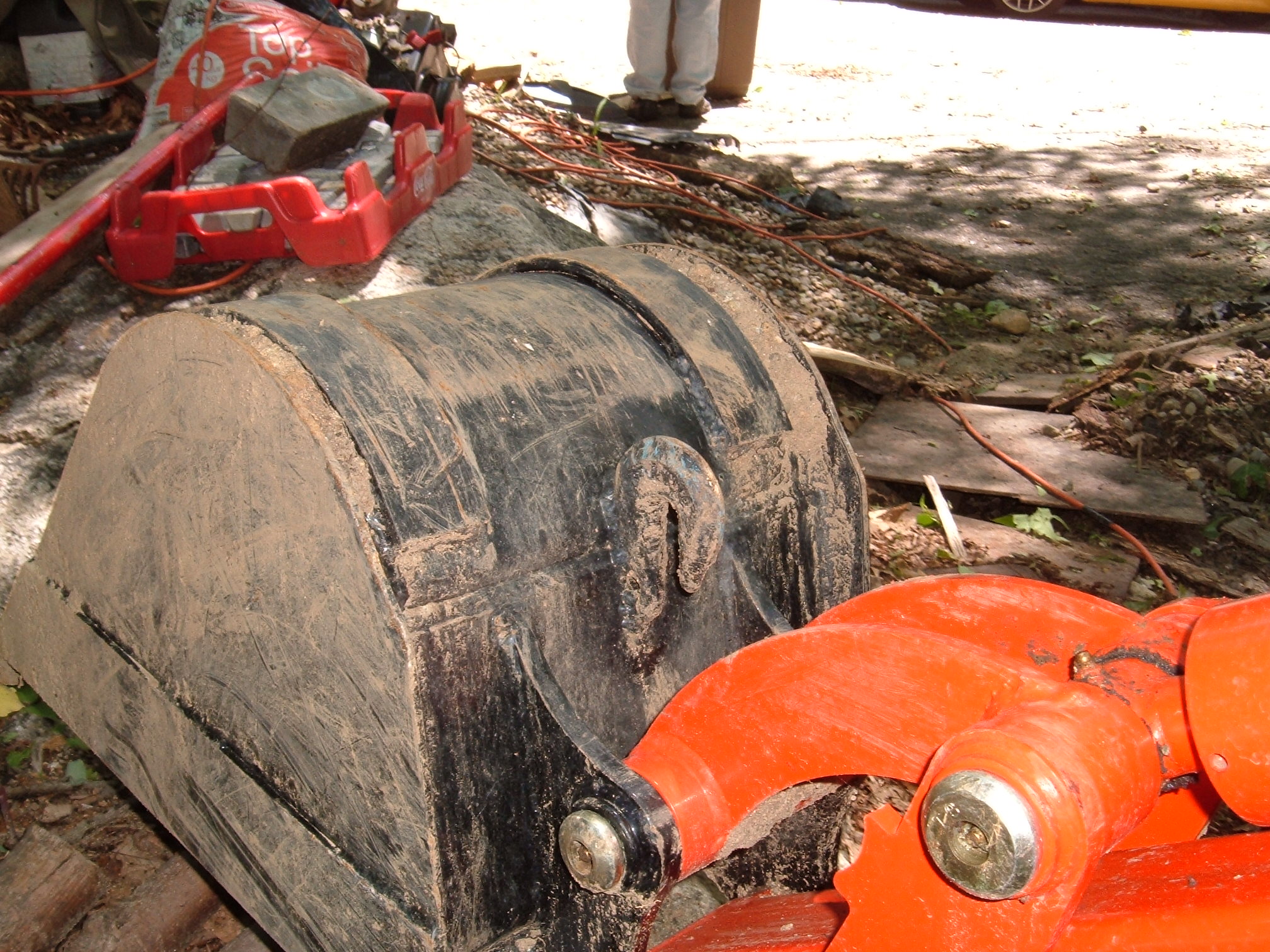

Hey Buggs...
Here is a picture of the loader on my CK20..
As you can see the top and bottom are bent. The previous owner put a single hook in the middle and it has been used to lift things to the capacity of the loader and hence the top edge is now bent...
