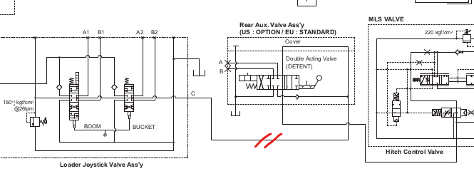

I think I know what needs to be done. I found a copy of the service manual and figured out the piping from it.
There is a long adapter bolt fitting going into the rear Aux valve ass'y, where I have the red lines. If I remove the rigid line on it and connect my hose to it, place a 90 on the rear Aux valve ass'y. This would be the best place to tie in at, what do you think?

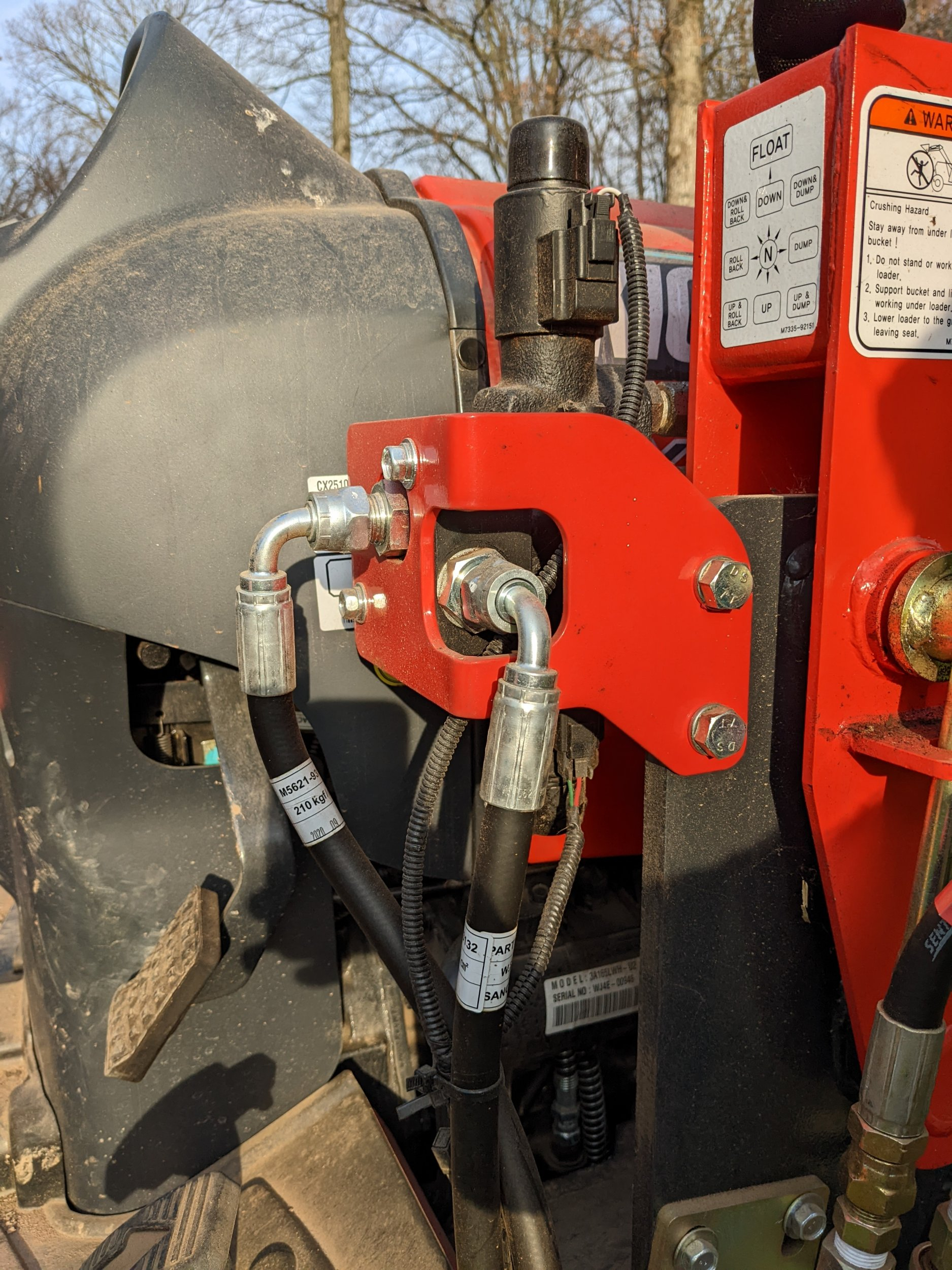

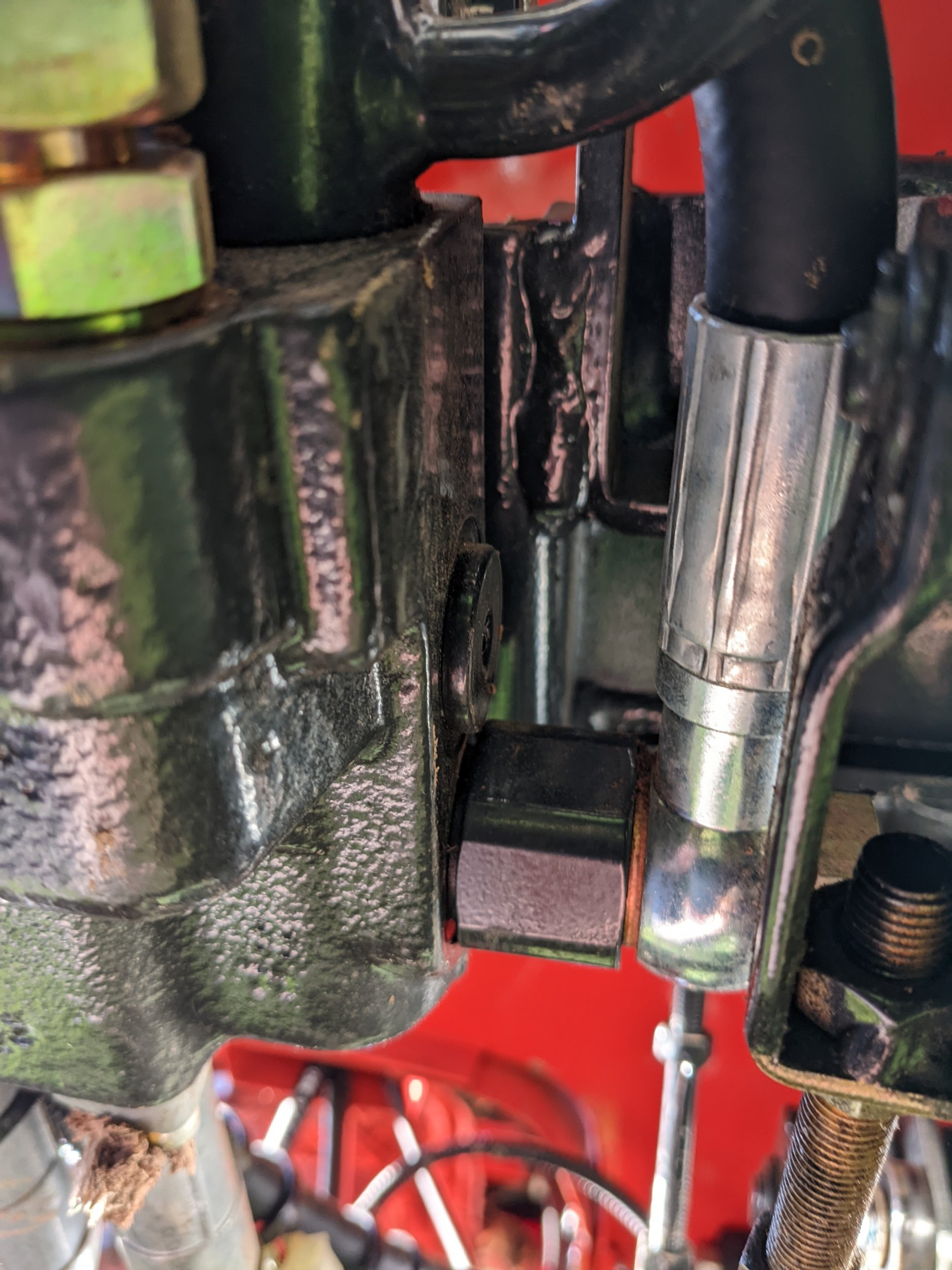

#74
Here are the pics of my Kioti 3rd function. The first 2 pictures are from the main hydraulics under the right side of the platform. The silver ended hydraulic hose goes up to the 3rd function valve shown in the third pic. The other hose off the 3rd function valve goes under and towards the back of the tractor.
The other hose goes back under your seat to your rear aux?

This might help a little with that.
Your third function is tied into your power beyond, so when your controls are in a neutral position fluid flow though the port and your third function can work, and all fluid your third functions not using and when your not using it continues back to the next spool. That is your rear aux, then hitch control valve, and then back into the return line.

It’s in Iptman’s picture. Your HOSES replace the long pipe from the loader control valve to the transmission under the seat, the third function control valve is placed essentially in the middle of the old hard pipe. Hopefully this helps.
I can try to add more pics from what Iptman already added if it helps. Removing the long hard pipe was sort of a pain. I tried removing it without removing all the body of the tractor the instructions said to and I couldn’t get the pipe out till all the parts were removed.
