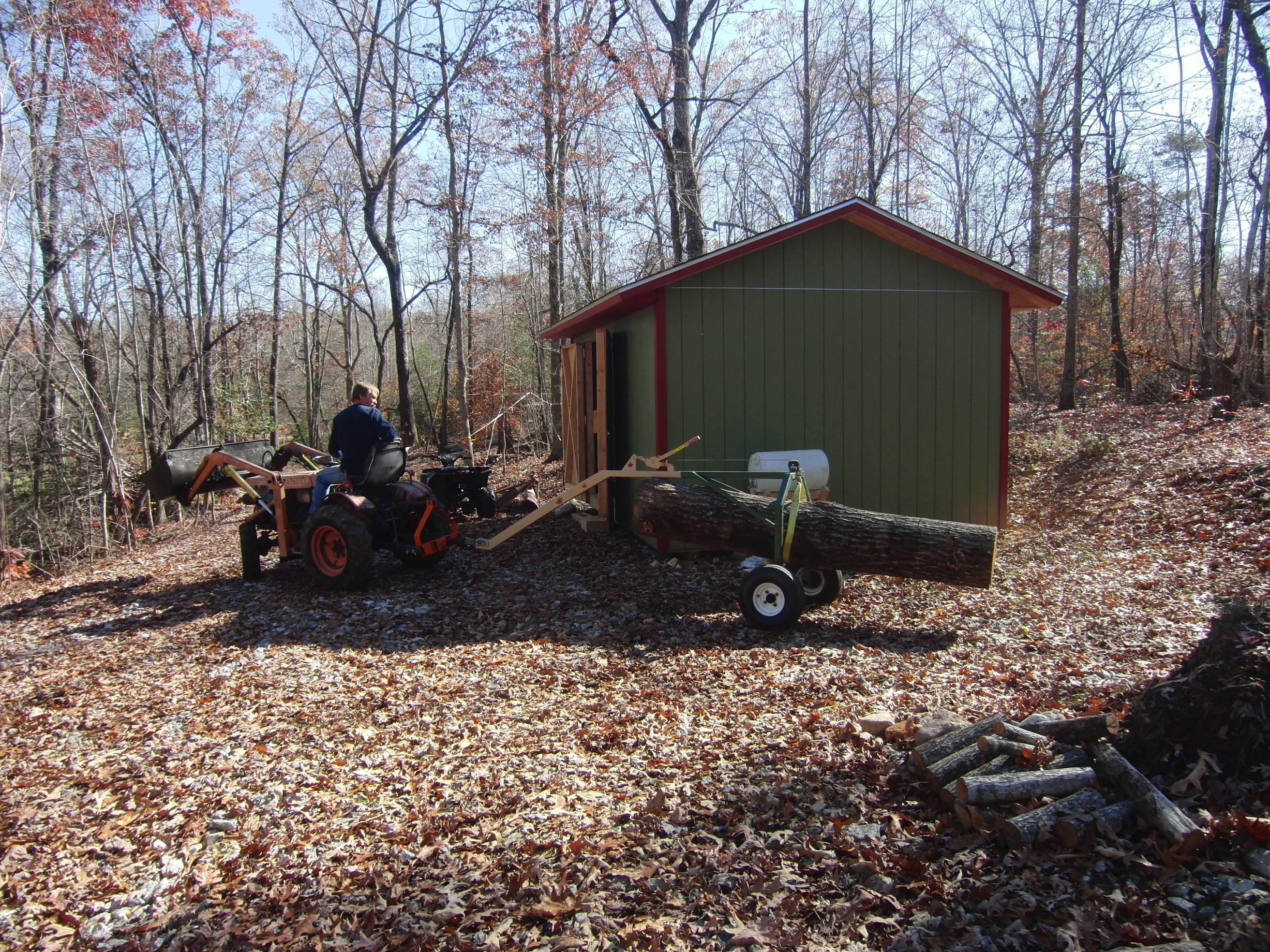

I also put 4" x 4"s under it when I put it together.
It is in the background in this picture
