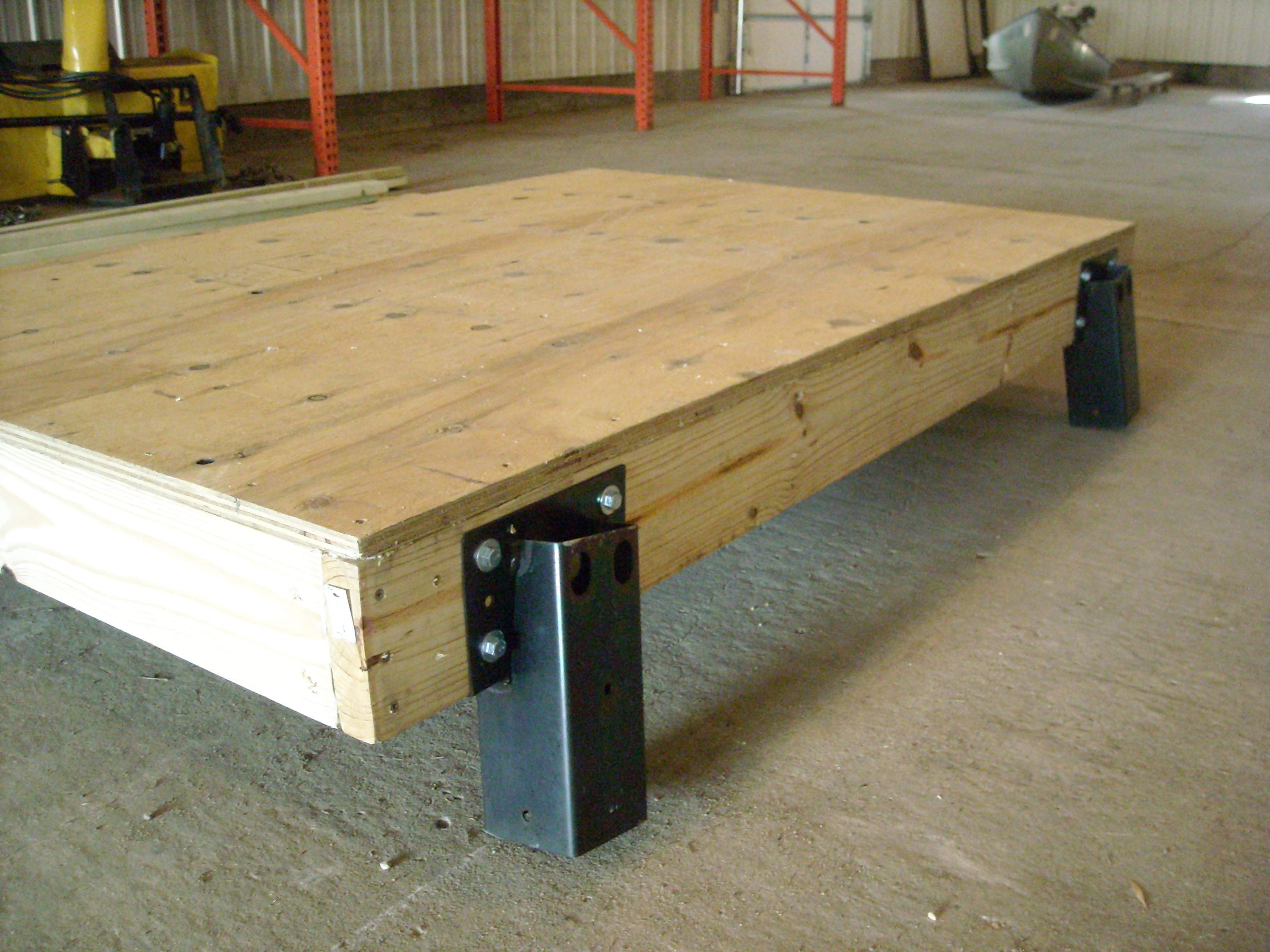

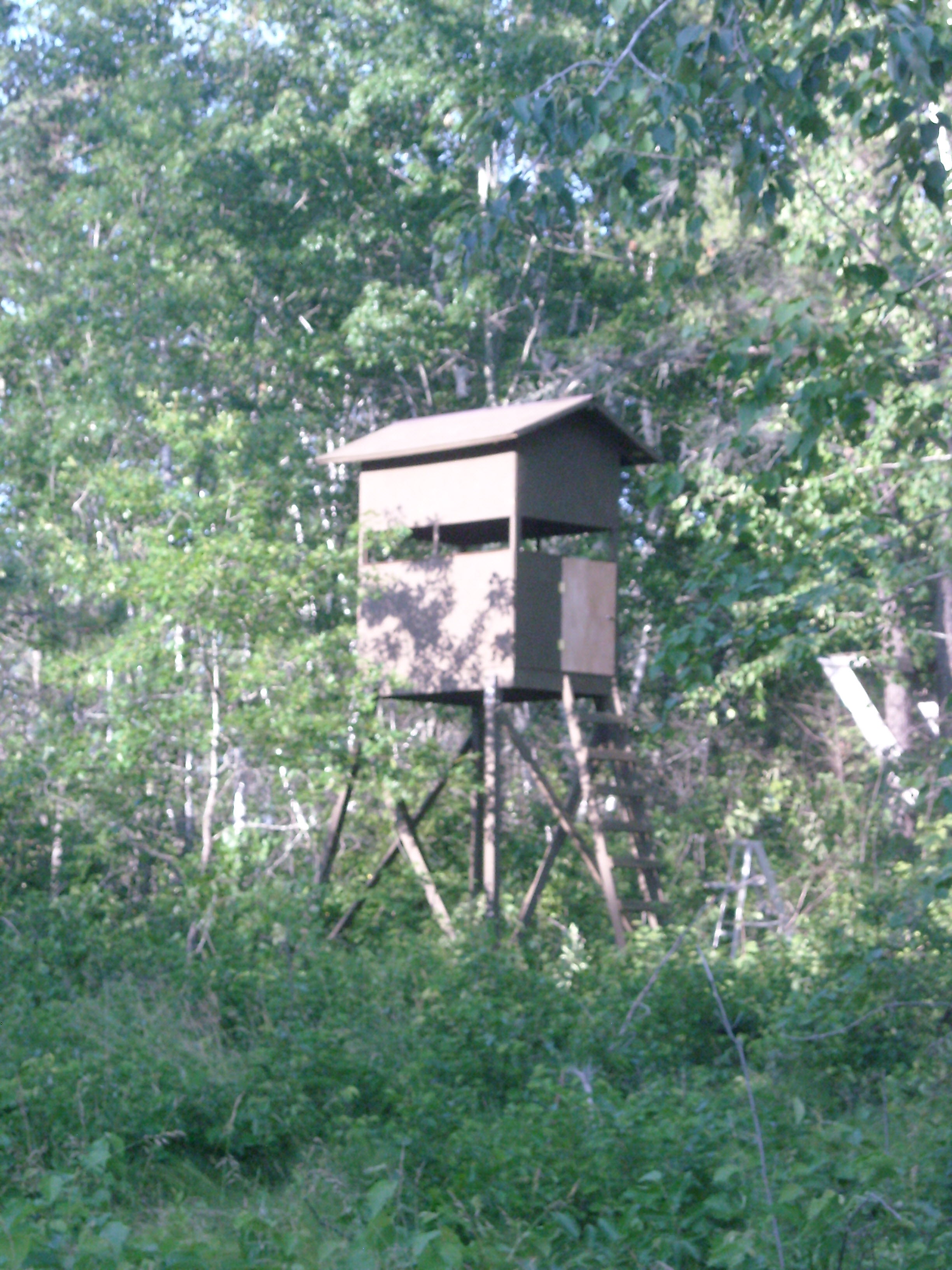

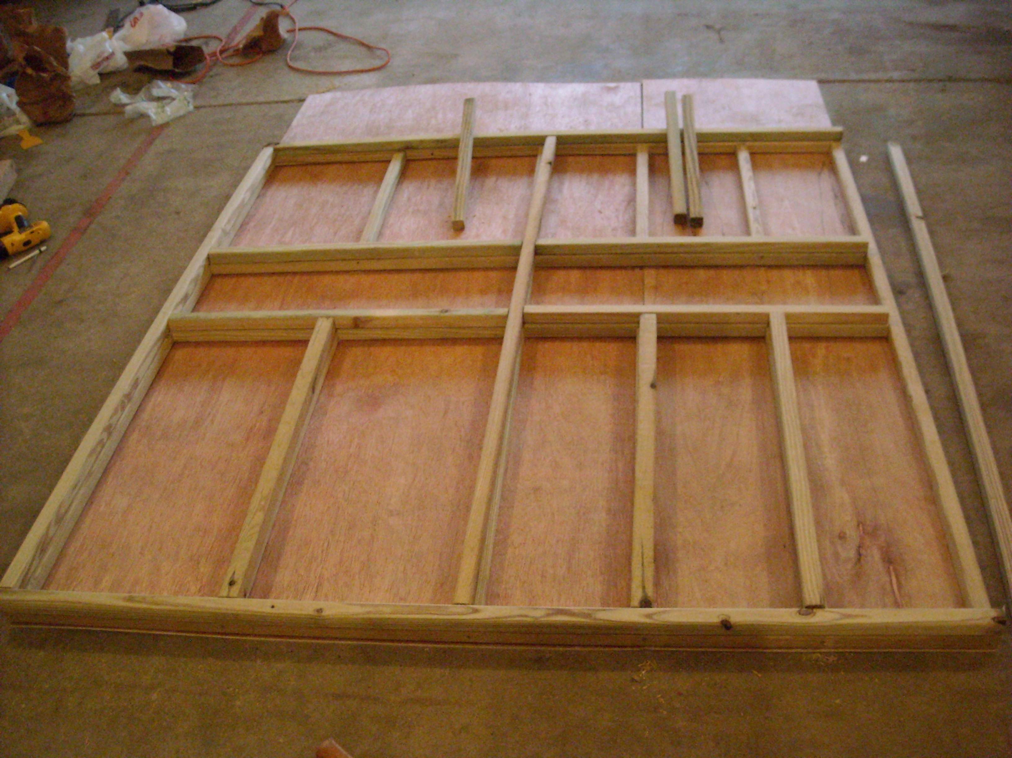

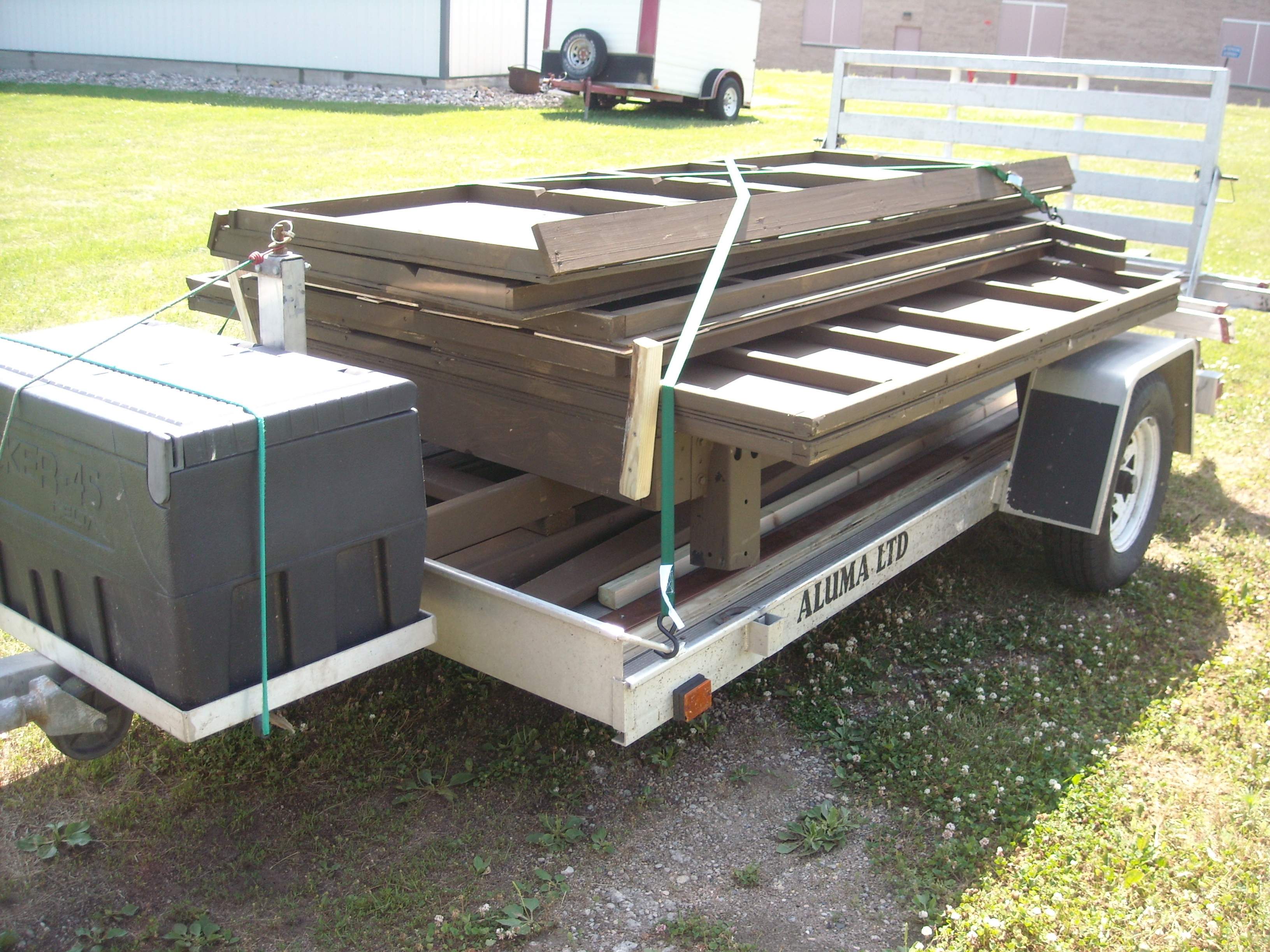

I recently built a 4x6' two man deer stand to use with my grandsons. I first built it in sections on the garage floor and pre-painted the whole set up.....then hauled it to my land and assembled it in about two hours. All the dimentional lumber is treated.....and the plywood sidewalls are 1/4" luan with a good coat of paint (I hope it holds up). The door still was not painted when I took the last photo. It's sitting on 12 high 4x4's and we used elevators for attaching 'em. The lowest point on the roof (inside) is 6'4". The windows are 37" high at the bottom (after much research....just right).

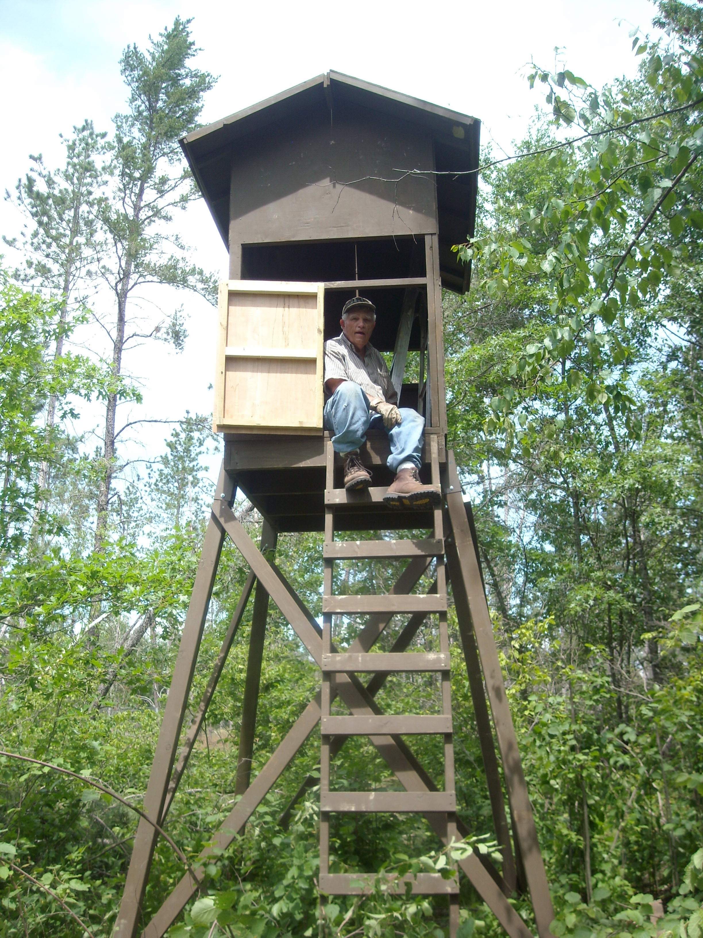

A few more pics...... I used adhesive and screws or ring shank nails for all assembly to keep down the squeaks. It was a challenge getting the two roof pannels up on the house with just me and my wife.....but the winch on the 4 wheeler and the tractor loader got 'er done. I later bent a 12" wide x .019 aluminum flashing for a ridge cap. At this point I am relying on treated plywood and paint for my weather proofing on the roof....but may shingle next year (?). The total cost with elevators and paint and fasteners was about $600. .....which is more than I figured. I have bought some pre-fab houses for similar prices (as shown)....but I like the size of this one....especially for two people. The fold-down plexi glass windows will be installed soon. (and are included in my cost)

Ooops....pic of pre fab house didnt go with last post. I am going to add a brush pile to help "camo" this stand. Note the "trap door" set up. Pretty safe for the young kids......and us old duffers too.

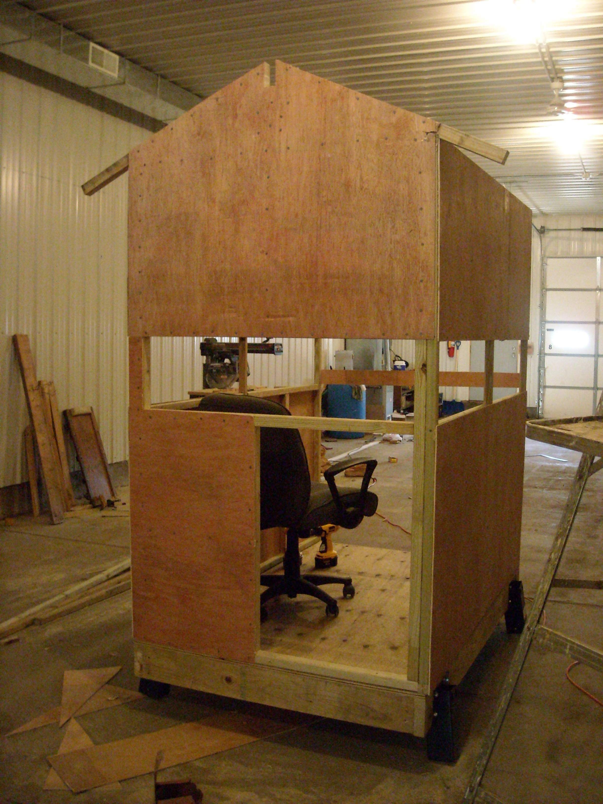

Hey Froggy,
you're set up looks great. In my case I did not have to go hight as my shooting lane gently slopes to about 7 feet in 200 yard, so basically at about 7 feet off the ground and I'll be shooting in to the dirt. I made mine same 4'x6' foot print. With one of my boys is okay but once I took two boys (a little guy) and we could hardly move, shoulder to shoulder:D.
I made mine mobile on a trailer, with 3/4" OSB, wrapped the whole thing with EPDM, and By the way I have wall to wall capeting.. the only thing missing is cable and running water:D
JC,
It took two weeks to build on my driveway , couple hrs a day.
I drove it to my place and permanently parked it.
I ripped out some 2x4 and made windows on three sides using Plexiglas.
windows:

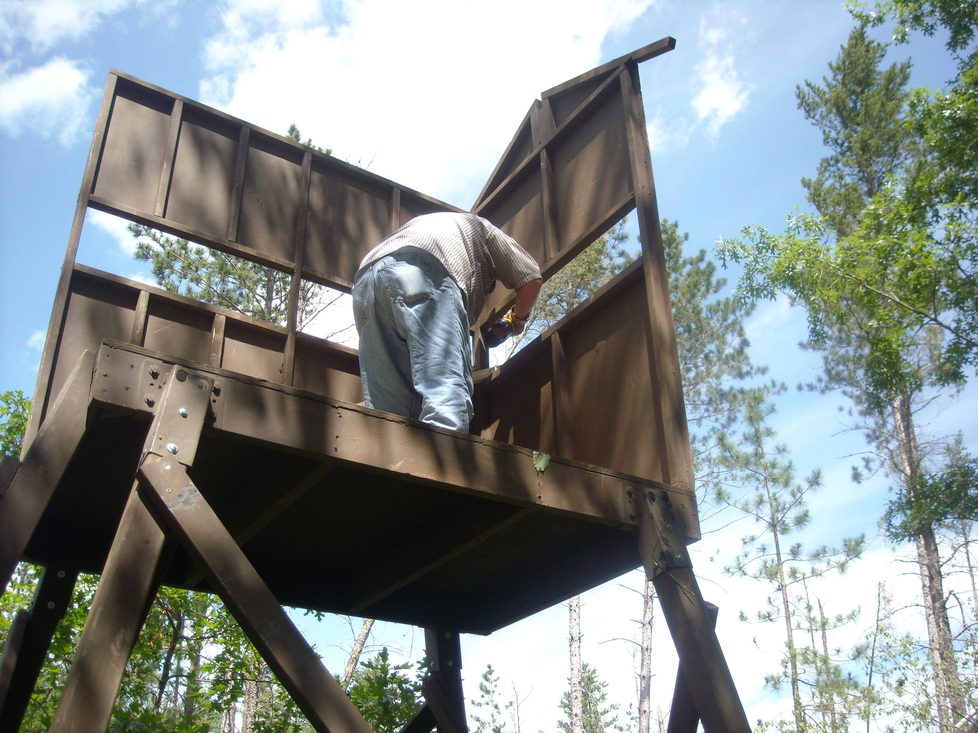

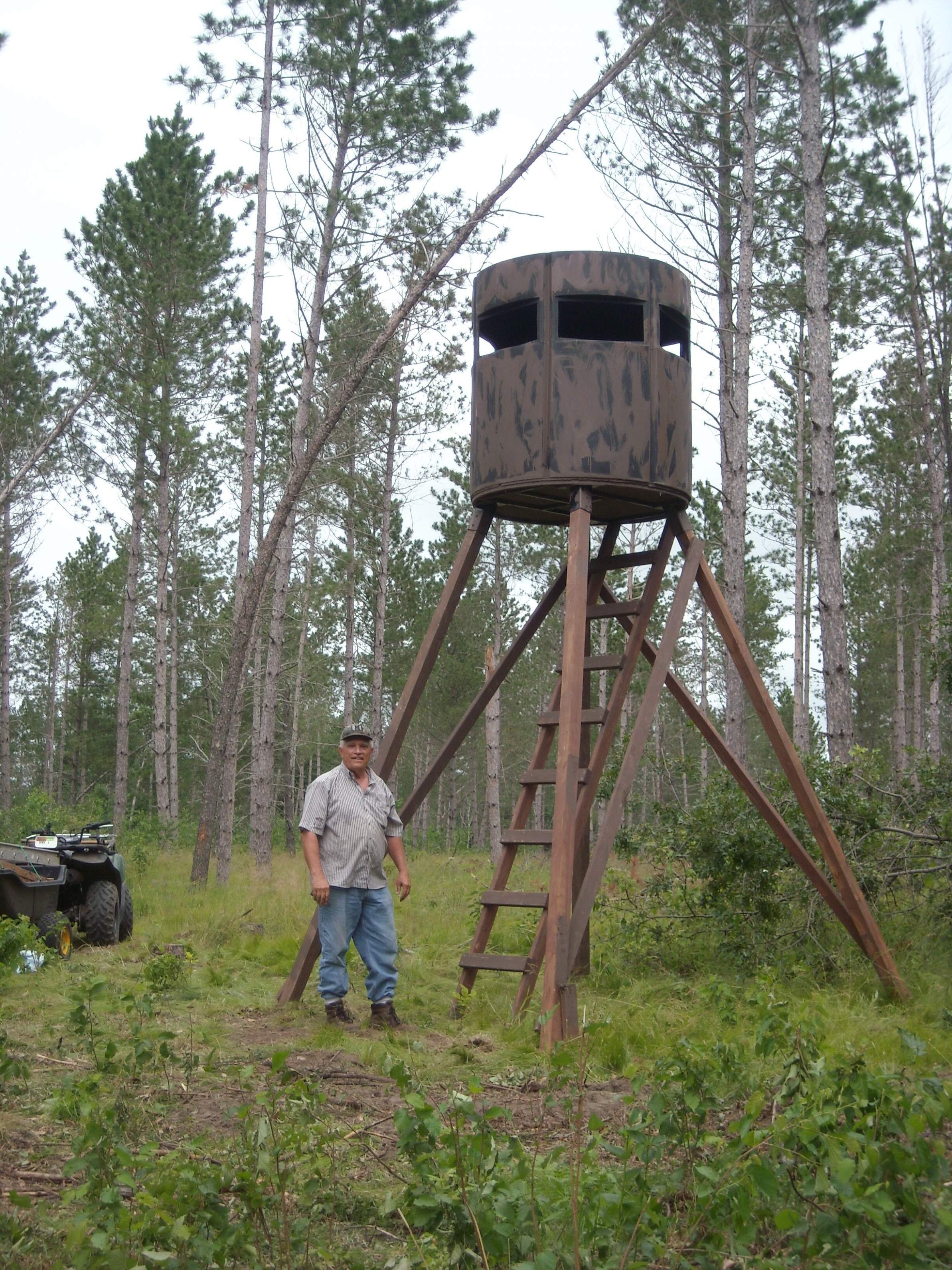

We need to get over the brush when hunting in the woods up here in the north country....which is where the big bucks STAY....at least during daylight hours....IMO. Also, I have about 8 elevated stands (some are box blinds and some are ladder stands) on my land....perhaps 1/2 of them are used at any one time. They are all elevated so that all shots are directed to the ground.....much safer with that many hunters in the woods.
To get stands up to 12 or 14 foot heights you need to keep the weight down.....or go to larger timber to support the house. I used 2x2" lumber for all roof and sidewall construction along with 3/8" treated plywood for the roof. Also, you need to stake it down to prevent tipping in high winds.
Truth be known.....I would much rather stalk or do some western-style, open-country hunting (I like the wide open spaces :D). But in this part of the world it's pretty hard to do....especially for young hunters and/or on public land.
So, these elevated box blinds are the real deal up here in the woods (on private land). But....'ya still need to be quiet.....and patient....and hold the gun steady as you squeeze. Good training for young hunters. ;)

Elevators are a product brand name for the metal connectors that allow 4x4 legs to be attached to the platform (base) as shown in the pictures. This joint can be a little tricky to make without a good connector like "elevators". Google the name....they make some other hardware too for tree stand and swing set purposes (etc).
