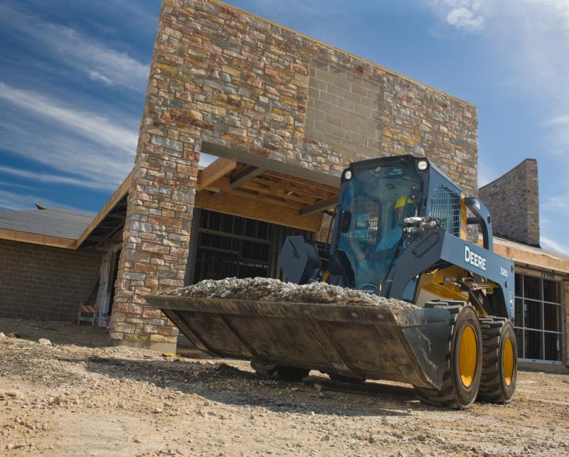

Quick update on the new D series skid steers and track loaders:
Larger cab fully pressurized
New rounded bubble door (think CAT)
New interior layout
Auto idle
Cooling upgraded tremendiously (ready to run mulch head, probably best cooling package on any non-dedicated mulch machine, totally different than anything else on the market)
Optional reverse fan
Hydraulic fan (runs as needed)
improved lighting
New 89hp track machine (4-track machines total)
There are several other things that I haven't mentioned but these are the bigger changes. Look like good overal machines, Deere has always speced out well against the competition, so these upgrades should only help.
   / New Deere "D" Series SSL/CTL #2
Here are some pics for you.
   / New Deere "D" Series SSL/CTL #3
No more flip up door?
   / New Deere "D" Series SSL/CTL #4
Used to be a bragging right for JD. However, some people complained of not enough head room with the door on the ceiling.
I wondered why someone didn't make a reversible fan. It could blow the stuff off the radiator screen.
   / New Deere "D" Series SSL/CTL #5
Did they put a larger case drain line on it? Demoed a head on one a couple of months ago and the case drain was too small.
