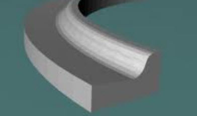

Concrete would cost more of course, how much I'm not sure but I would guess
at least 50% more since there is much more labor involved.
Concrete would be nice yes, but taxes increase with concrete drives here, asphalt is not
considered a permanent improvement. Is that not the case elsewhere?
I would need to take up the old asphalt so the new drive would run flush with the entrance
to the garage and also the concrete curb which looks similar to the one below. I think they
call it a gutter curb.

   / New Driveway- 2 pavement options..help!! #36
As long as your old drive has less than 3/4-1" rutting, I would just do a 1.5" over lay. Of coarse patching larger holes and tacking the whole thing. I wouldn't rip up the old, that's lot of labor, trucking, and yiu don't come out any better. If yiur worried about fineness if finish, have them sand and traffic roll it.
1.5" is the boarder between sp-9.5 and sp-12.5 (S3 and S1 old marshal mixes), but the 9.5 will look better, but rut slighlty faster.
   / New Driveway- 2 pavement options..help!! #37
I didn't read the part about the curb, sorry. That makes things a bit more expensive, yiu have a couple options:
A: take up existing asphalt and repave
B: mill it and repave (most expensive)
C: mill along curb and garage and overlay
D: mill at garage or feather the joint down, or eve saw cut 3 ft wide strip, and over lay the "gutter" portion if the curb
