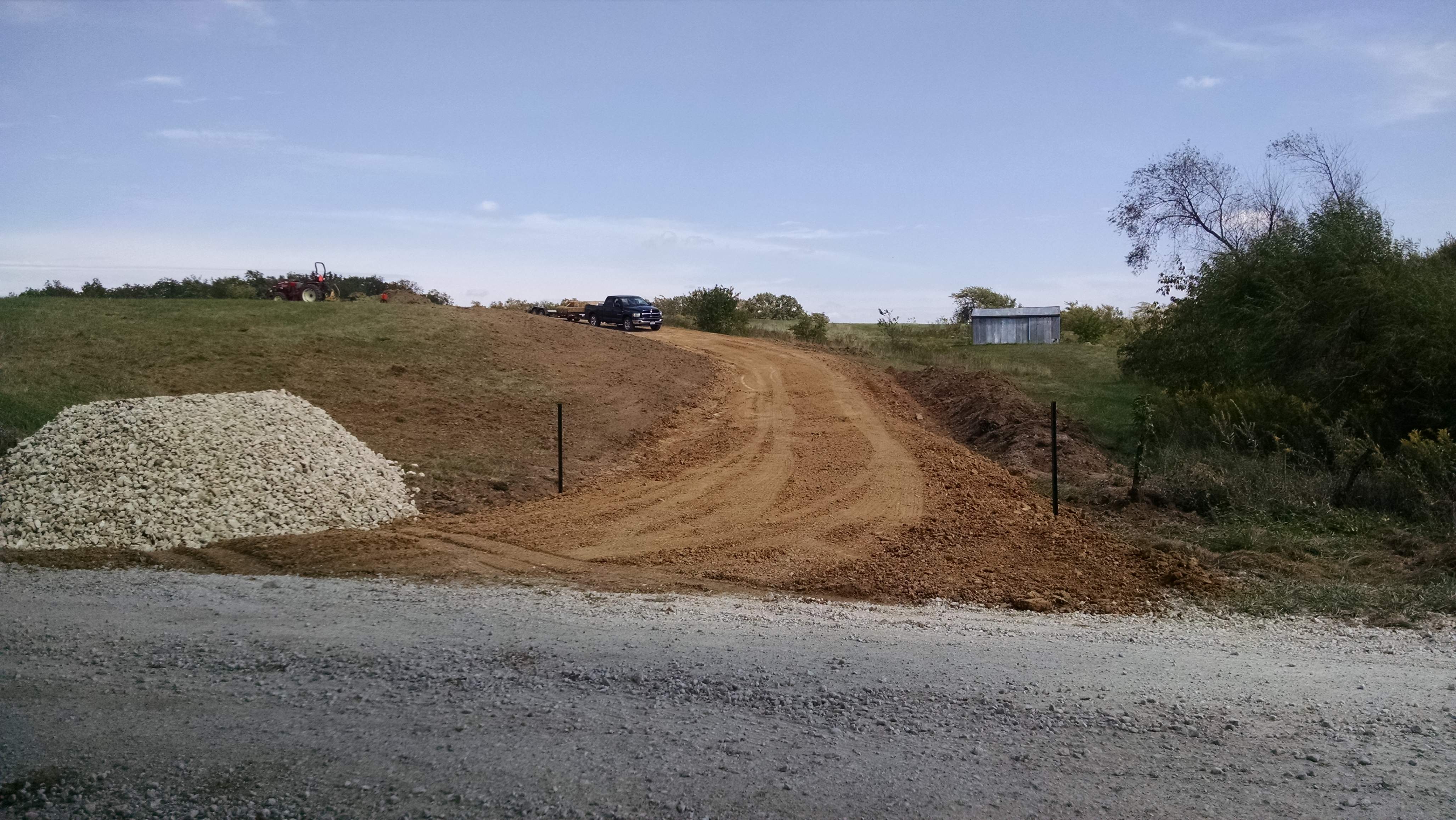

Ran into an issue today. Stopped into rental store to change reservation date on the sheep's for compactor and found out that they had a smooth drum reserved for me instead. I specifically asked for the pad foot when I made the reservation. Actually we had a lengthy discussion about it and they had to bring it in from another store. Not sure where the breakdown happened but now I'm stuck. I called around and the only sheep's foot available is a small trench compactor that is pretty light and not very wide. Should I go ahead and try the vibrating smooth drum or try to compact using my tractor? Just worried that the smooth drum would be a waste of time and money, but maybe it's better than nothing. Soil is clay and I need to make a decision soon. Any input is appreciated.
If you know anyone with a dump truck, see if you can get them to wheel roll it. Better if the truck is loaded. If not, I would load the bucket and wheel roll it with your tractor. Either way you'll probably need to touch it up with your box blade afterwards. After you have it the way you want it, you'll able to tell if you still need to run the smooth drum compactor over it. With clay soil and truck rolled, I don't think you'll need it.
   / New Driveway Construction #43
That's kind of what I was planning on doing. In VA all we have is red clay and I have a class 7 dump truck (32K GVW) that weighs 7.5 tons empty and plan to just run that over it ... I got a permit to carry 8 ton on it (normally I could only do 6 ton thanks to some Federal single axle bridge law) so hopefully that will be good enough.

Unfortunately I don't know anyone with a dump truck that will have time in the next couple of days. I rolled it with a loaded bucket on my tractor today with mixed results. It's been warm and windy here so the clay is like rocks and doesn't want to pack. I'm a little concerned about the soil on the top of the hill. It looks like clay and works up like clay, but after it's exposed and dried out it turns into dust and doesn't want to pack. It seems similar to top soil but is slightly different in color, but not as orange as the good clay. Hopefully I dug down deep enough. I'm down 8" in most places and I dug another 6" with a shovel with no change in soil type, so guess it is what it is at this point.
I stopped back in the rental store and they cut me a deal on the compactor. I'm going to rent the smooth drum this weekend to compact the dirt, return it for a couple days while the rock is hauled in, then rent it again to compact the gravel. Hopefully it does a good enough job with the dirt. I also ordered a load of 3" clean to put in the ditch in an effort to prevent erosion. The plan for tomorrow is to put the 3" rock in the ditch, finish widening the entrance, spread topsoil/seed/straw on the hillside, and install a silt fence.

OP, You cannot compact dust or sand. Its impossible. You have to have what is called optimum moisture content or you will get no where. Depending on the soil type it requires different amounts of water. You do not want mud, but there should be absolutely no dust. IIRC, the non scientific method is to add water until you can roll the clay into a ball and it will hold its shape, but if you try and flatten it out into a rod is breaks apart.

Thanks for the info. I do remember reading about optimum moisture content when I was studying up for this project. I should've mentioned that we're supposed to get some rain tomorrow, so hopefully the moisture content will be right when I have the compactor this weekend. I actually thought about renting it today, but figured I'd wait until the weekend after it got some rain on it.

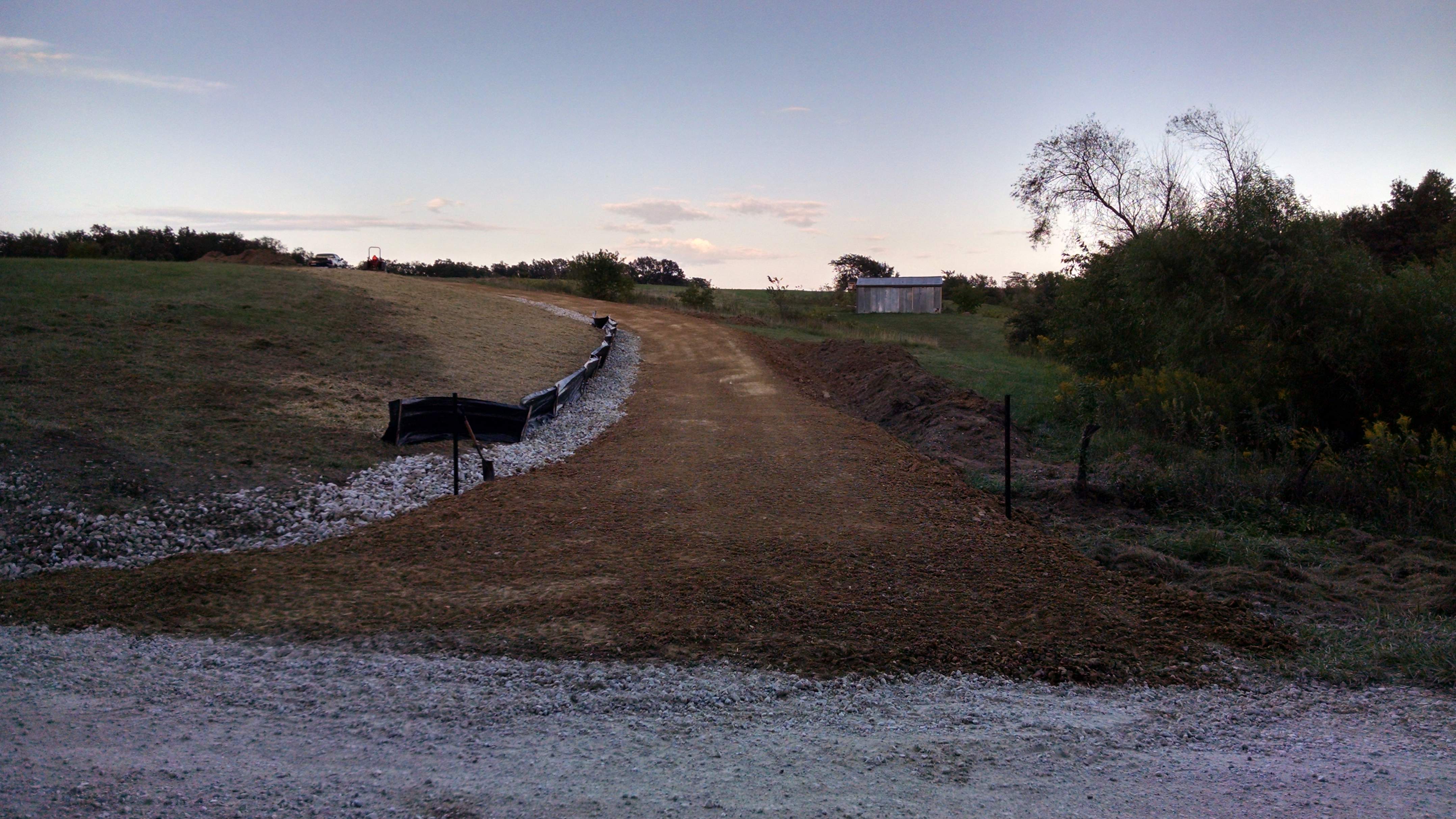

Got the hillside seeded, silt fence installed, and put 3" rock in the ditch. Wishing now that I would've waited to put the 3" down until after the driveway rock was down because it might be in the way when installing the fabric and water will probably just run around it and make a new ditch until the rest of the rock is down. I can't remember why I thought it was a good idea to put the rock in the ditch prior to the driveway rock. Oh well, I've made plenty of mistakes along the way.... at least this mistake hasn't cost me any money yet. Ran short on silt fence so I'll have to install some more this weekend. Hopefully it doesn't rain too hard in the mean time.
On a positive note, the trucking company brought the 3" today and he seemed really pleased with how everything looked. He asked who did the dirt work and he seemed surprised when I told him that I had done it with my tractor. He was also very knowledgeable about how to install geotextile and best practices when spreading rock onto it. Originally they were going to try to spread the rock while in reverse, but after looking at the situation he suggested that they use a trailer that dumps from the belly and allows them to spread more accurately. Unfortunately that means they will be driving on the fabric, but after talking with him a while I'm not too concerned about them doing something that would compromise the fabric. He also mentioned that they would be able to haul the rock cheaper using that truck:thumbsup:
