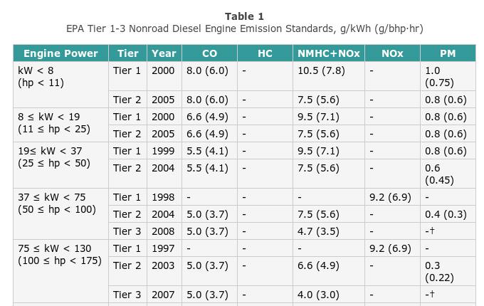

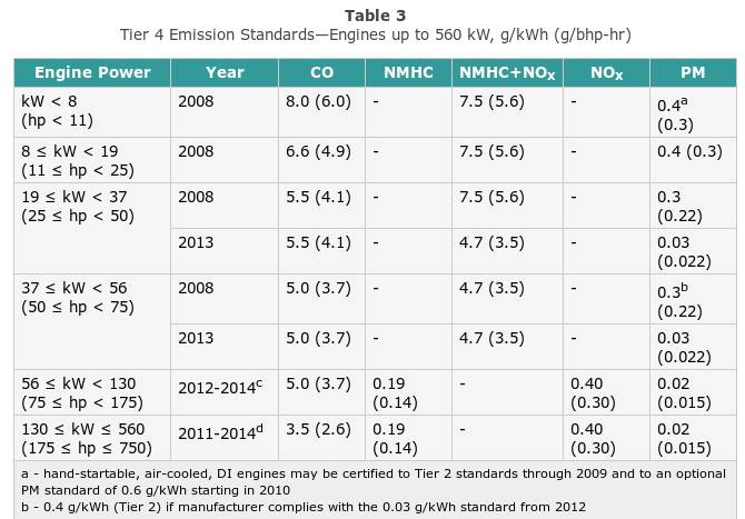

Gents, attached are tables for the emissions specifications for Tier 1-3 and finally Tier 4.
The first thing that one should recognize is that in the region up to 25hp very little changes. Main change is a roughly 50% reduction in PM in tier 4. This can be accomplished by higher injection pressure, finer atomization and at most an oxidation catalyst. None of these is a big deal, shouldn't affect fuel consumption but the platinum on the catalyst may add $200 o the price.
25-75hp the big change in 2013 is the massive reduction in PM which will require a DPF. DPF's need to be regenerated, so the engine either needs a sophisticated fueling system, or a fuel fired burner.
Above 75hp there will be specific focus on NOx emissions, which either means EGR which we know what that does (2007 pickup anyone ?) or some form of SCR (urea injection and catalyst). Above 75hp one is starting to look at a sizeable machine and pretty expensive with a not inconsiderable appetite for fuel, so hopefully the OE's go SCR since despite the hassle it works great and fuel consumption is pretty much a wash with earlier vehicles (there are some benefits to those fancy injectors etc, included refined operation).
