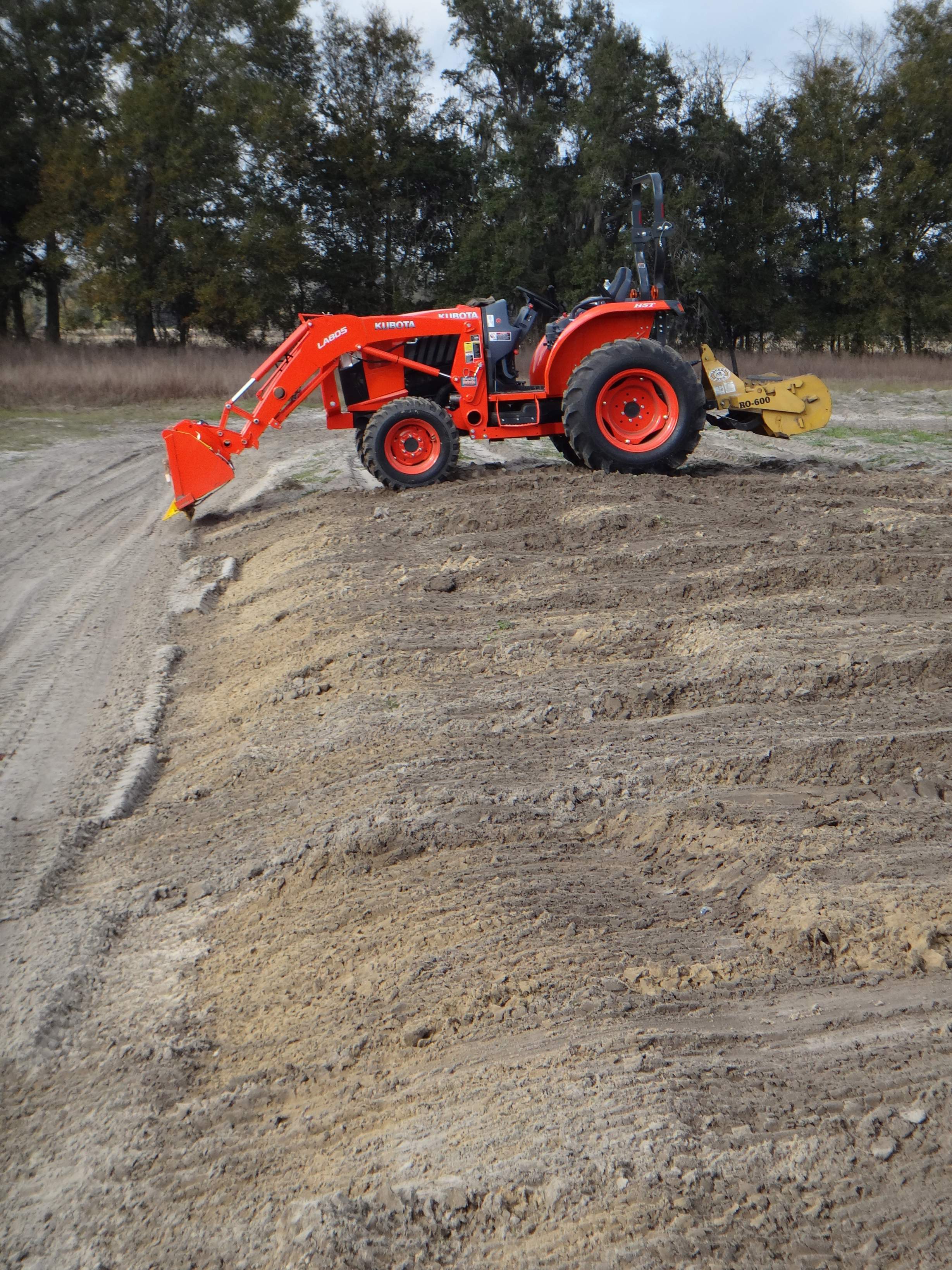

My driveway is "very long" and uphill and needs to be snow plowed.
A Loader will handle moderate snow.
VIDEO: FEL bucket snow edges - YouTube
How much snow do you get in storms and how often? The next increment up for moving snow is a rear/angle blade. "Very long" does not tell us much on which to base recommendations.

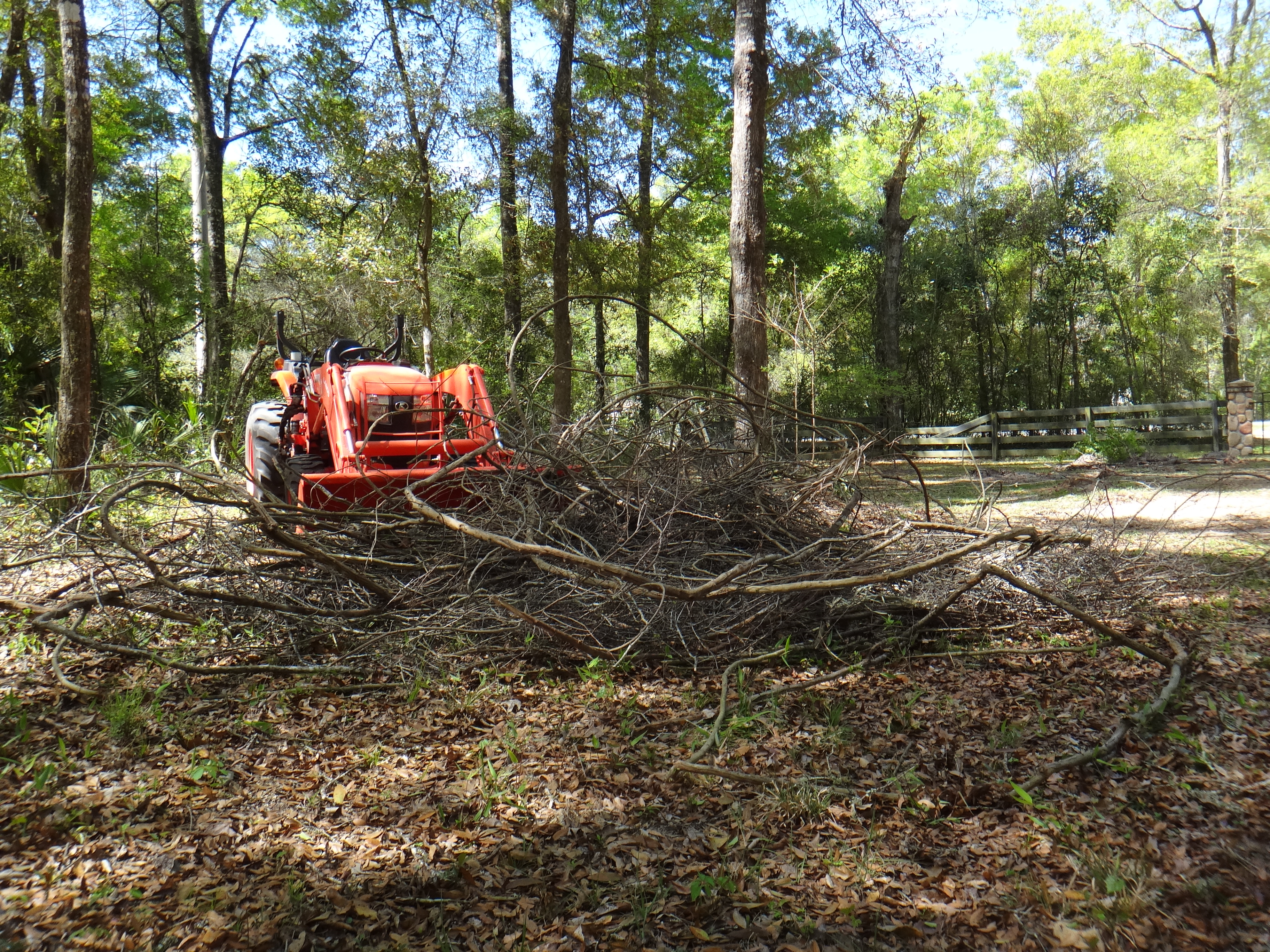

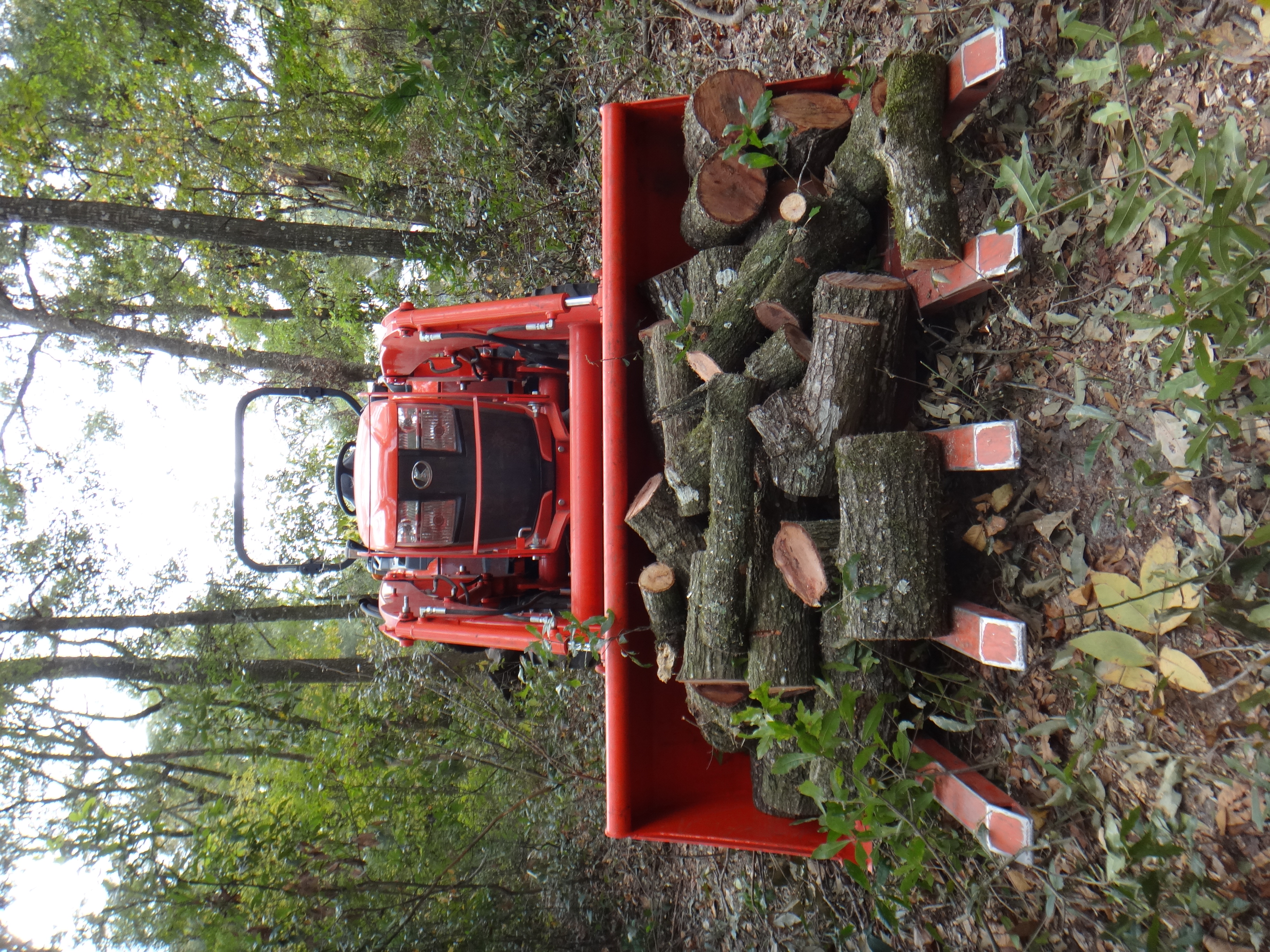

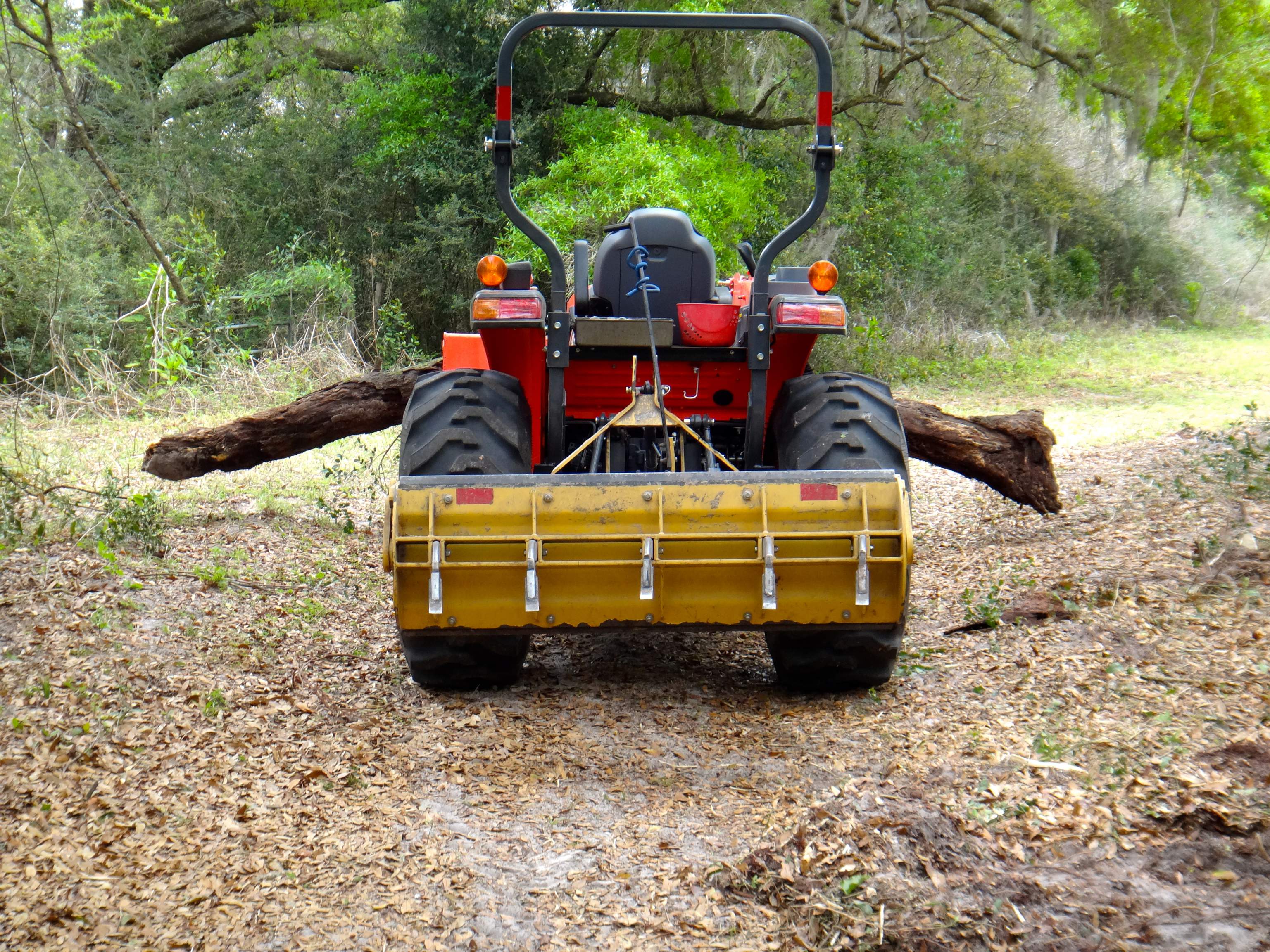

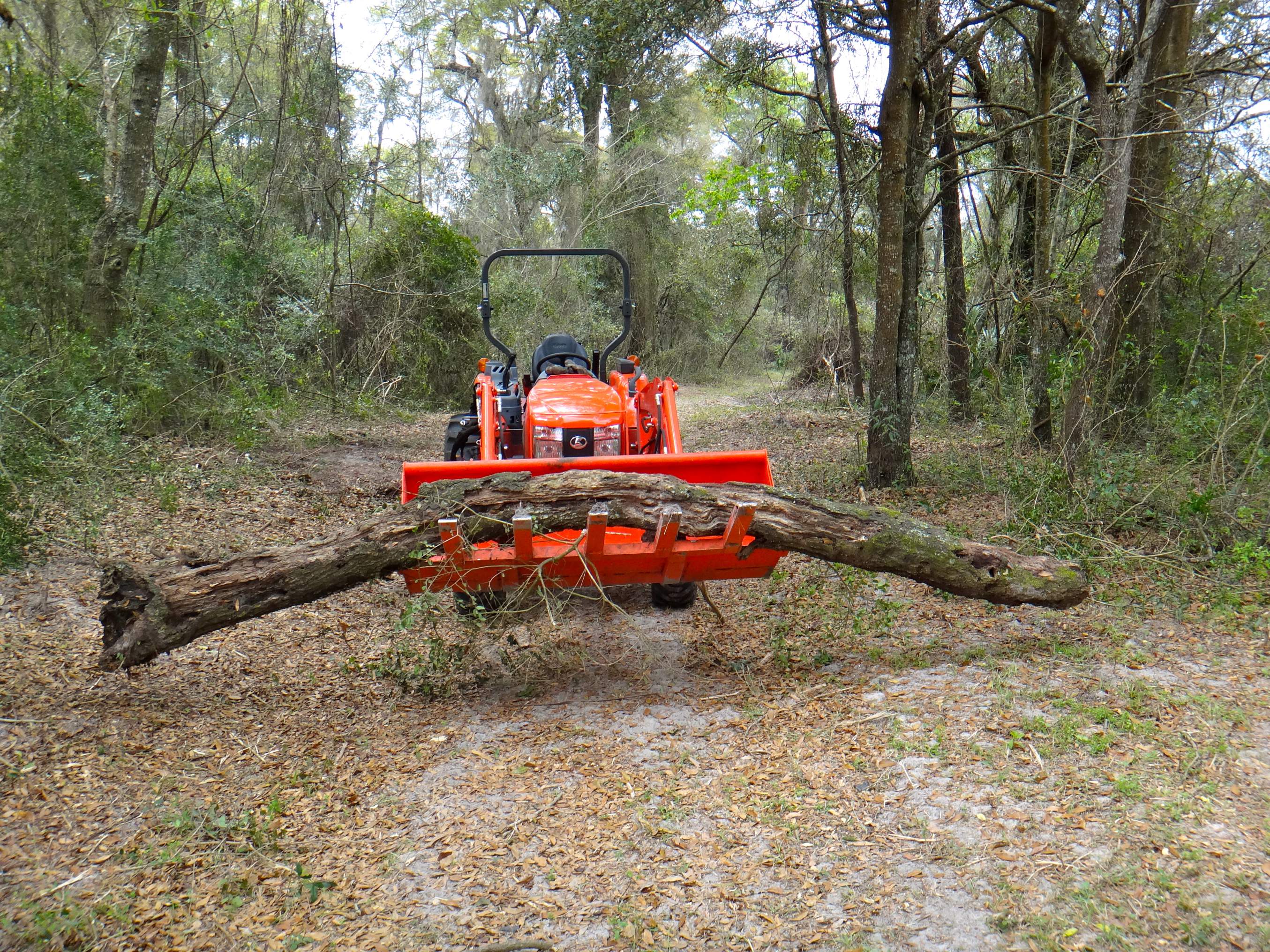

I burn wood for heat so I will need a Loader to move trees and firewood.
Buy a stick of 1-1/4" PVC pipe. Cut PVC to tractor width, 74" long. Walk the pipe through the gates on your new land, barn entrance and into the woodland, to see how a 74" wide tractor will fit through your conditions.
A Loader bucket is almost always used for transporting firewood.
A Ratchet Rake bucket attachment is very useful in woods work. It tears vines out of trees. It is also useful for light grading and food plot development.
VIDEO: ratchet rake brush clearing - YouTube
