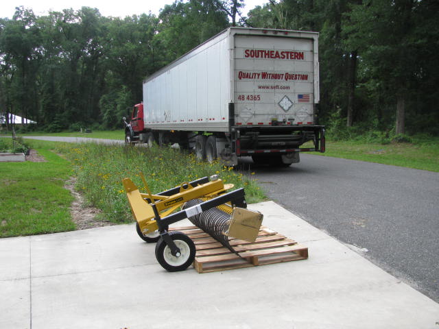

My tractor is Category I. I like being able to order implements from the internet, often from everythingattachments.com or Iowa Farm Equipment.com, and have said implements arrive on a semi trailer three or four days later. Almost all Category I implements are available in Category II from the same venders. Not so, Category III implements.
