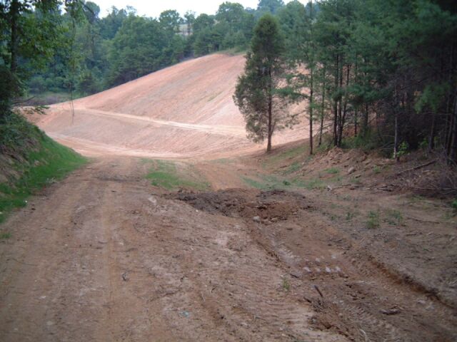

view from streambed....where well/pump would be....hoping to create a type of artificial waterfall, stream there also.....have kubota 4610 with loader and blades, rakes, etc....this is what i've done with it so far

Great looking pond. I wouldn't worry about it filling up. It will if you give it some time.
   / new farm pond help #6
Nice pond! From the looks of the slope I would let mother nature fill it. One little popcorn thunderstorm will put a lot of water in it. I am building an addition on mine and a small t-storm put 40,000 gallons of water in it in just a few minutes. It took the better part of a day to pump it out so I could continue work. Give nature a chance before you invest in a well, I think you will be surprised.
   / new farm pond help #7
I agree with Dozer and John on this one -- give it a little time.
That is one good looking pond job!

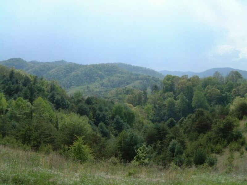

Thanks for compliments. This one was done with a rather small trackhoe and a rather hefty dozer. This pic was taken 2 weeks before exacavation was started. No trees had to be cut, all dozer and trackhoe work to remove, mostly jack pines, white pines, poplars, no real monsters moved. The guy was here about 2 weeks, he also hydro-seeded all around, dam, sides of hill around. was around $14, 500
sealed dam with red clay taken from sides of hill, pipe is 12" with collar cemented with 3 cu yds cement
