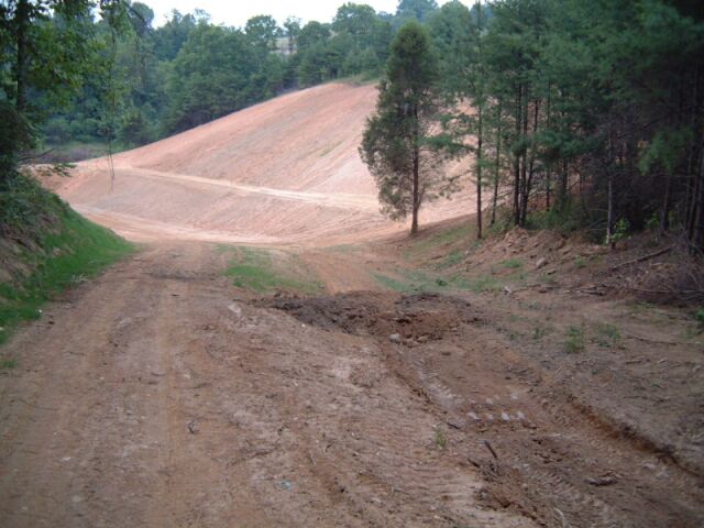

ok, think I've got some help now on the 'muddy' issues. Got a T-shped fishing pier under construction now, 40 feet by 24 feet in size, still not a good hold on grass yet, and some fish attractors in place. What i'm currently doing is trying to get a 'fake' creek carved out above the pond to both fill the pond and for landscaping and aesthetic purposes. This area was overgrown, briars, bittersweet vines, jack pines, cedars, etc....was a thick wildnerness. Here's some pics of the area i'm trying to build a waterfall and streambed for pond.
any ideas on this would be appreciated. I'm still open as to what i'm going to do here. just want to fill pond, then use it as a place to sit, relax by the creek......there are no other creeks or water sources on property. My well for the main house is about 300 feet from this one. I didn't want to affect my house source much if i could help it.
this is head of the pond where water source would be...dug or drilled ...using 'bota 4610 with loader and attachments

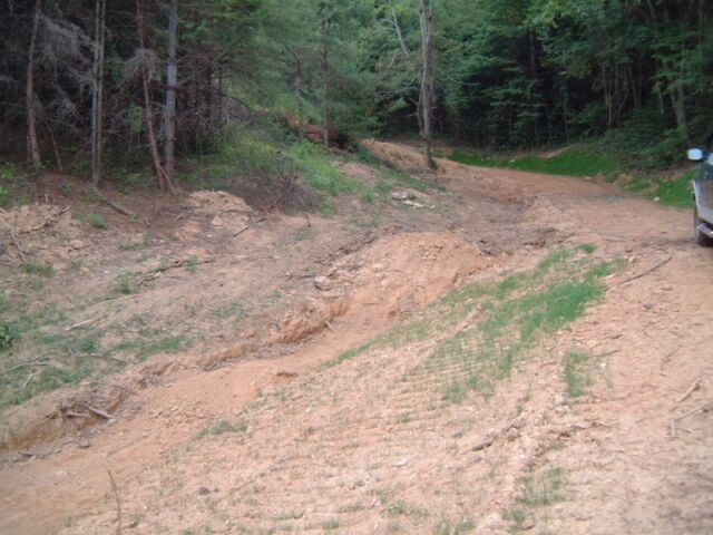

   / new farm pond help
#18
view of streambed and waterfall area looking toward lake

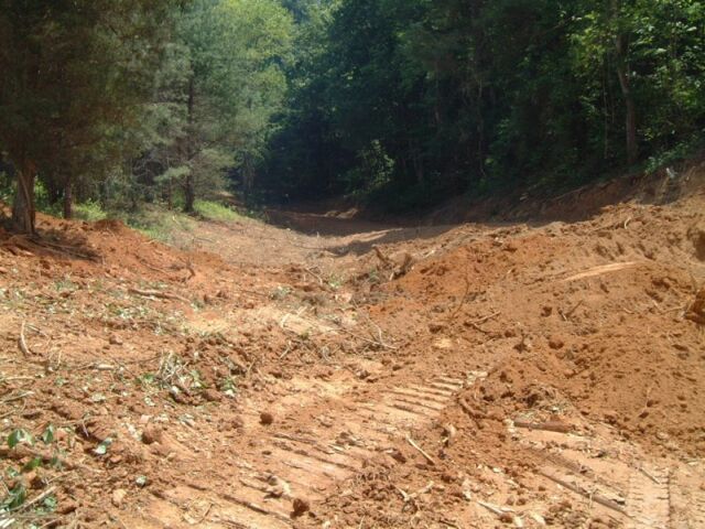

#20
waterfall and stream for pond...view before rock placement
