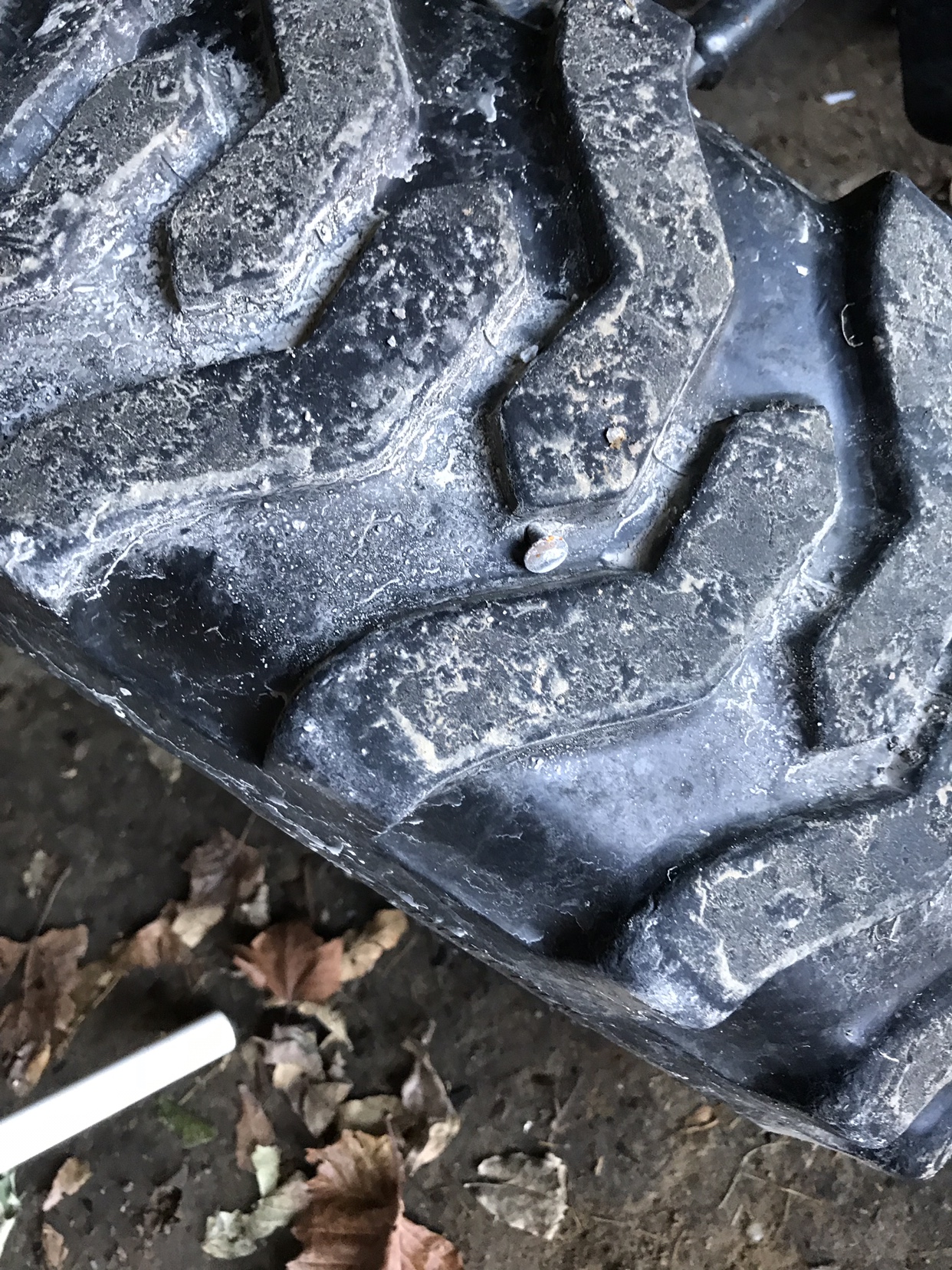

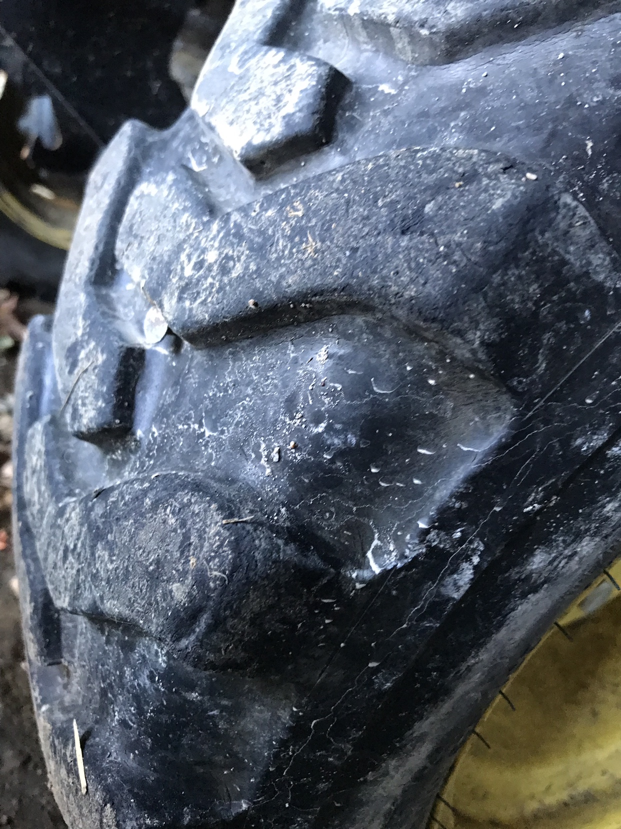

Well since I am so hard on my tractor tires I am replacing the 2 front ones on my John Deere 2720.
2 years ago the one snagged a rock and cut the sidewall, I had to put a tube in it and now I used the tractor to clean-up the roof shingles that were removed from the barn and they are full of nails.
She has industrial on her now but after researching specs. I ordered these (Multi-Trac C/S 23x8.50-12 Carlisle #574372) turf tires.
Off to work I go so pictures to come.

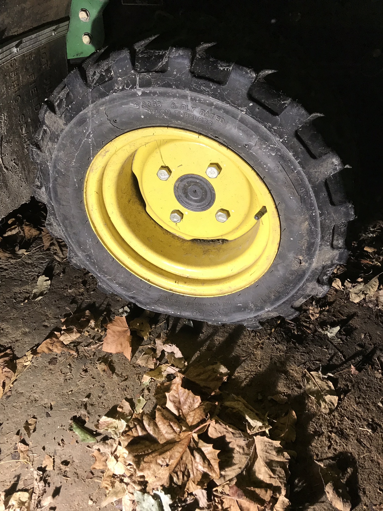

On the 2720 from the manual;
Front Wheels and Tires
Standard 24x8.5-14 R3
Optional 23x8.5-12 R4
You're going to need new rims with those new tires.

Thanks for the replies and Yes, I do know about the rotation and I am almost continually in 4wd

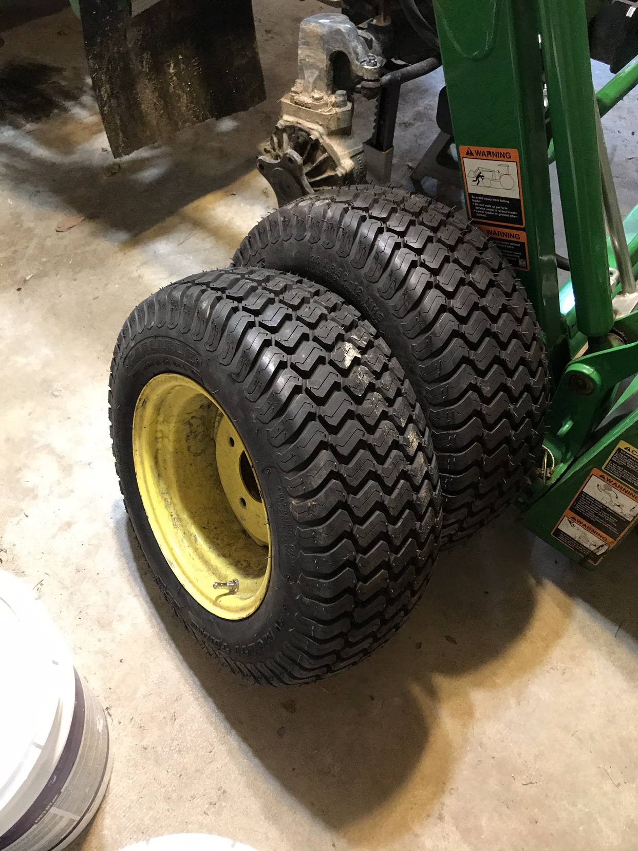

Now need to find time to either install myself or get them installed but definitely need to finish installation of my barn roof which is priority.

Tires all mounted though I went to 4 different tire shops, all said they were too small for them to dismount the old and install the new.
The (as us old guys used to call them) junkyard up the street from me changed them.

The tires are working out great even with the R4s on the rear.
