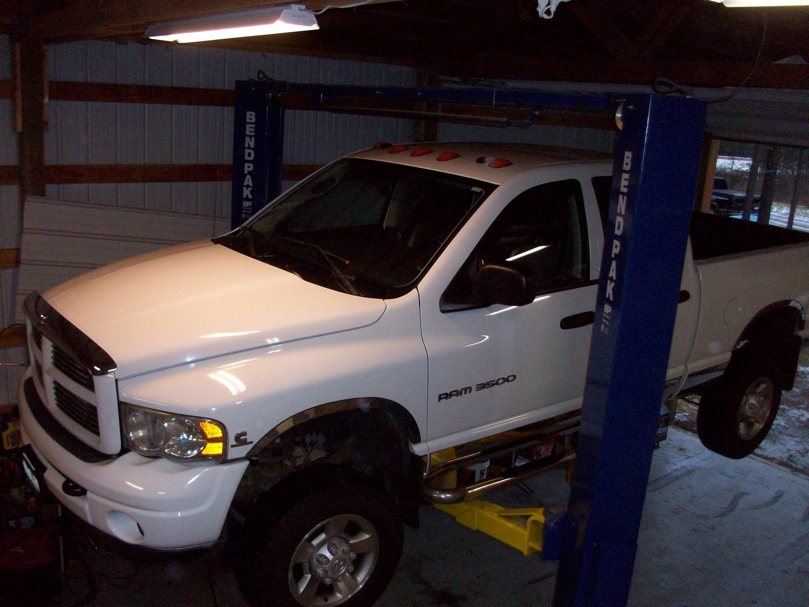

Here is a picture of my pit-I mean lift. I am getting too old to be crawling around in a pit. My lift ran $2k and some change.
DaveView attachment 406107[
Got to agree on going with a lift -and am partial to 2 post lifts especially if doing suspension work or ever removing the rolling chassis.
I went with a 10 k lb. asymmetrical ( allows you to open your doors more fully:)) ALI , ETL certified lift to have a little extra capacity over what the dodge 3500 weighs.
For what they cost/ and how useful they are- it is hard to beat a lift.
Oh and Wow - that Is a nice shop!- still have quite a ways to go on mine.

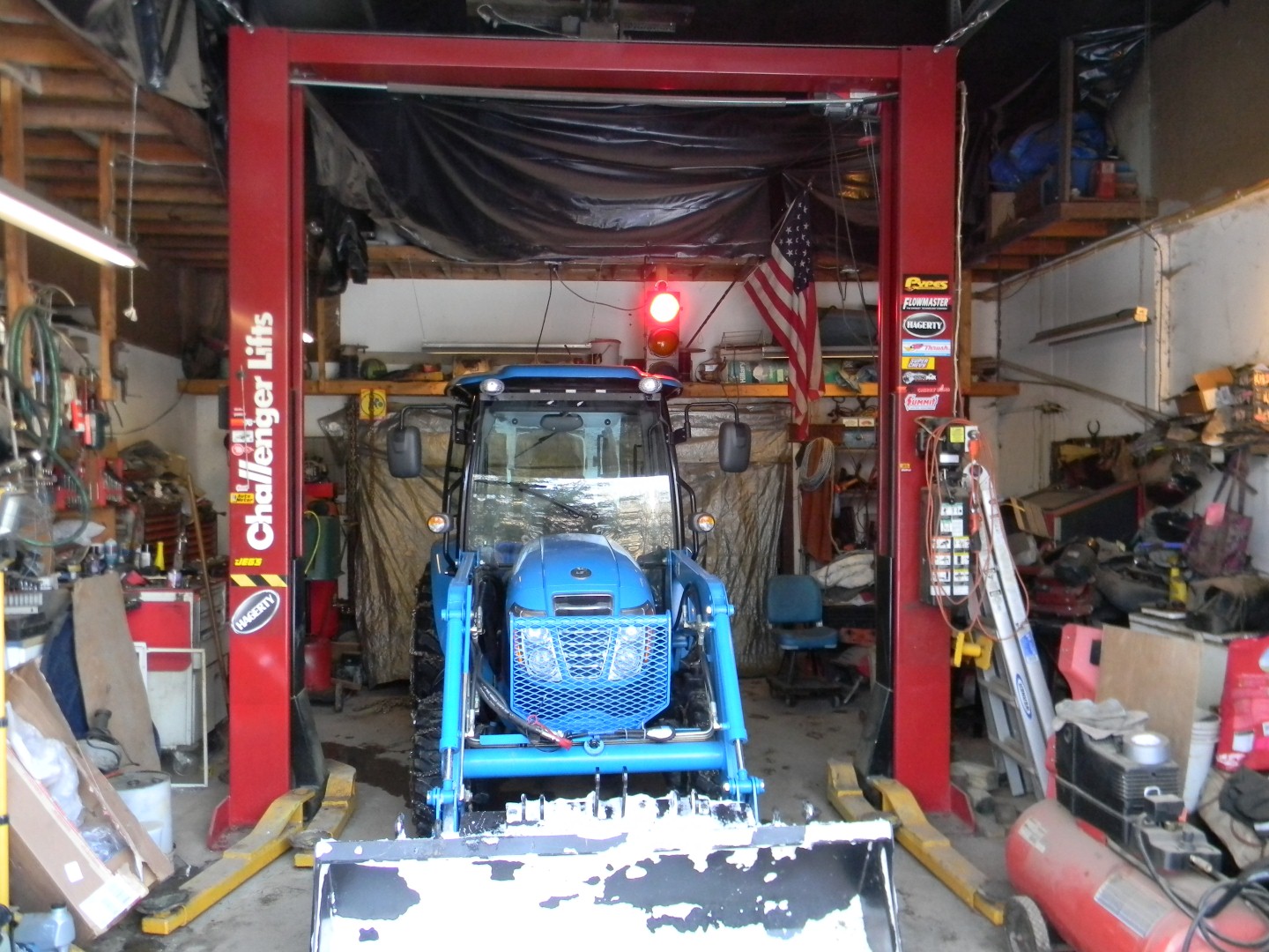

Here's a pic of my Challenger 9000 lb lift. Of course my garage is not as clean as Dave's. Lift is in a 24'x24' garage with lots of other equipment and tools so not a lot of free space left. There is another 18'x32' pole barn attached on the back which is also full. I need to knock down part of the house for more garage space. Rafters are 14'. Garage door is a 12'x12' insulated overhead door. Door tracks are about 13' so door rolls up above the lift. Top of lift is about 12'6". No more pits for me. I use a mobile home furnace for heat in the pole barn and a kerosene salamander in the main garage when I'm working out there.

Here is a picture of my pit-I mean lift. I am getting too old to be crawling around in a pit. My lift ran $2k and some change. Dave<img src="http://www.tractorbynet.com/forums/files/rural-living/406107-new-garage-grease-pit-20141229_113027-jpg"/>[ <img src="http://www.tractorbynet.com/forums/files/rural-living/406109-new-garage-grease-pit-20141229_145438-jpg"/>
Just curious as to what happens on a lift like this if the vehicle being lifted is not balanced. Looks like it would tip over front to rear. Maybe the lift senses unbalance?
