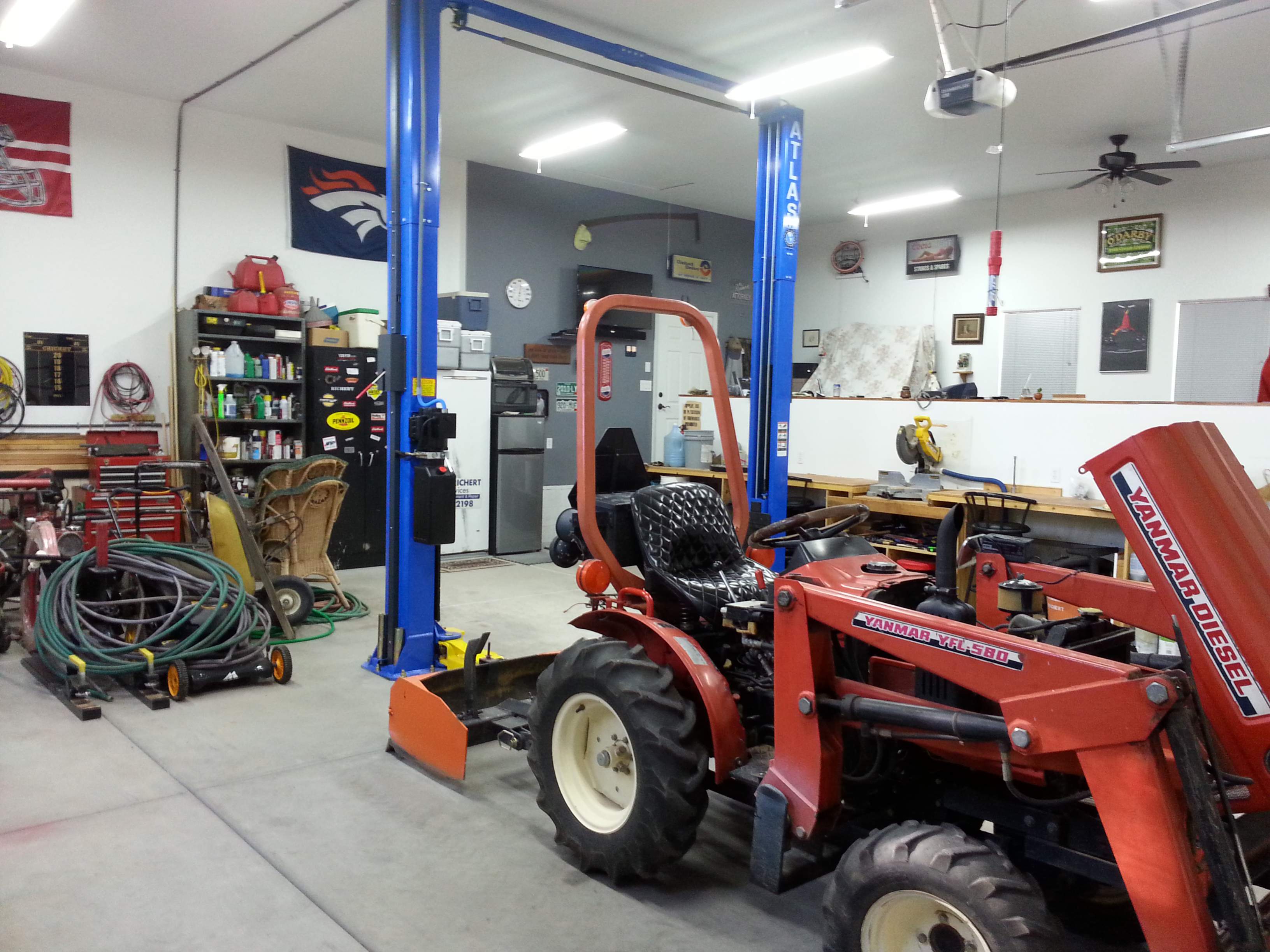

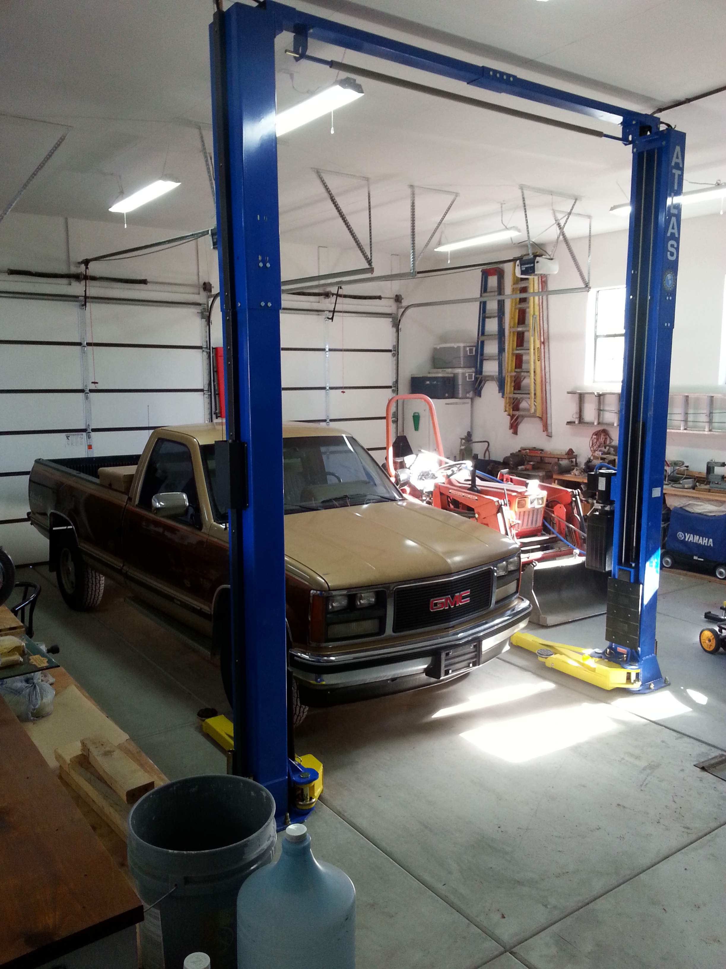

Here is a picture of my pit-I mean lift. I am getting too old to be crawling around in a pit. My lift ran $2k and some change.
Dave 20141229_113027.jpg[

Here is a picture of my pit-I mean lift. I am getting too old to be crawling around in a pit. My lift ran $2k and some change. Dave<img src="http://www.tractorbynet.com/forums/files/rural-living/406107-new-garage-grease-pit-20141229_113027-jpg"/>[ <img src="http://www.tractorbynet.com/forums/files/rural-living/406109-new-garage-grease-pit-20141229_145438-jpg"/>
Byron;
Nice shop! What is your ceiling height to accommodate the lift?
Thanks!
Sent from my iPad using TractorByNet
/ New Garage, Grease Pit? #14
I would check with the local building inspector to see if pits are even allowed, before I went to all the trouble of building one and then being ordered to fill it in.
You will probably have to supply a detailed plan/blueprint.
/ New Garage, Grease Pit? #15
My ceiling height is 13'. They make lifts and adapters for shorter ceilings.
Dave
/ New Garage, Grease Pit? #16
The ceiling in my last garage was 10' and its a few inches shorter in the new house. That's bare minimum for stacking a couple smaller cars.
