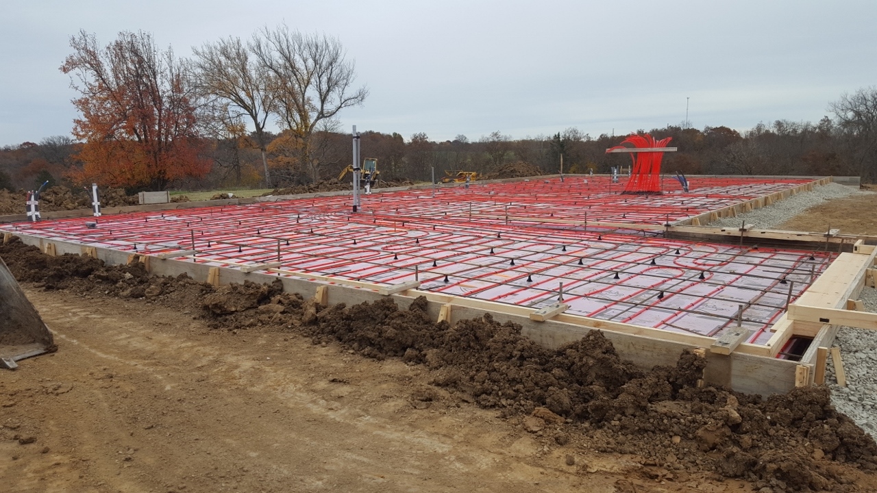

I'm still researching on the pour, one thing at a time though. Power screed is 14' so i think I'm ok. I've never done any of this before but I'm taking my time and doing a lot of research, and so far I think it's come along ok. In the beginning I was scared to dig the footer, and lay block. But now i've been able to overcome these fears.
Got the pex all laid in and clipped. I need to pick up long turn 90* 1.5" pvc, each run will go 2 in 1 to come out of the concrete and meet up with the manifold. I'm going to leave them long and put the manifold hanging over the back wall while the pour is done, then when the pad is set I'll go back in and trim off the excess. I'll have the tubes pressurized during the pour as well to prevent potential crushing. There's 700 pex clips and ~1600ft of pex tubing totaling only 16.3 gallons of fluid.
The right side was done first. And it's a bit of a mess compared to the left. I may redo it honestly.

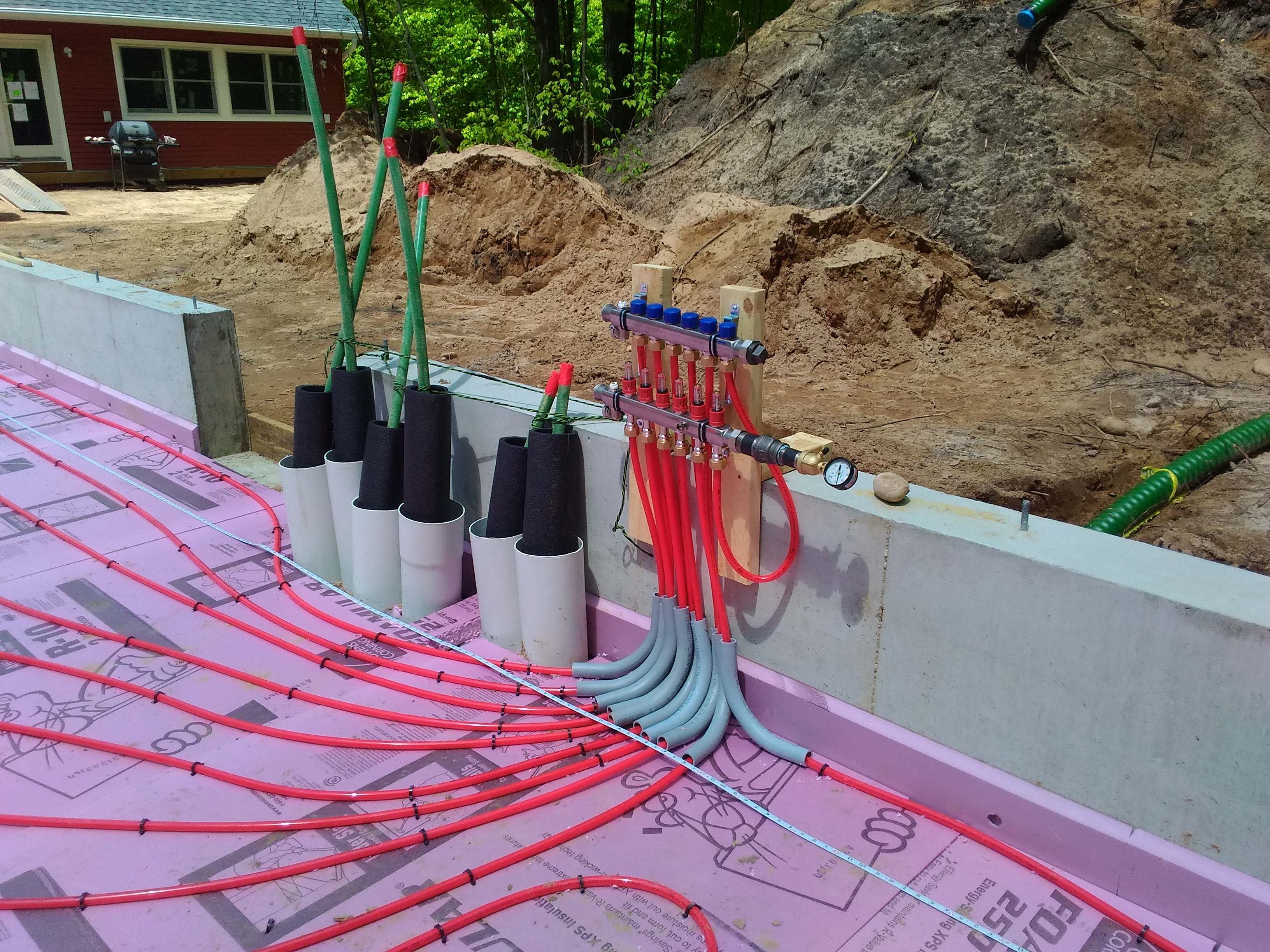

Where your pex turns up things are going to get crowded real quick. It's hard enough when the pex is at the bottom of the pour. With yours within 2" of the top the long turn elbows are going to breach the surface of the slab at an angle with most of the sweep being above the slab. Pex can stand some pretty sharp bends, more than you'd think. Normally pex fitting elbows are used on each individual run. In your case those will still breach the surface. But they might work better than long sweep PVC. Even the horizontal end of the PVC is going to nearly breach the surface.
Here's a couple pics of how I've always saw the uprights done. Not pimping it. Just offering visuals for thought. Rebar is used to hold everything in place and then is cut off flush with the slab when done. I wish I had a better pic of the individual elbows. Maybe you can zoom in.

How about this picture of where my pex comes thru some pvc elbows. My pex is plastic stapled to the insulation and ends up on the bottom of the concrete pour.
Jon

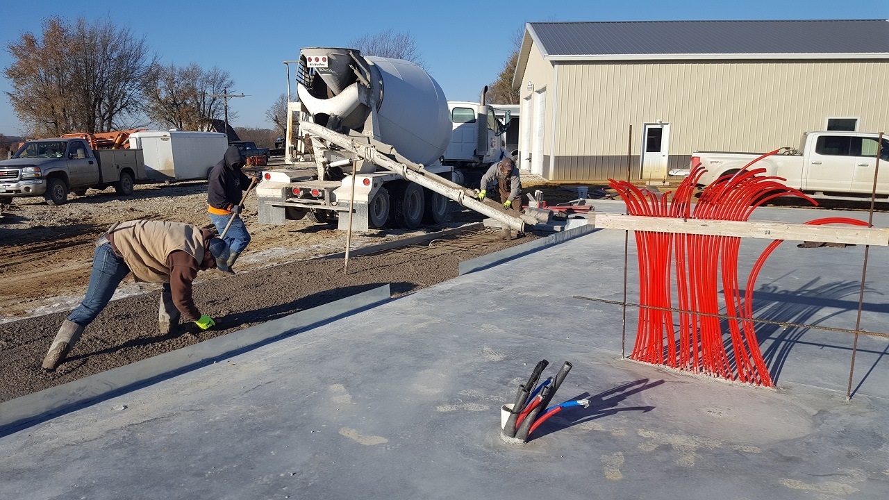

As others have mentioned this is brutal work with a slab this size and confined side walls to work around ! Set your screed pins based on how wide you screed is. You might need 2 rows of pins. I always just use rebar set with the laser level. Then drive them down when you get the concrete level as you go. As far as moving that platform around....you will be wore out doing all the moving while the concrete is setting up ! If i can't get the truck chute where i need it i have a 16' chute made out of galv. roofing with 2x4 sides it mounts to. Put a couple of legs on the sides to get the height you need for the concrete to flow. Pulling concrete with a rake is ok for a small area or you have a big crew to do it. You know how much time you have to unload each truck ? Some companies only give you so much time to off load , if not done in that time you will get charged by the minute ! I have poured many yards of concrete but when you hear the concrete truck coming down the road a certain fear comes over you !!! Good luck and i think you will be fine. See if you can get more help as 4 guys is minimum.
   / New garage time!
#255
Love the pex pictures, I'll take as many as I can get for ideas.
We have 2 trucks coming at the same time, one driver is in training and they're down on business so they're not going to charge us time. I'm working with the same company that brought me 2 trucks to pour my foundation, no time on that one either. We know the guys over there.
I thought about making a chute to get the extra 8'. I'm still thinking about it. We have 4 guys with an extra 2 we can call in if we need. 2 on the stand inside, 2 outside. Stand is screed and outside is raking. That's the plan at least right now.
Jon
Yes, very good pic Jon.
This clearly shows how much space sweep elbows require.
Is that a 5" pour? Hard to tell in a pic.
Good example of a very tidy setup!!!
