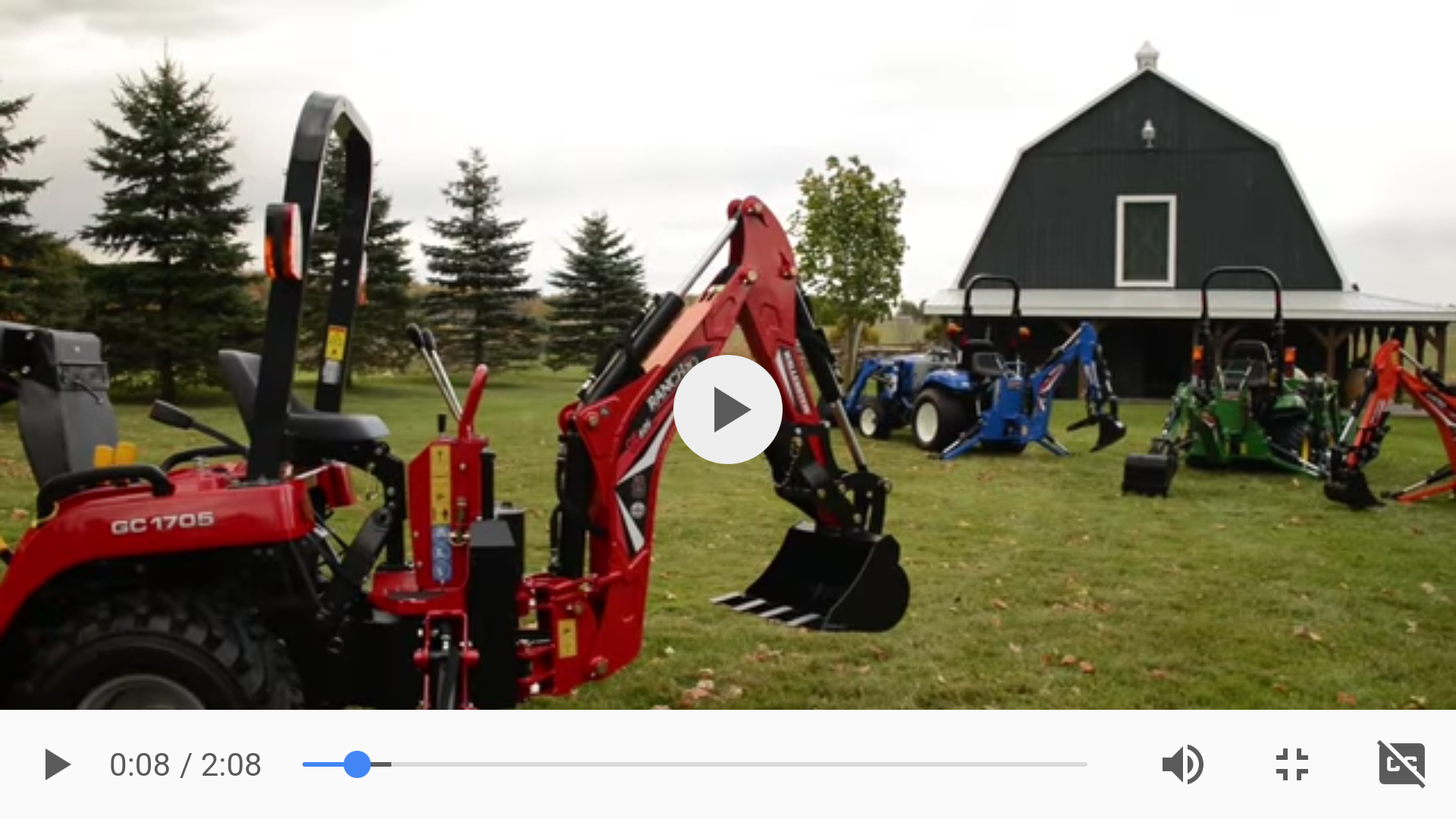

I was reading in the fine print and it said some sub frames will not work with mid mounted mowers. When you talked with them, what did they say?
This is what the website says under it's part number for the gc1705 subframe:
"Midmount mower compatible
(GE605) Must have either OEM reversible seat or seat kit"
One answer I don't have yet, is wether or not the 3 point hitch will be able to folded up and left in place or not. The video of the ge605 backhoe has a gc1705 with it installed, and I believe you can see the 3 point there.

On the GC series, the 3PH lift arms swivel down, stabilizers swivel up and top link rests just above or in the drawbar hole. From mfr. the parts are held in place by a rubber strap hooked to either side of the ROPS support. You never have to remove them from the tractor.

Does this apply to 1705/1715's as well? I only ask because someone in a thread said they were designed differently for the backhoe.

Check out your 3 point. The stabilizers should be pinned into the lift arms in a manner that you can quickly release. If so, then you can follow Coldsteelva's directions on folding them up.
I would ask the mfg. you decide to get the backhoe from as reassurance but in the pic you posted the 3 point hitch is definitely still on the tractor and folded up.
