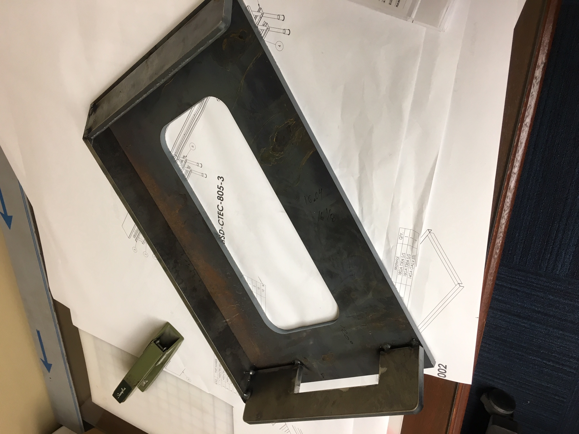

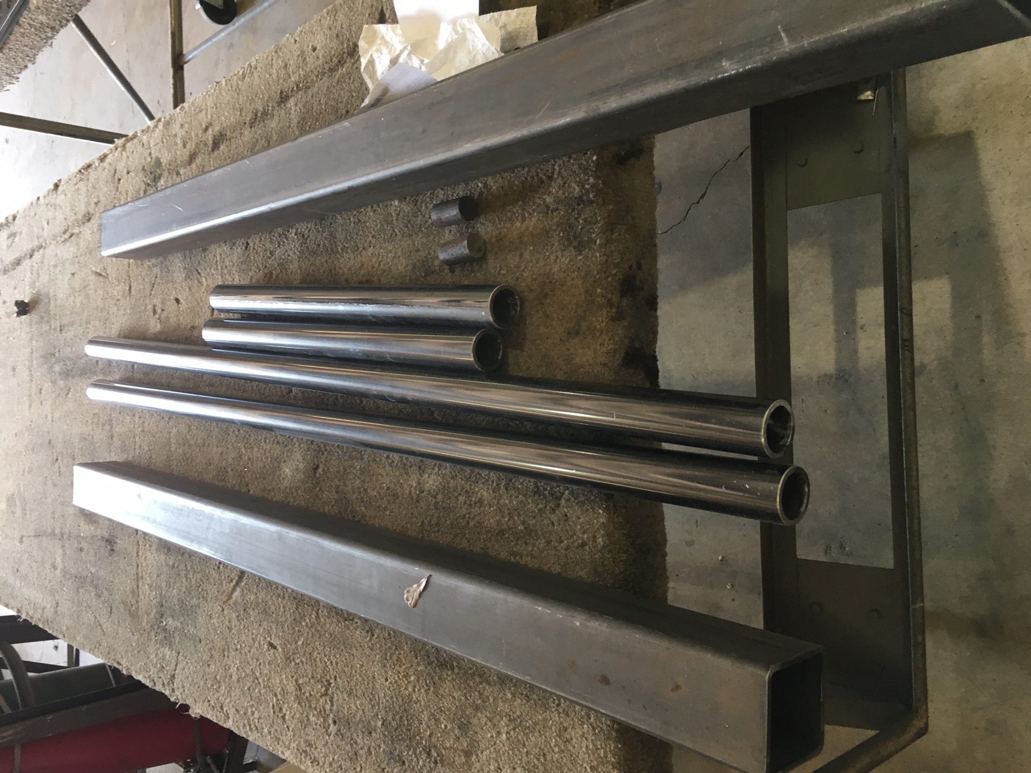

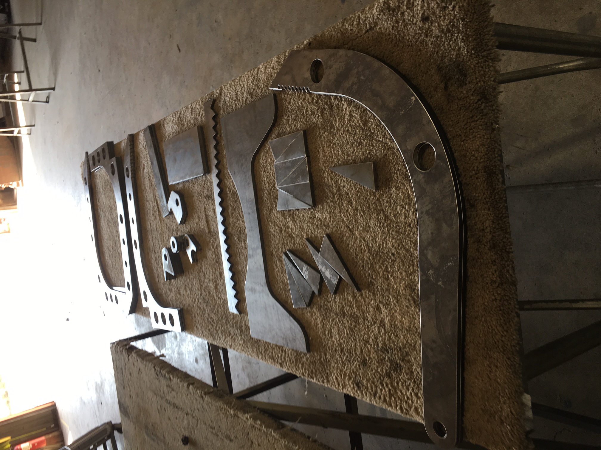

Well,

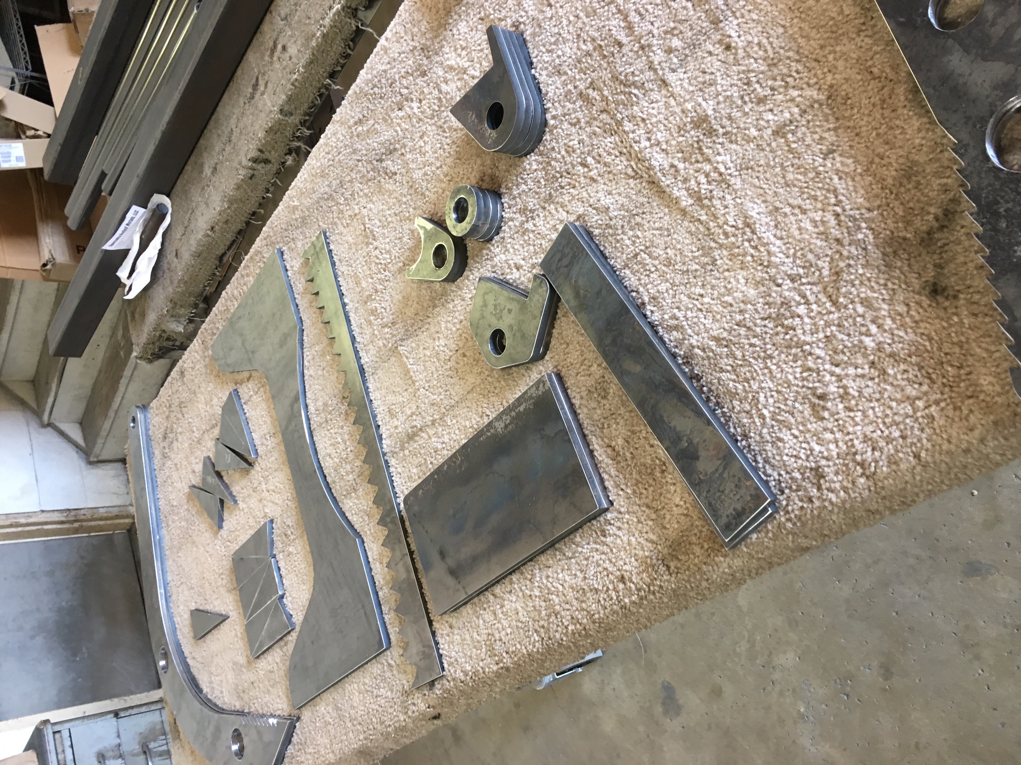

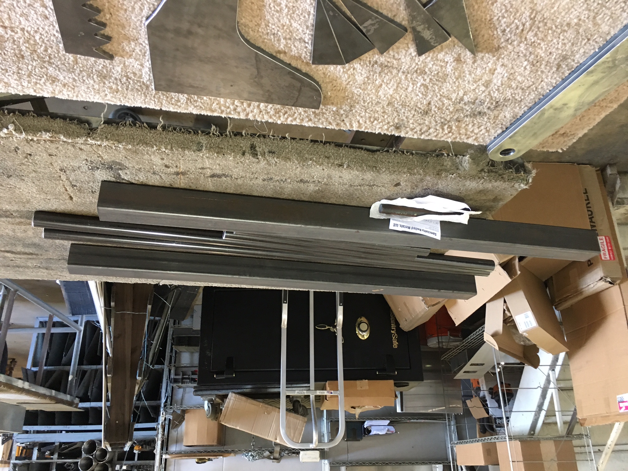

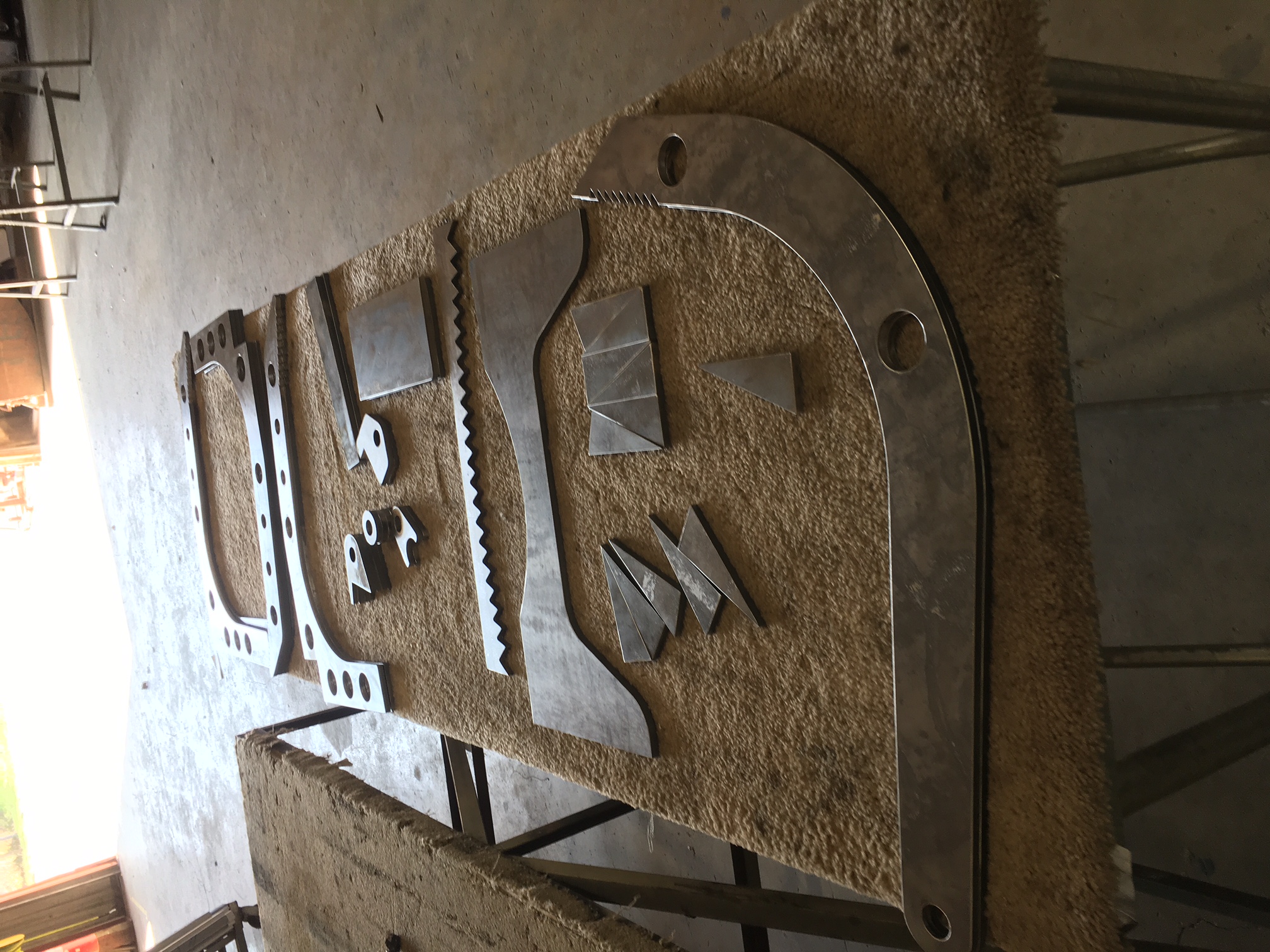

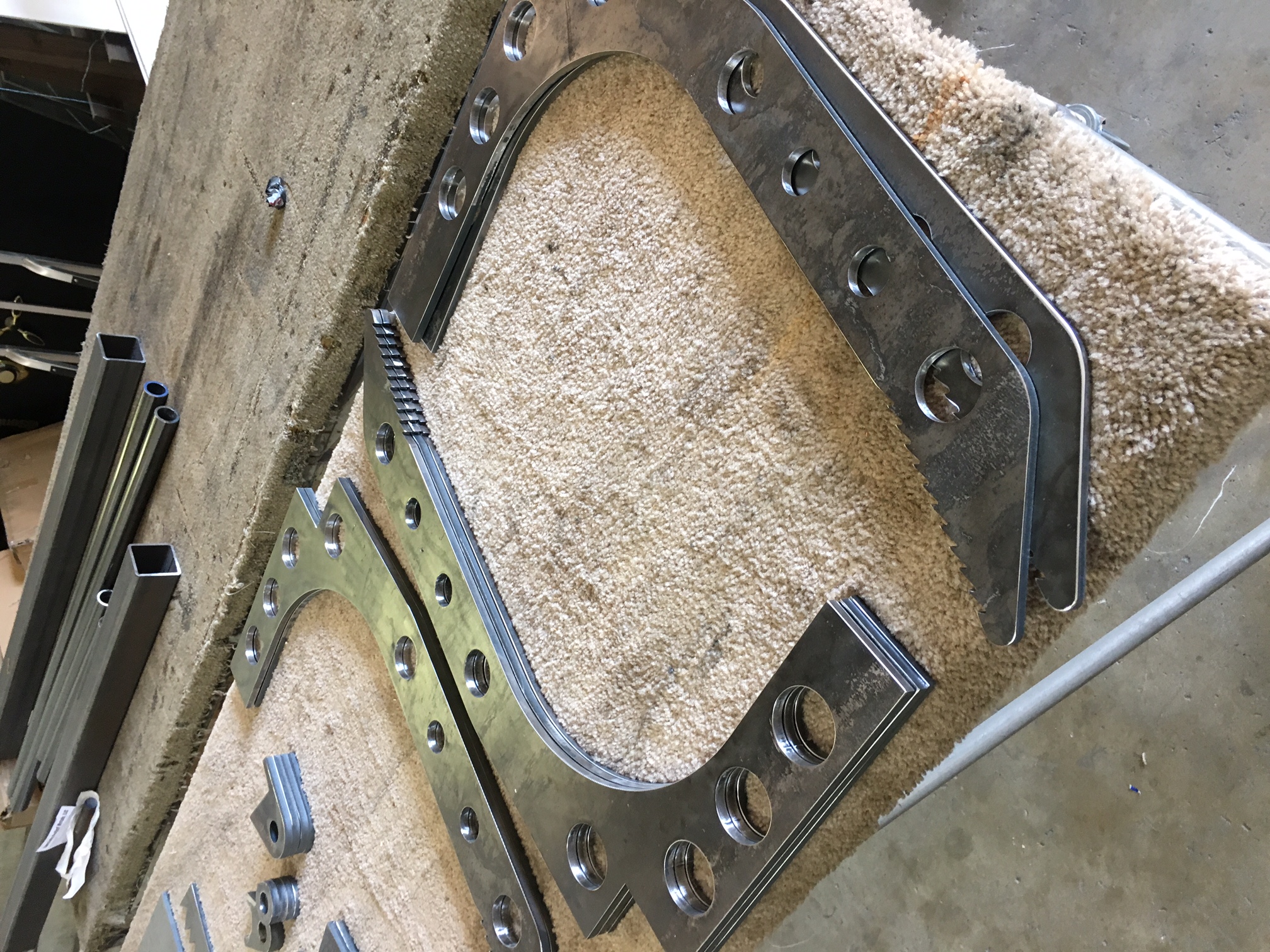

I am finally moving forward on my grapple build. See attached pictures.
I have one of the quick attach plates tacked together and will check for fit this afternoon.
Then tomorrow I plan on getting it all welded up.
Just waiting for the third function kit to come in along with my cylinder.
Then once it is on my tractor I will measure up for my hoses.
   / New Grapple Build! Let me know what you think #55
Looks like alot of welding ahead of you.
I still think you would have benefited from heavier round pipe. But time will tell.

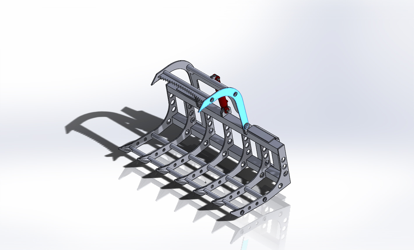

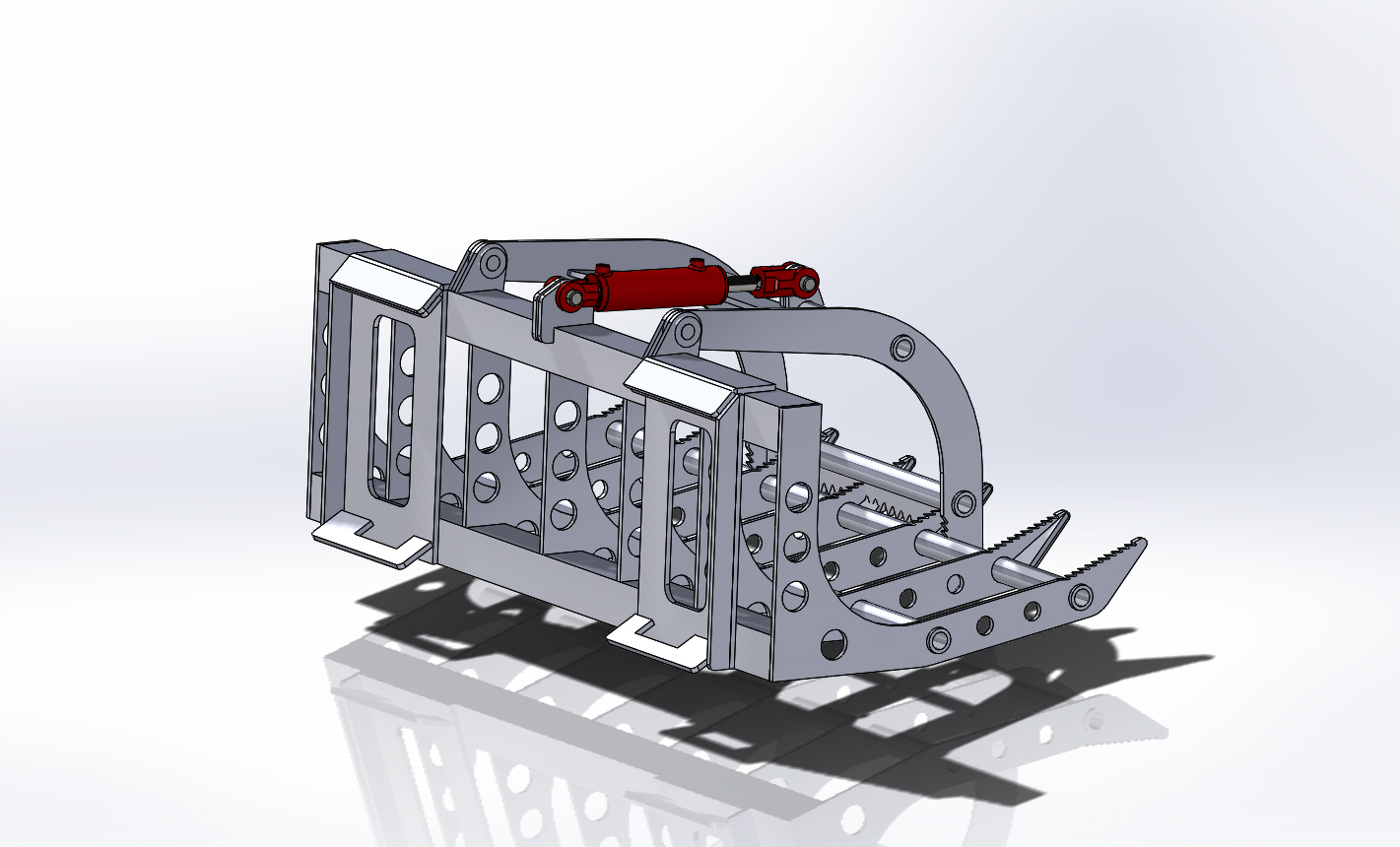

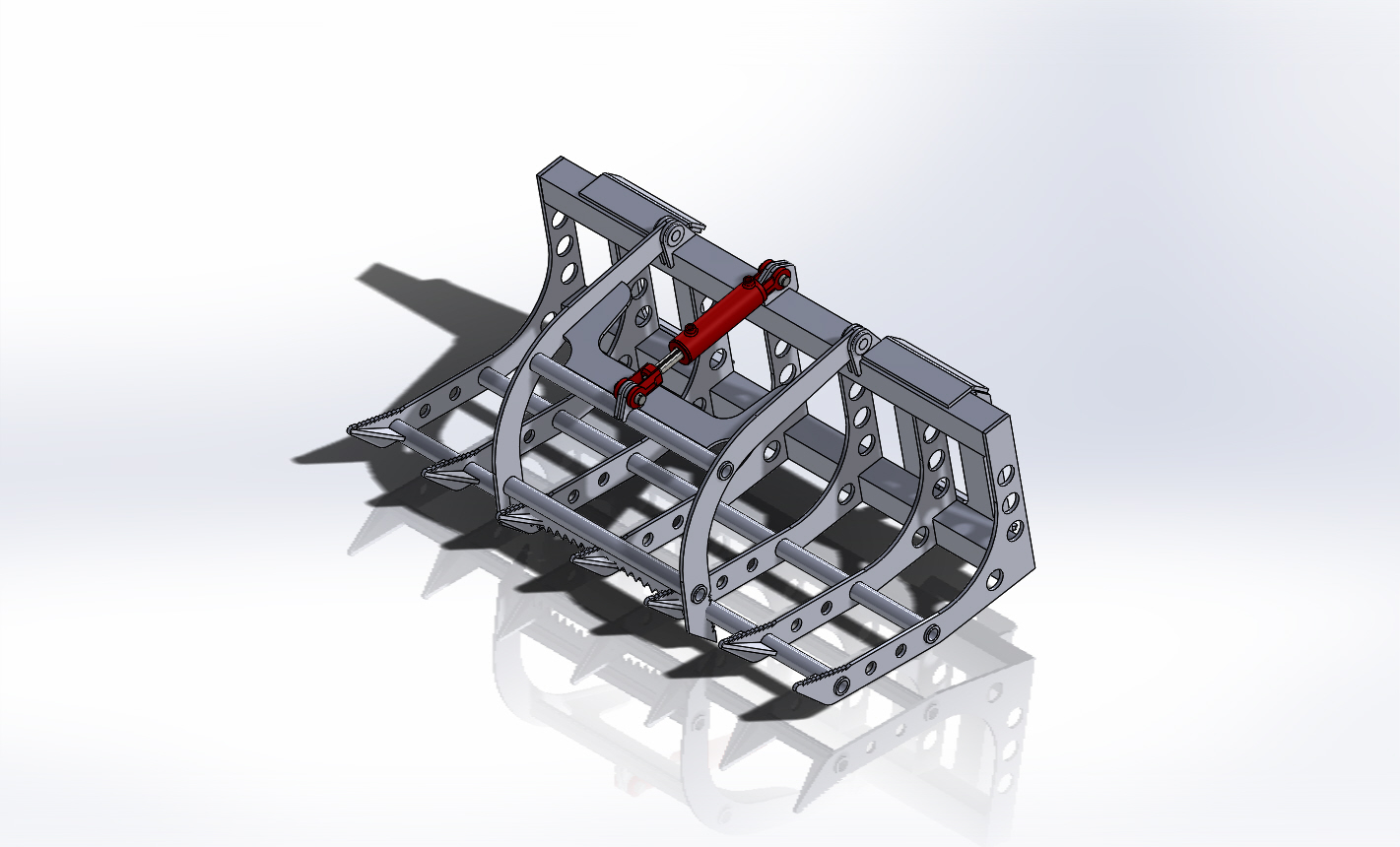

#56
Here is the final design, in checking out other builds - even with the 2" schedule 40 pipe for the cross members, having two should make it more than strong enough.
We will see.
#57
Oh and it's right at 280lbs
54" long
37" jaw opening
   / New Grapple Build! Let me know what you think #58
Impressive. Keep those pictures coming !!
   / New Grapple Build! Let me know what you think #59
I think heavier pipe was needed.
#60
Several people have mentioned that, the tines are 3/8", i couldn't get any heavier pipe very easily,
I will put it together and try pulling a stump up with it and see how it handles it, i do have two pipes in my design instead of just one like most designs I have seen so we will see if that makes any difference.
