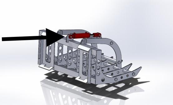

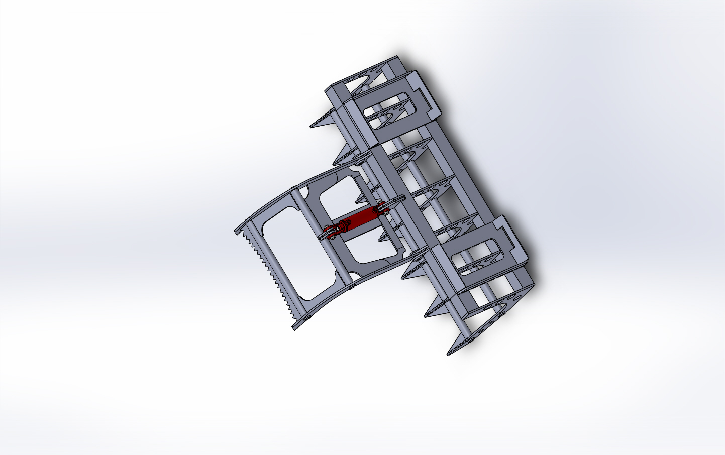

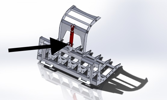

I think you'll want one more support centered in the lid to support between the cylinder and the center of the "jaw".
   / New Grapple Build! Let me know what you think #63
Just wondering why you lowered the mount for the base of the cylinder?

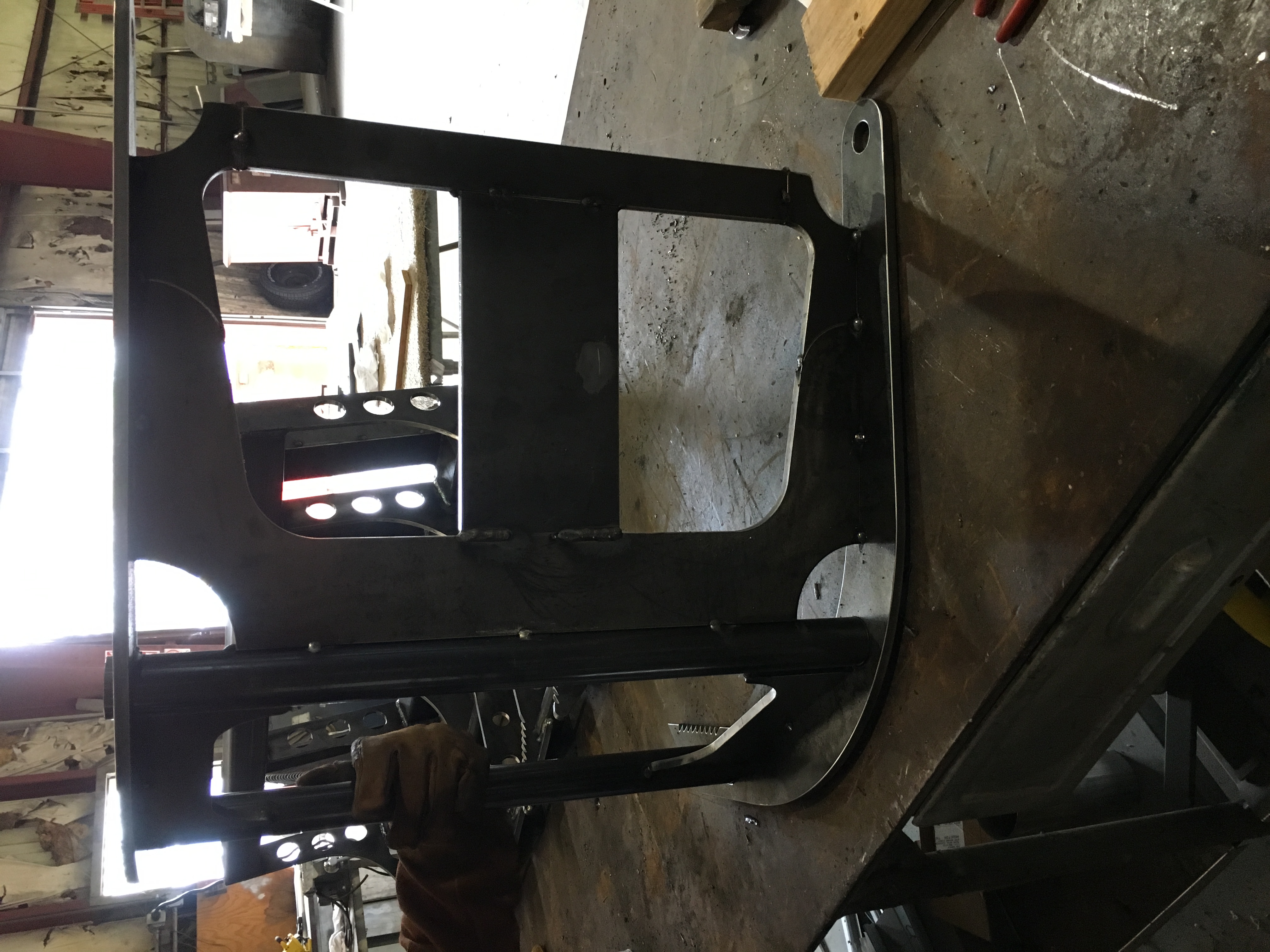

I have added more support. I am not sure I like the looks if it, but I think it is strong enough.
Still deciding if I am going to change the clam supports, but I am running out of material :)

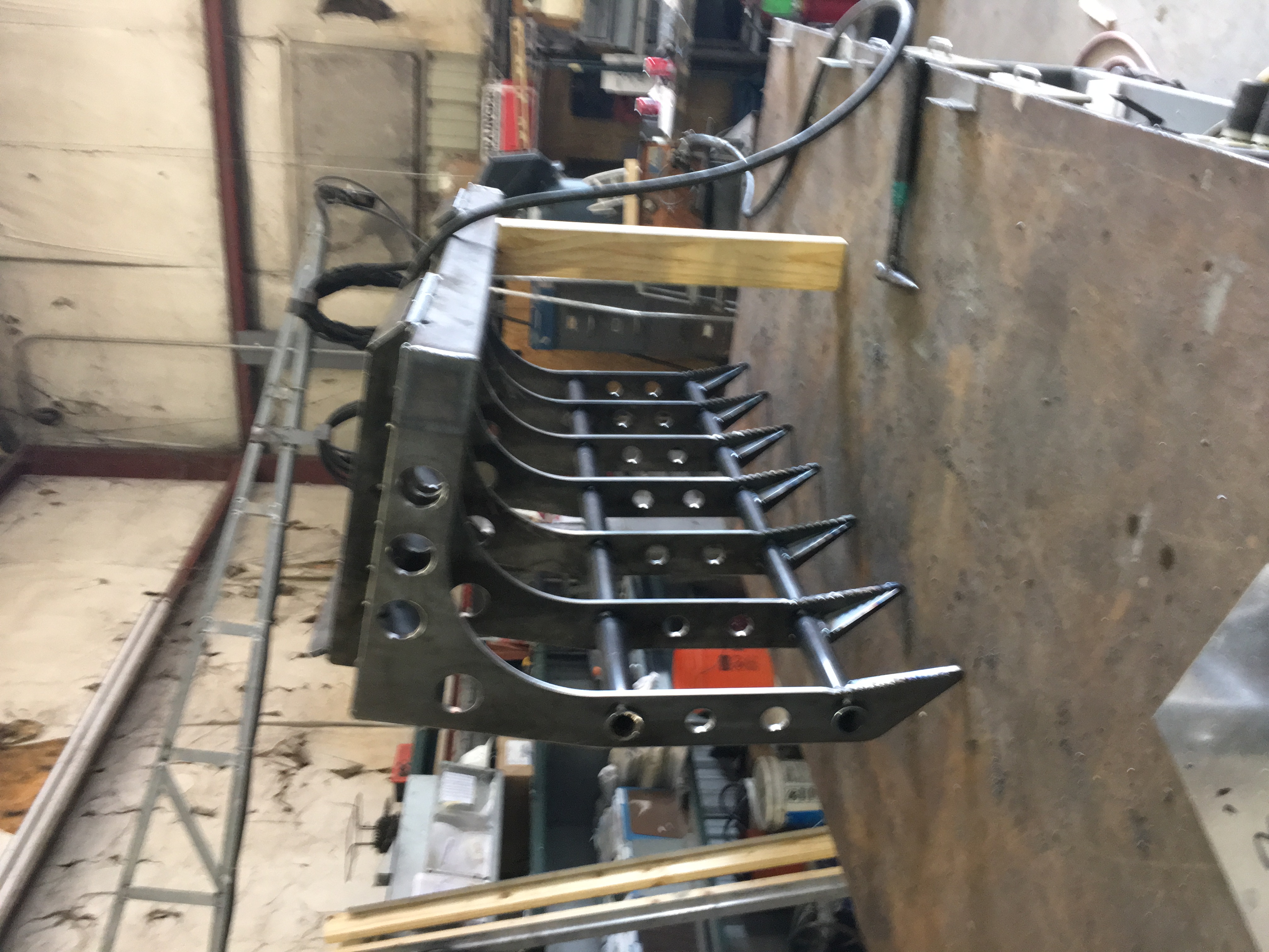

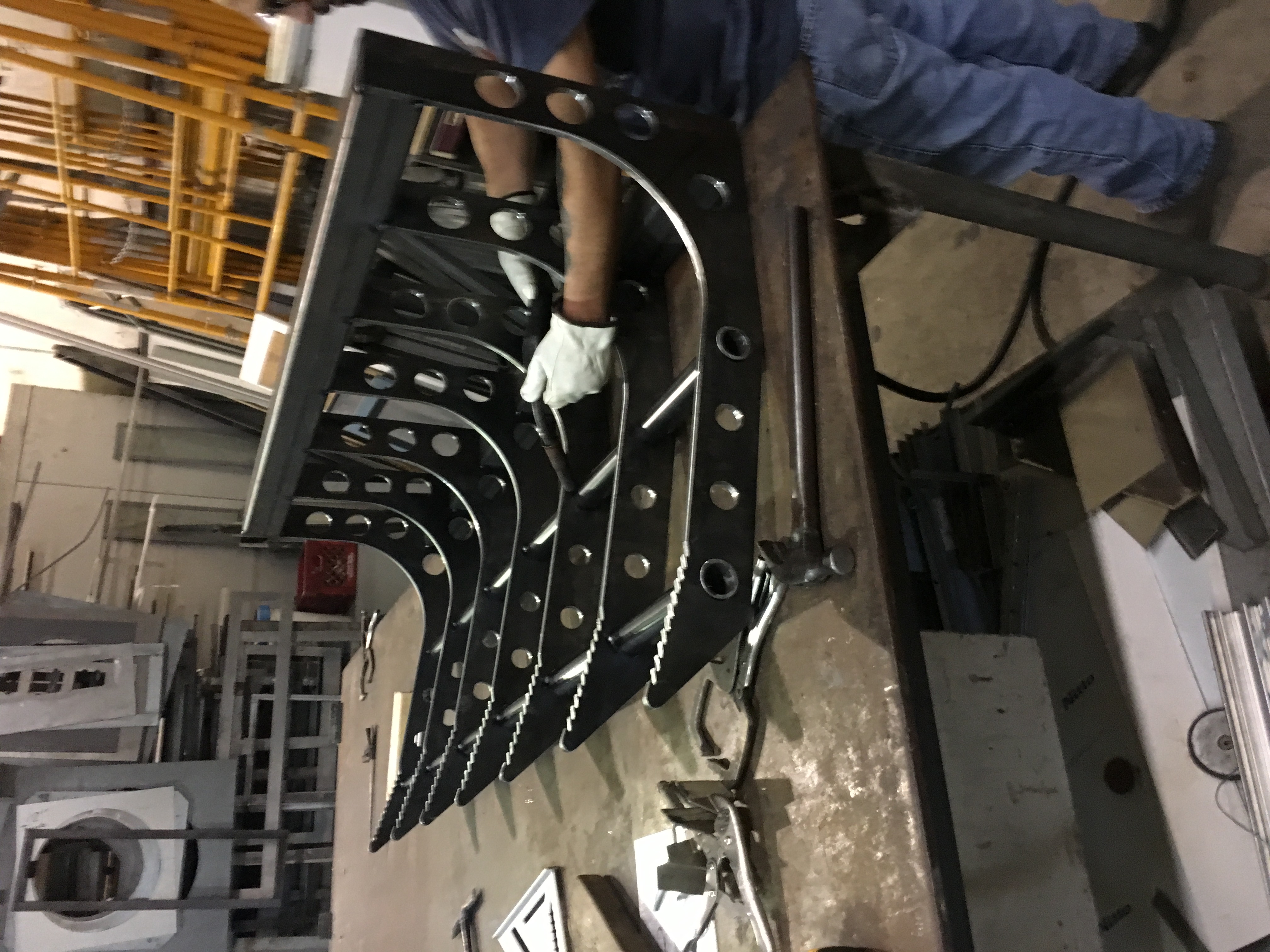

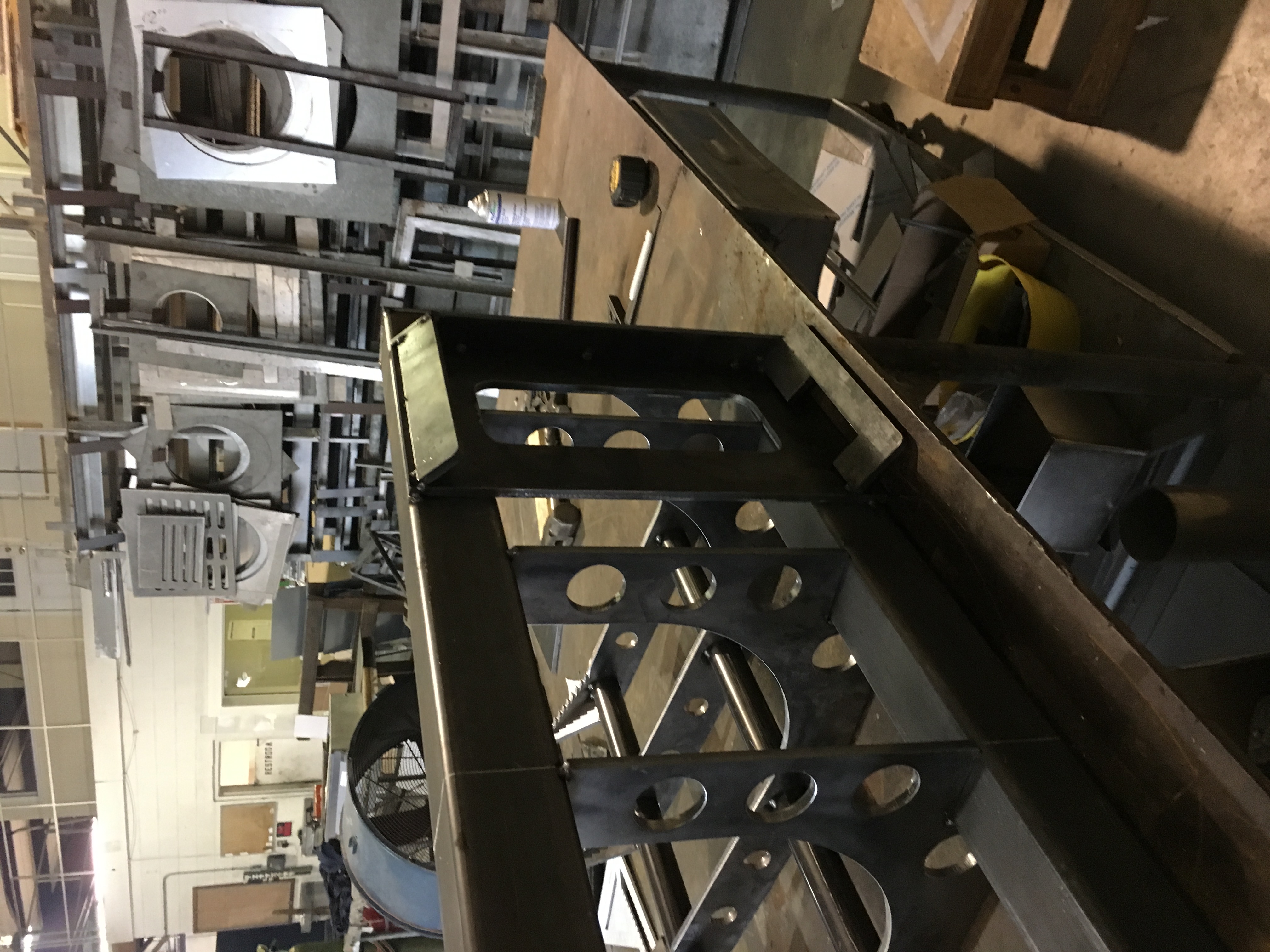

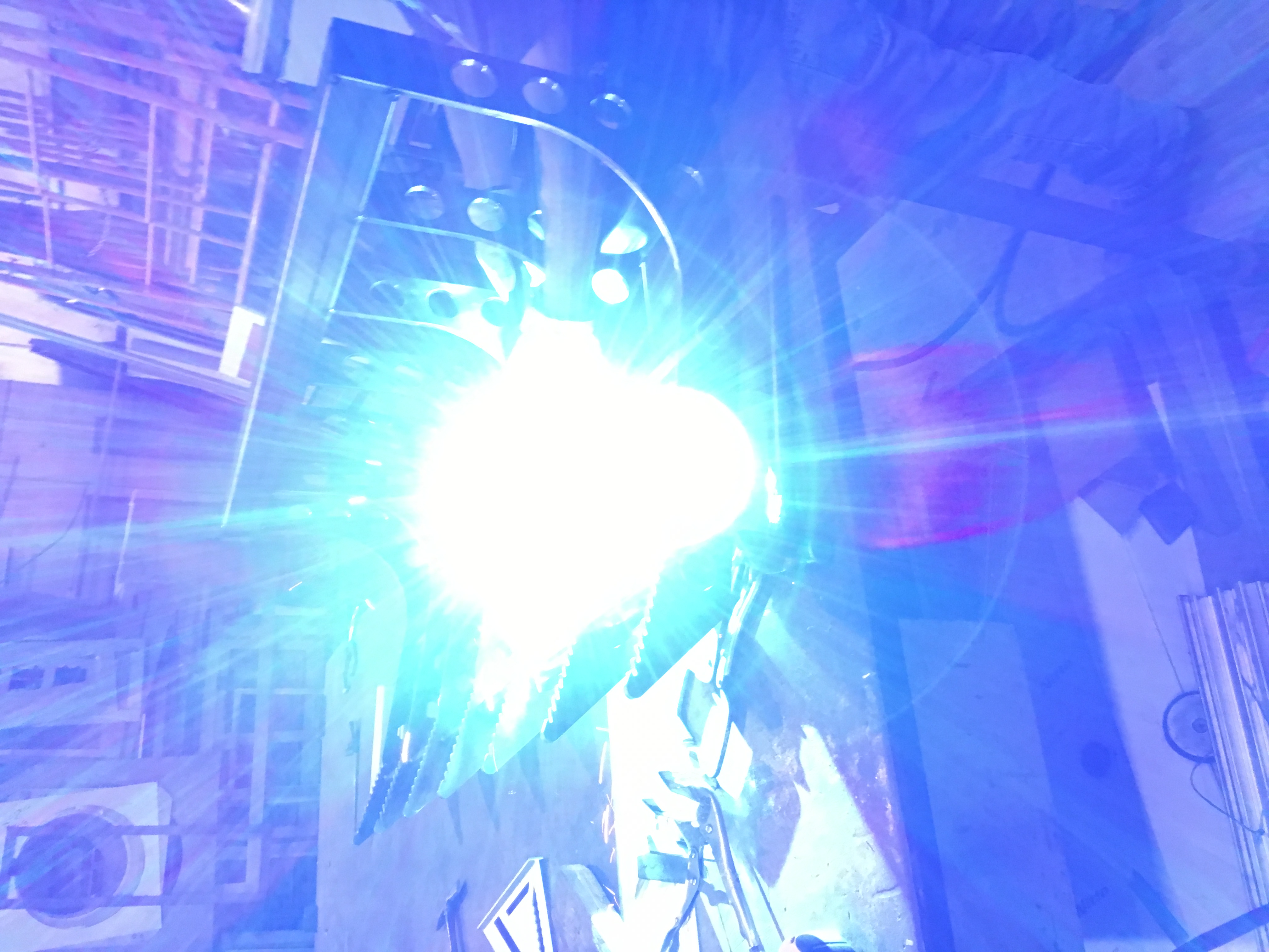

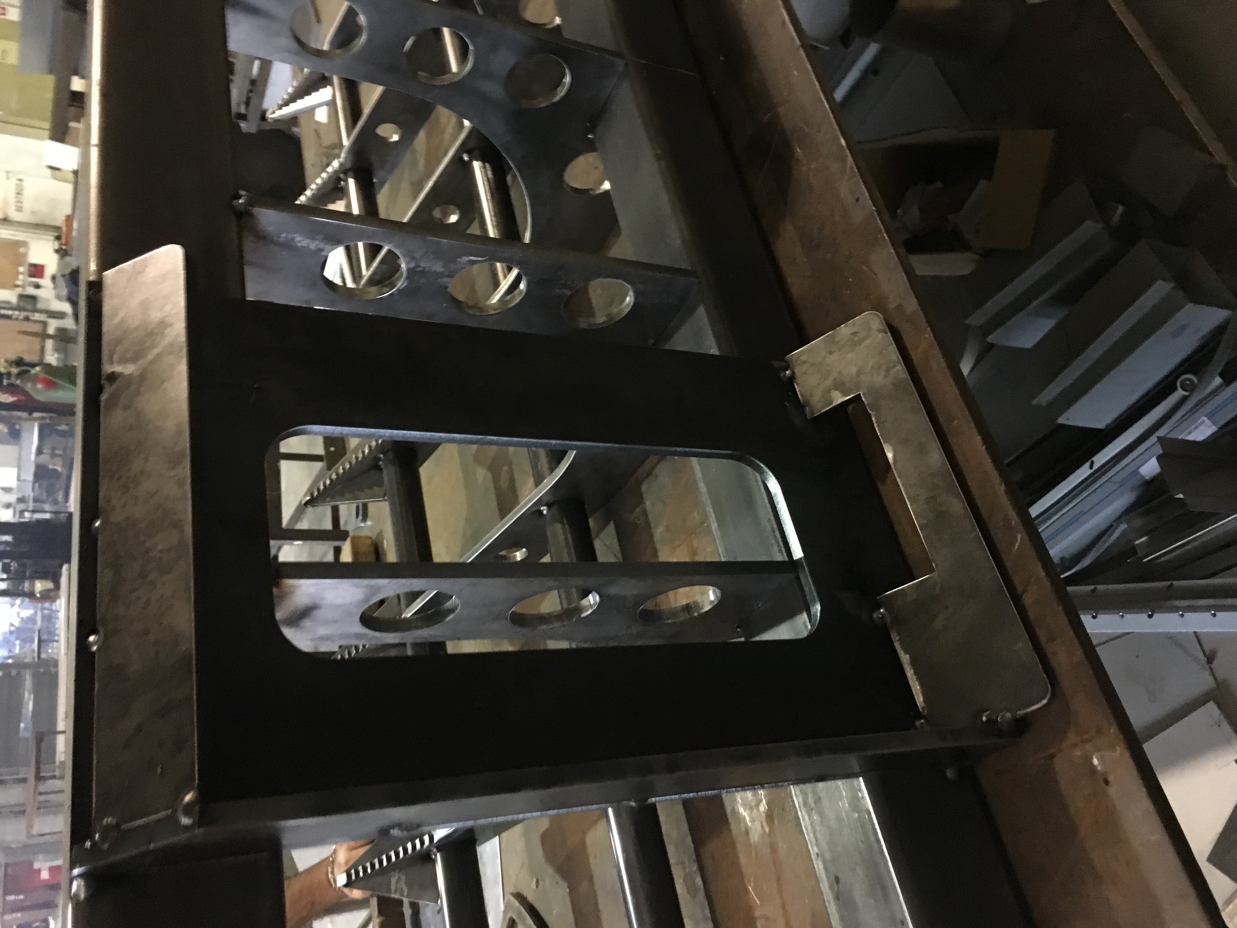

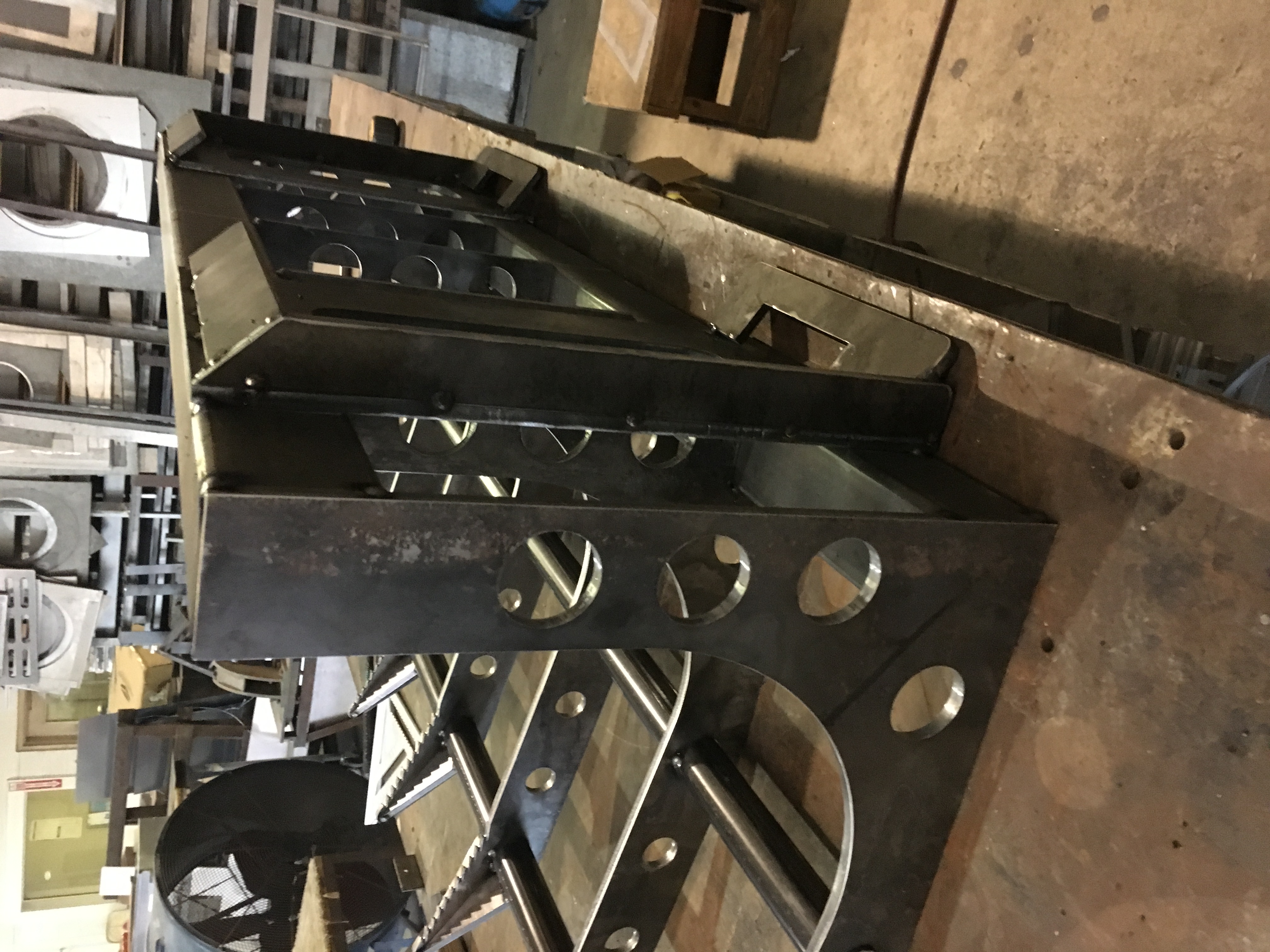

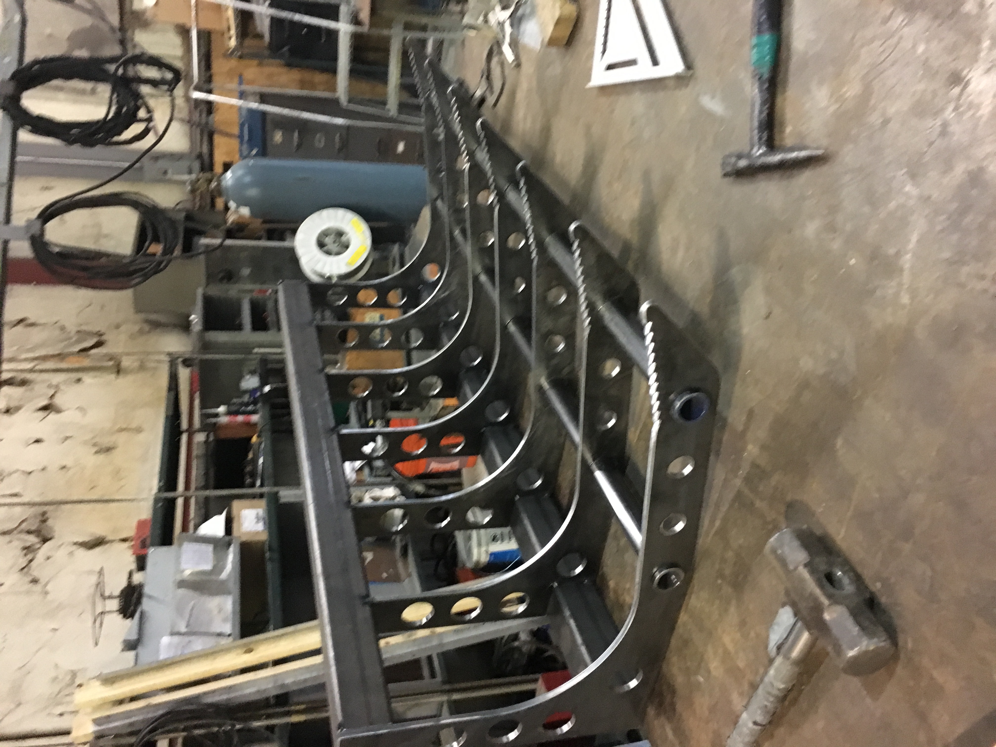

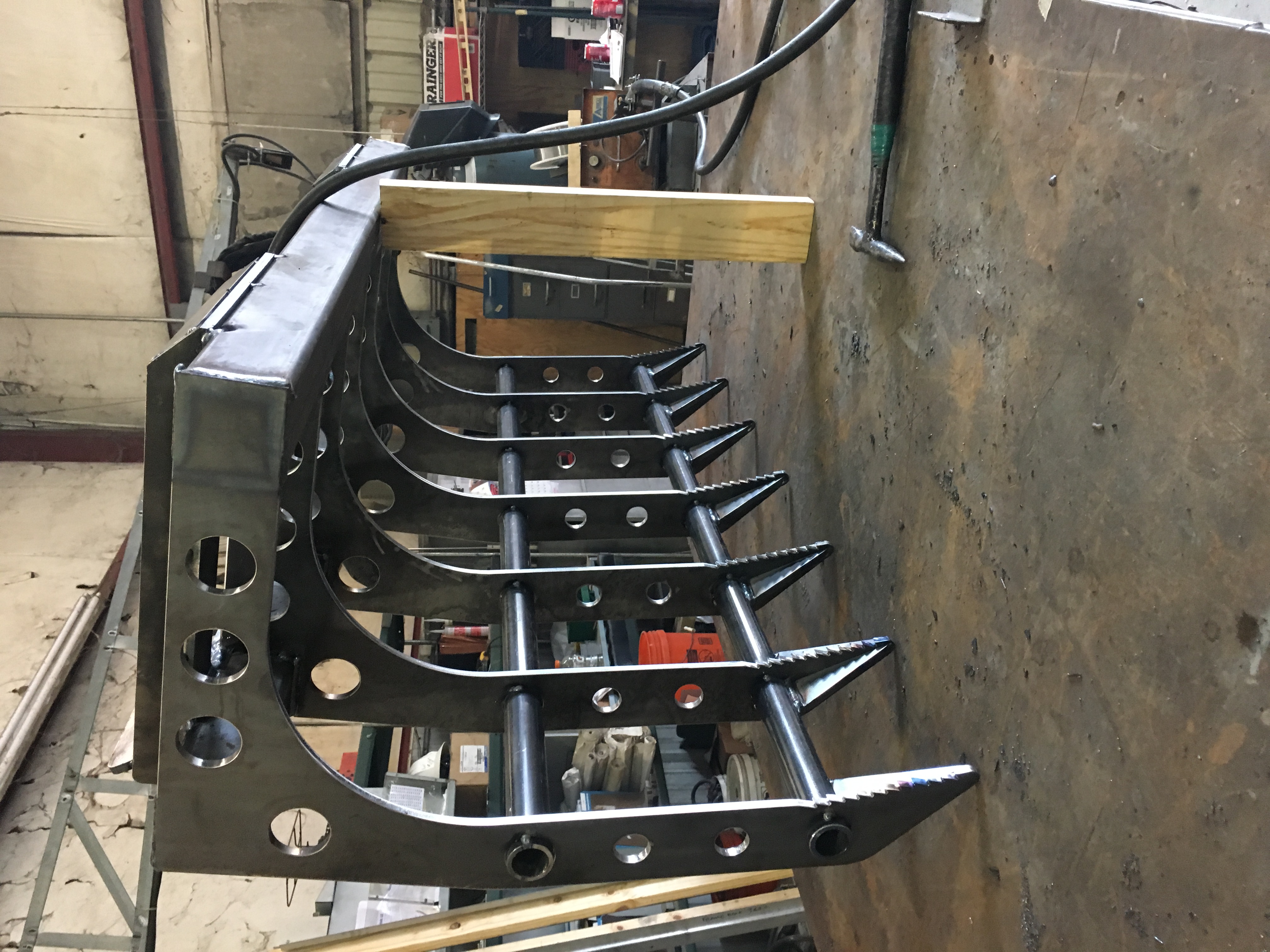

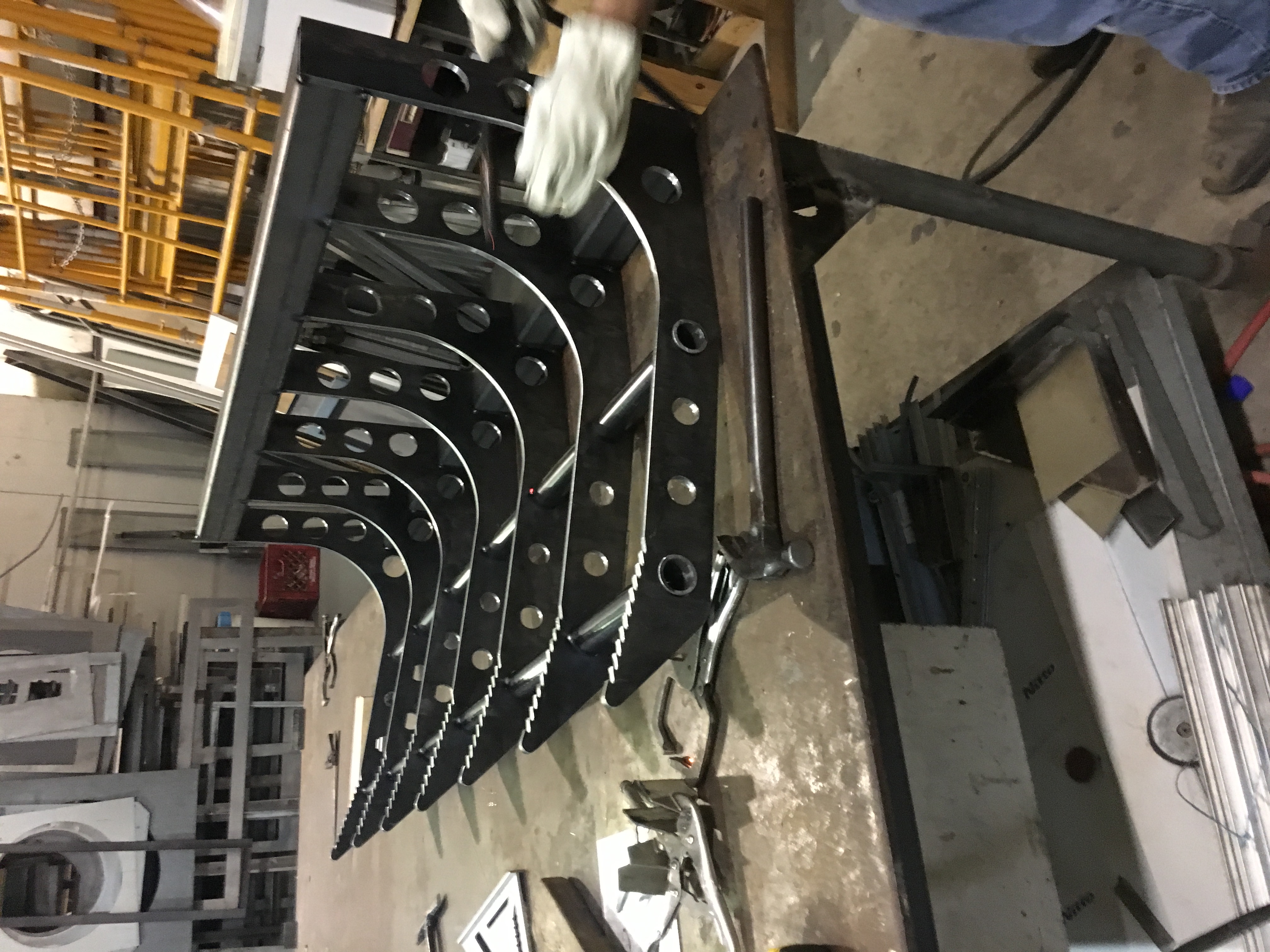

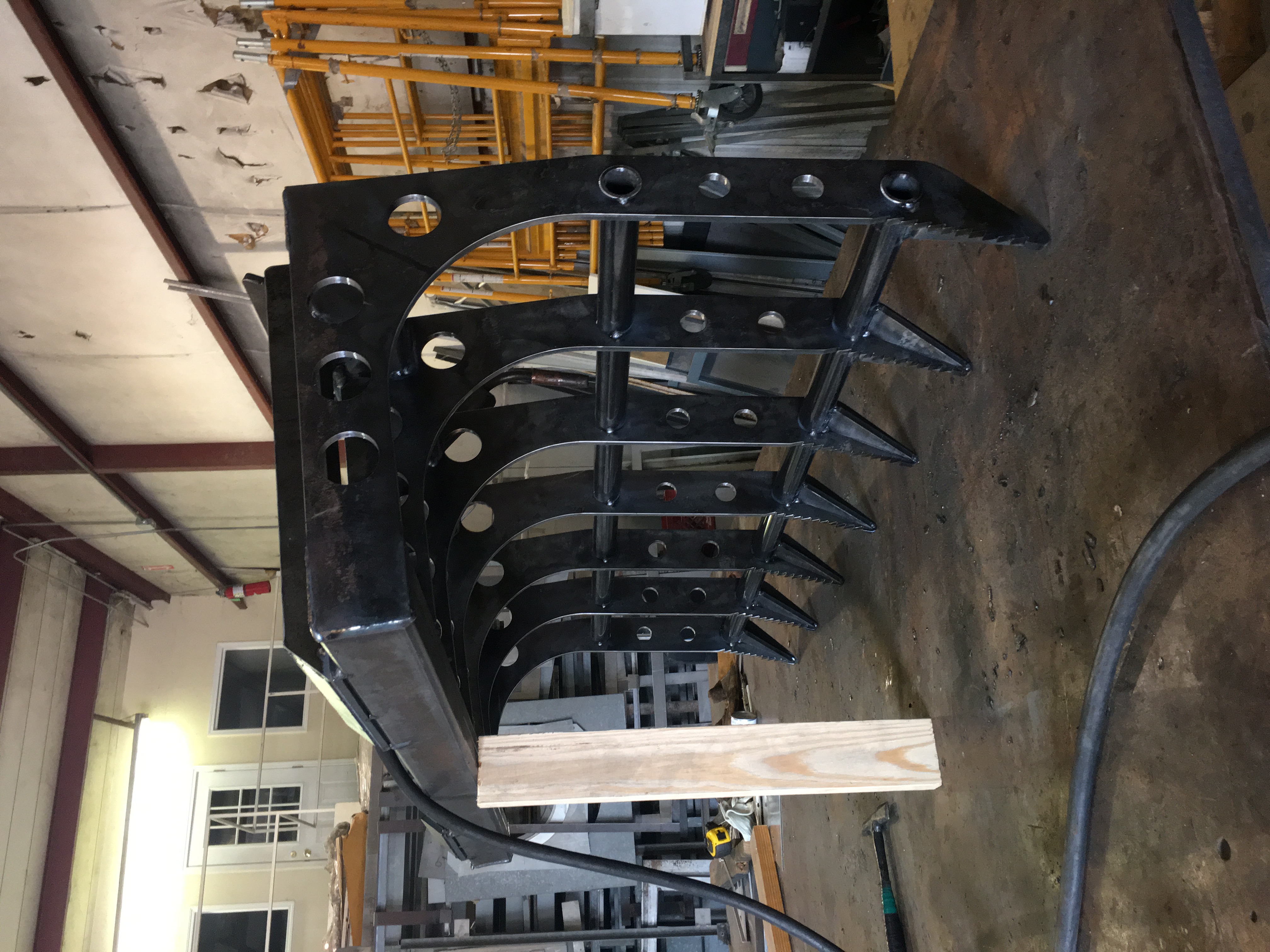

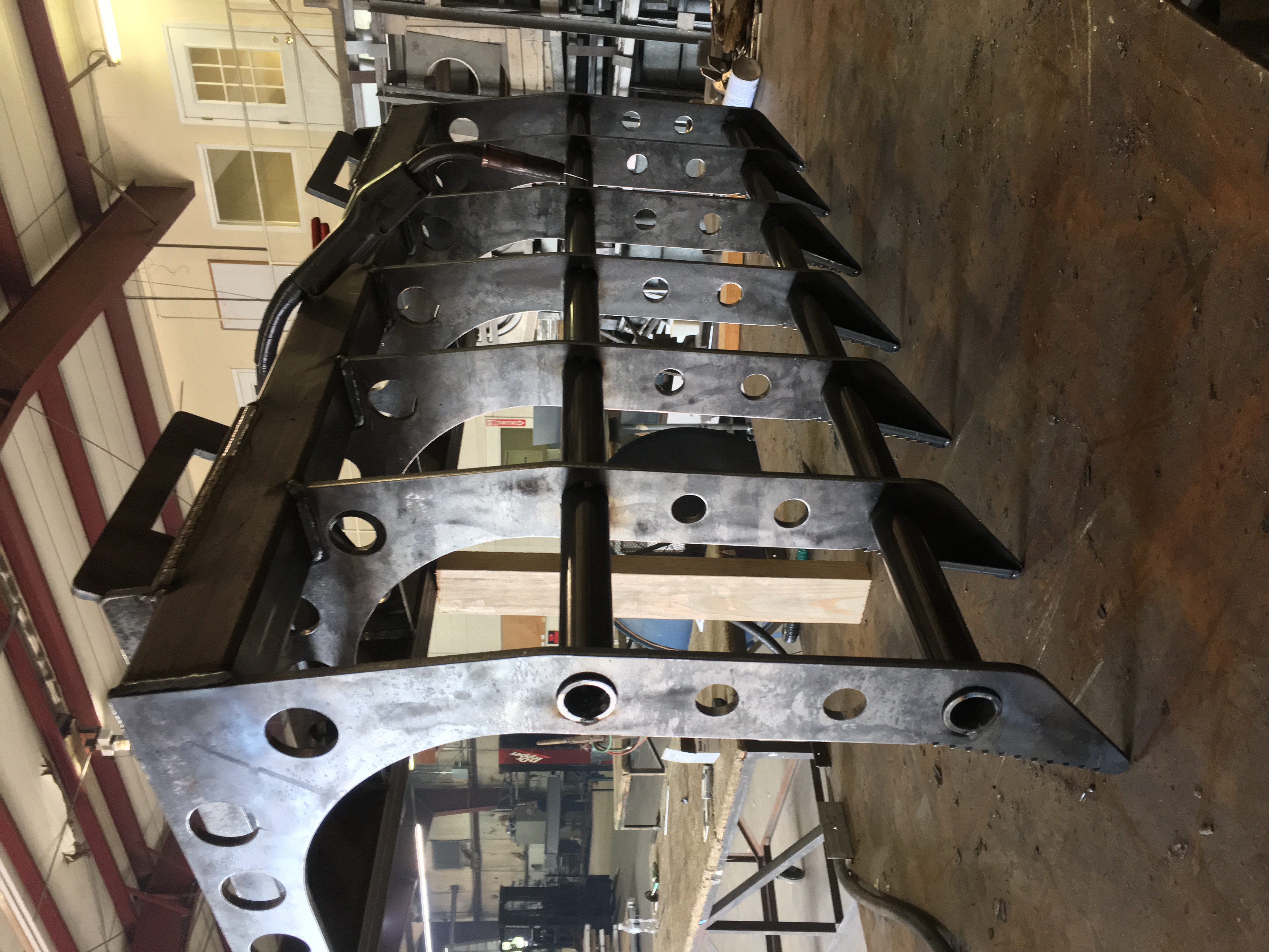

Here are some pictures of the build in progress.
#68

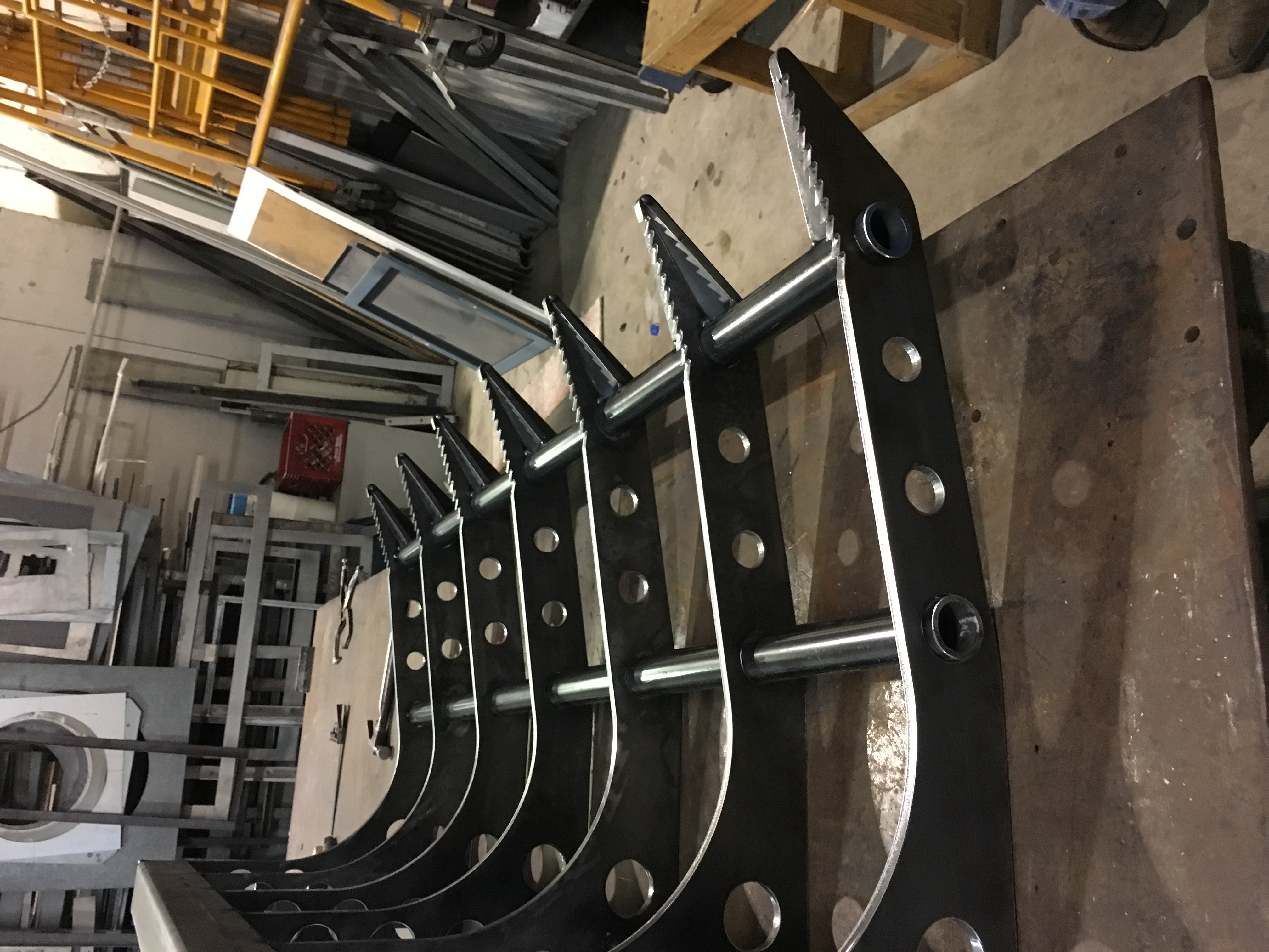

And some more:
#69

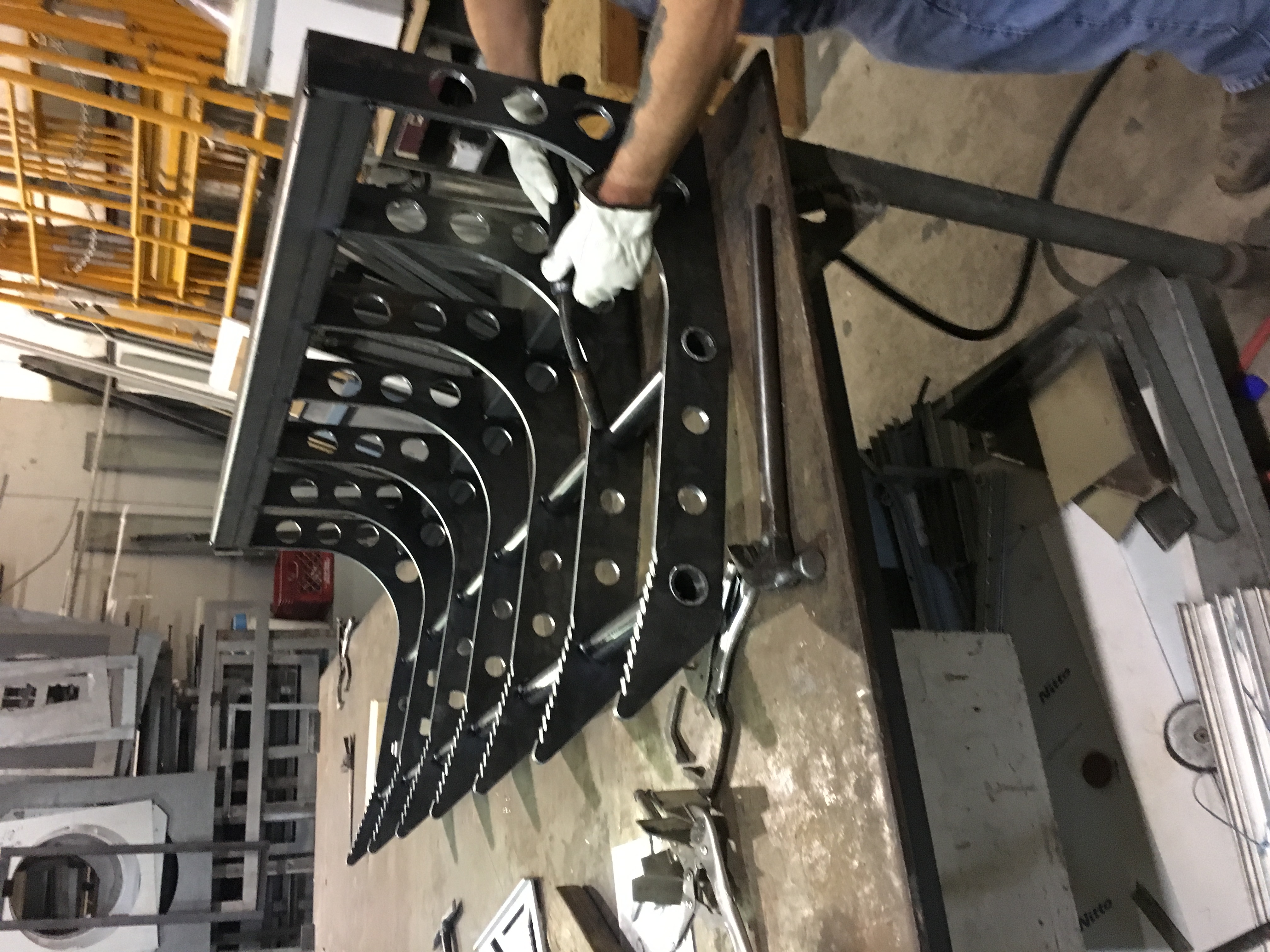

And still more:
IMG_0671.JPGIMG_0670.JPGIMG_0669.JPGIMG_0672.JPGIMG_0673.JPGIMG_0675.JPGIMG_0676.JPGIMG_0677.JPG

I need some help with the bushing and shafts.
Does anyone have a line on getting those near Houston?
Found the cylinder at Suplus Center.
I am trying to decide between WR Long and Construction Attachments "one touch" kit.
Or just build my own from scratch (with a little help from my friends here on TBN :thumbsup:)
So any suggestions would be nice.
Thanks
Steve
I wouldn't worry at all about bushings. My grapple is twelve years old and has no grease-able pins. The jaw pivots on 3/4" bolts. No grease ever. The threads at the contact points are worn off but it appears that the bolts will need replacing in about fifty years.
Regarding hydraulic controls, I'm a fan of just using rear remotes. I have used diverter valves and rear remotes and I prefer the much cheaper and simpler rear remotes.
