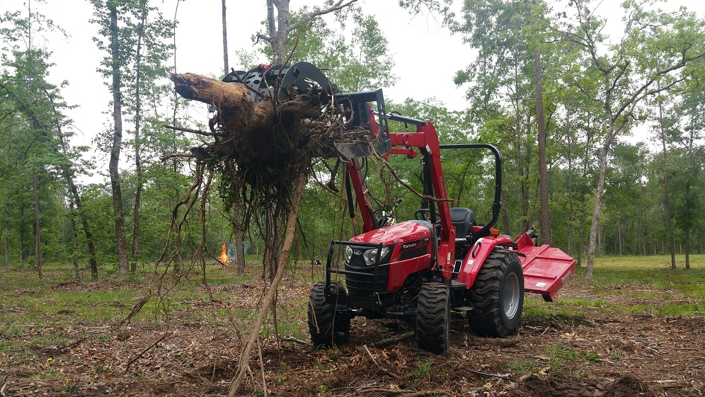

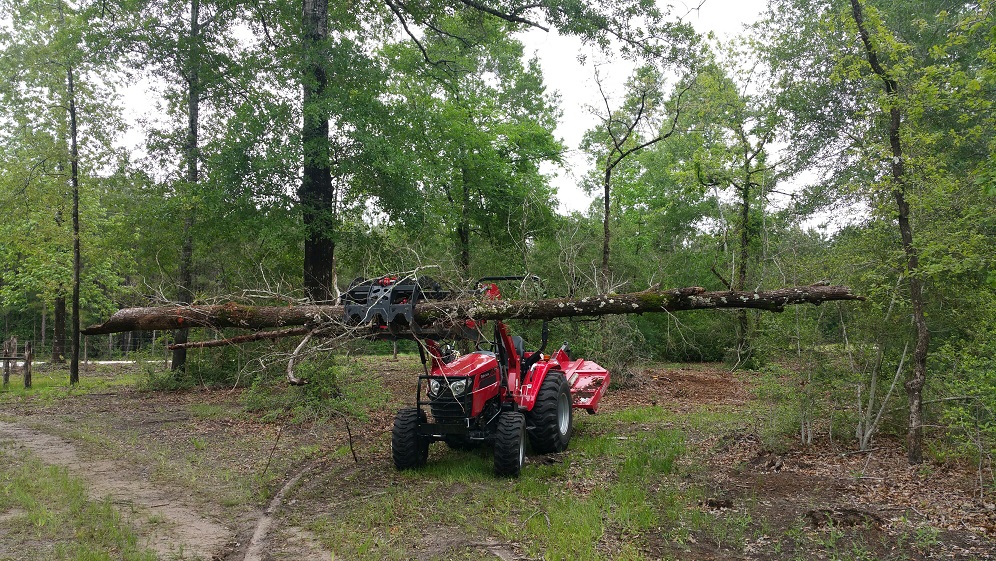

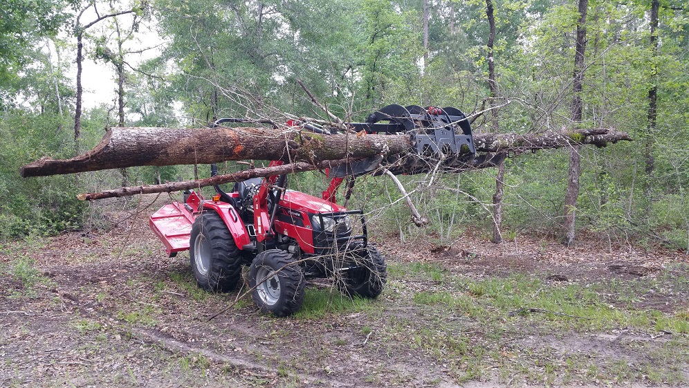

That's fantastic! Nice fabricating. Hope my crummy cell pics and rambling plumbing description helped.
Pretty soon you'll be doing this!
Snowback,
I have seen these pics on some other posts - your setup is what convinced me I need a grapple!
I really appreciate all the help you gave in this build, with no help from either the owner's or service manuals my only other option was to head back out to Navasota and talk to Chris at J5 Tractors.
You really brought it all together for me.
Thanks again!

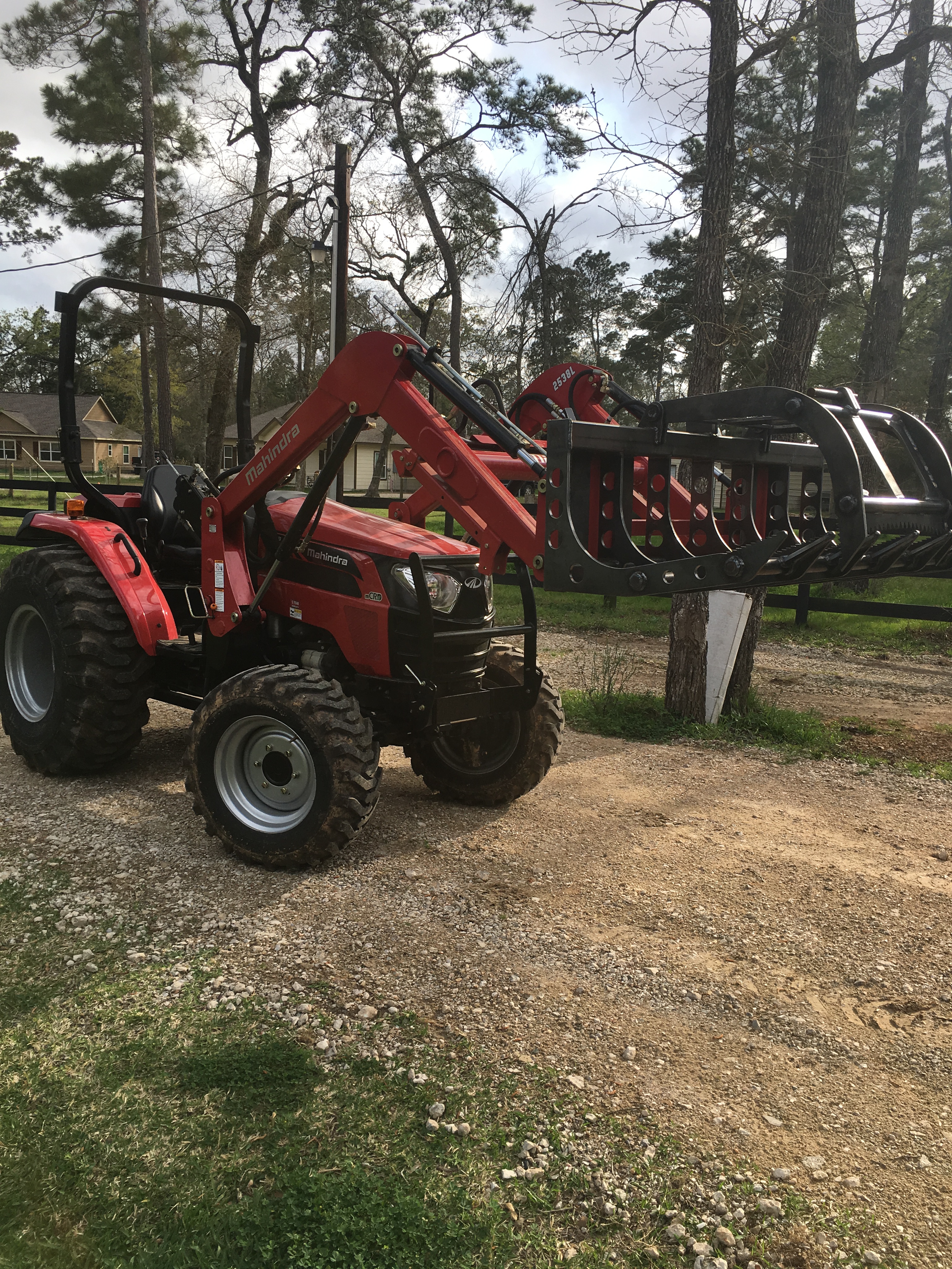

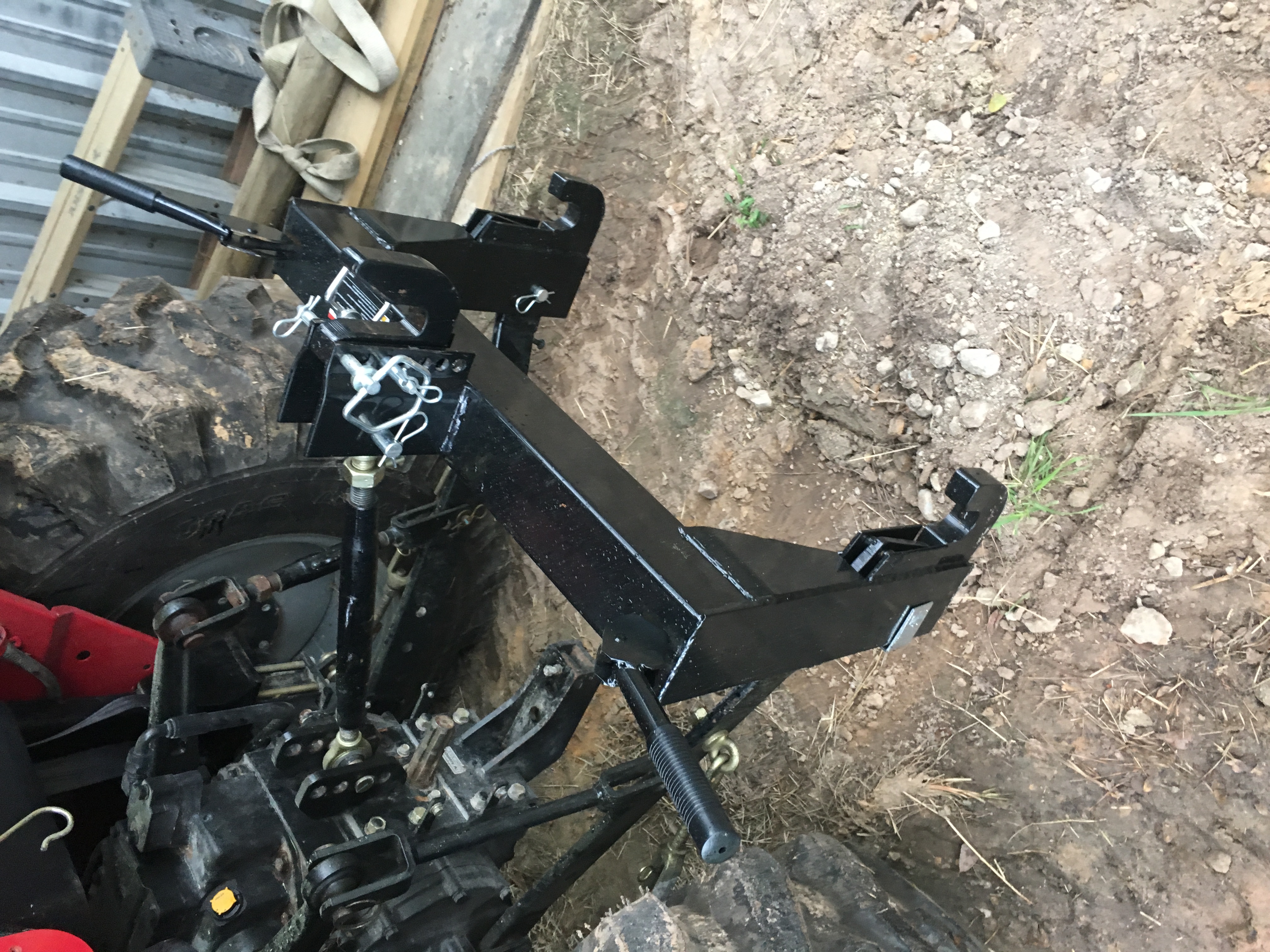

Well, Almost done!
Got my grapple dry fit for extra assurance. Now it's off to paint and then patiently ( :( )waiting for hydraulics and 3rd function kit.
Also got my Quick Attach on and my two most used implements set up for it, my box blade and my rotary cutter; I still need to set up my landscape rake, trencher, fertilize spreader and my 55 year old disc.
