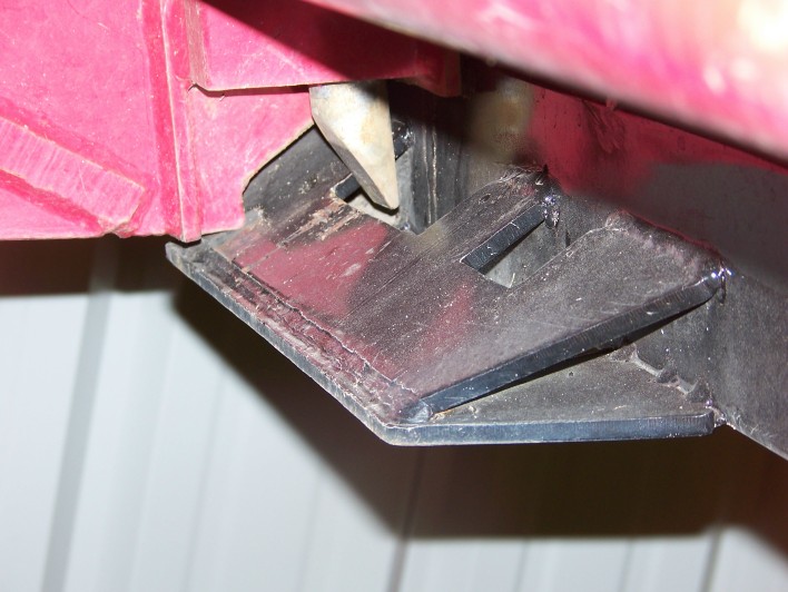

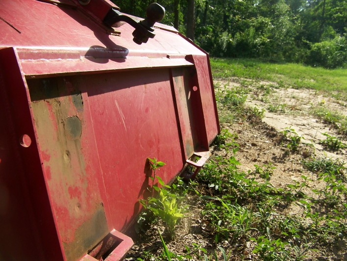

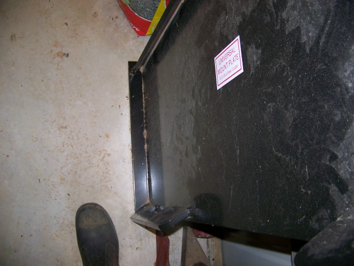

This morning I posted with no sleep after working in the humid heat all night. Now that I have had a "nap" and a Coca-cola, I have printed the PDF and my "simplistic" drawing. Now as to the PDF file. First off...........that design's lower angle is nothing like my KMW bucket, my grapple, or my spare QA adapter plate I bought at a RB Auction.
However, 16 5/8 to 16 9/16th inch is the overall dimension between the upper and lower mount APEXS. This dimension is a direct result of the angle apex dimension of 15 7/8. What I am trying to say is some folks are using 15 7/8 and some folks are using 16 5/8 +- 1/8 inch for the distance between the upper and lower "mounts". This is the problem. If these two different dimensions do not "intersect", it is builds in sloppiness.
Notice the photos below to see the difference from the PDF file's lower design. Now for the coup de grace...............when you read the PDF file you will see the notes down near the bottom of the page it says.............................NOTE...Some attachments may require added support structure to the attachment interface between surfaces A and B. ;) Also, I believe the QA tool carrier manufacturers are to blame also, as my tool carrier lower mount and latches are different from what is on a Mahindra 4110. So one can not really point a finger at a particular attachment manufacturer.
hugs, Brandi

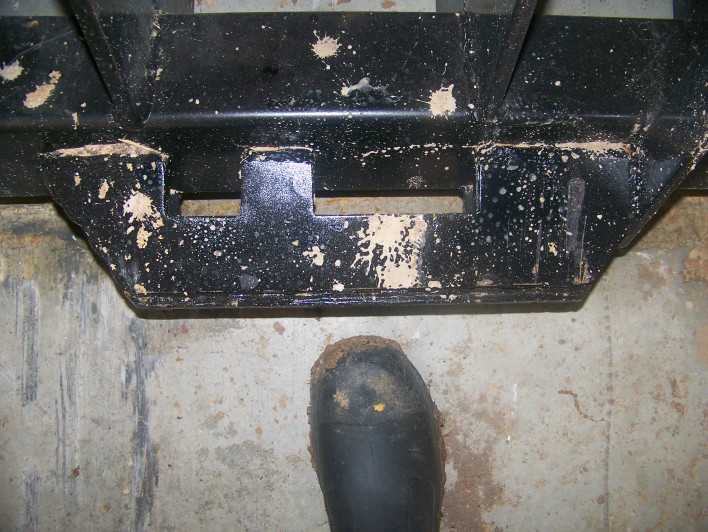

Brandi - did you ever get your shims? If so, how is the grapple working now?
   / New Grapple
#48
VirginaiAgent,
I have been so busy on my new pond here Instant Pond, I forgot to post photos of the shims and welding. I had it welded up on the 5th. 4 plates each 1/4 inch thick. I asked for 3/8 inch thick shim plates. But we tack welded 2 per side and all seemed fine. Since it is nats on now, it needs a little finesse to unhook. Hooking up is a breeze. Last unhook was a breeze also. Guess it will take on and off a few times to get the corners and burrs smoothed out. I had my trailer fender inner skins tack welded at the same time by the same welder and he only charged me $50. I am not afraid of it now, so the kids gloves are off.
Oh yeah, I spray painted it gloss black when it was still hot from welding. It can not be too hot or the paint will blister. Taking it on and off hasn't hurt the new paint.
hugs, Brandi
