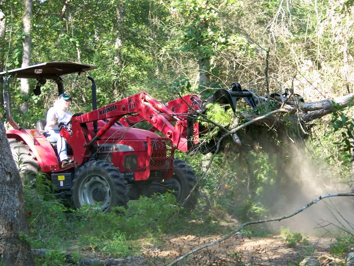

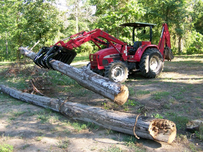

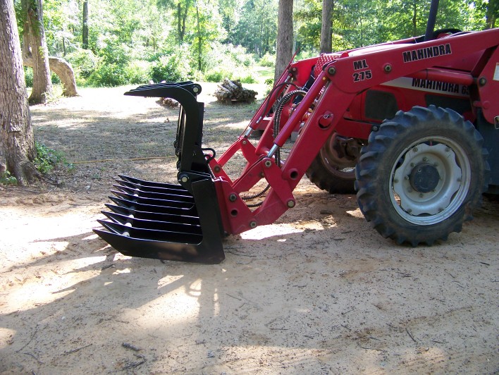

I picked up my 72 inch grapple on Friday. It was shipped to my local dealer with no freight charge from www.palletforks.com (Skid Steer Attachments Pallet Forks Hay Spears Bobcat Cat John Deere Mount Plate)

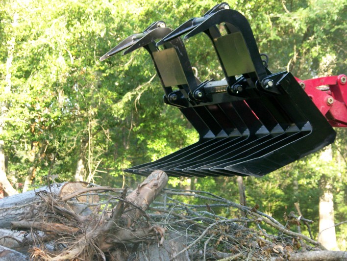

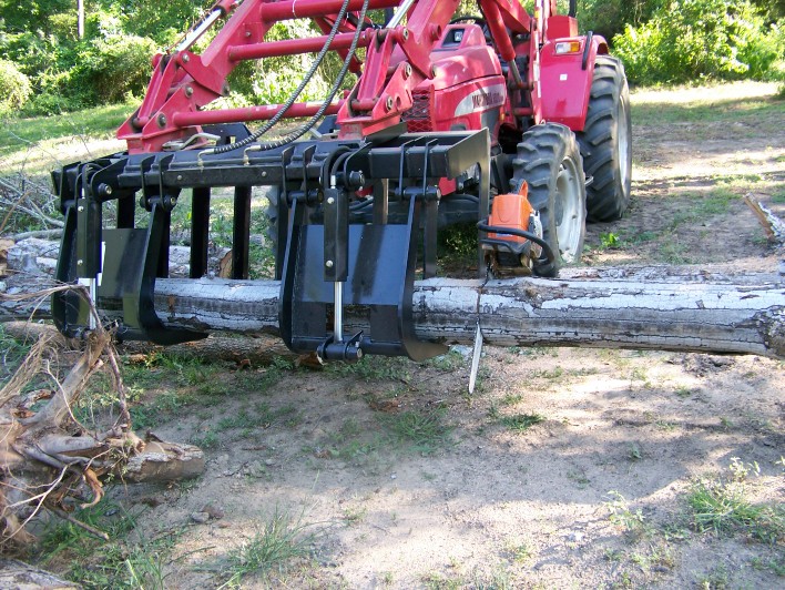

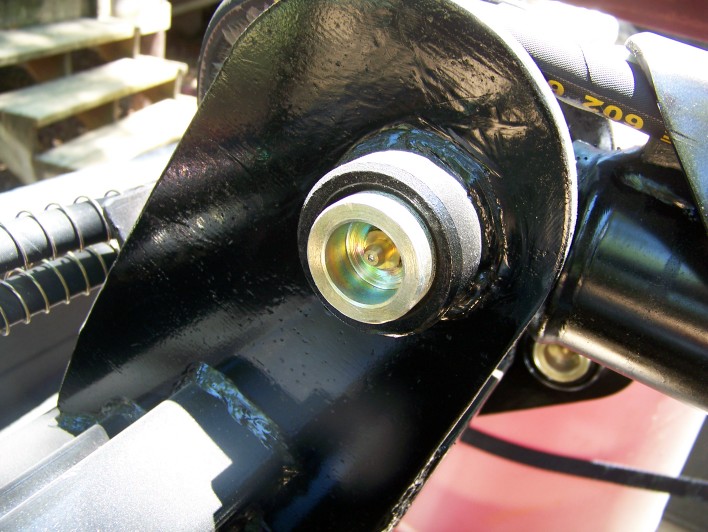

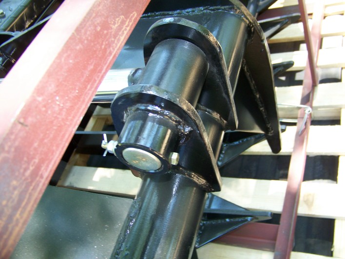

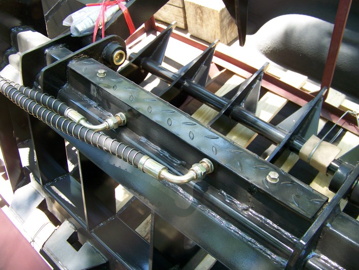

I love it. It has recessed grease fittings on all pivot point, massive (I think 1.25") pins retained with bolts, and covered center hoses with the hoses to the QAs spiral wire cover. The cylinders are also covered, but not the chrome. Got this all for a very good price.

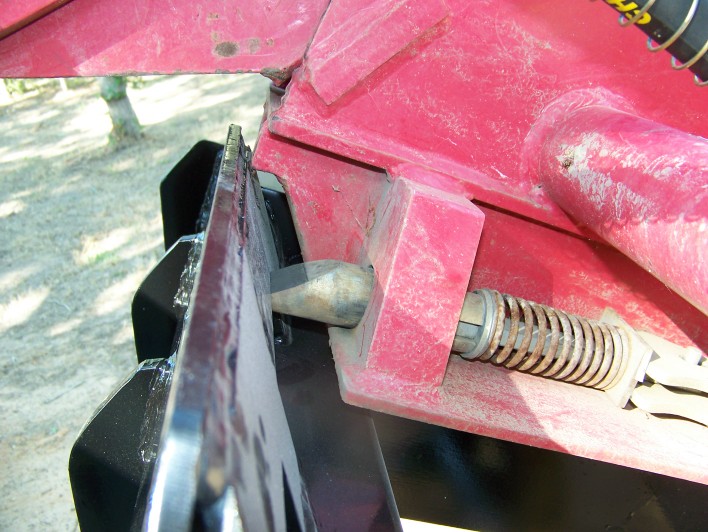

Now, my left QA pin engages this grapple slot less than 1/4 inch. The right QA pin engages the slot about 5/16th inch. I am thinking of welding 3/8 inch plates on the back sides of the slots for positive pin engagement. Is this slop normal for a skid steer grapple on a utility tractor? It is on my Mahindra 6520 4WD with a KMW ML275 loader. It works fine right now as long as I don't back drag anything with it. But I want the grapple to be able to handle all my tractor can give it.

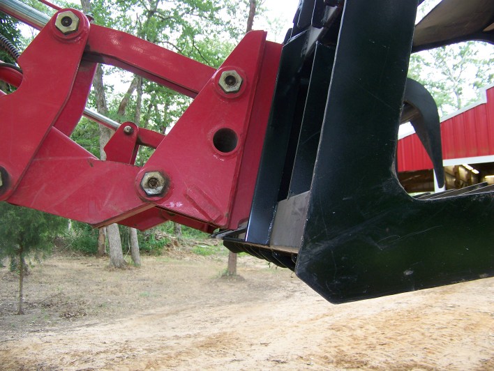

Post up a picture of the pin engagement. 1/4" does not sound like enough.
/ New Grapple
Zebrafive,

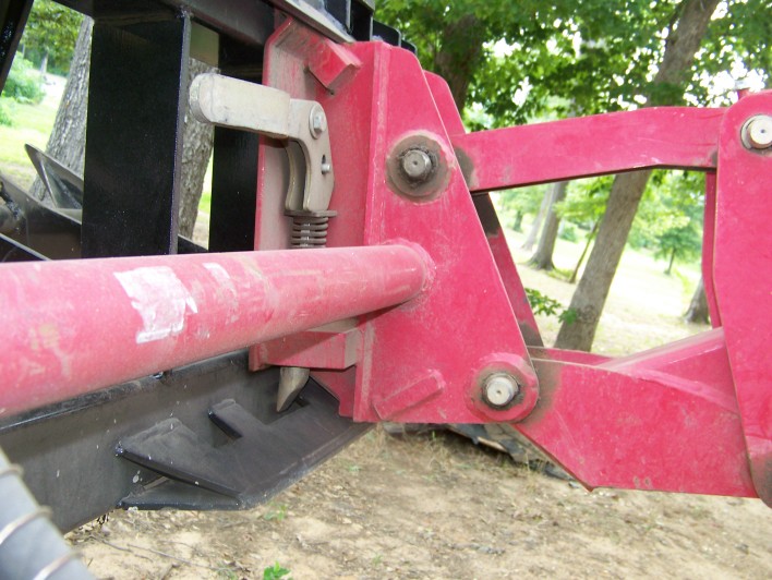

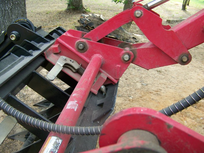

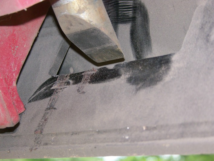

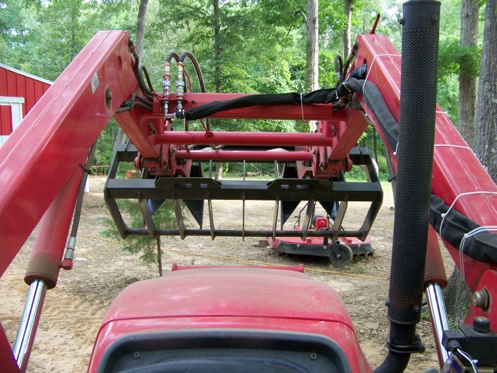

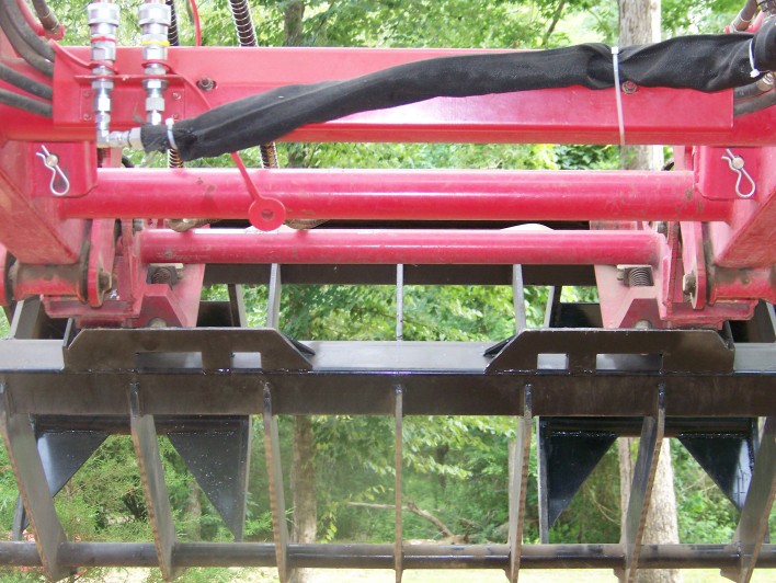

Here are bunch of photos. Can the QA Pin springs become too weak to work correctly? The first photo shows it best with the grapple hanging straight down and about 1/2 to 5/8th inch gap. It is being held on with only about 1/4 inch of pin. Also the red "corner" stop on the QA Tool Carrier is engaging the grapple.

They sent them to alot of customers, don't take no for a answer...

I would add the 3/8 shims/reinforcements. You do not want the grapple to come off.
I built adapters for my grapple. Skid Steer to JD 245 loader. Digging, lifting, carrying, and pushing it worked great. But once i was trying to pull a large log out of a tangle of logs and the 1/4 thick bars the pins engaged bent and the grapple popped off. I was able to stop before the hoses broke. Hammer and a welder and it's fixed.
Looks like there is plenty of room to add plates for more engagement.
I don't think it's a spring problem with your carrier's pins.
I see ebay seller offer the 3/8" reinforcements. But with your skills you could easily fab them, if the manufacturer does not send you some.

NO, that is not normal - it is icorrectly dimensioned. I have a Bobcat attachment [Tilt Tatch] that remains permanently installed on my [identical to your] SSQA. I consider Bobcat the standard, and it fits extremely well. The pins on the SSQA engage about 5/8" ... extending about 5/16"+ out the other side of the slot. Note the cross pins in your overcenter levers on the QA. They are low in the slots and will rise to the top of the slot before stopping the QA attachment pin from rising. It looks like this would allow the grapple to come loose. Your going to need those shims. Id place them slightly forward of the slot edge so the QA pins will hit them sooner and close up that top play in the crosspins a bit. Youre going to like that grapple when you get it right. Just be sure its right before you back stress it or itll likely hurt your QA :eek:

Until I get the shims welded on, I won't put back pressure on the grapple. I plan on (depending on the design of the shims) installing them a little behind the existing slot, 1. for a lip to weld on, and 2., to account for the taper of the pin.

Presumably they have no real affiliation with Bobcat or it would have been right in the 1st place. Take a harder look at the existing slot. On a properly designed implement the bend in the flange fits the bottom QA angle, and the cut slot metal matches the pin angle exactly. So shims backed off from the slot would be a bad choice because the pin will never touch them.
