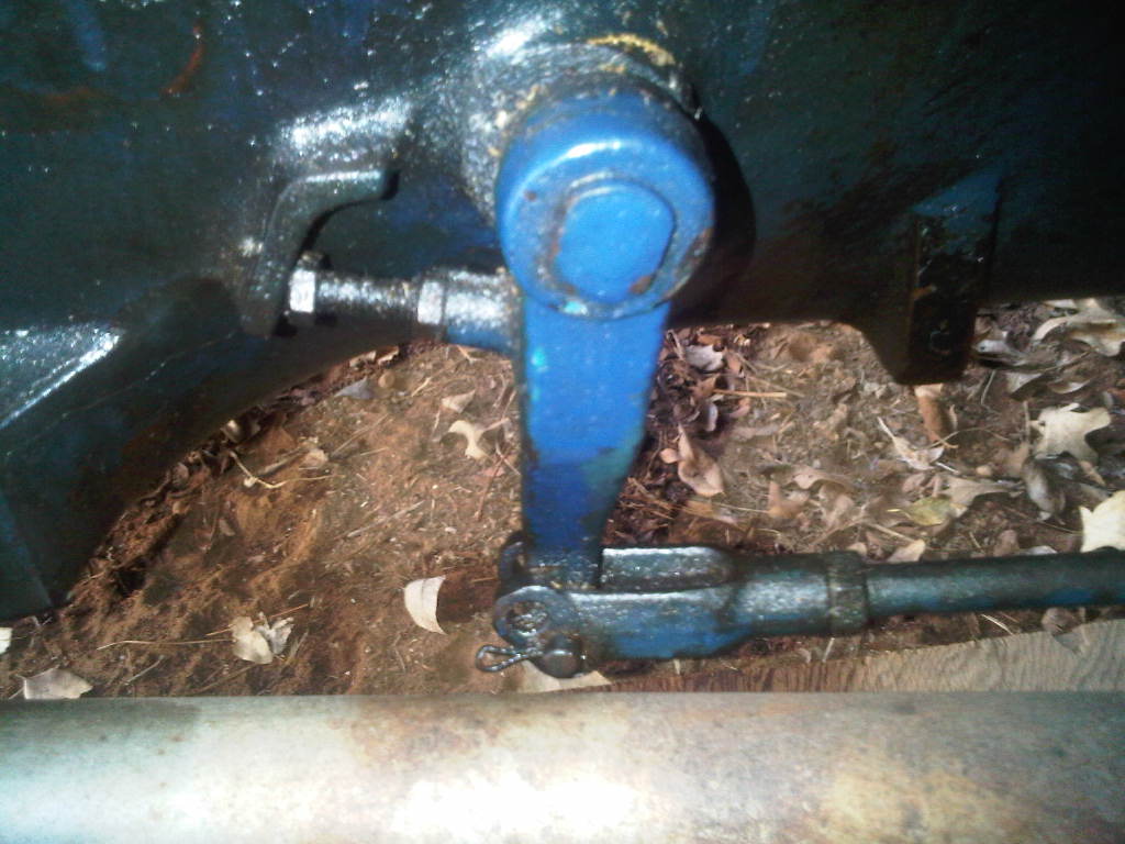

Well, I didn't have an opportunity to fire up the old tractor but I did get to see her for a minute. I found out that I can easily lift up the clutch pedal about 2 inches from where gravity rests it. Is this the freeplay range?

   / New guy: Ford 3000 questions #16
no.. freeplay is where you push before you feel resistance.
